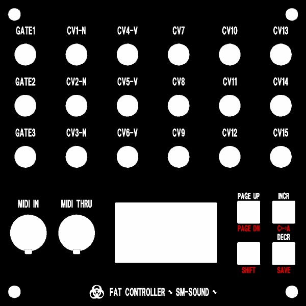

    For CAD design I want to make traffolyte front panels for my synthesizer modules I design. I was thinking maybe Signlab? but also I have Corel Draw and now I am starting to realise the CAD side of things doesnt need to be so much machine orientated am i right in saying for CAD you can almost use anything you like or get on with?
    Mostly yes but the CAM software will dictate this to some degree but most accept common format's like DXF for 2D files and STL for 3D. Coral draw is a good one as it's Vector based which is a common format for most 2D CAM packages.

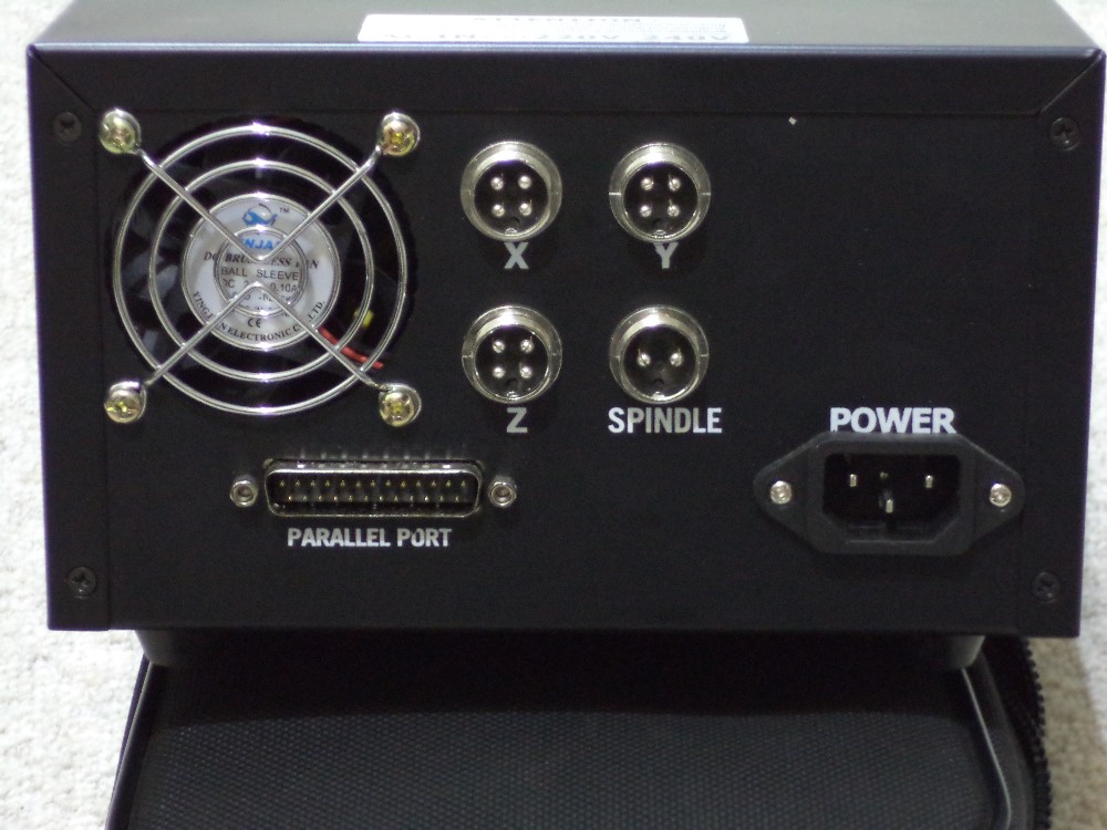

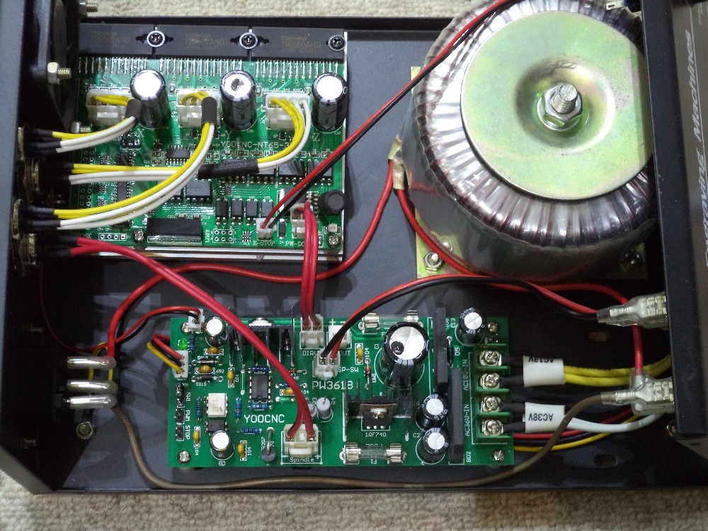

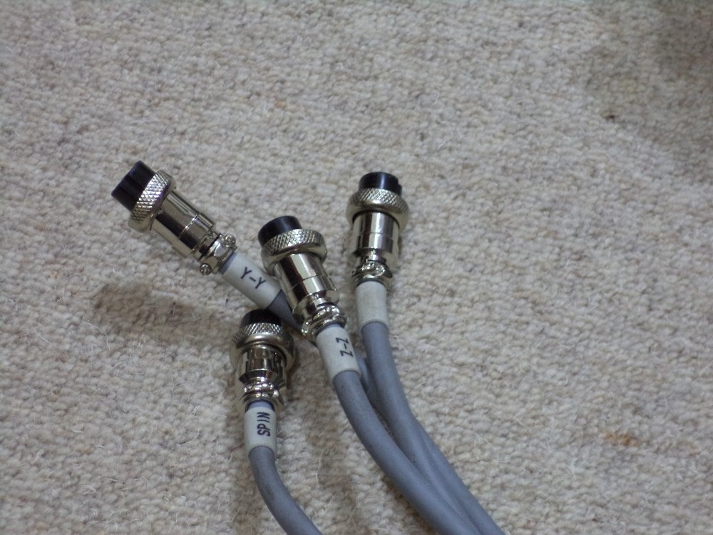

    So to keep on topic here are some pics of my Opened UP stepper control box and also some pics of the machine.

Name:	3020 Sketchey Motor Leads.jpg
    Sketchey Motor Connection LEads

    YOOCNCPW3618 & YOOCNC NT65-3X

    I am also wondering what peoples thoughts are about the Spindle Motor MOD making it PWM control via Mach3 as opposed to the switch and speed control pot on the control box?
    I can see advantages and disadvantages for both options.
    Looking at the board there sure is a free pin labelled PWM thats on the board with the 555 timer on it.
    The boards I have are:
    YOOCNC PW3618
    YOOCNC NT65-3X
    The transformer I have is Torroidial 220V Primary
    Secondary 0-18V
    Secondary 0-36V
    Semiconductor Component list as follows (well most of em lol) :
    PW3618
    4N25
    EL817C328
    NE555
    NT65-3X
    TB6560AHQ
    EL817330
    EL1373201501-50 1304AL
    SS14
    If required I can also knock up a layout in Corel just so you can see what IC goes where.
    There are also x2 74HC SMD components but I cannot find my magnifying glass right now to see the exact number maybe its a 14 but not 100% atm.
    Finally I did check the earthing and yes as warned its pretty sketchey. The main chassis is earthed but half the motor out pins the metal shield is not earthed and also the fan covers are not earthed.
    I assume most of thes eissues are caused by powder coating the box then fitting the stuff without exposing the metal.
    I guess another reason why this is kit is cheap.
    However, so far for what I paid from what I can see it seems quite good value.
