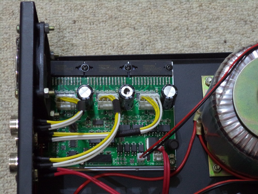

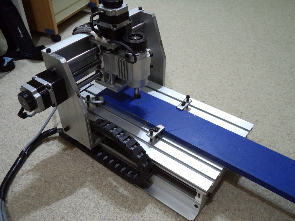

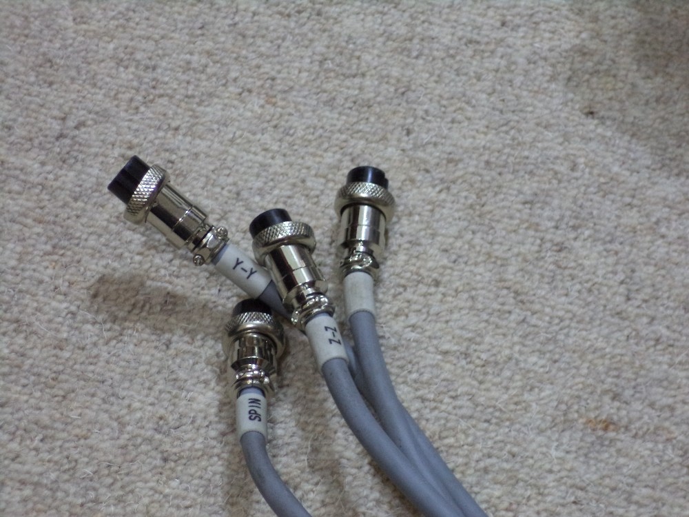

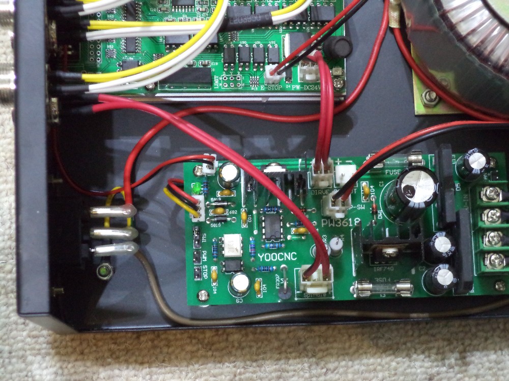

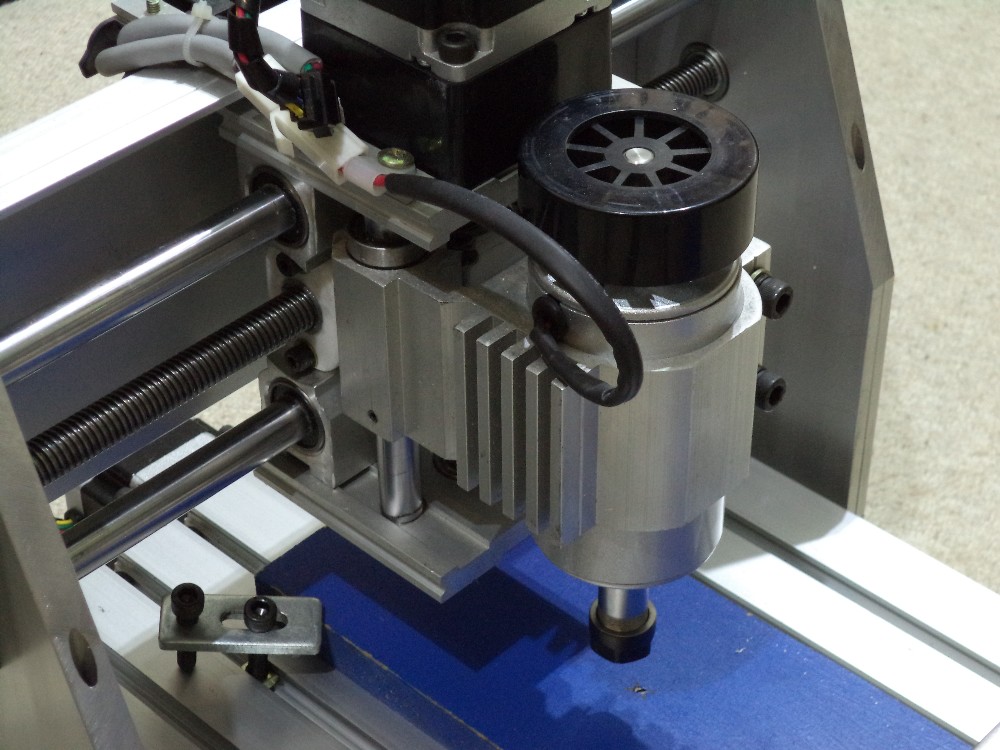

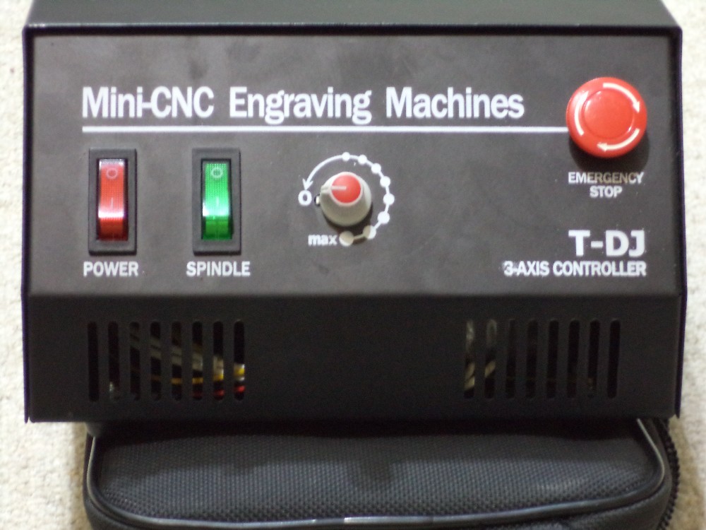

So to keep on topic here are some pics of my Opened UP stepper control box and also some pics of the machine.
3020 Router/Engraver
3020 Router/Engraver Rear
Spindle Motor
Sketchey Motor Connection LEads
Stepper Controller Front
Stepper Controller Rear
YOOCNCPW3618 & YOOCNC NT65-3X
YOOCNCPW3618
YOOCNC NT65-3X

I am also wondering what peoples thoughts are about the Spindle Motor MOD making it PWM control via Mach3 as opposed to the switch and speed control pot on the control box?
I can see advantages and disadvantages for both options.
Looking at the board there sure is a free pin labelled PWM thats on the board with the 555 timer on it.
The boards I have are:
YOOCNC PW3618
YOOCNC NT65-3X
The transformer I have is Torroidial 220V Primary
Secondary 0-18V
Secondary 0-36V
Semiconductor Component list as follows (well most of em lol) :
PW3618
4N25
EL817C328
NE555
NT65-3X
TB6560AHQ
EL817330
EL1373201501-50 1304AL
SS14
If required I can also knock up a layout in Corel just so you can see what IC goes where.
There are also x2 74HC SMD components but I cannot find my magnifying glass right now to see the exact number maybe its a 14 but not 100% atm.
Finally I did check the earthing and yes as warned its pretty sketchey. The main chassis is earthed but half the motor out pins the metal shield is not earthed and also the fan covers are not earthed.
I assume most of thes eissues are caused by powder coating the box then fitting the stuff without exposing the metal.
I guess another reason why this is kit is cheap.
However, so far for what I paid from what I can see it seems quite good value.
