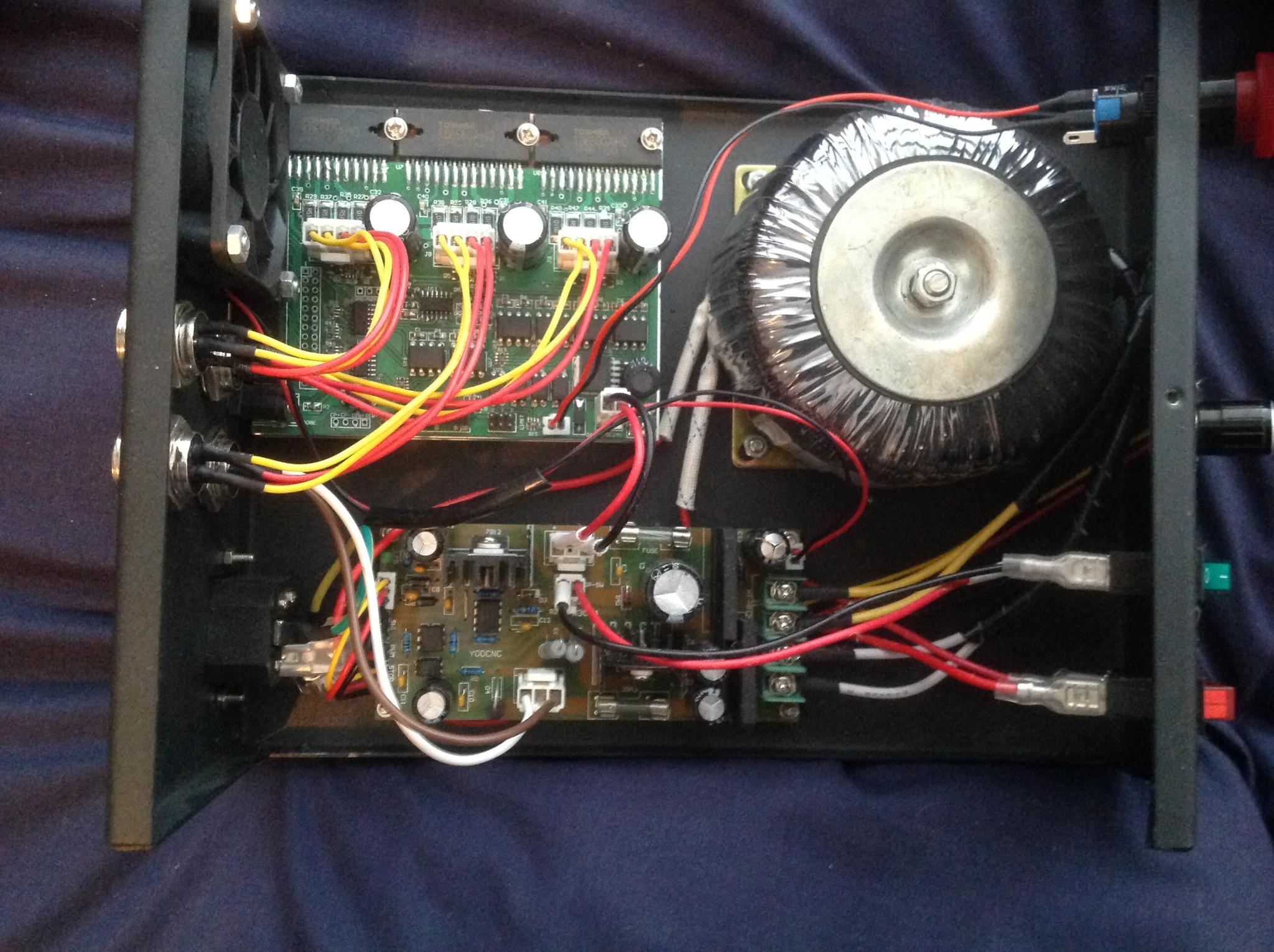

    I was having a look in the control Box and noticed that were they had grounded the earth wire to the bottom off the box wasn't actually grounded because off the paint so I undid the nut and scraped away the paint and now the Control box is earth so if you have one off these boxes you should check just to be on the safe side.

    It seems to be ok so far but I haven't cut anything with it yet,No there is no limits or home switches fitted to the machine, I hope to fit some but I am not to smart when it comes to pcb boards and haven't a clue if they can be fitted to this machine I know the spindle board is called a yoocnc pw3024
