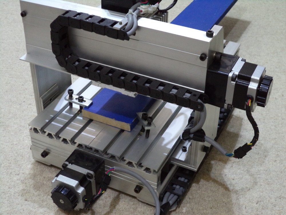

    So to keep on topic here are some pics of my Opened UP stepper control box and also some pics of the machine.
    3020 Router/Engraver
Name:	3020 Rear Shot.jpg
    3020 Router/Engraver Rear
Name:	3020 Spindle Motor.jpg
    Spindle Motor
Name:	3020 Sketchey Motor Leads.jpg
    Sketchey Motor Connection LEads
Name:	Stepper Controller Front.jpg
Name:	Stepper Controller Rear.jpg
Name:	Both Boards.jpg
    YOOCNCPW3618 & YOOCNC NT65-3X
Name:	YOO CNC PW3618.jpg
    YOOCNCPW3618
Name:	YOO CNC NT65-3X.jpg
    YOOCNC NT65-3X
Name:	My End Goal.jpg
    My end goal and target with my home CNC project :)

    I am also wondering what peoples thoughts are about the Spindle Motor MOD making it PWM control via Mach3 as opposed to the switch and speed control pot on the control box?
    I can see advantages and disadvantages for both options.
    Looking at the board there sure is a free pin labelled PWM thats on the board with the 555 timer on it.
    The boards I have are:
    YOOCNC PW3618
    YOOCNC NT65-3X
    The transformer I have is Torroidial 220V Primary
    Secondary 0-18V
    Secondary 0-36V
    Semiconductor Component list as follows (well most of em lol) :
    PW3618
    4N25
    EL817C328
    NE555
    NT65-3X
    TB6560AHQ
    EL817330
    EL1373201501-50 1304AL
    SS14
    If required I can also knock up a layout in Corel just so you can see what IC goes where.
    There are also x2 74HC SMD components but I cannot find my magnifying glass right now to see the exact number maybe its a 14 but not 100% atm.
    Finally I did check the earthing and yes as warned its pretty sketchey. The main chassis is earthed but half the motor out pins the metal shield is not earthed and also the fan covers are not earthed.
    I assume most of thes eissues are caused by powder coating the box then fitting the stuff without exposing the metal.
    I guess another reason why this is kit is cheap.
    However, so far for what I paid from what I can see it seems quite good value.
    However.. theory and practicality can be very different..
    I should have more results this weekend :)
