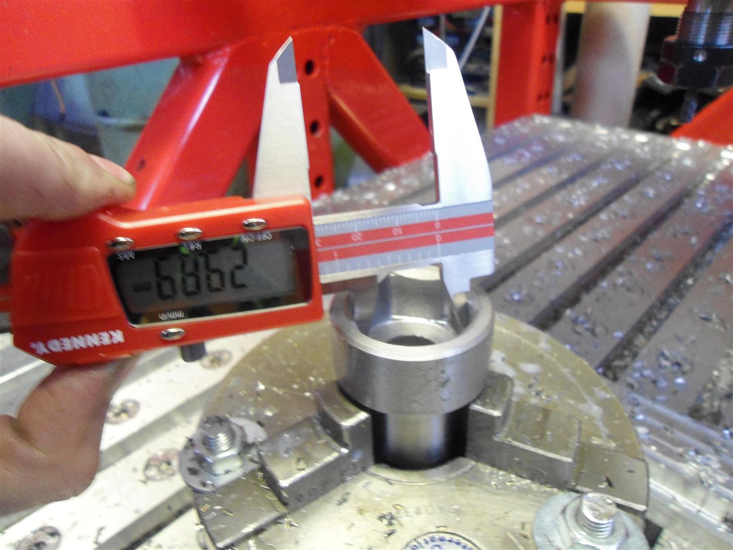

    The plan ultimately is to use it with this part...

    You can guess the rest.
