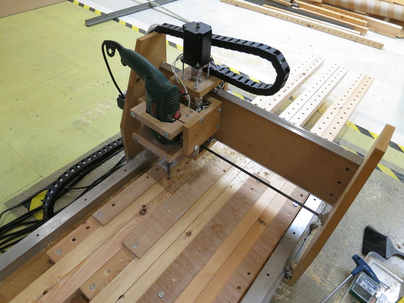

    Here's a picture of my machine in case you're curious what it looks like...
