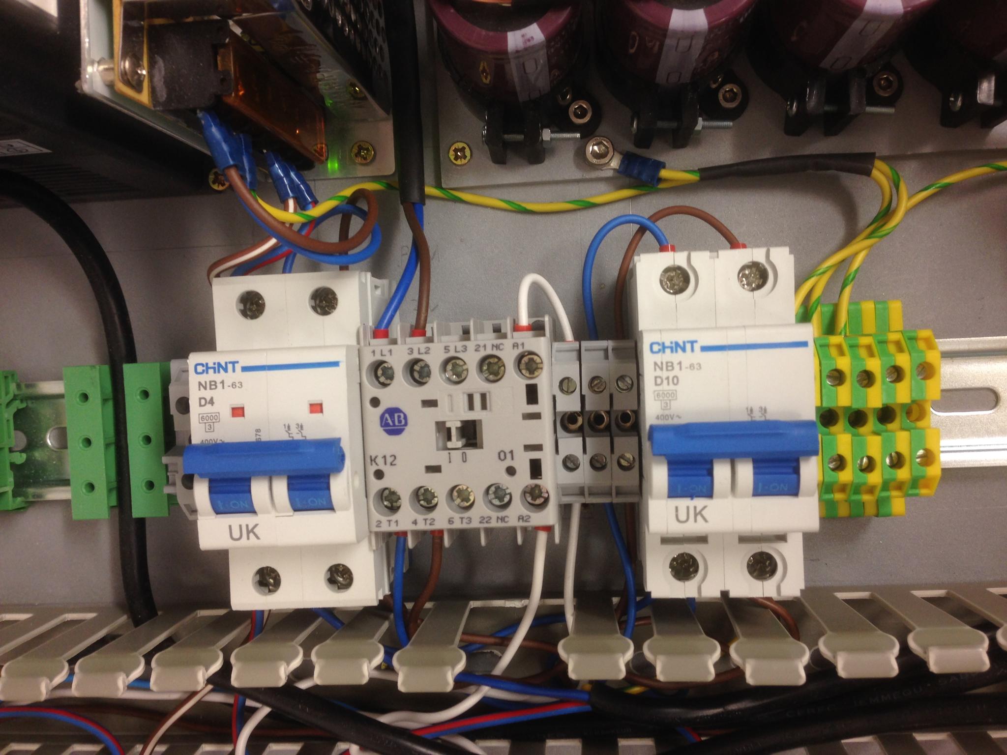

    It's a very neat and tidy job you are doing.
    May I ask where you got the three blue connectors (on the din rail next to the relay) from?.
    Can I see a blue wire trapped under the din rail where the connectors are!! ..Clive

    Had another look at the picture and it does look like a wire is trapped but it must be a bit of outer sleeving that has dropped into the rail. I was stripping a lot of cables last night.

    ICan I see a blue wire trapped under the din rail where the connectors are!! ..Clive
    Bloody hell Clive you must have eaten some carrots as a Kid. Had to look really hard to see that even after you highlighted.
  4. #94
    That's what happens when you won't go to bed early.

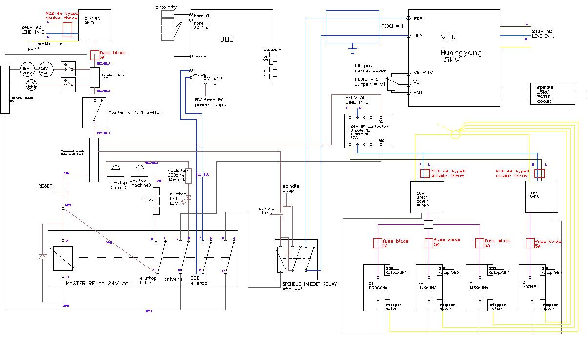

    Got the 24V relay and the contactor wired in earlier this week. But when I energise the 24V relay, the contactor switches but the MCB for the linear supply then trips out. Tried it twice and it tripped both times.
    Wiring diagram re-posted here:

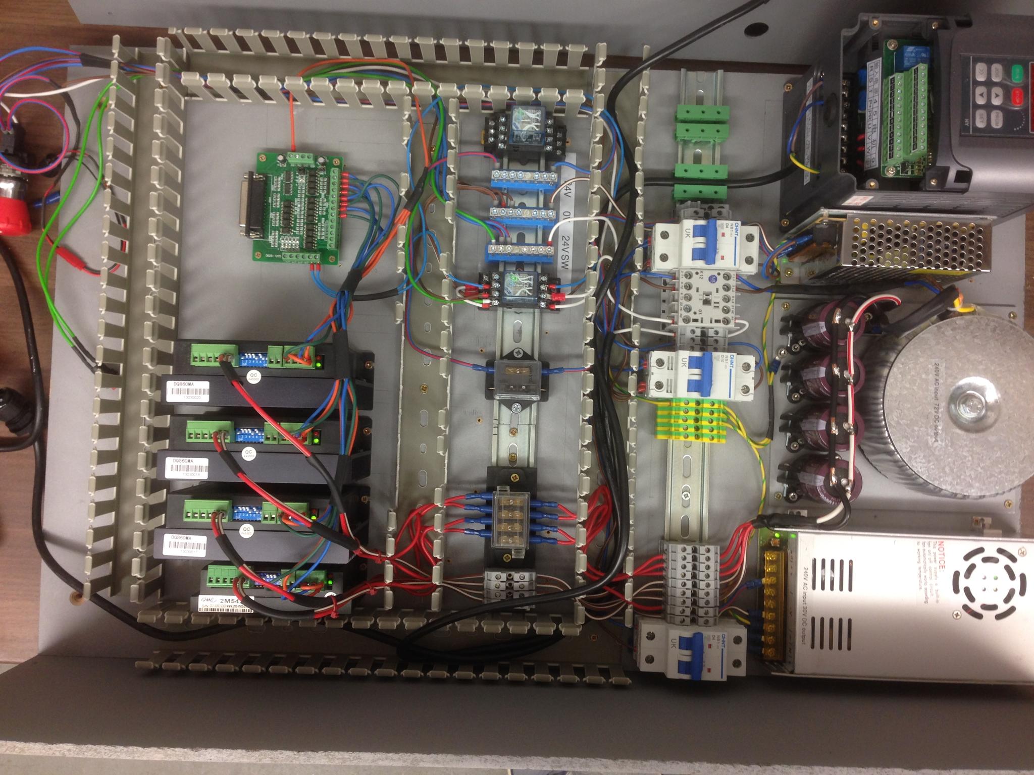

    Here is a close up picture if it helps:
    The powering up sequence is:
    1. Plug in and switch on at wall - this powers up the 24V PSU
    2. Switch master on/off switch which puts the system into e-stop mode and lights up the red LED
    3. Press the RESET momentary button which switches off the red LED
    4. This energises the 24V master relay (which self-latches)
    5. The master relay makes a circuit which runs 24V to the contactor A1/A2
    6. The contactor switches on (with a click, and the lever indicator on the front moves to I)
    7. This takes the mains power from the 6A type D MCB . . .
    8. . . . and feeds it to the linear PSU (which is connected to 3 drives), but the MCB immediately trips
    If I disconnect the linear PSU then the relay, MCB and contactor operate and power up correctly and stay on so it would seem that the transformer inrush is too high for the MCB?
    Previously with the linear supply connected to one driver and just through the MCB without the contactor it has switched on (on the one and only time I tried it) without a problem.
    So, what to try? - What is the reason for most of the current draw ? -
    Inrush through the 'shorted' coil until the magnetic field is established ? (750VA 2x24)
    Charging up the capacitors (40,000uF) ?
    Doing the above and powering up the 3off DQ860MA 80V drivers ?
    Or some from each ?
    I could try switching on and off several times without any drive connected
    I could then try disconnecting the AC supply to the rectifier and see if the MCB stays on with just the inrush through the coil - is that OK to do?
    If that is OK I could unsolder one of the capacitors to reduce the charging draw.
    Up-spec the MCB ?
    Any ideas? thanks

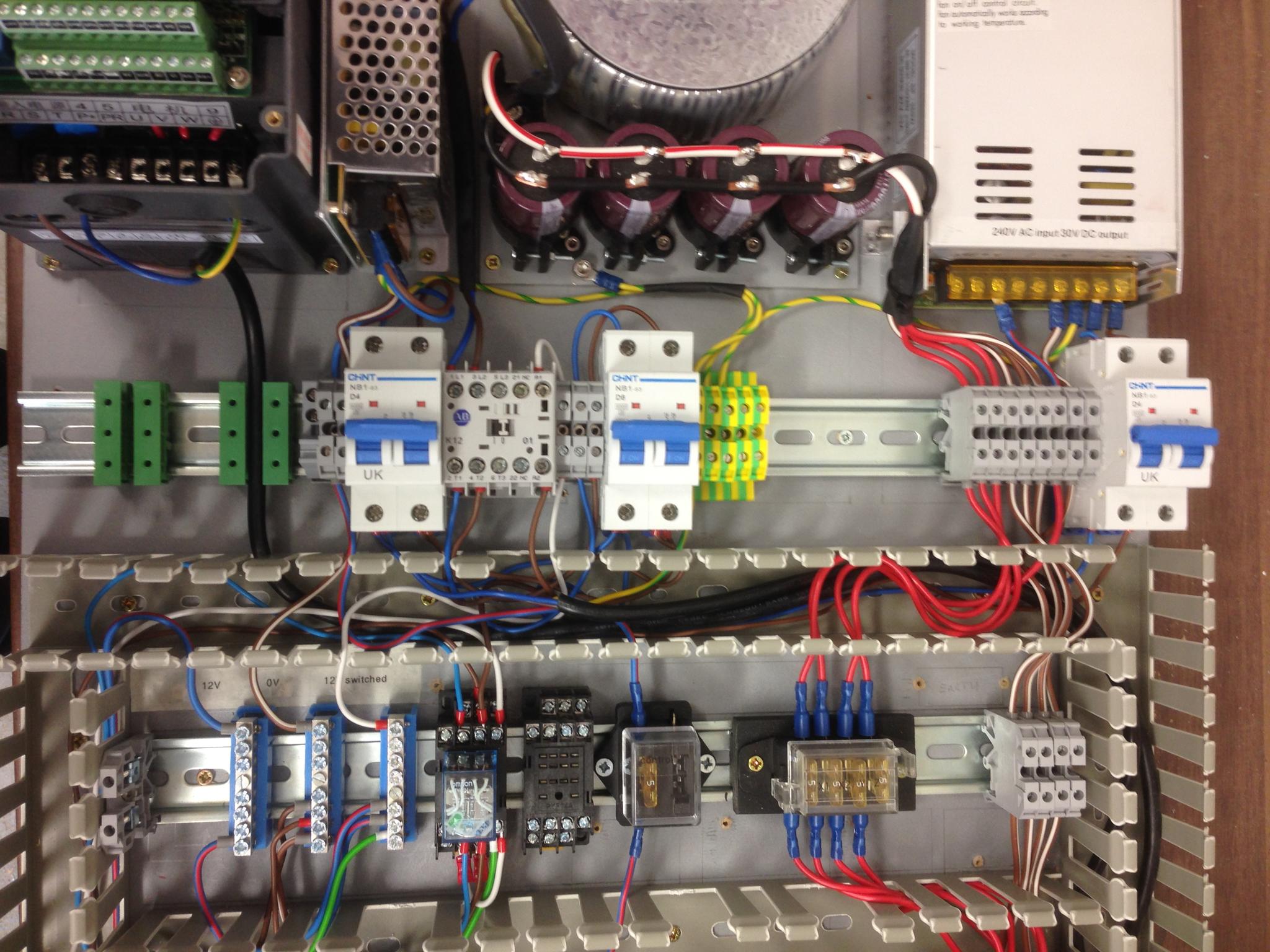

    10A MCB type D arrived today so I swapped out the 6A unit, held my breath, and switched it on. The contactor clicked and the drivers powered up !
    Could have been lucky (by chanced switched at maximum peak voltage) so tried it again. Same thing, worked fine. Switched off and tried one more time. All fine again. All this was with 3 drivers connected (but no motors yet).
    Switched off again and checked the decay time on the linear supply and it dropped from 72V at just over 1V per second, and stopped at around 3V.
    Here is the proof:
    And here is the new unit (the one on the right):
    It will be the weekend at the earliest now but hope to mount it on the wall and plug in all the cables etc. to get the basic machine running. It might be the following weekend but hope to machine out the control panel that I was cutting out when it went bang last time.
