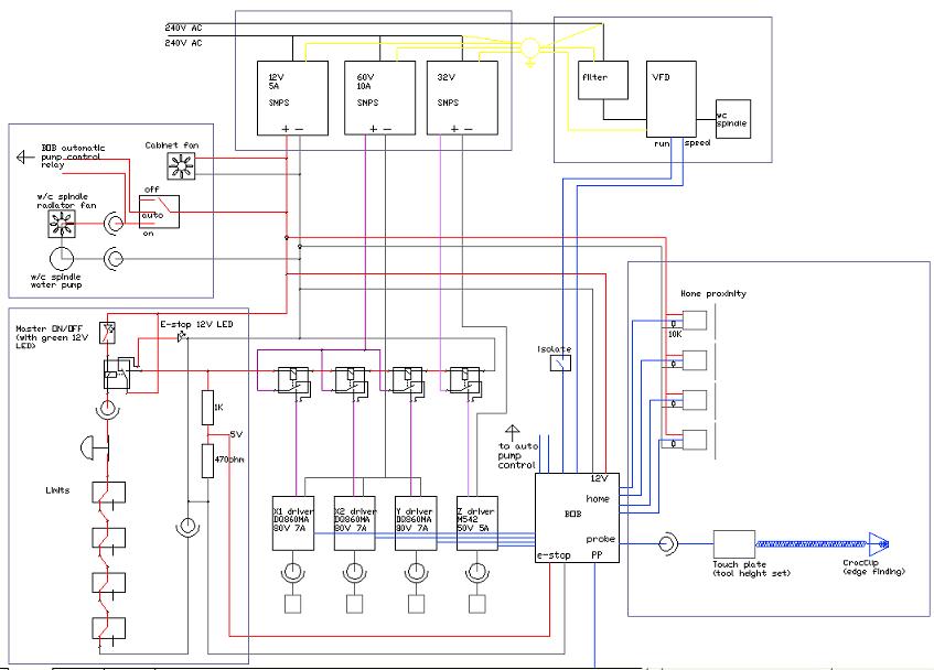

    Don't use a relay for the probe as you'll get a delay and you don't want that.
    Regards the relay then just use a Standard 12 or 24V relay for the limits. Unless your BOB inputs can accept 24V which they won't All your doing is running the 5V signal from BOB thru the NO contacts and keeping the wire length to the shortest possible. Most false trips are picked up from the Long limit switch wire runs connected directly to the input and often close to power cables acting as antena picking up stray signals. Using 24V means you can run it thru the Limits and E-stop to power the Relay coil making the system stable and won't trip the relay unless broken and keep the Signal wires short and inside the Control box.
    Also I wouldn't use Solid state Relays as they tend to fail On which is BAD news for limits.!!

    I'm a big fan of 'volt free' contacts, i.e. in this case the contacts of the relays, it lets you interface different voltages from different sources without problem and if you want to add other things into the circuit later on you won't have to modify existing parts to accommodate it. As Irving says, fewer components is more reliable but in this instance my preference is to use a relay.
    In my case I eventually used 3 wire proximity switches for the home switches directly into the bob and a PILZ relay with the limits in series with E/Stop switches and then one of the PILZ relay contacts into the bob.

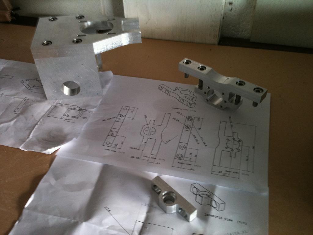

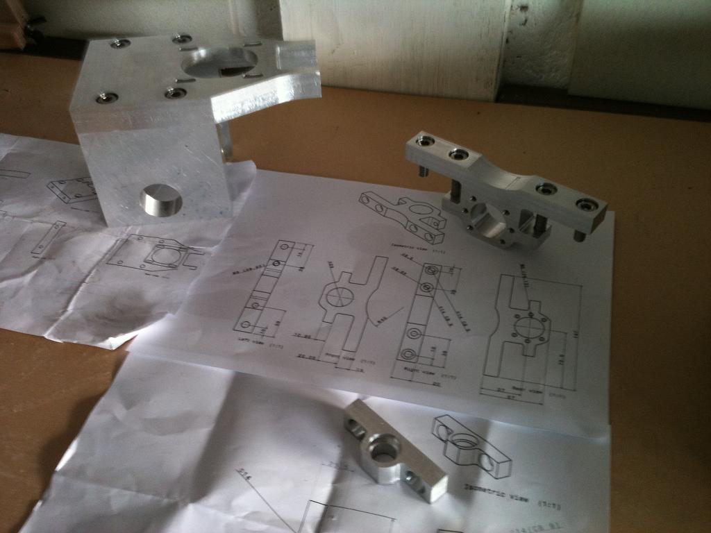

    Few more bits for the upgrade parts.
    Left = replaces some wooden parts which held the Z axis stepper motor, plus the Y axis ballscrew nut
    Back right = Bracket which connects the new Z plate (20mm aluminium) to the Z ballnut
    Front = Bracket which holds the bearing at the lower end of the Z ballscrew. Purpose designed compact unit to limit the amount of Z plate pocketing to retain Z plate stiffness. Machined the bearing pocket with a roughing cut, leaving 0.2mm dia undersize, then finished with full depth cut at final 20mm diameter. Really nice finish. Bearing arrived today (ID6xOD19xdepth6) and is a lovely gentle press fit into the bore. The end of the ballscrew will be turned down to leave a 6mm dia spigot.
    As you can see I like to print out some basic drawings with a few key dimensions on as I find this helps overcheck the machining etc. I've also started sketching the outline of the part on the blank with a felt pen to see where it will cut, where to clamp, make sure the machining is occuring roughly where it should be etc. All for now.
  8. The point I was making is that if your BOB has optoisolated inputs you can run these directly at 24v with 5kV isolation and all the noise immunity you need and saves all the hassle, adding an optoisolated relay doesn't 'make it better' just less reliable. Noise immunity is only an issue with non-isolated 5v BOB inputs.
    Incidentally, if that is the circuit on that board then it has a potential noise immunity issue of its own unless used in a 'permanently energised' arrangement. With the diode not energised, the base of the output transistor, say Q1, is floating. Depending on the gain of Q1 a sufficiently large spike could briefly turn the transistor on and energise the relay. It should have a pull-down from the base to ground to prevent charge build-up on the base. A moot point and unlikely but not impossible.

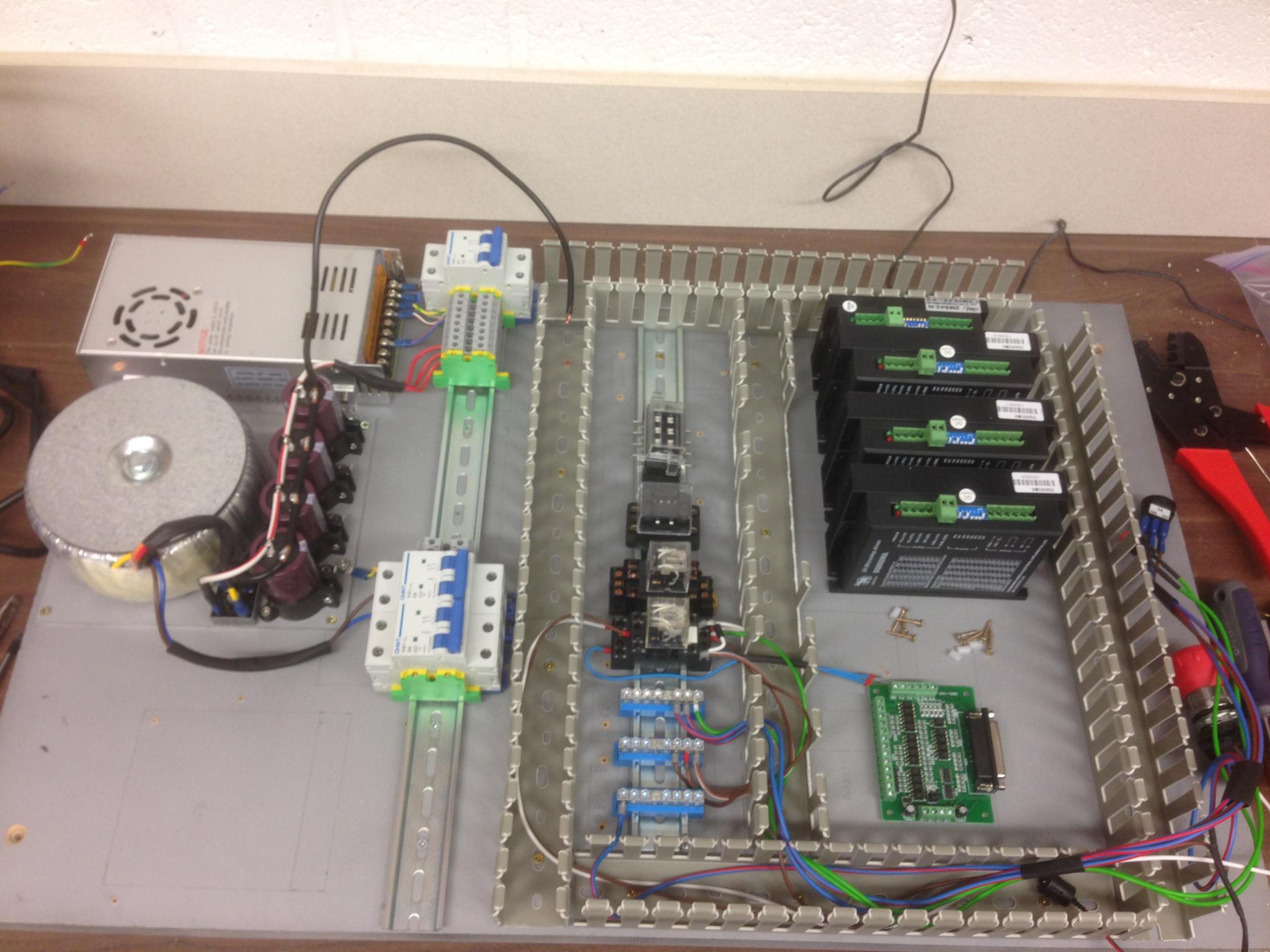

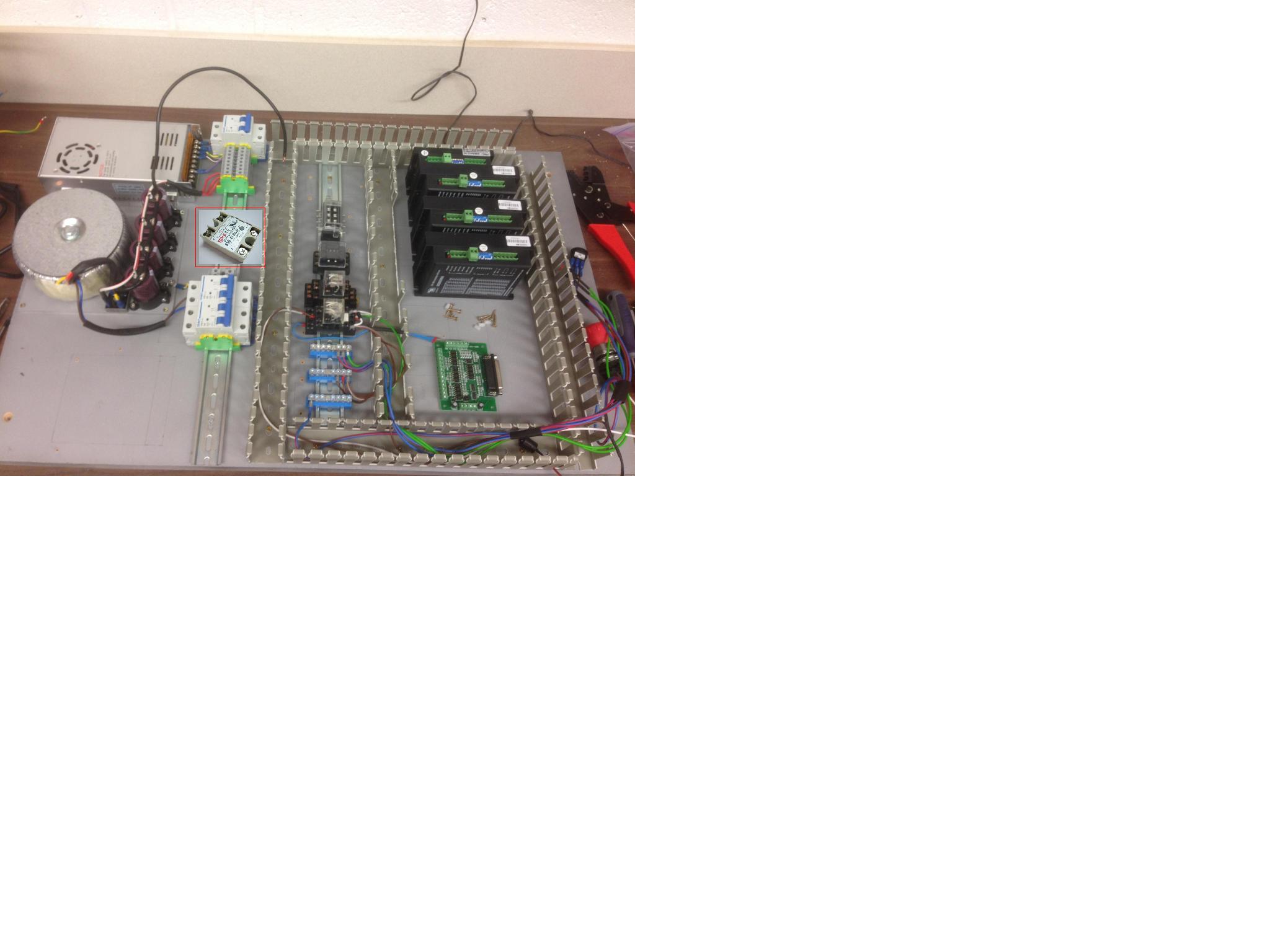

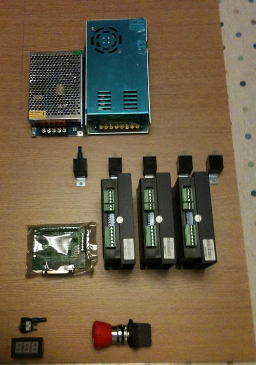

    My VFD being out of action has stopped progress for now. I need to get the machine working to cut out the control panel, and some other parts. Whilst I sort that out I thought I'd keep the log going by showing these bits which arrived a while ago:
    DQ860MA drivers for X1, X2, Y (80V 7A) from Wantai
    60V 10A power supply for drivers
    12V power supply for relays, limits, home
    Breakout board ('free' model which came with DQ860MA) - this is pretty basic and has no relays etc.
    5off 12v relays with spade terminals - one master, 4 slaves
    e-stop panel mount version
    master on/off switch with power light
    voltmeter (just for show really)
    not shown:
    Z axis retains existing MD542 driver at around 32v (re-using current bits which work fine)
    3off proximity switches for homing
    red 12V LED in bezel mount (to show e-stop condition)
    Far from complete, here is current wiring layout:
    This assumes I upgrade the BoB as:
    It is shown controlling the VFD speed
    It is shown using BoB to run cooling fan and pump for spindle
    It is shown running of 12v (free one is 5V)
    Also drawn too many limit switches!

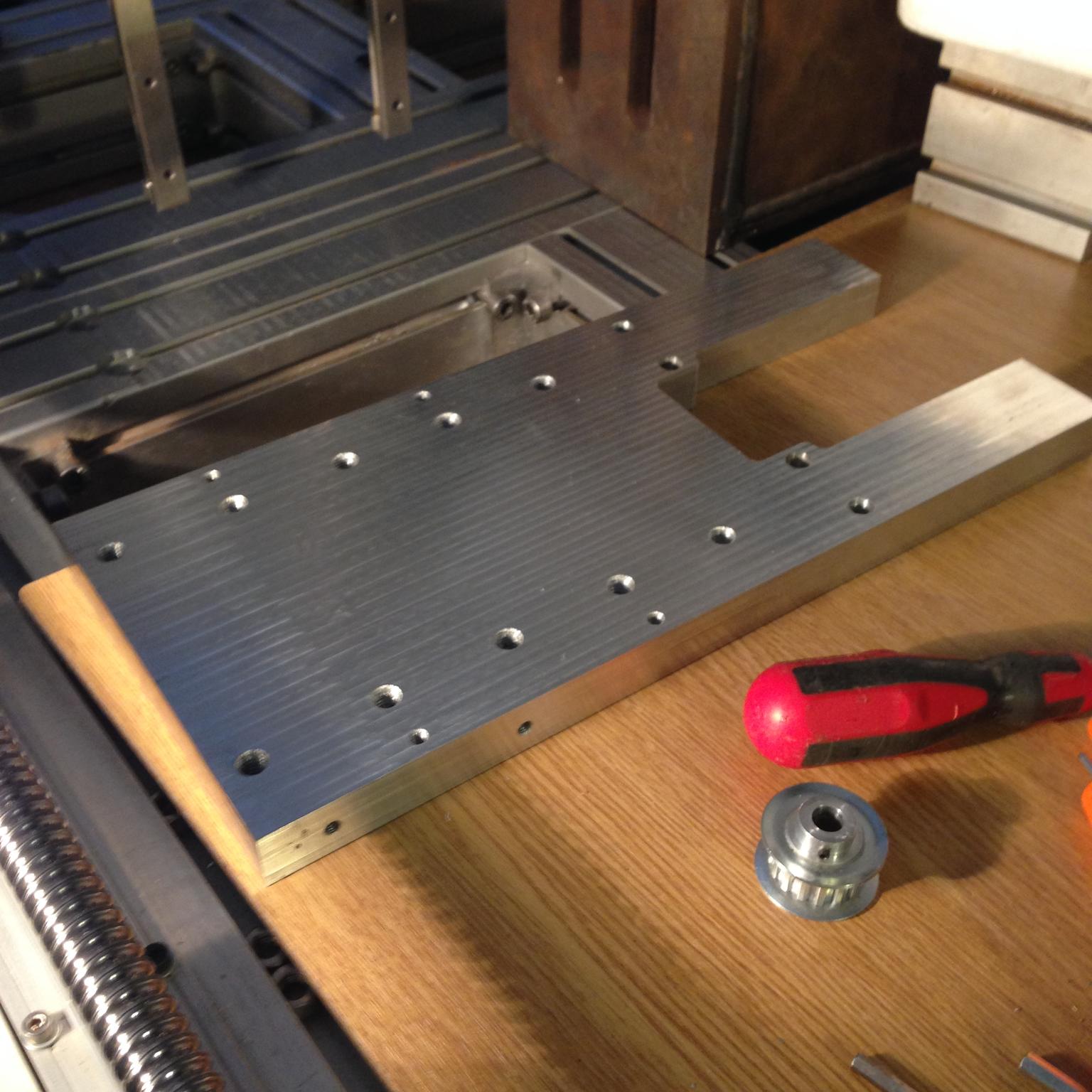

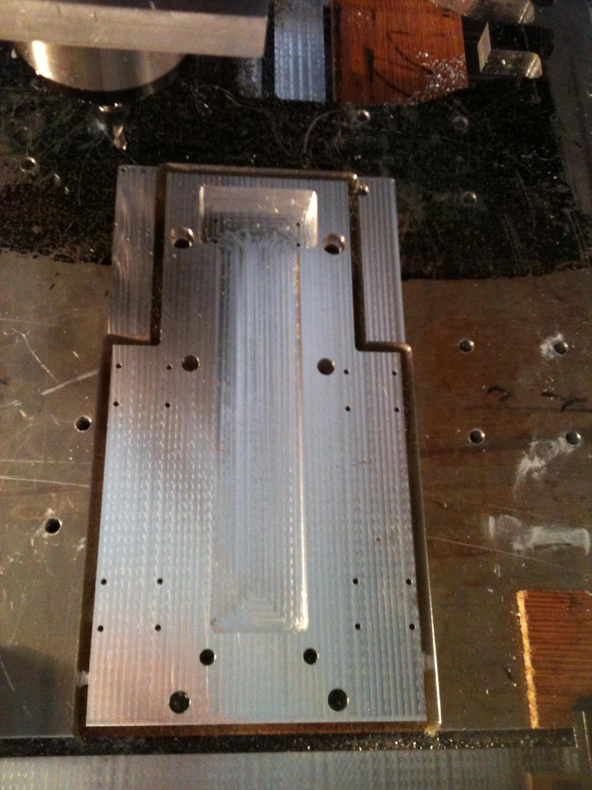

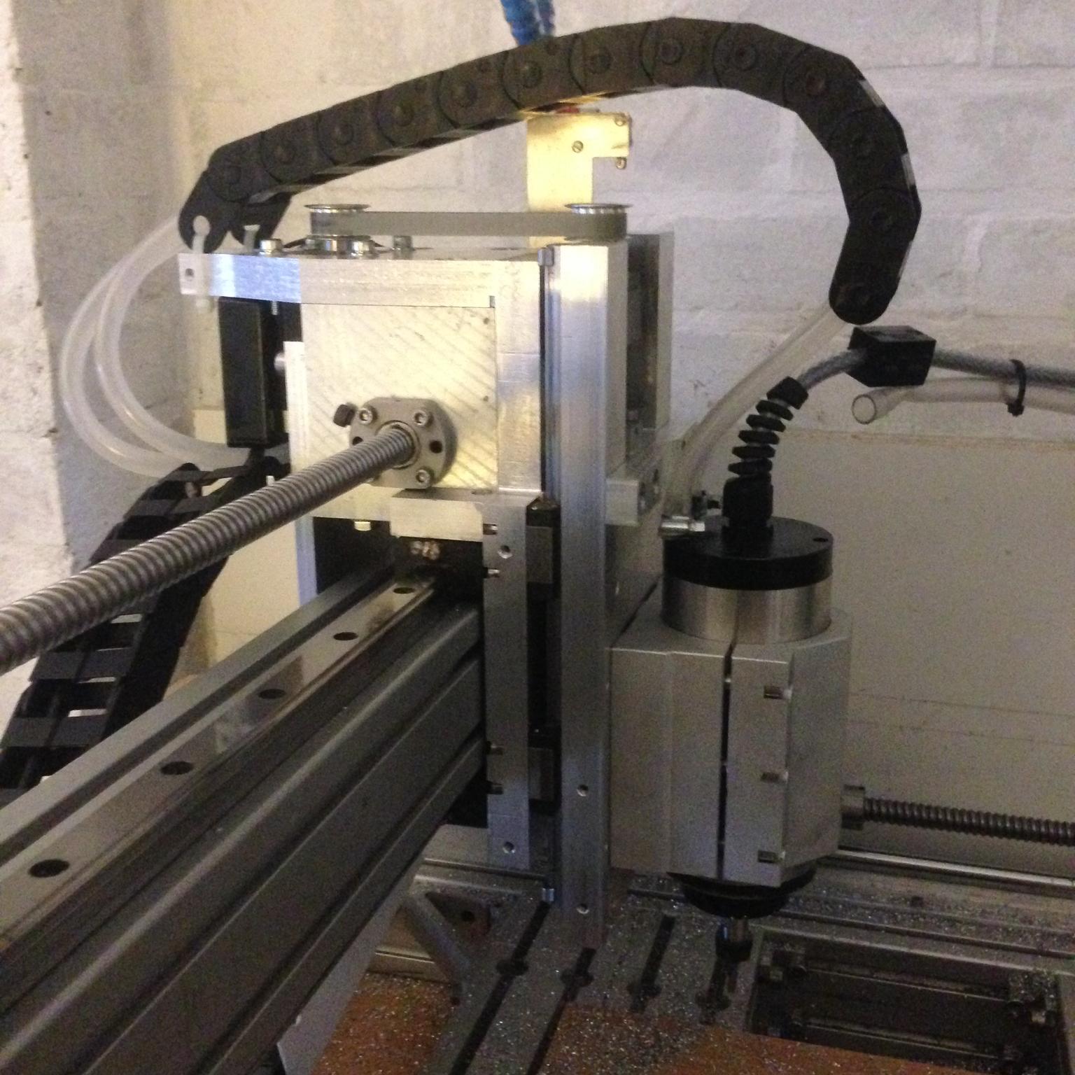

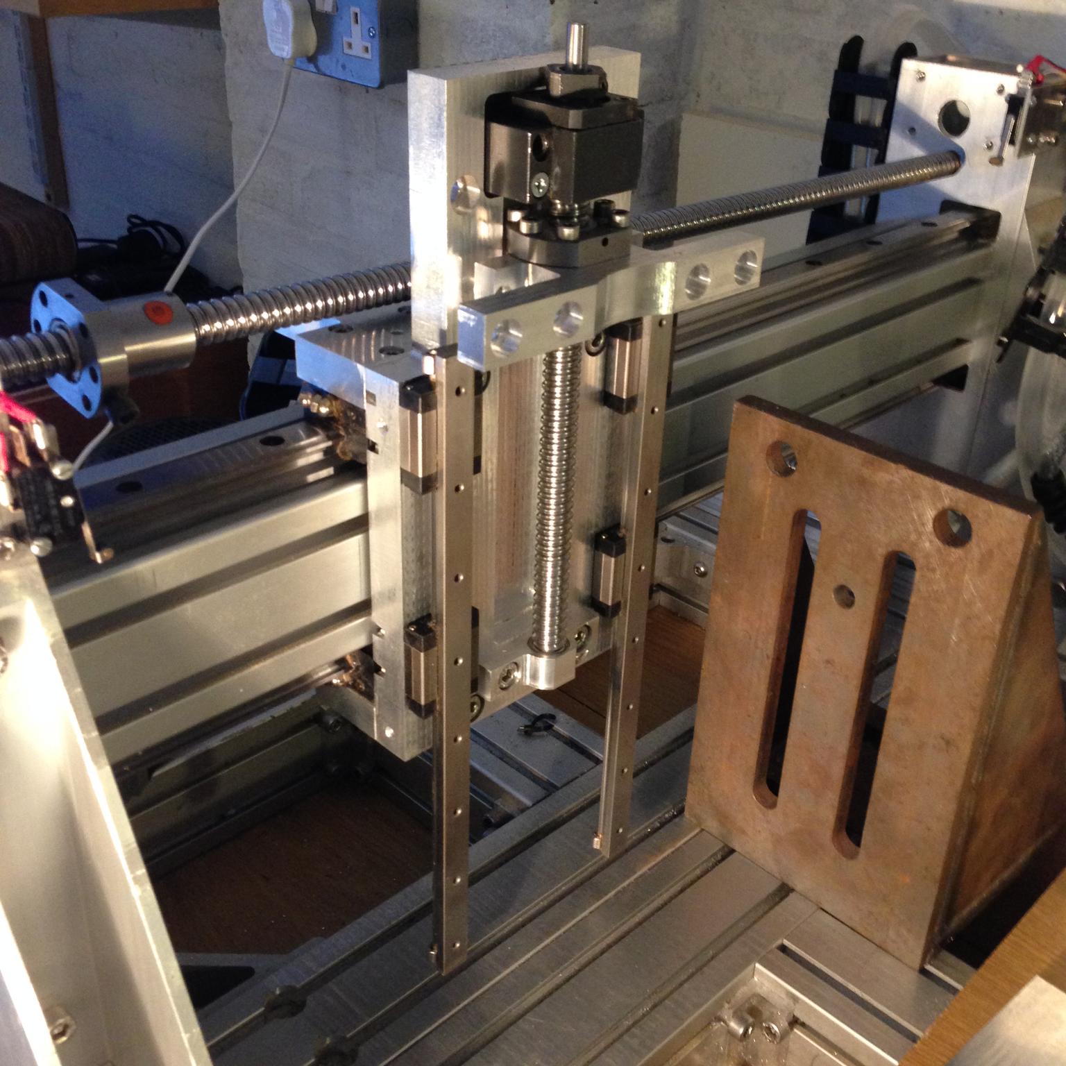

    A couple of weeks ago I finished machining the final part for upgrade and disassembled the Y and Z axis. Here are a few photos of the new bits coming together.
    1. Z stepper motor mount and side pieces which hold the Y axis ballscrew

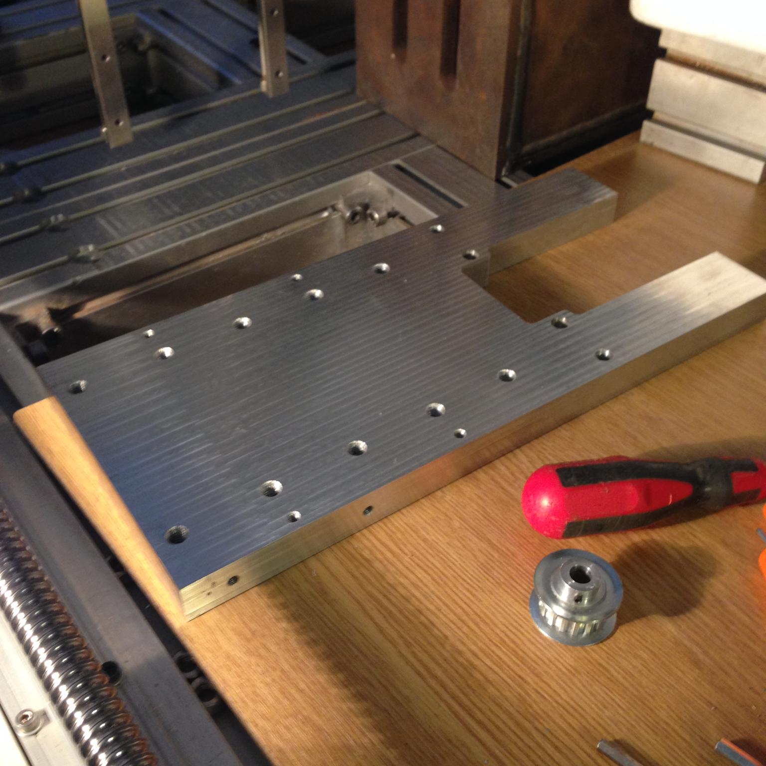

    2. Z axis main plate
    3. Y axis main plate

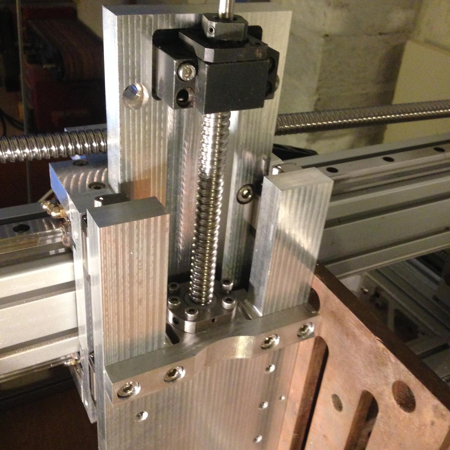

    4. Z axis rails and ballscrew coming together

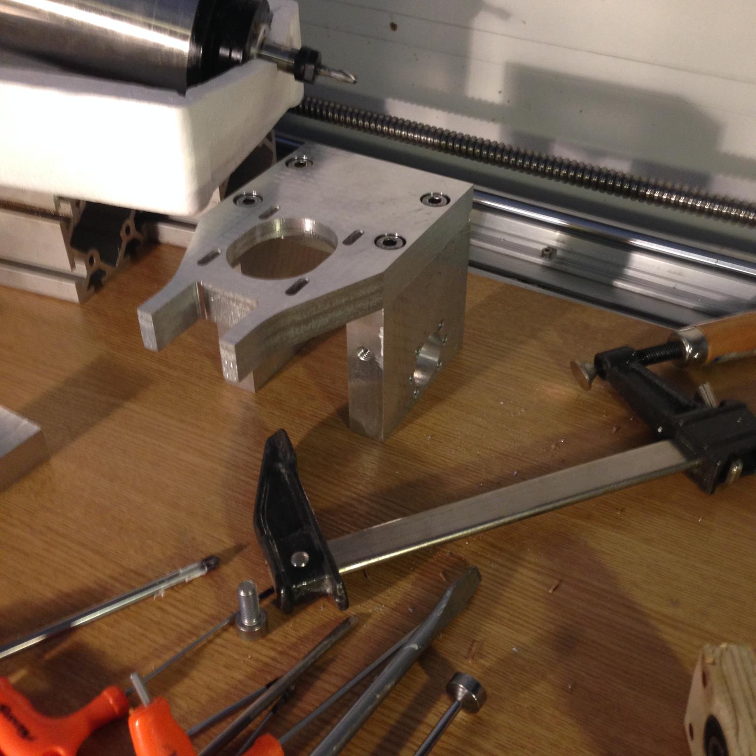

    5. Converted a linear bearing housing to clamp the 80mm spindle (as posted by others on this site)
    Removed circlips, knocked out bearing, machined slot in one side, drilled 2 new holes to make 6 in total, counterbored to suit M8, job done.
    Plan is to fit 2 long blocks onto the Z axis plate either side of this clamp so that if I ever index it up or down the Z axis it will remain aligned.
    Still bits and pieces to tidy up, new spindle strain relief bracket to make, tidy hoses etc. but have already cut out my first new part and it does seem to be cutting better than before.
