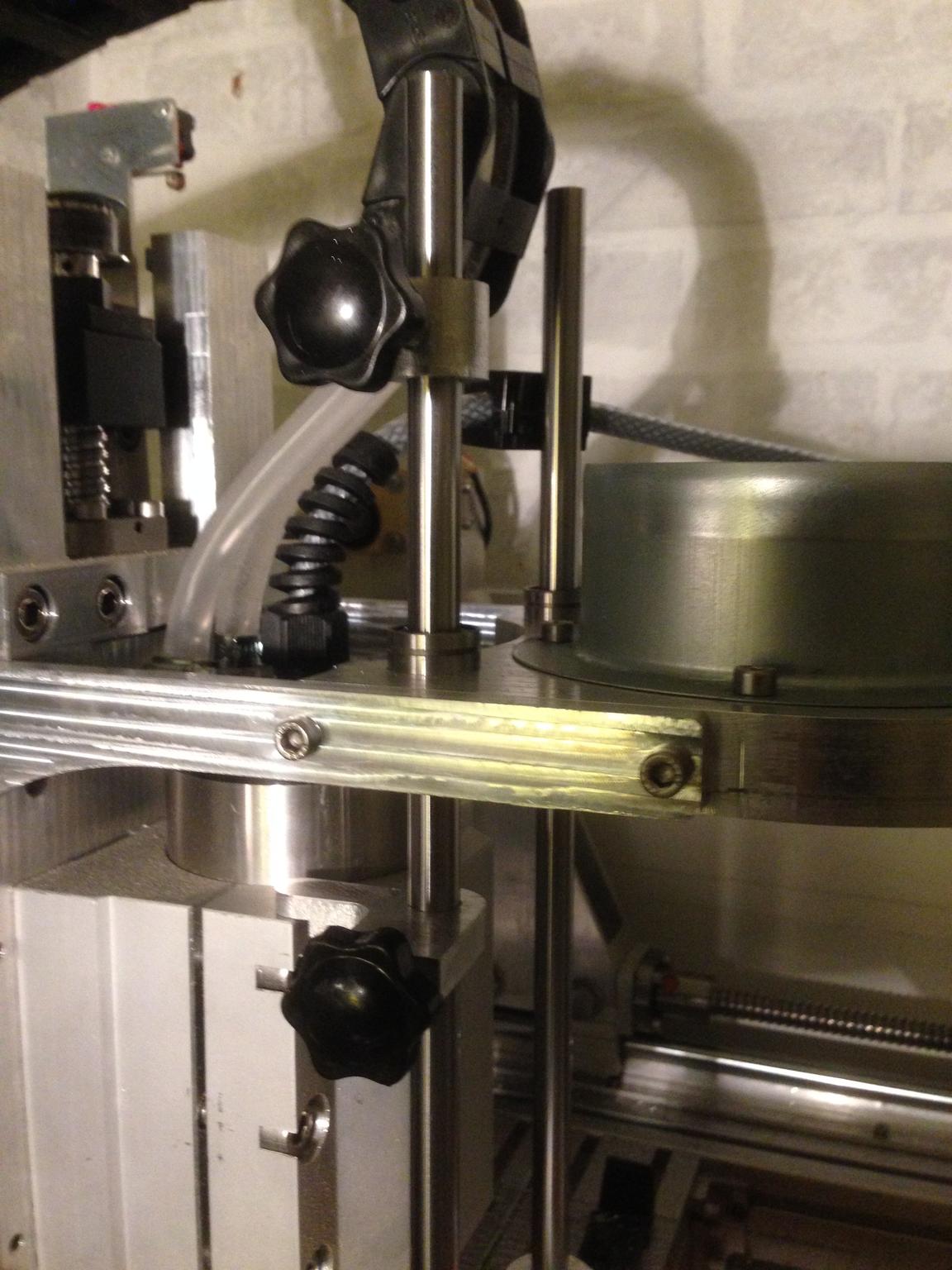

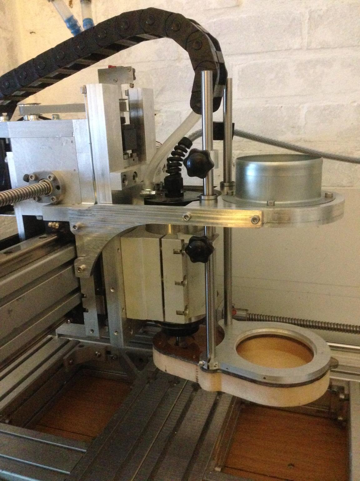

    I guess you mean CAM toolpath control to avoid any clamps? I have some low profile clamps so should be OK there.
    With regard to adding brushes - yes I've considered that and with the lower plate being removable I can try different designs and use the best one for the job.
    @Eddy,
    Thanks for the link to the video. He does go on a bit! During cutting mine will behave a bit like that, but with the advantage of rising up out of the way when the cut is finished. His looked static from what I could tell.
    Also, the lower plate on his is completely open, whereas mine is only open locally around the cutting bit so should give better extraction. I also think my magnetic removable plate means it is quick to get everything out of the way and change over to jobs which don't really need a dust shoe such as aluminium machining.
    Eddy,
    The only aspect I was drawing your attention to was the piece of 4" flexible ducting around the spindle collet area
    I'd glossed over that but you are right - that is a good feature and would improve dust collection still further. I don't think I could fit 4" hose, but something smaller in diameter and just tall enough to make a seal with the spindle during cutting should work. I'll look into it . . .
    Some progress. Putting my hand under the extractor shoe feel likes a reasonable draft so I think it will do the job.
