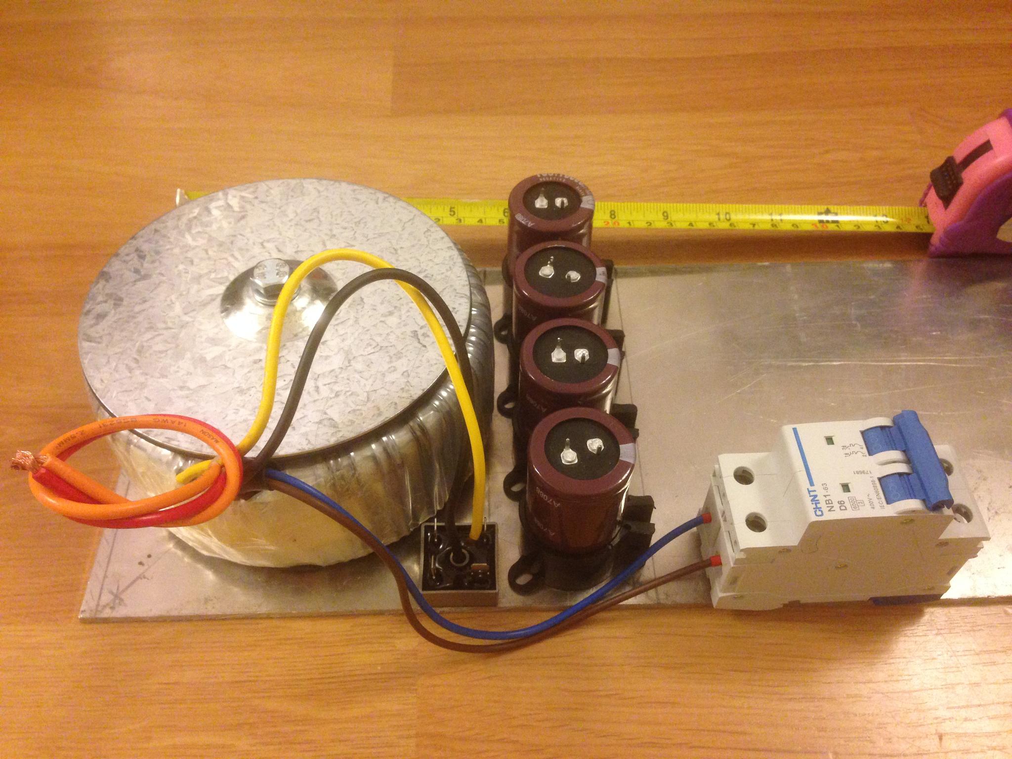

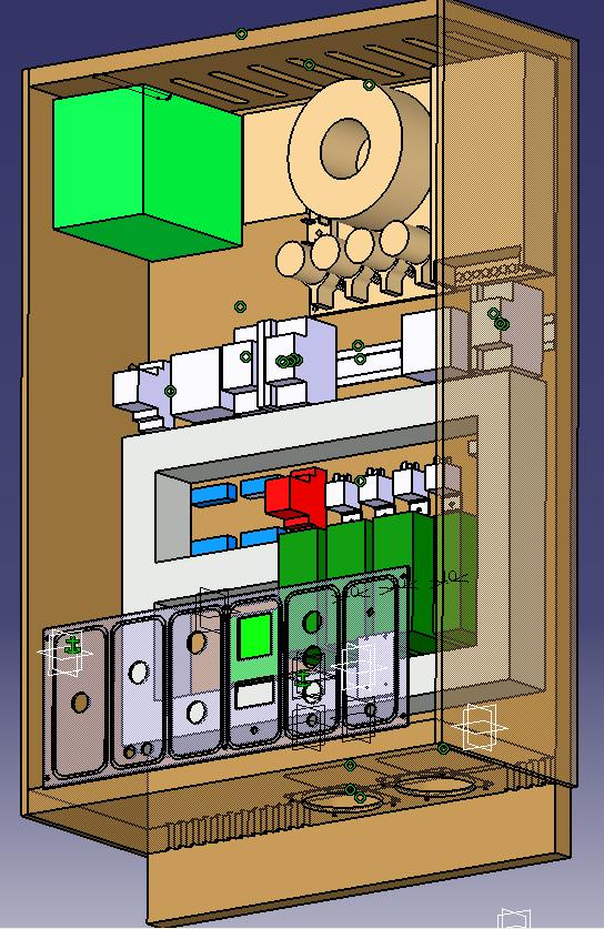

    Ok, good to know thank you. Gantry is pretty light and feedrates aren't that high.
    Capacitor mount brackets arrived today so roughly laid it out on the aluminium plate. Plate will be trimmed off just after caps, and before MCB.
    I noticed that the toroid 2x24V AC cables are a much heavier gauge than the 240V AC cables so I'll match that heavy gauge with the DC cable out of the rectifier and over the caps.

    It's a bit bigger than the blown SMPS it replaces but should still just about fit in the cabinet, top centre:

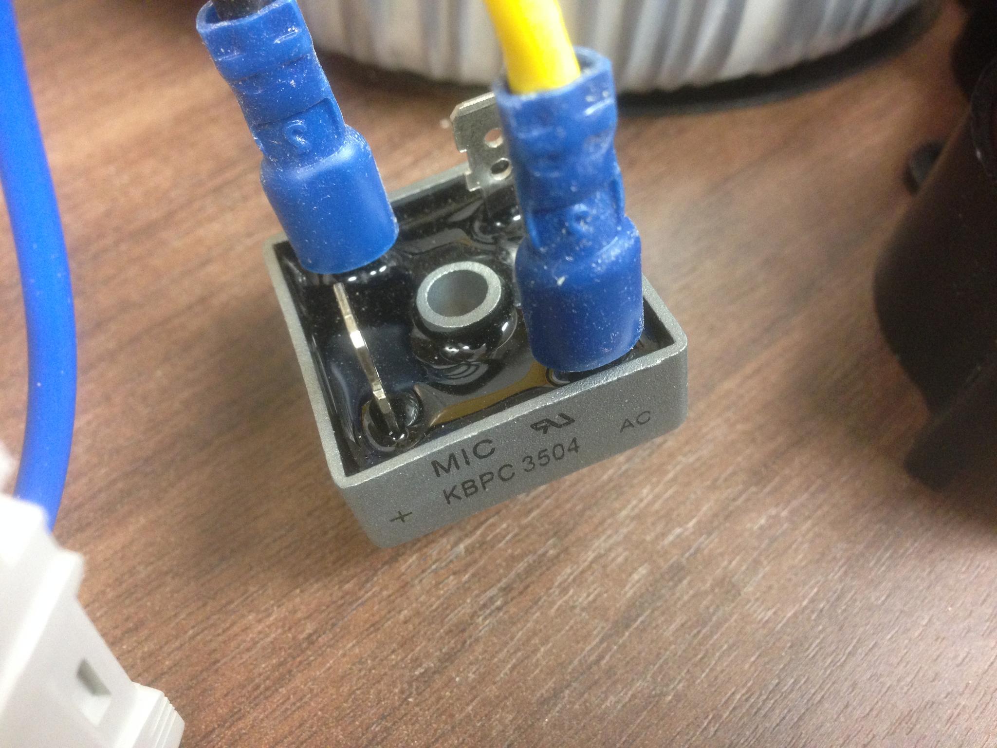

    Crimped terminal ends on the black and yellow cables for the rectifier. Had a look at the datasheet and the terminal rotated 90 degrees to the other 3 is the DC + output. Diagonally opposite this is the DC - output. The other 2 are AC inputs.

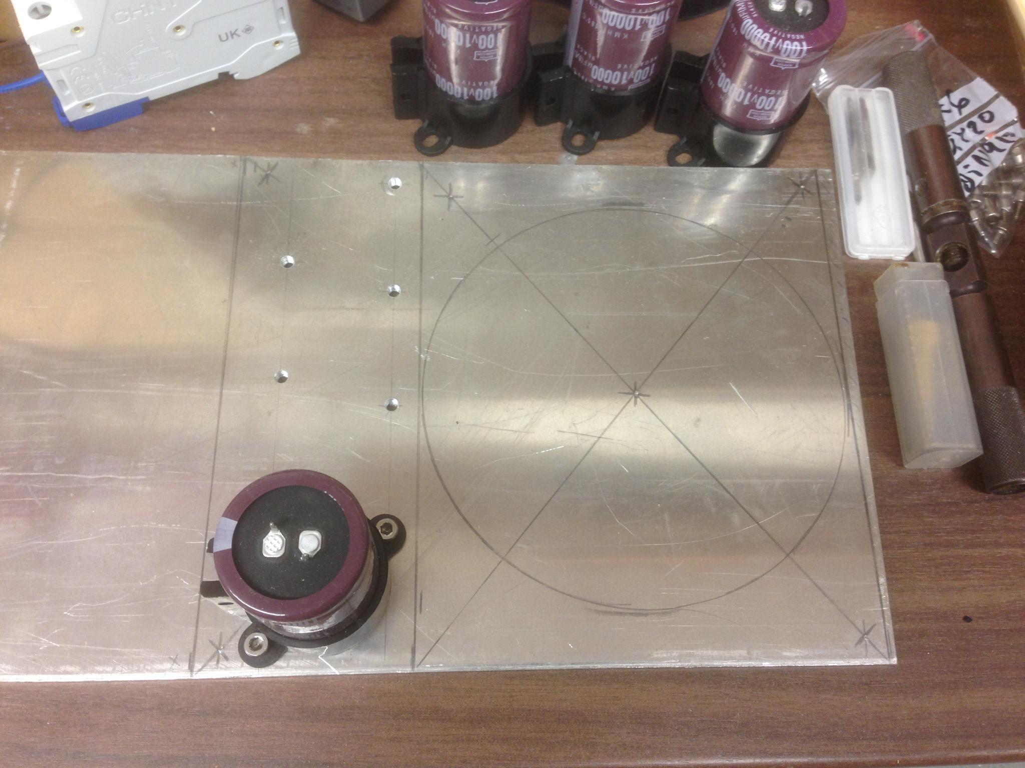

    Marked out the holes for the cap brackets, rectifier, toroid and corner bolts and started drilling a few out. Went with M4 tapped on the capacitor bolts. Getting there slowly . . .

    The MCB hasn't tripped out yet on the few times I've turned it on (6A type D) but since I haven't connected the capacitors yet that probably doesn't mean much.

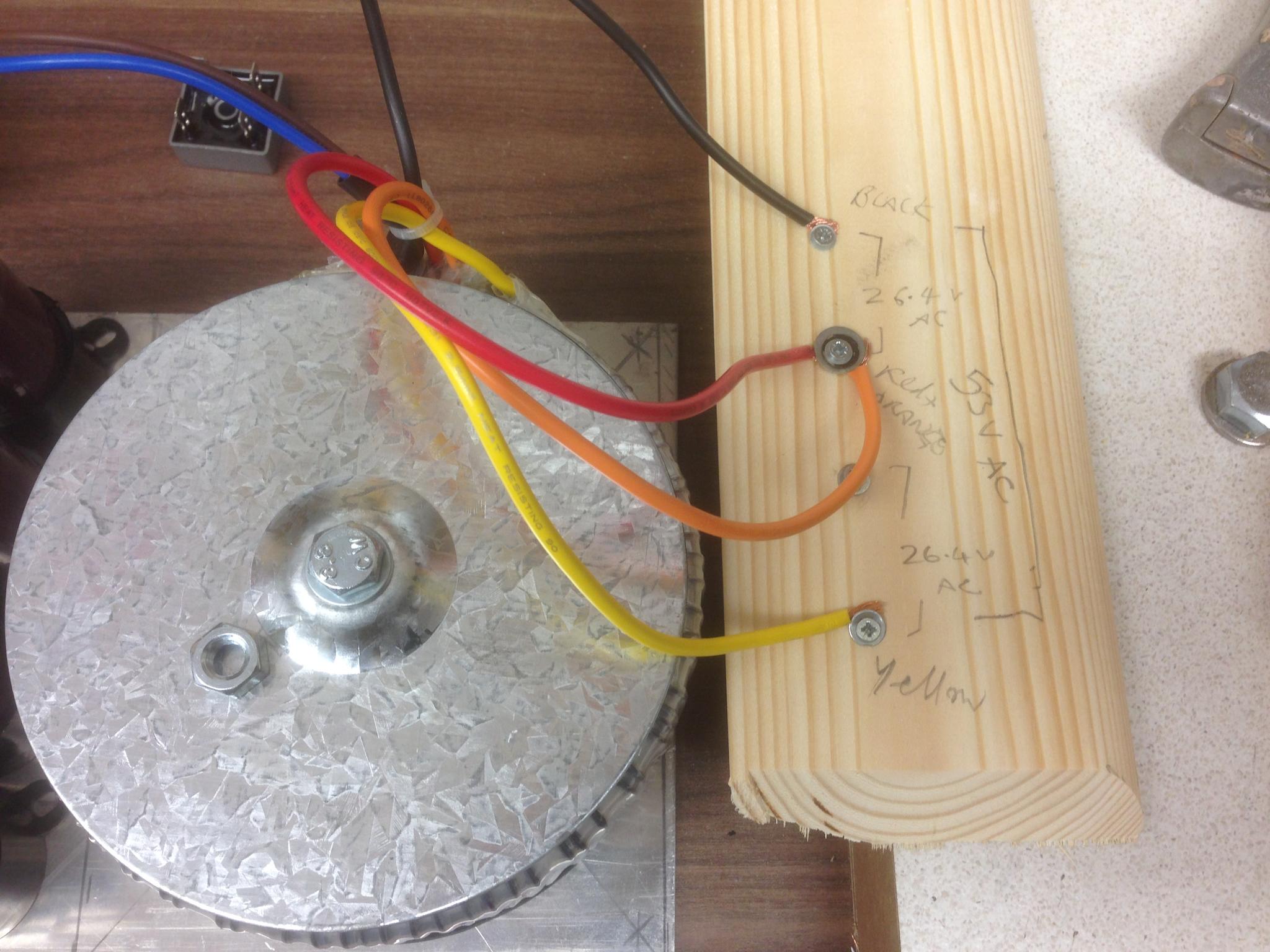

    This was the way I joined my transformer from the technical description on the airlink website...
    Neil...

    Doh! I've cut the red and Orange back quite short and soldered them together. Can someone tell me if it matters this way around instead of Neil's picture ?
  11. #60
    Doesn't matter.!
