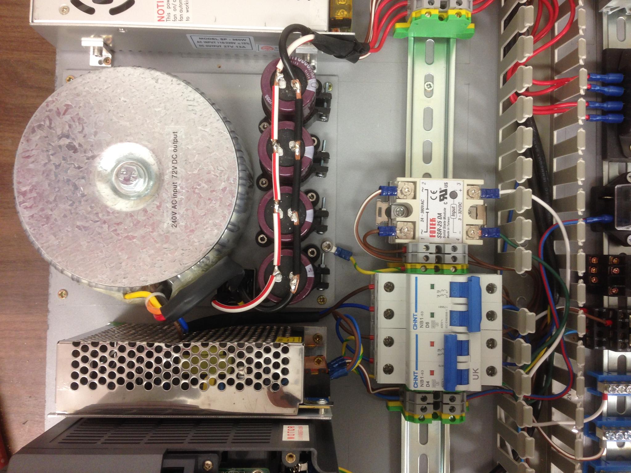

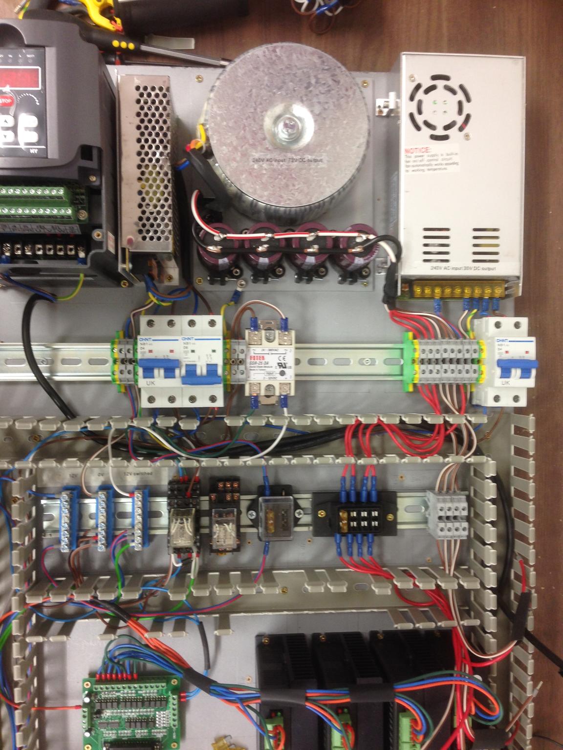

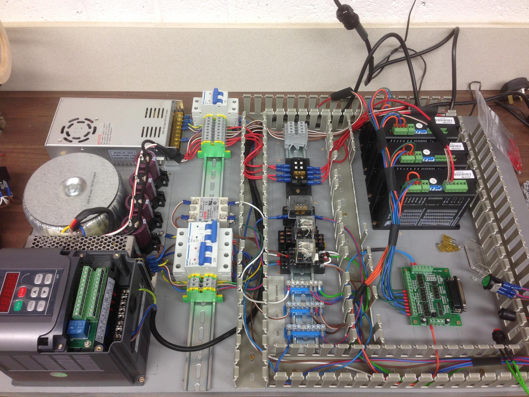

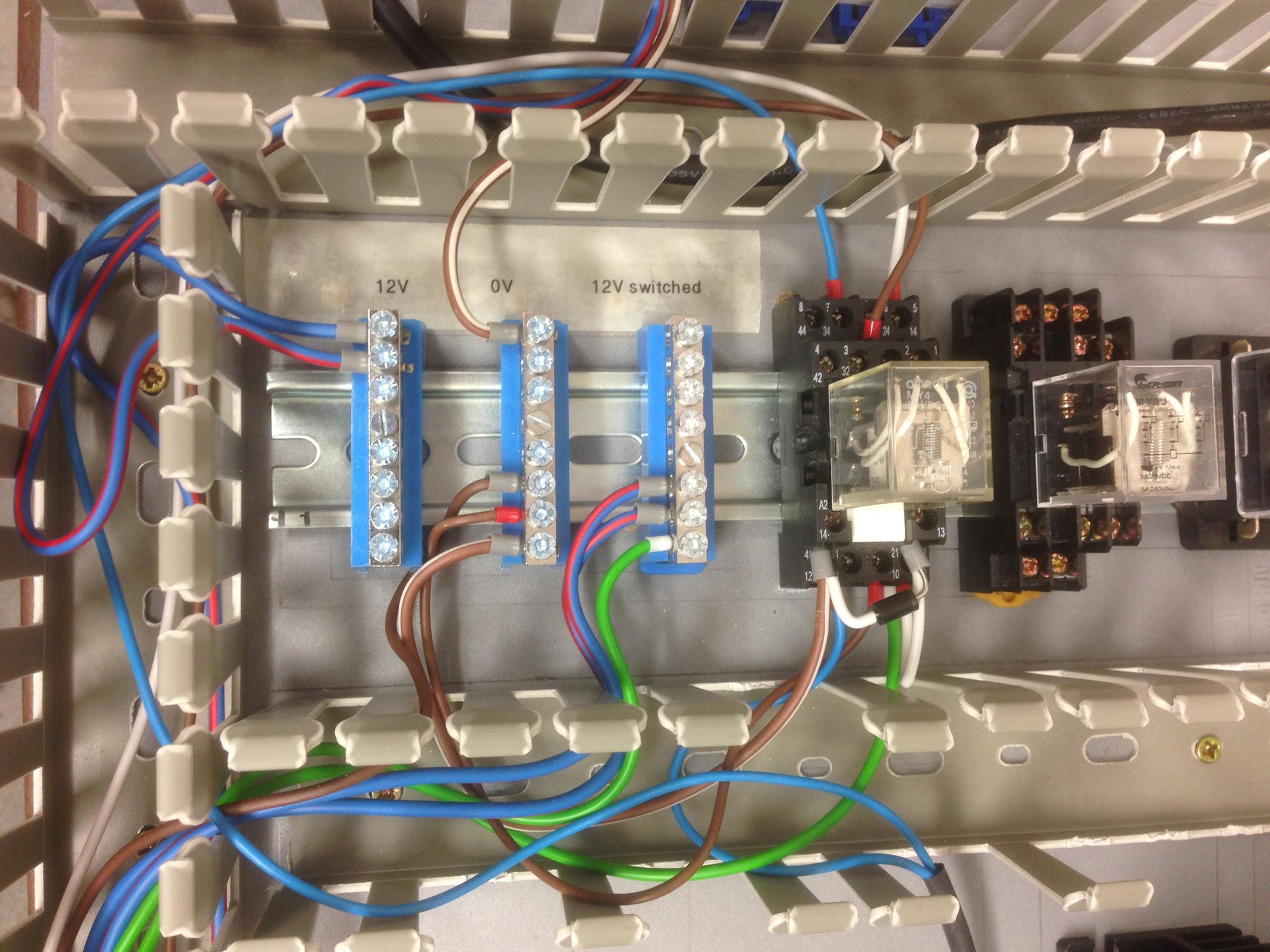

    For info here is where I got to using the SSR (small white square in the middle of the top DIN rail for those who don't use them):
    But since these pictures were taken I've removed the SSR because as mentioned above I don't think it works well with the transformer. If it had worked then I didn't plan on using a heat sink because the 25A rating was just to help it survive the unrush current (which is momentarily 100s or 1000s of amps), but then it should settle to a couple of amps (?) for normal running. But if you've got a heat sink then I guess there is no harm in using it anyway.
    New plan is to do what I should have done in the first place which is to run 24V DC control instead of 12V (as industry do) which means I can use a 24V DC contactor to switch the transformer and SMPS. The e-stop can then (through the relay) cut power to the drives in an emergency.
    The proximity switches are happy on 24V and if I ever upgrade to something like the CS labs unit this also uses 24V. Just waiting for all the new bits to arrive from China.
    At the moment I've laid the earth terminal blocks out to act as end stops/cover plates for the main grey terminals because in case you didn't know one end of each JXB4 terminal blocks is open so the last one in the row is 'exposed'. I've got some cover plates on order and when they arrive I can then cluster the earth terminals in the middle to make it as close to a star layout as possible.
    Also when the new relays arrive I plan to re-do the diode layout and run it through a terminal block instead of hanging out the back piggy backed onto an cable.

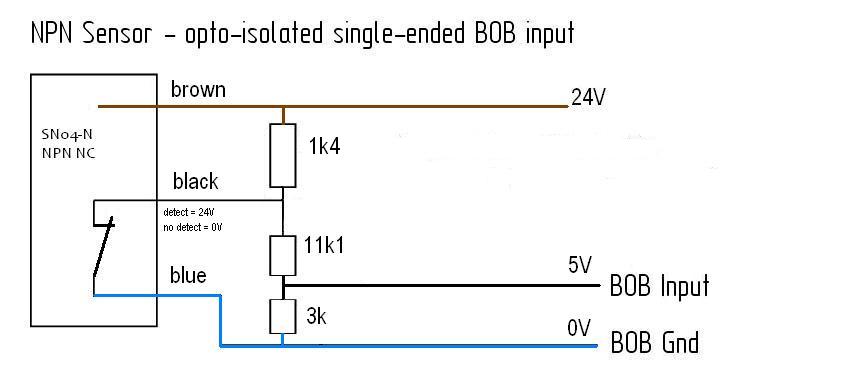

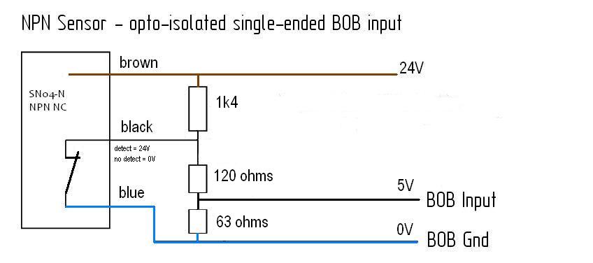

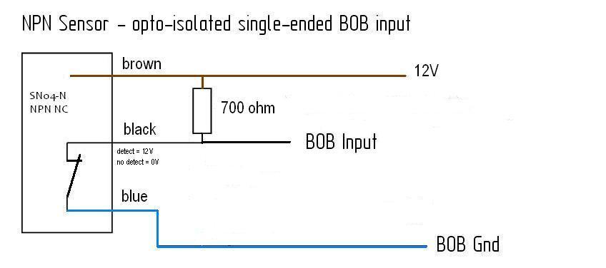

    Whilst waiting for the various bits to arrive I've turned my attention to the wiring I'll need for the proximity switches. I've kept this job until last as I knew there were going to be problems.
    The prox switches are SN04-N. Brown wire (10-30V) , blue wire (0V), black wire (signal NPN NC).
    I rigged one up on the bench (at 12V for now), with a 700ohm resistor between brown and black, then checked the voltage between black and blue. Got 12V or 0V when a metal plate was present or not.

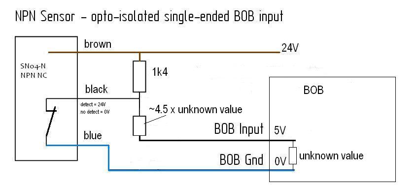

    All good, but my BOB is 5V inputs only. So I've thought about the options:
    1. Upgrade to 24V logic BOB ! Maybe when funds permit but not now
    2. Use a pair of resistors as voltage dividers
    I think can work out the ratios OK (top one ~4.5 times the bottom one, giving ~5V tap out in centre?)
    But what actual values to use to control the current into the BOB?
    What is the acceptable current into the BOB - I've seen a USB board quoted at 7mA . . .
    How do I calculate the current my resistor selection will allow into the BOB?
    I've got a feeling I need to know the resistor value inside the board . . .
    Here is a diagram I created showing one option (adapted from a great post by Irving long time ago):

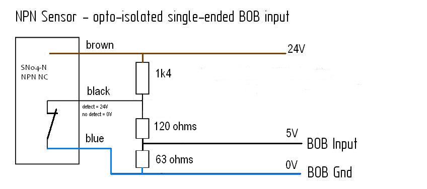

    Here is another option:

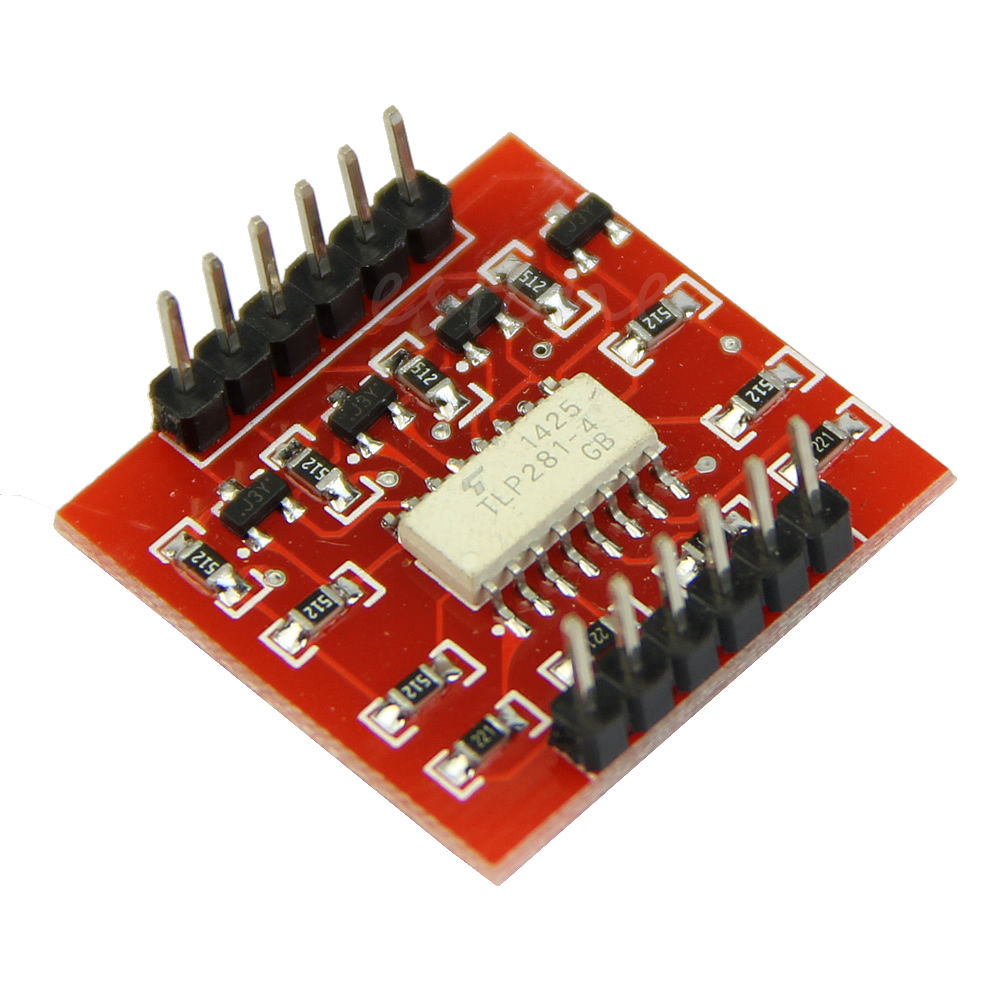

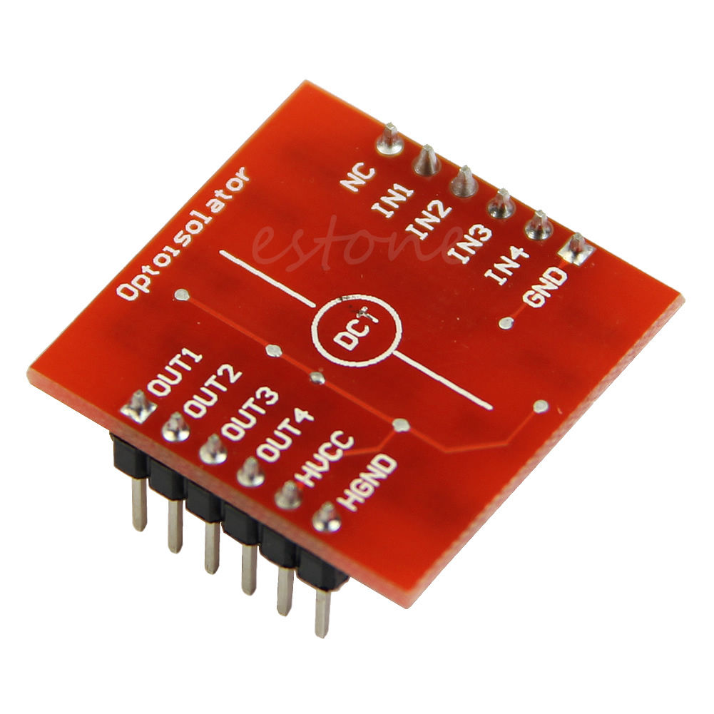

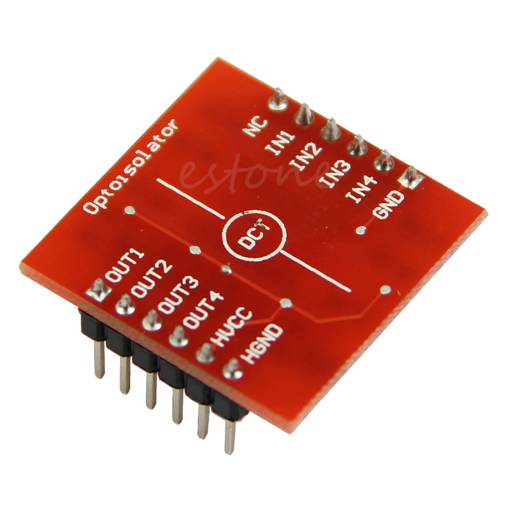

    3. Use an opto-coupler module
    I bought this out of curiosity (£1.32 all in) - just got to wait for it to arrive in a couple of weeks:
    http://www.ebay.co.uk/itm/3911024978...ht_5545wt_1109
    I asked the supplier about max input voltage and max output voltage but after several days no reply. In the advert they suggest an ideal use is using 3V systems to control 24V systems but I want to go the other way around.
    They sell sauce bottles, phones and underwear so I guess they don't make them themselves and probably have no idea!!
    Any thoughts on the above options and questions?
  9. #79
    The output of an NPN switch does not have to go to the supply voltage. There is no need for additional opto-couplers or voltage dividers. A NPN output is simply just a switch to 0V.
    Depending on the inputs to your BOB you have two simple options. If the input is connected to an opto-coupler then connect the anode to the BOB supply voltage (5V) and connect you proximity switch output to the cathode (may need to add a series resistor if BOB does not have one). If the BOB has a logic type input then simple connect the proximity switch output to the input. You may need to add a resistor between input and BOB supply (5V) if one does not already exist on the BOB.
  10. #80
    Quote Originally Posted by Graeme View Post
    The datasheet is a bit scant... I'd verify that there aren't any pull-up resistors attached to the output of that NPN switch (which would see the supply voltage on the output if the switch is in the open state)....therefore to test, just provide it with its supply voltage & see what voltage is on it output (if any)
