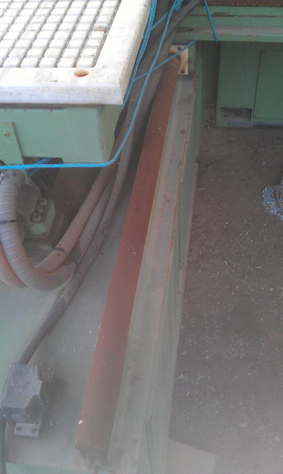

    Cheers, i was thinking the same, its a shame they did not store it inside, and i will have to strip down all the electric to make sure they are dry prior to powering it, everything apart from the drivers and controllers ( spindle, motors, barings, hydro connections and cnccontroller ), has been exposed to the elements for at least a few months.
    a upgrade of main parts is looking like 5-6k, and maybe 5 days.
    So will decide in morning, its still worth it for the right price
    so, will see what deal there is to be done tomorrow afternoon
    No maybe to it there will be more than any 5 days to compleltely retrofit, test and setup this thing and if you have no experience then maybe 5 weeks. . .Lol
    true, i ment 5 days for swapping over the parts and testing the electrics, testing and setup is another story.
    Its a weigh up at the mo over time costs in salvaging/servicing parts, over replacing/fitting them,

    well, i put a very good offer in and it was not acsepted, with them being scrap dealers not machine resellers, they have not realised it should have been kept inside, shame really, but the rails and baering and ballnuts have rusted, i would have took a risk with the electronics, but when absolutly everything needs replacing, its not worth it.
    If anyone else was considering this, you need to go look before you put in an offer because it does not look the same as it does in the photos,

  9. #29
ID:	11457hi just incase anyone was interested in buyin it, this are some of the pictures i took when i went to have a look, ITS NOT IN THE SAME CONDITION S IT LOOKS IN THE EBAY PHOTO, not by a long shot. its been left outside, shame
    really annoys me when sellers do this on ebay, i have more pics if anyone needs them
