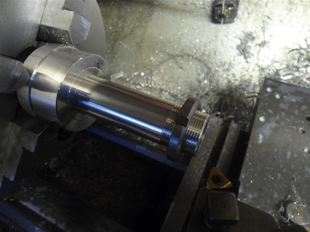

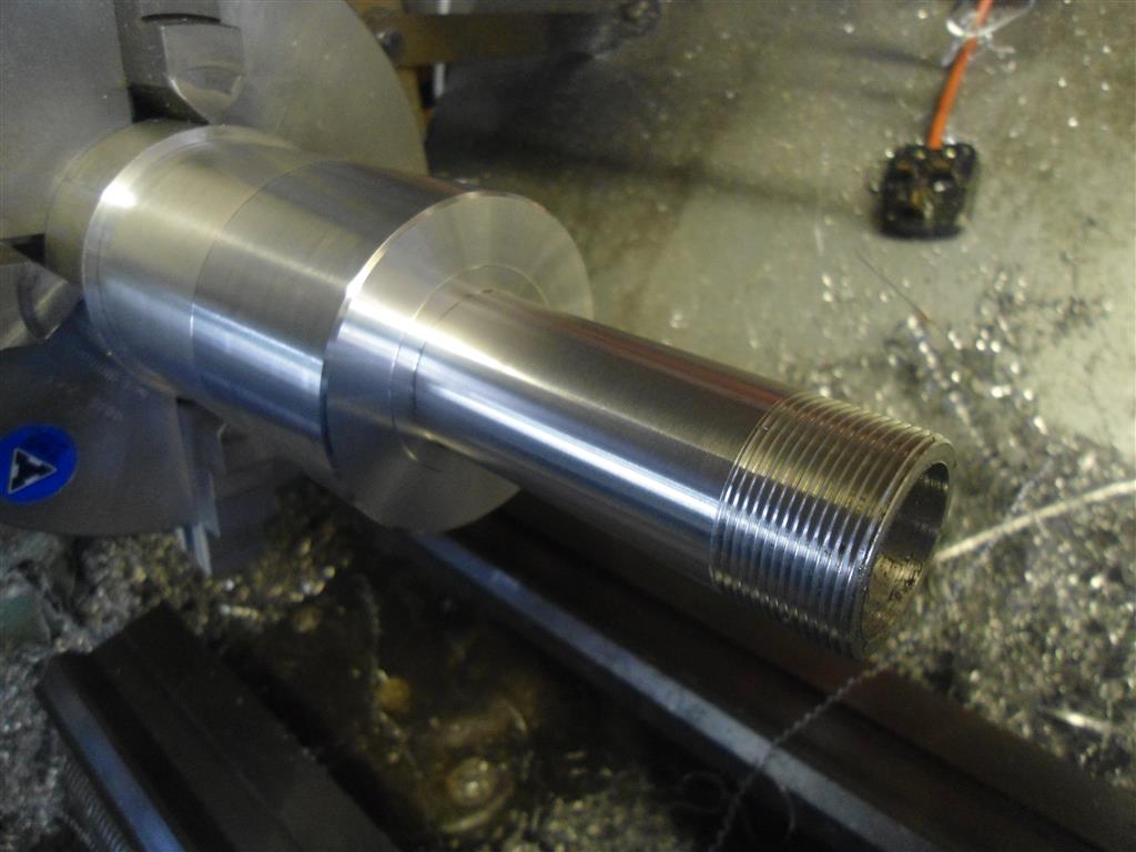

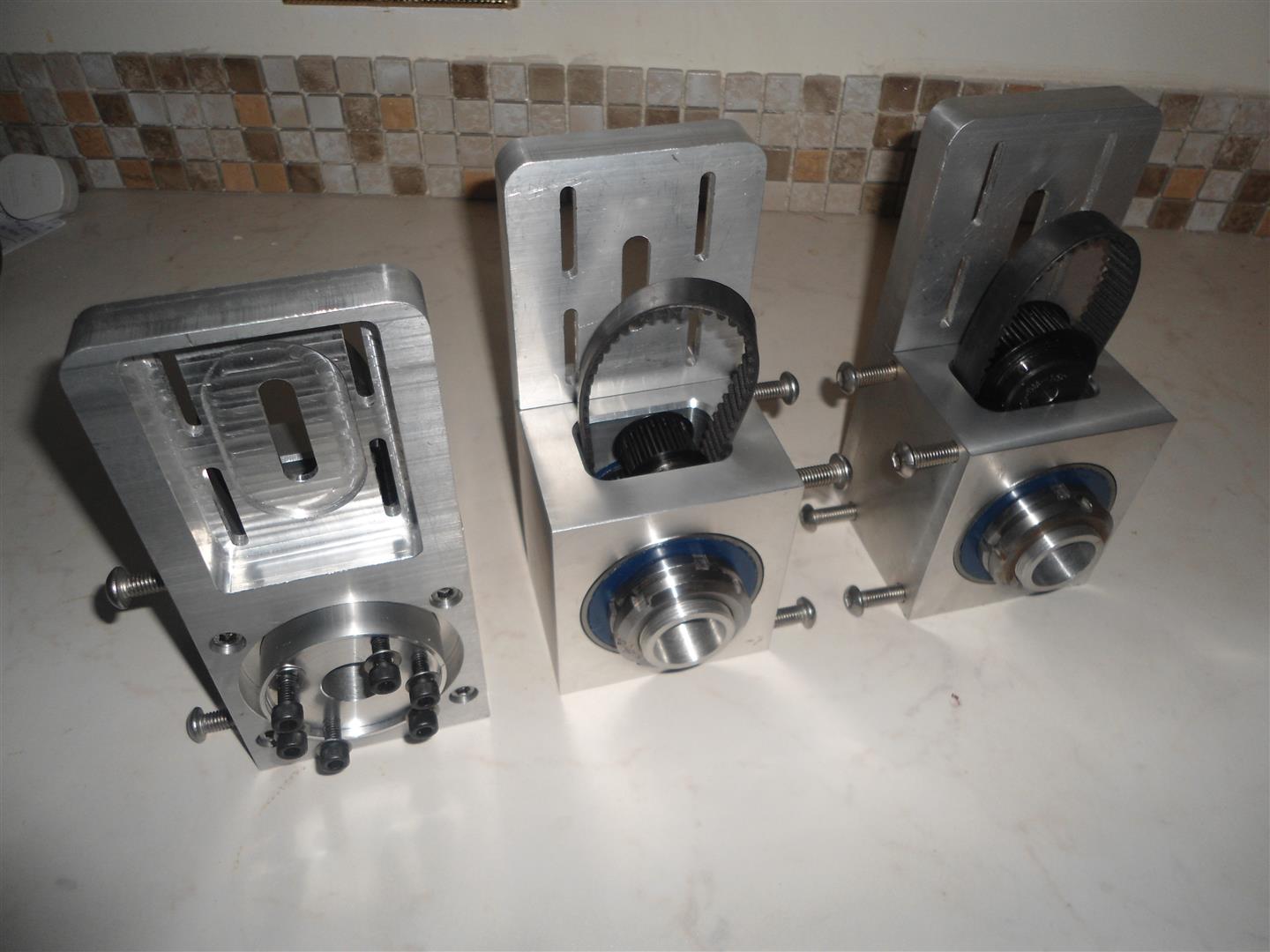

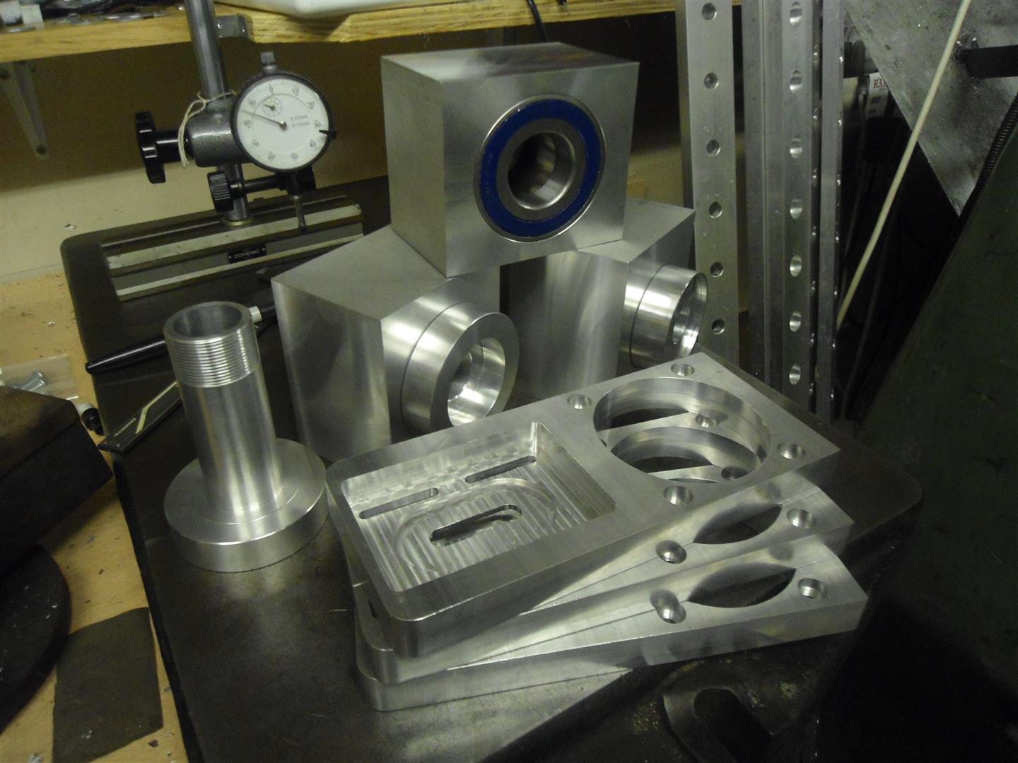

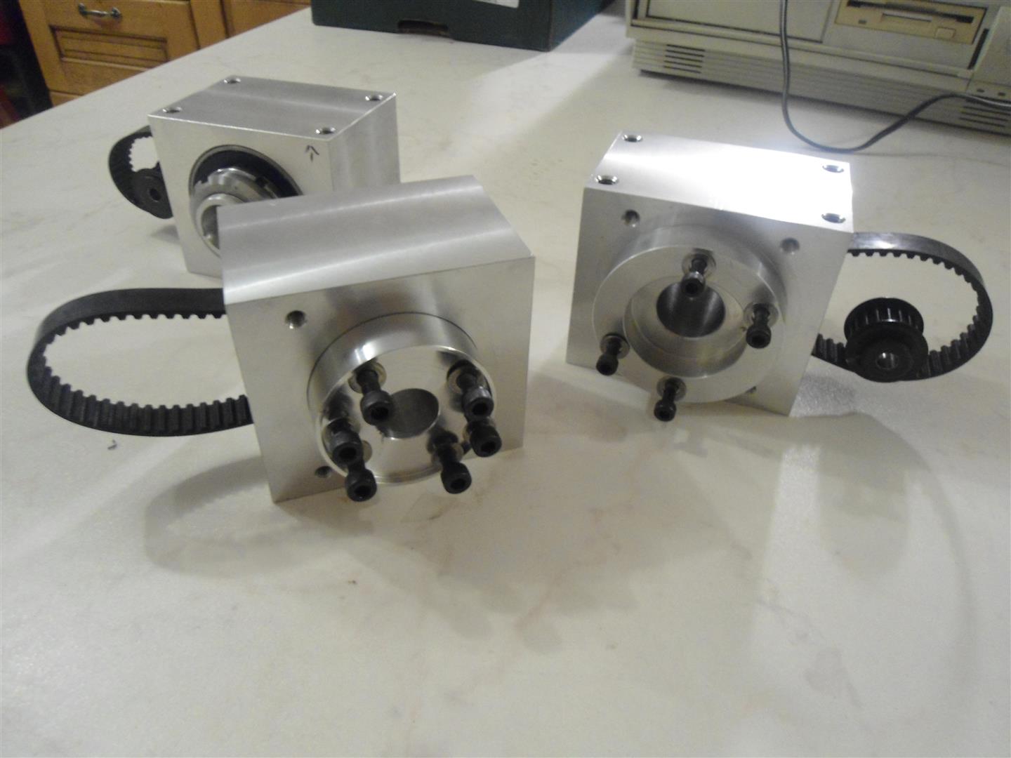

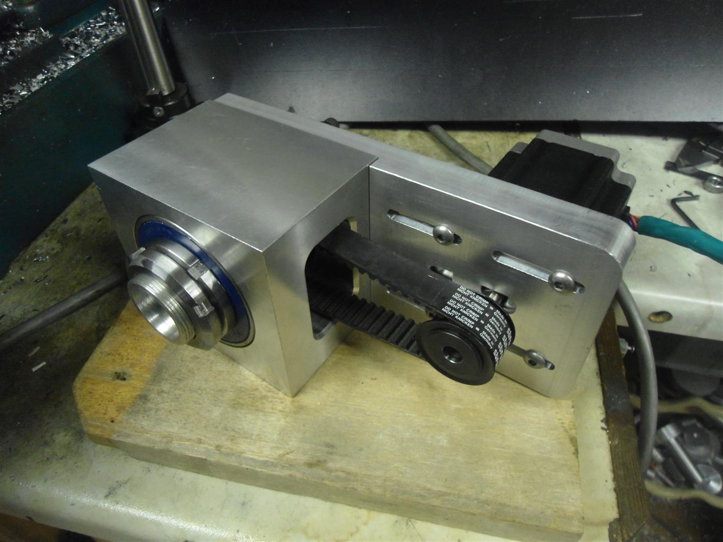

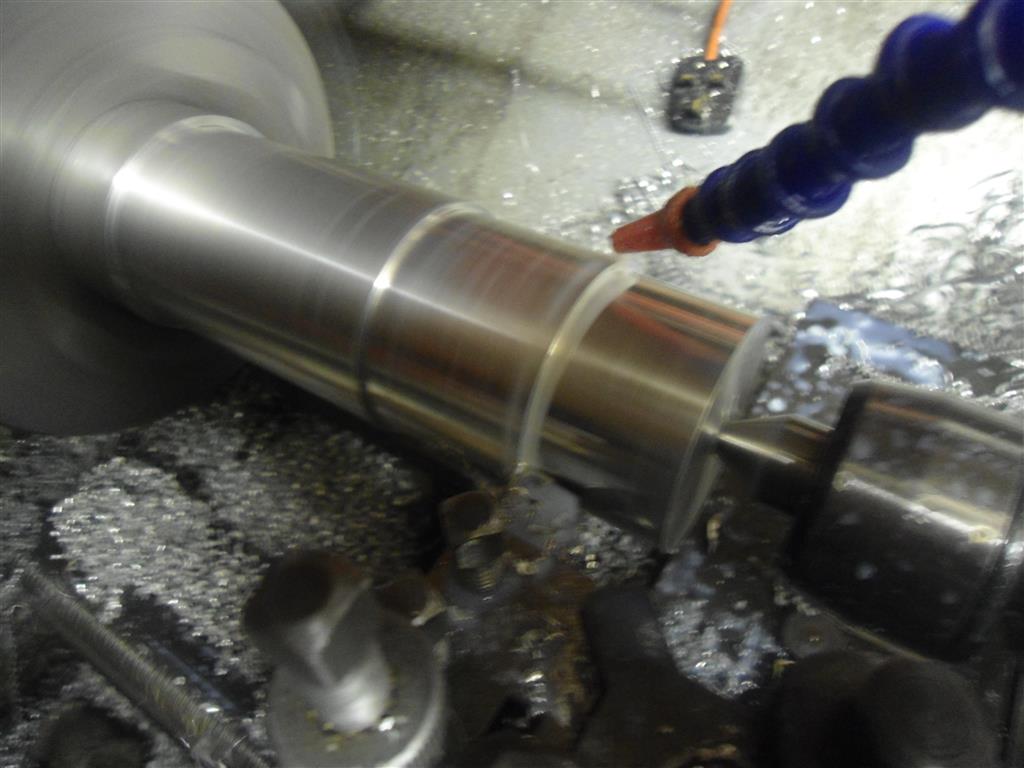

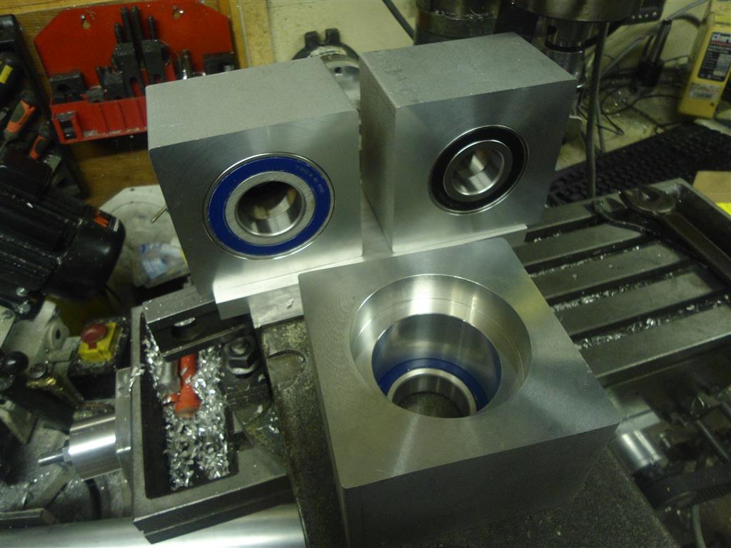

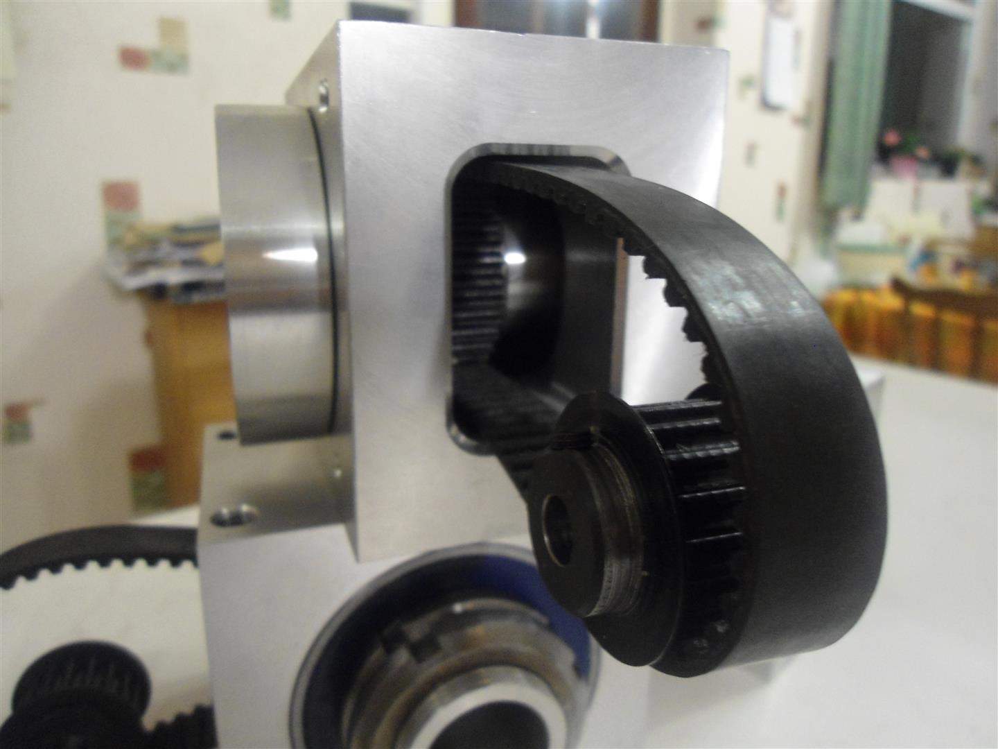

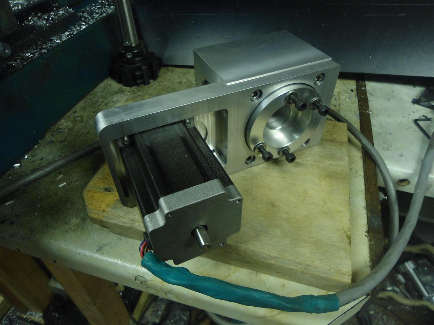

    I've just finished making three more rotating nut mounts for someone who spotted the video on YouTube who's making a large machine with two SFE2525 ballscrews and one SFU2010 ballscrew. I simplified the design by changing the housing for a block machined from 4" square aluminium bar, and a separate piece cut on my router for the motor mount.
    Some pictures:
    Attachment 10994Attachment 10995Attachment 10996Attachment 10997Attachment 10998Attachment 10999Attachment 11000Attachment 11001Attachment 11002Attachment 11003
    A video, feedrate displayed assumes connection to 25mm pitch ballscrew:

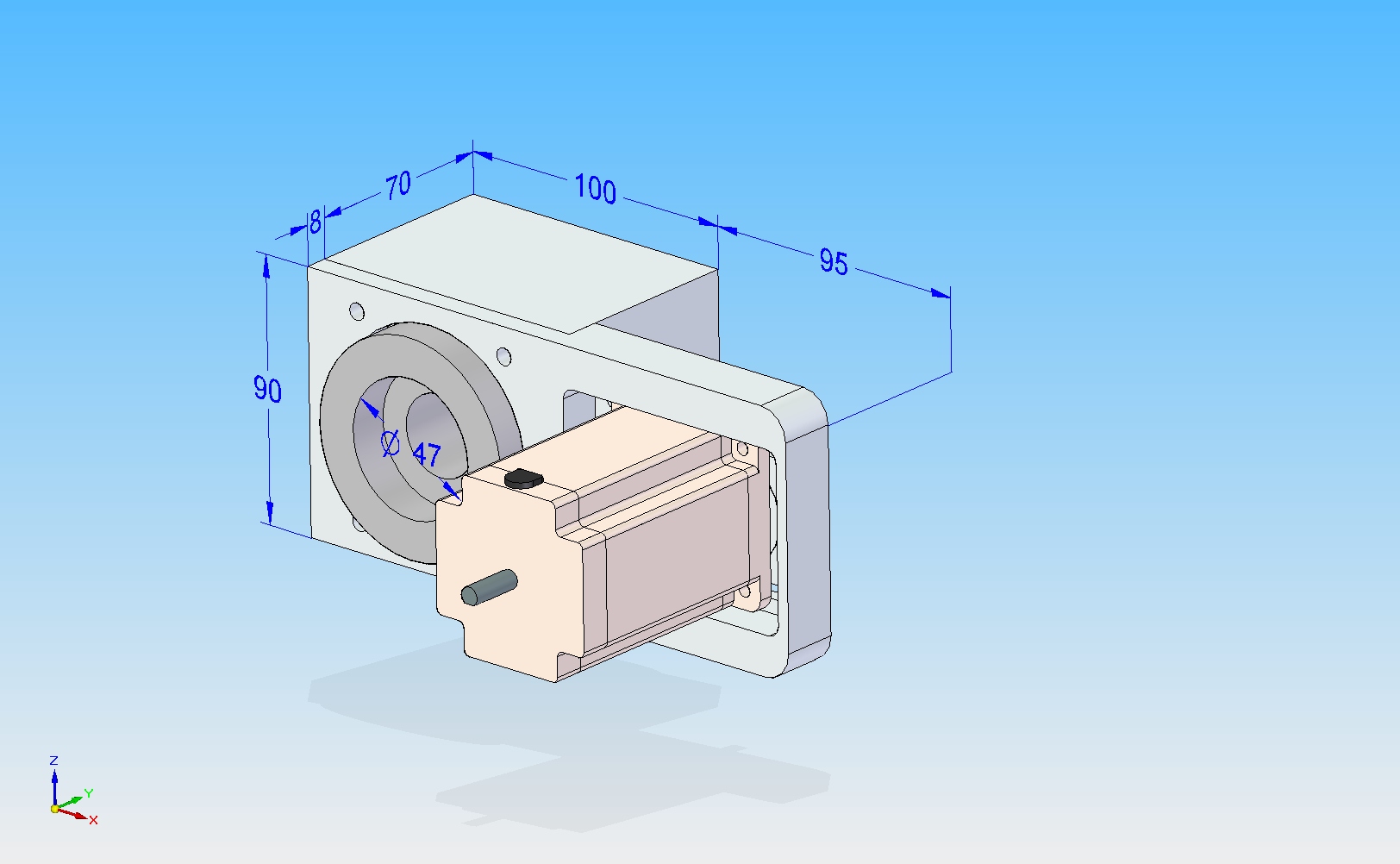

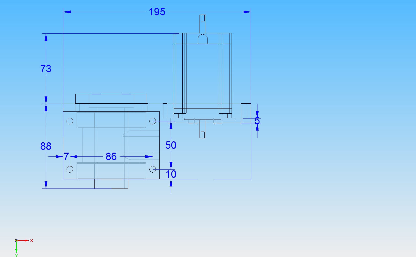

    Drawings:
    Attachment 11004Attachment 11005
    Attachment 11006
    Feel free to copy or modify the drawings and use them to make your own or get the parts machined by your favorite company... I don't mind.
