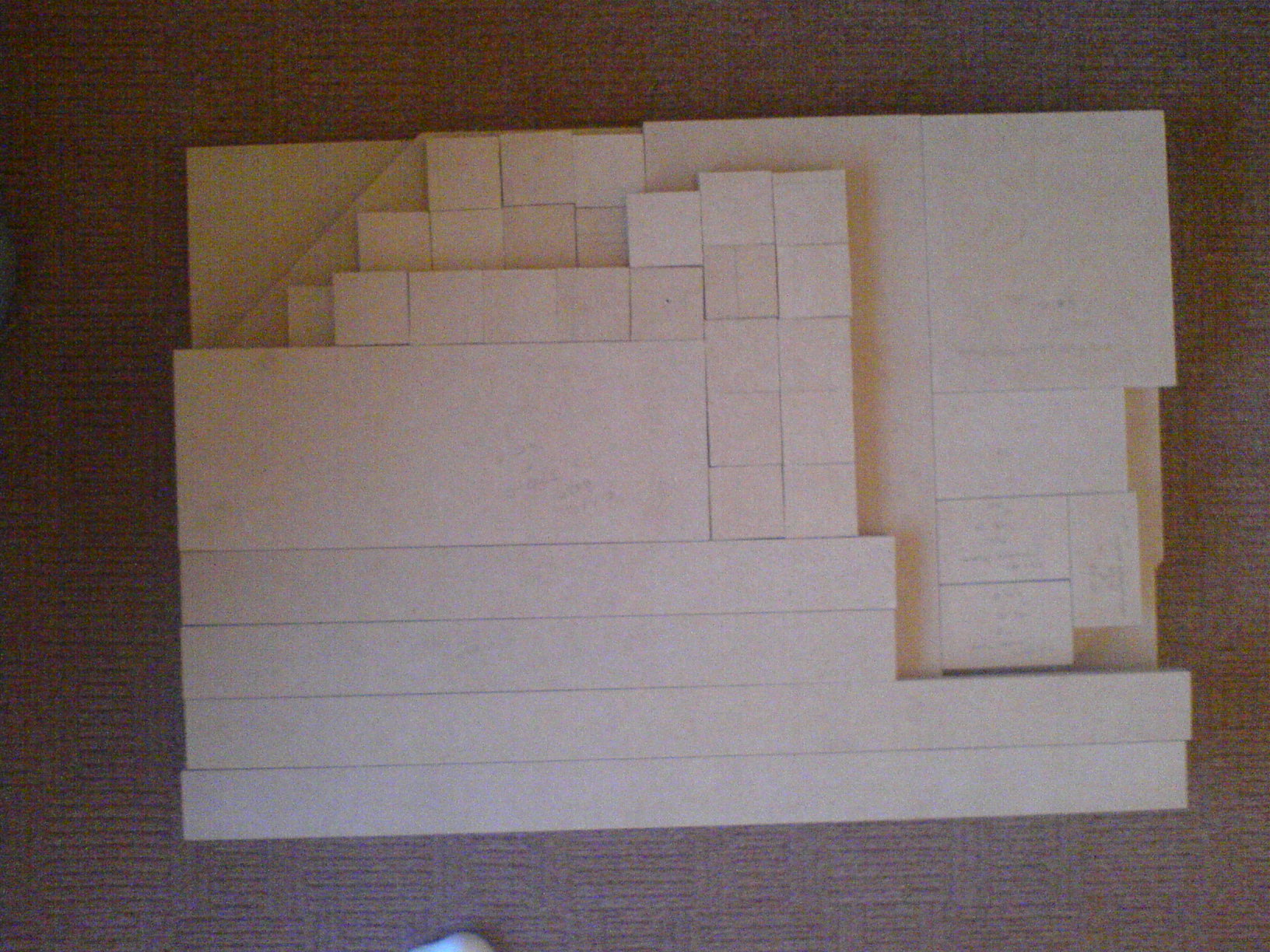

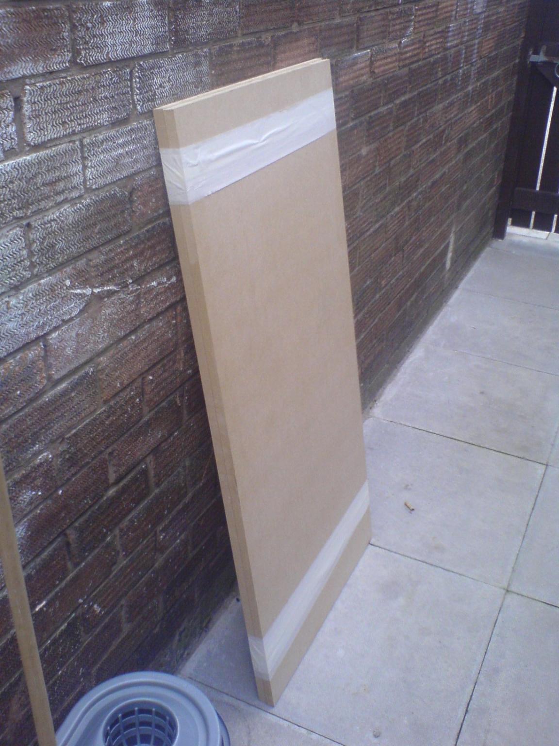

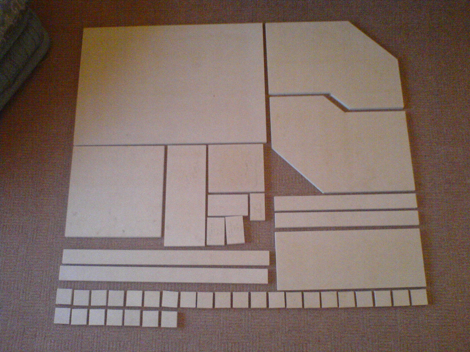

    Today i started my very own rockcliff machine cnc router build, so far i have cut all the parts from MDF.
    I only have basic hand tools, so should be intresting to see how i get on.
    Below is some pics of the parts all cut ready for the next stage, next i will be drilling each part with pilot holes ready for assembly and so on. The rockcliff machine can be simply glued, however i will be using wood screws for mine. The guys over at rockcliff have now also updated the plans to use screws and consider it a good move.

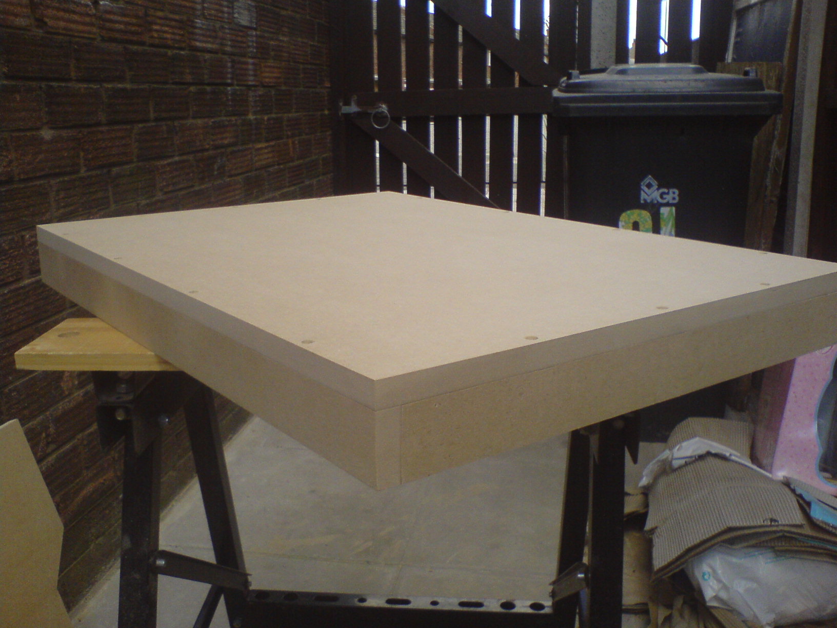

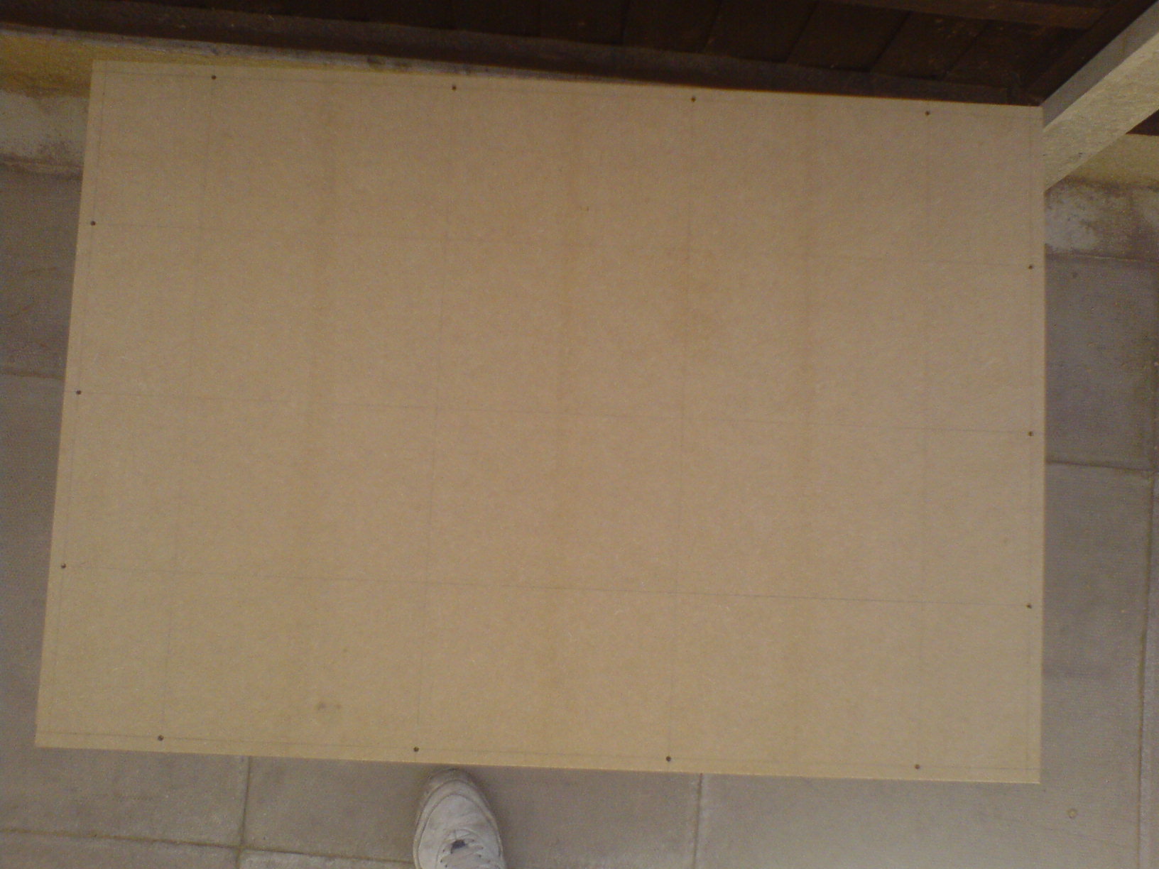

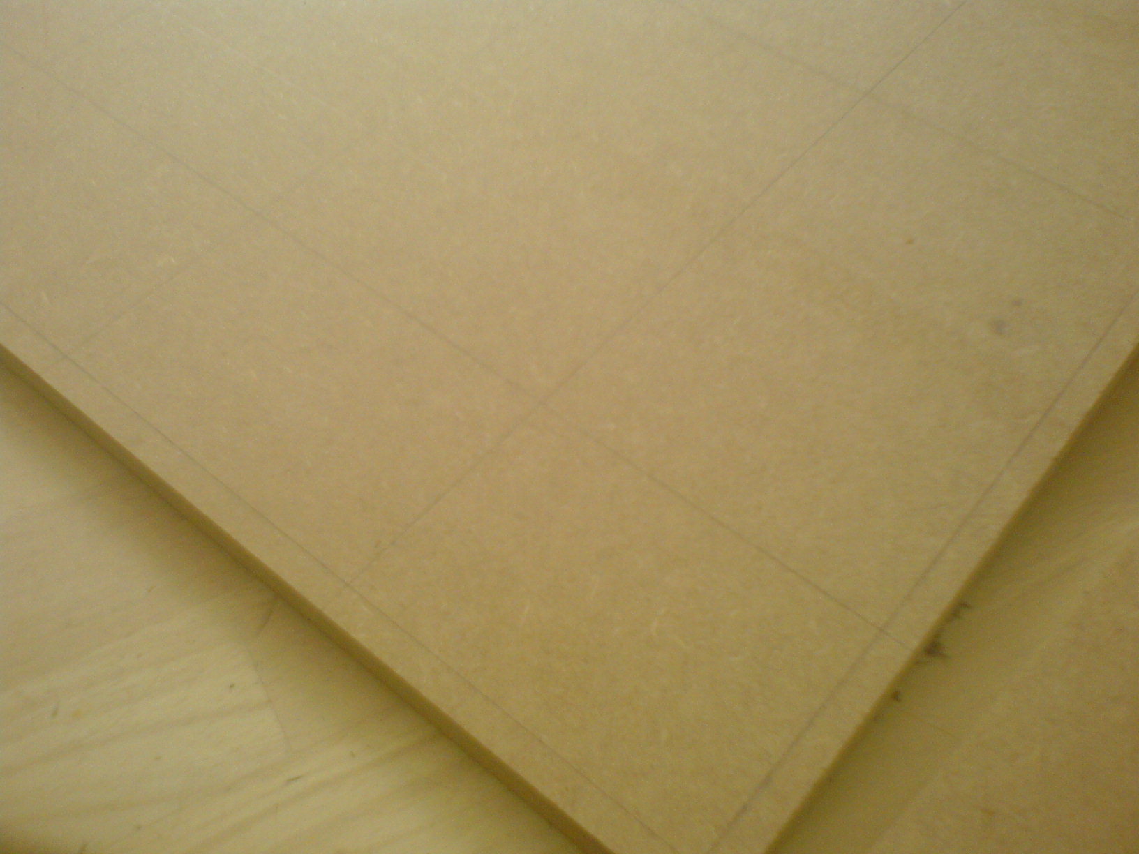

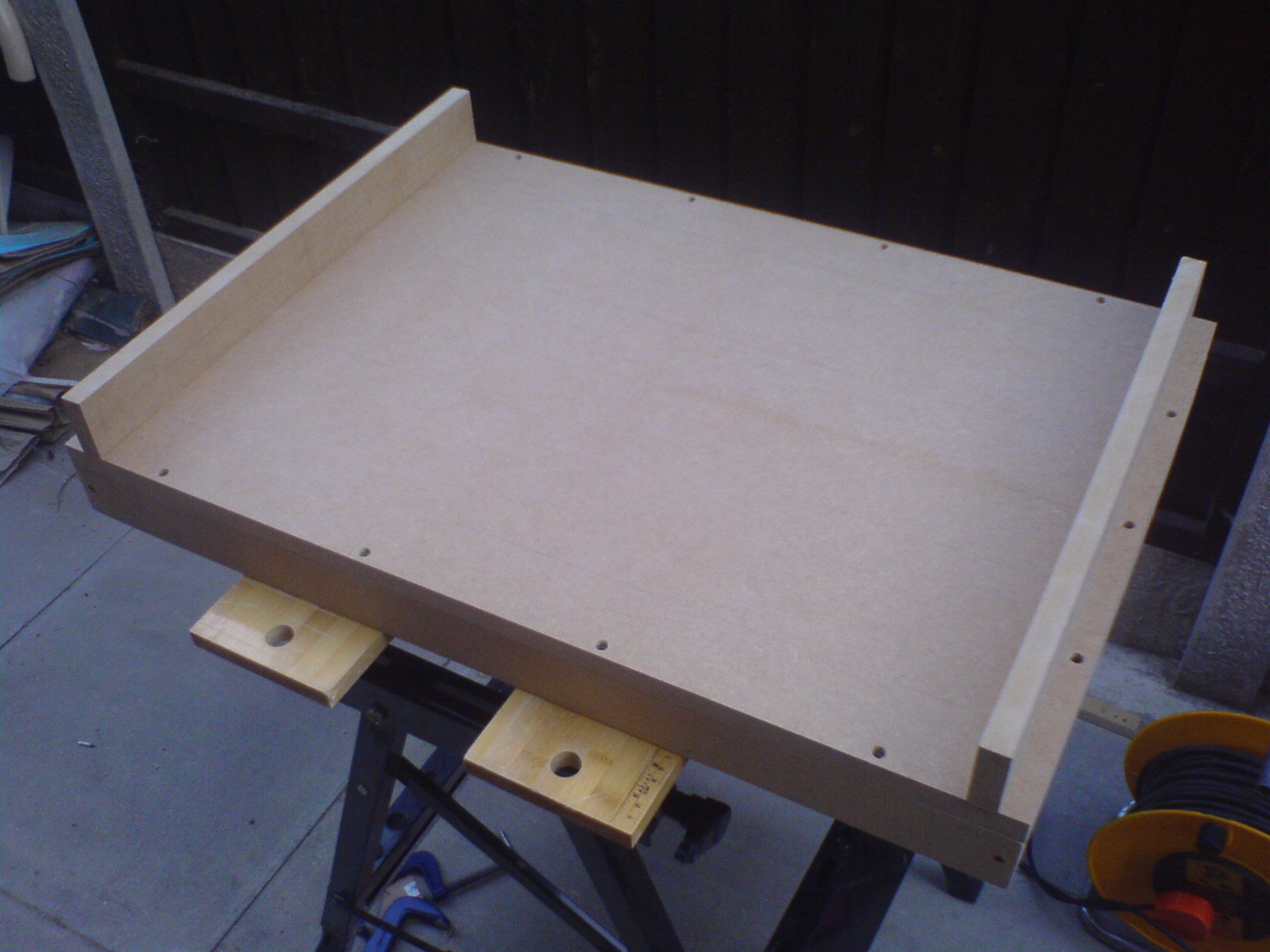

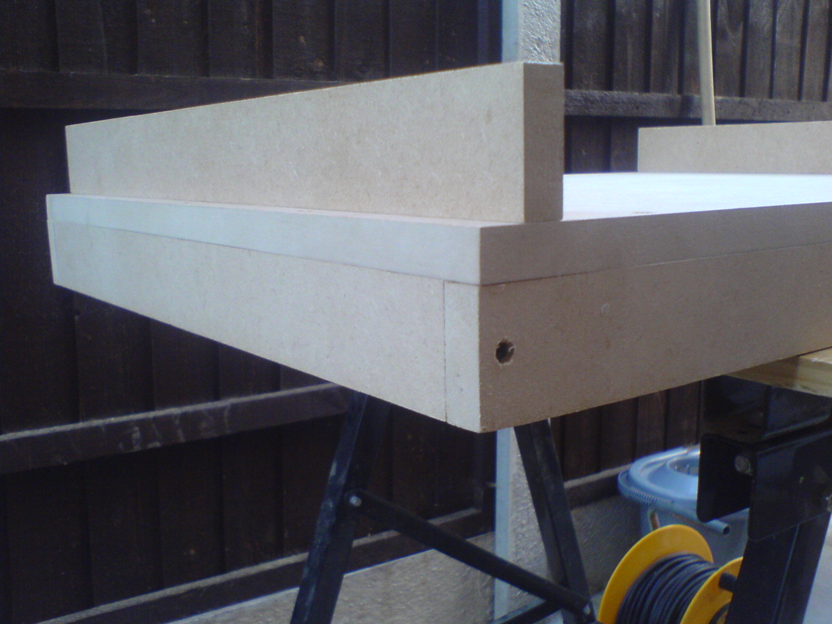

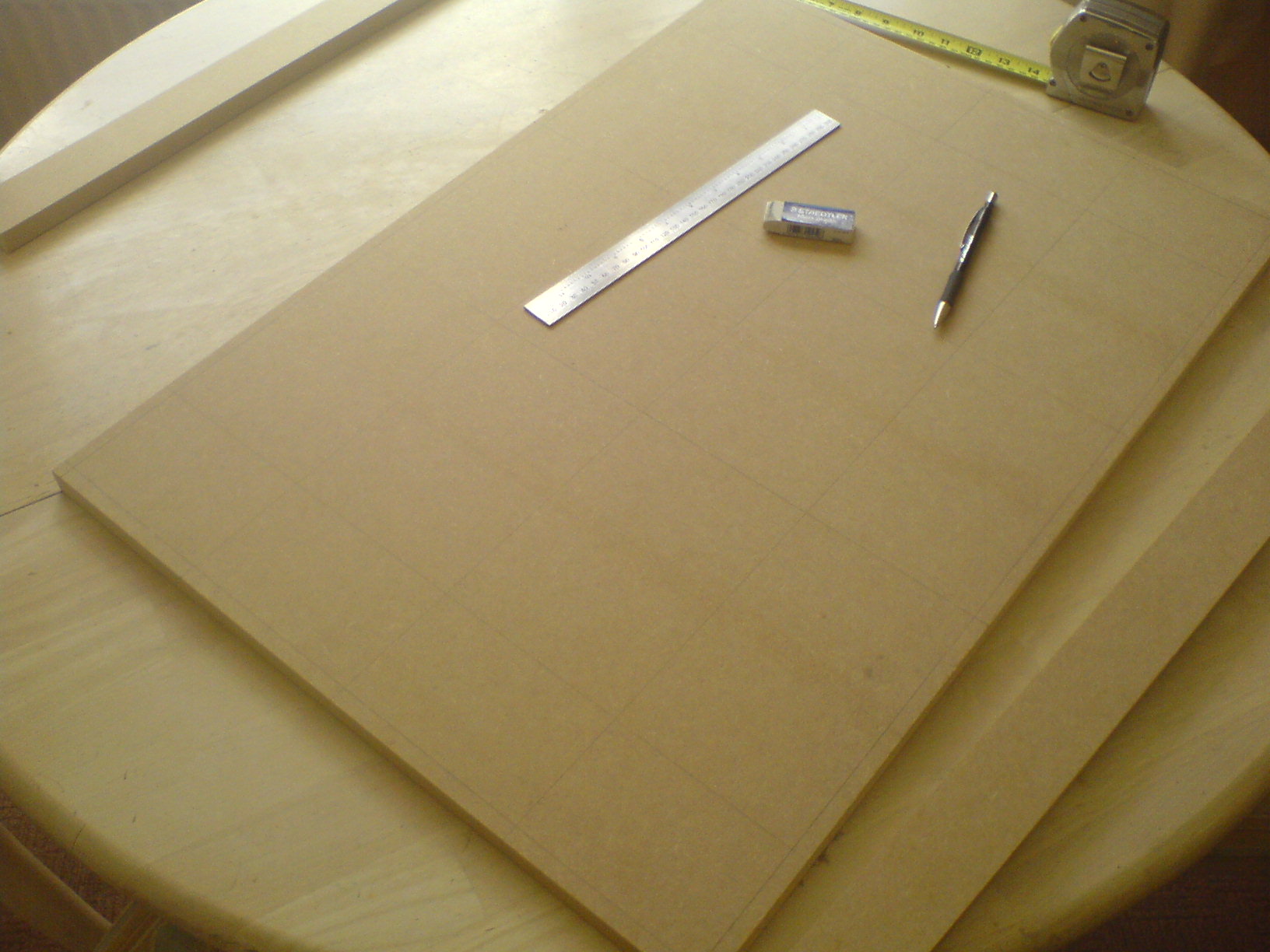

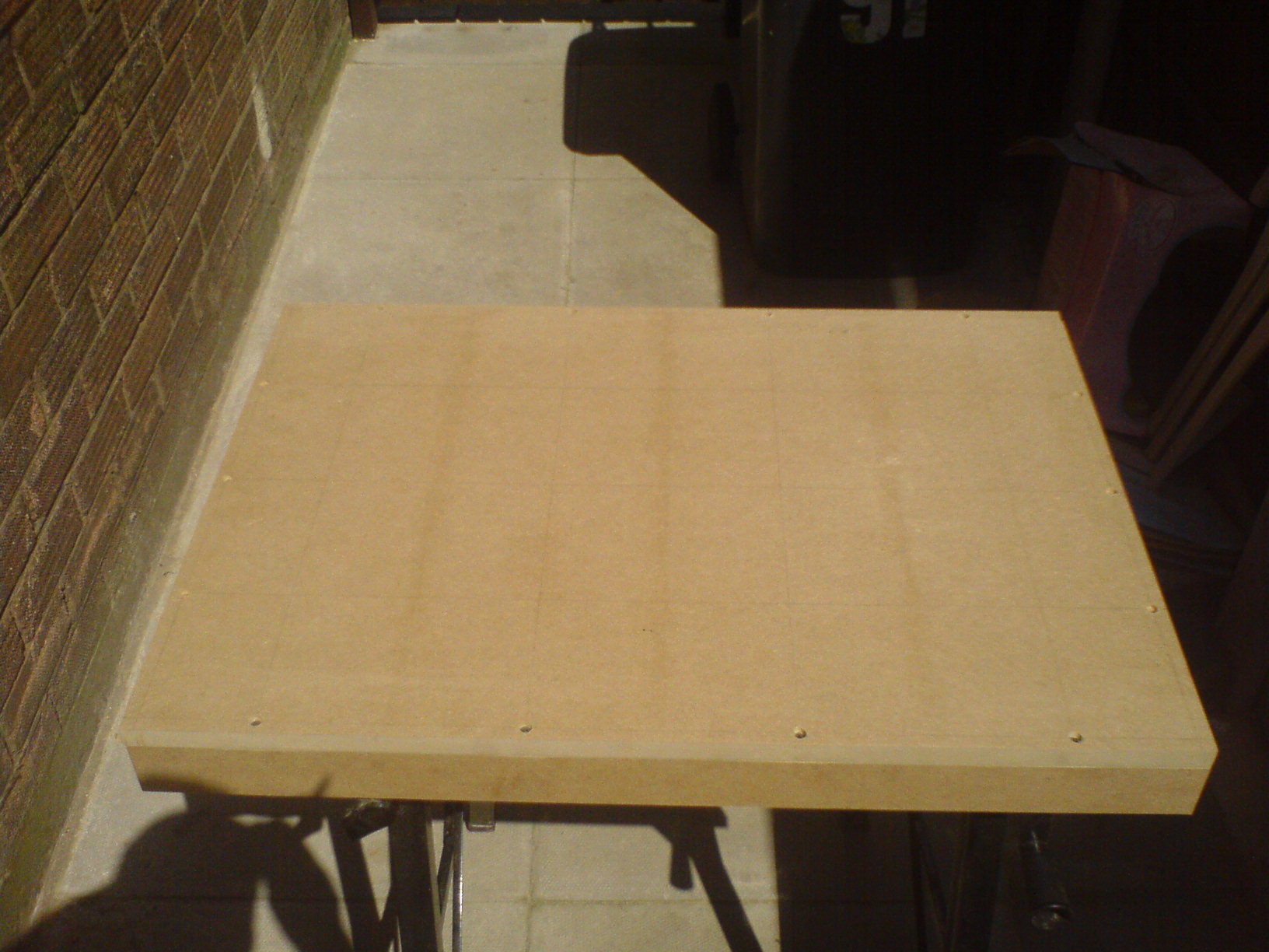

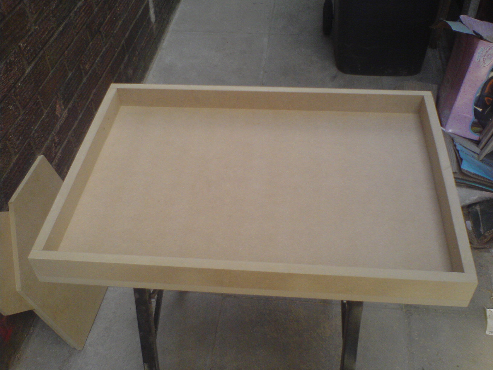

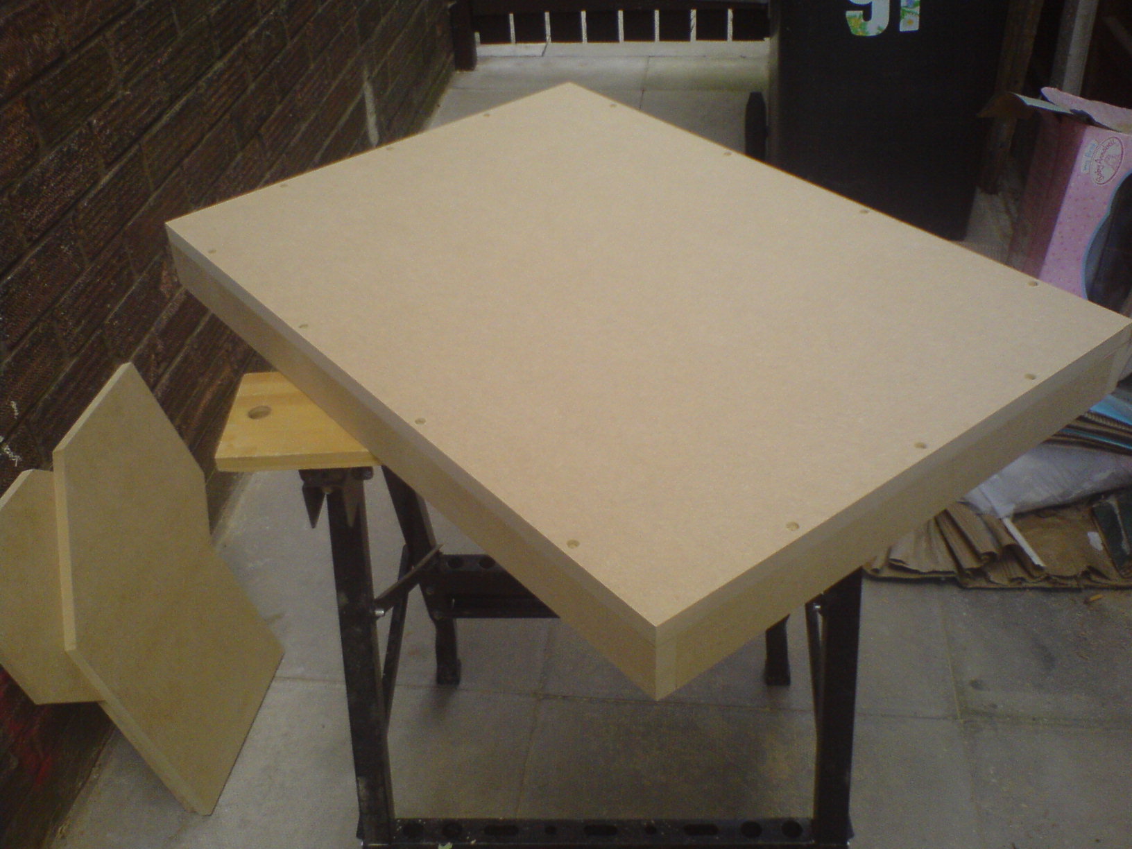

    ok so I got the base all marked up and drilled ready for assembly, I have also built the base ready for the next stage (see picks).
    You can see from the picks that I have marked out all my drill points and then drilled them, we have also used a bigger drill bit to skink the screw heads (5mm) this will help when we come to place other parts over the top of the screw heads and is a must really if you’re looking to do the same and use screws on your build.
    There is the option then to also fill the holes if you would prefer a flushed finish. (I may do this at the end of the build, not too sure yet :)) With the screws giving such a good hold we have decided not to glue unless we have to, this will help if I do need to disassemble the machine for let’s say relocation or a paint finish.
    Again it is advised that you pre-dill your screw holes as the MDF will have the tendency to split and this isn't really any good. Once everything was screwed together I gave all the edges a good sanding down just to flush everything off that little bit (see picks).
    The screws I have used are Fermacell Cross-Slot Screws 3.9 x 30mm; you can buy these from places like jewson.co.uk or travisperkins.co.uk. Most other wood screws would do a good job, I just happened to have a box of these in stock and found them to work well with MDF, they are designed to be used for Dry Lining.
    I have also added to the base, two additional TABLE SUPPORT PLATE's these are not really a must I just decided I would add these to the design to give that little bit more rigidity and surface contact. I used additional MDF for making the extra table support plates. (see picks)
    Well that’s it for now onto the next stage, if I was to build the base again I would more than likely mitre all the joints on the base and maybe add a 3rd table support plate in the middle of the base.

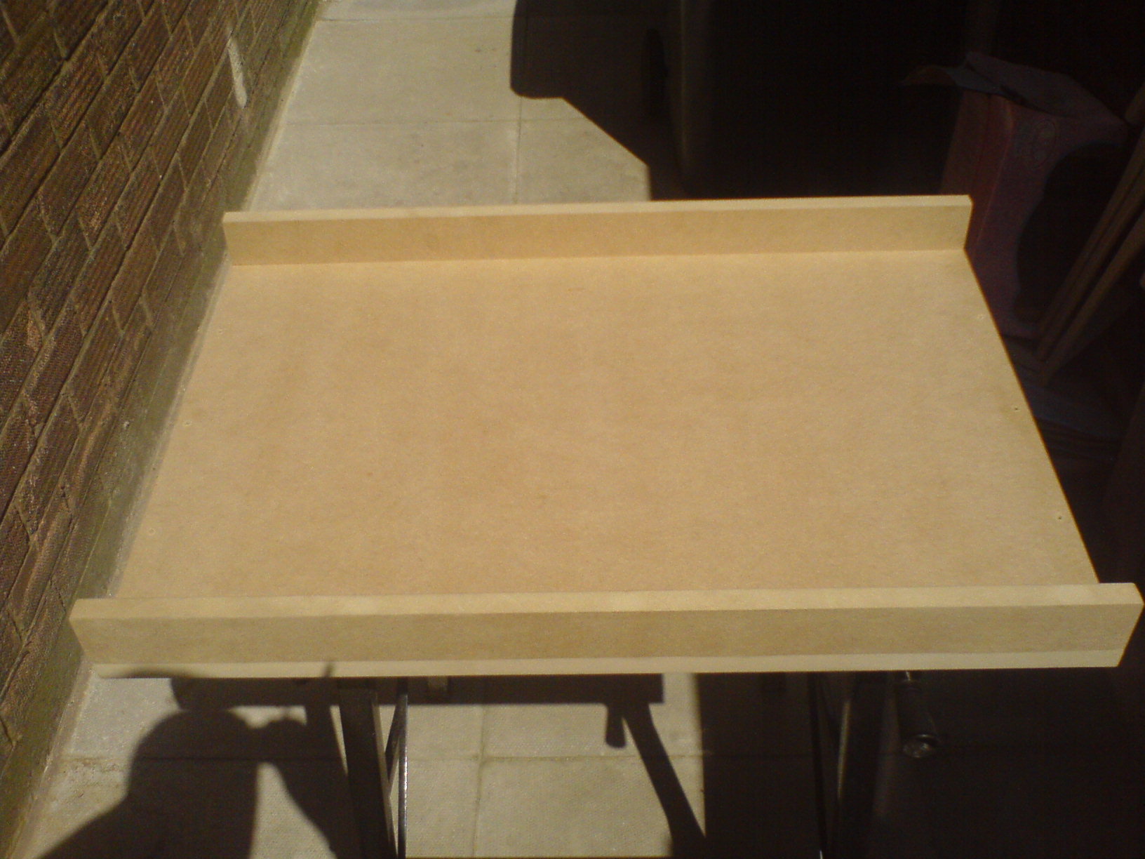

    Ok well today was a busy one for me so I didn’t really get much done today, I did manage to get something done however.
    Today I realized I have misplaced my spade wood bits in a recent house move so I’ve now ordered some new ones and they should be with me soon enough, I got some in a nice wood box to help keep them together for one and as I like to look after my stuff (lol yea right, is that why you’ve lost your others?!).
    Anyway moving on, here you can see I’ve fitted my Y-Axis Rod End Support Plates. If your building this machine or using MDF for your build I cant stress enough that you should use screws as well, be sure not to over tighten your screws as I found out today one too many turns equals a split in your work piece. I’ve also added side screws to my Table Support plates.

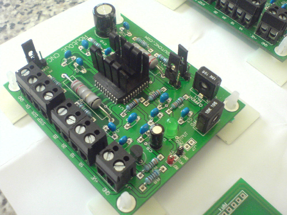

    Yea fair point about rockcliff! I’ve decided to buy already built drivers now anyway.

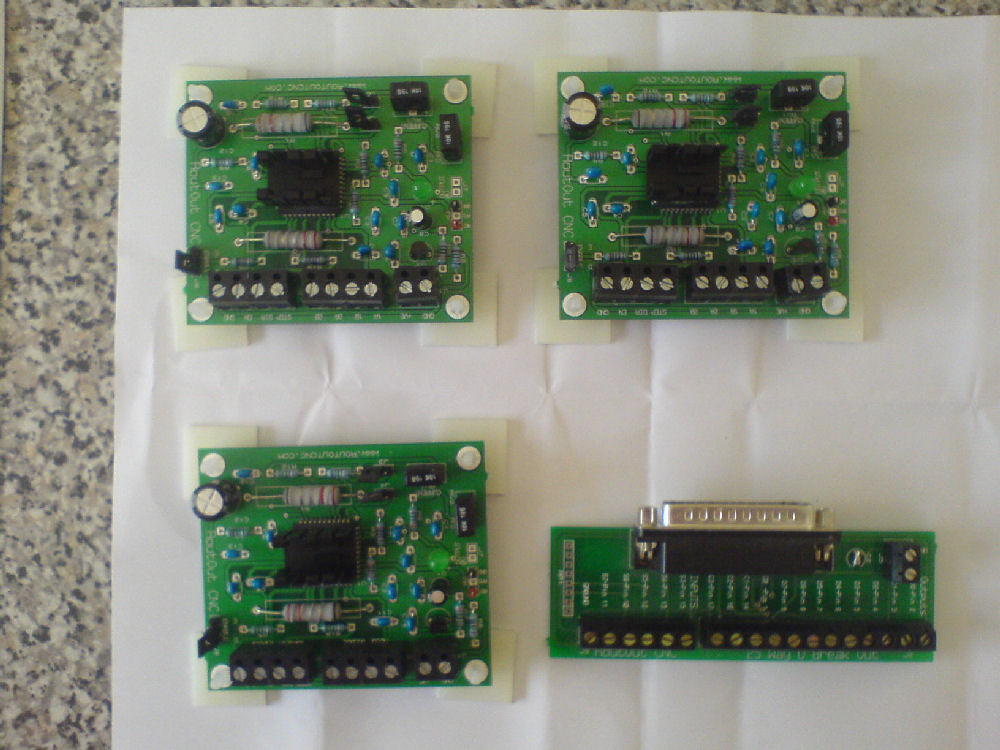

    After chatting with you and looking at the other choices I decided that www.routoutcnc.com was the best choice for me, you can read about my new drivers below:
    Microstepping Bipolar Stepper Motor Driver:
    The RoutOut CNC stepper motor drive has many uses including for CNC retrofitting / robot control or driving you own CNC machine. It is simple to wire and operates with no external current setting resistors needed. The RoutOut CNC stepper motor driver is a single axis, pulse width modulated (PWM), Micro-stepping Bipolar driver with Full / Half / Quarter / Eighth stepping capabilities.
    It is directly compatible with all of the major CNC software including but not limited to RoutOut CNC ,Turbo CNC, Mach 2, Mach1, KCam, Ability systems – LPT Indexer, etc., the list goes on.
    Features:
    • 2.5 A 30V Output Drive Capabilities.
    • 3V to 5V logic inputs.
    • Synchronous Rectification for low power / heat dissipation
    • Internal UVLO and Thermal shutdown circuitry.
    • Small PCB foot print only 66mm x 77mm
    • Internal 5V logic driver onboard (no need for 5v Supply)
    • Enable – Turns the motor off when not being driven.
    For a wiring diagram for use with Routout CNC see the PDF File (Link Below).

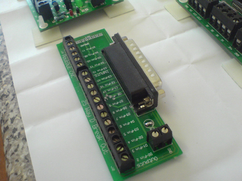

    Routout 25 Way D Quick Connect:
    The Routout CNC 25 Way D Breakout has many uses including for CNC retrofitting / robot control. It allows you to wire to the parallel port / LPT port using screw terminals, this makes wiring limit / sensing switches to you CNC machine a breeze.
    Features:
    • All connected printer I/O lines have screw terminal connector.
    • Very easy to wire limit / control switches.
    Routout CNC Quick Connect 25 Way D PDF
    I managed to get this lot for £86.49 Inc P&P, they do charge more on their web site (£130.00 Inc P&P) but if you go to their eBay shop you can pick these up for less. They have a fast email response and seem like a good choice with just 2-3 days for a delivery, you can find there eBay link by Clicking Here!
    Cheers and thanks again.

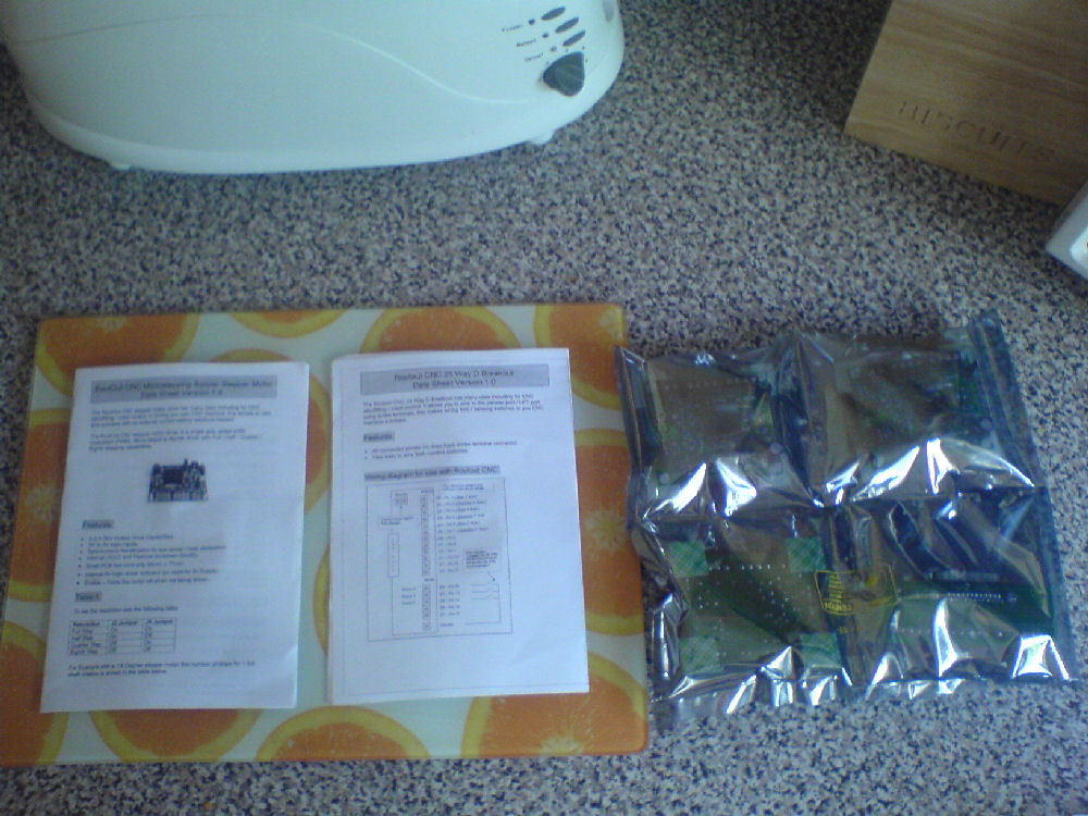

    Tuesday, i recived my RoutOut CNC 3 Axis Driver Kit, how excited was i !
    From start to finish purchasing from Mike Gaylor over at RoutOut CNC was fantastic! I was very impressed with how everything was packaged and the products themselves.
    I would recommend anyone looking for motor drives to go with Routout CNC; email response was second to none, there after sales support is top-notch.
    Ok, lets see what is in the box.

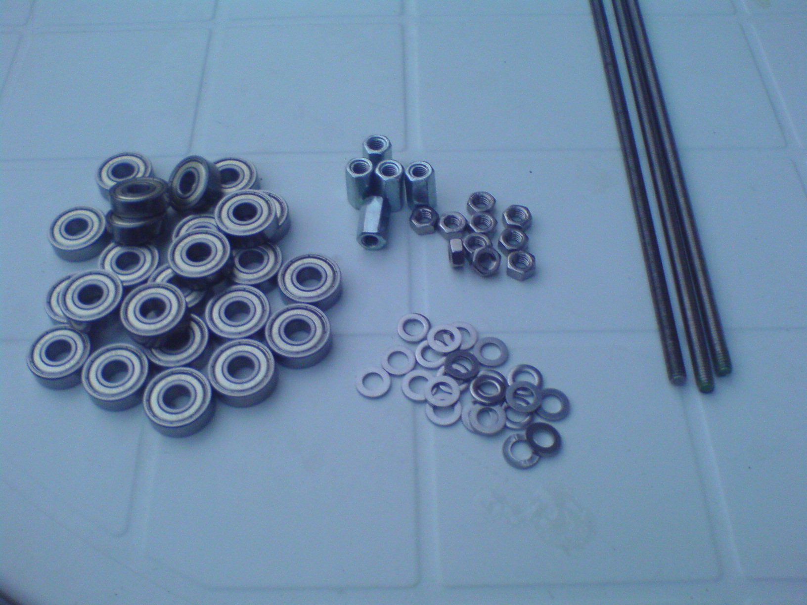

    Picked up my Bearings, Nuts and threaded rod today. O and some 6mm washers!
    The stuff I got was all stainless steel. I would recommend you get the same for your builds, its more expensive for stainless but you’re getting what you pay for.
