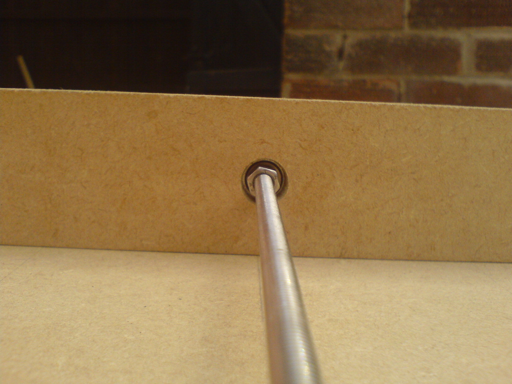

    Right I’ve got a few ideas on things I’m going to change with the default rockcliff plans, you don’t have to do what I’m about to show you, but you may as well as it will make for a better machine in the end. (I think)

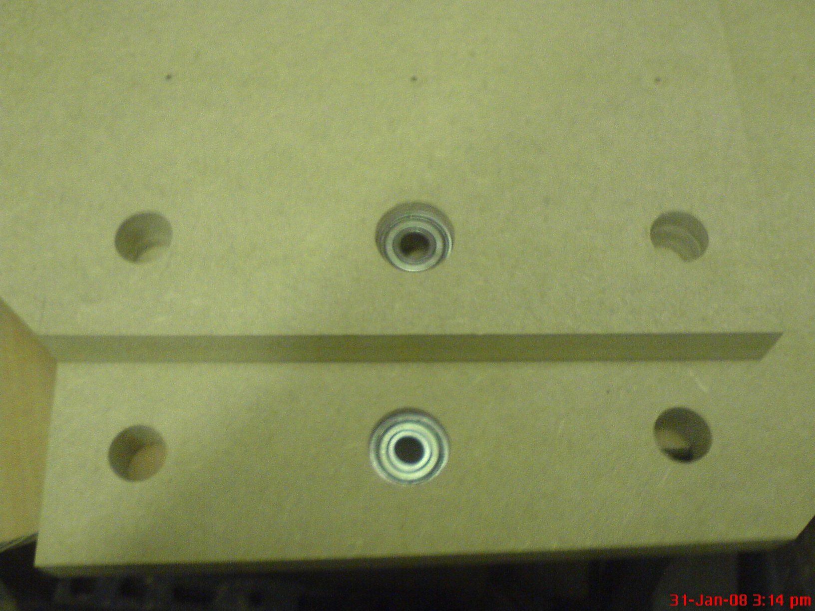

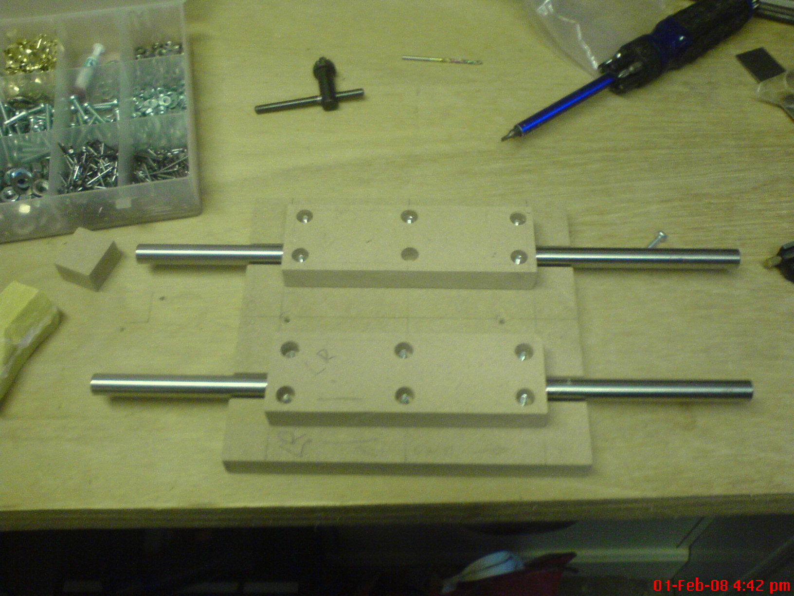

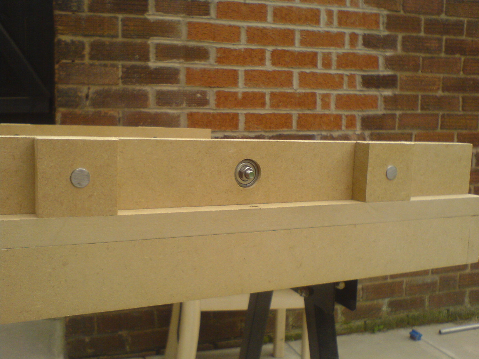

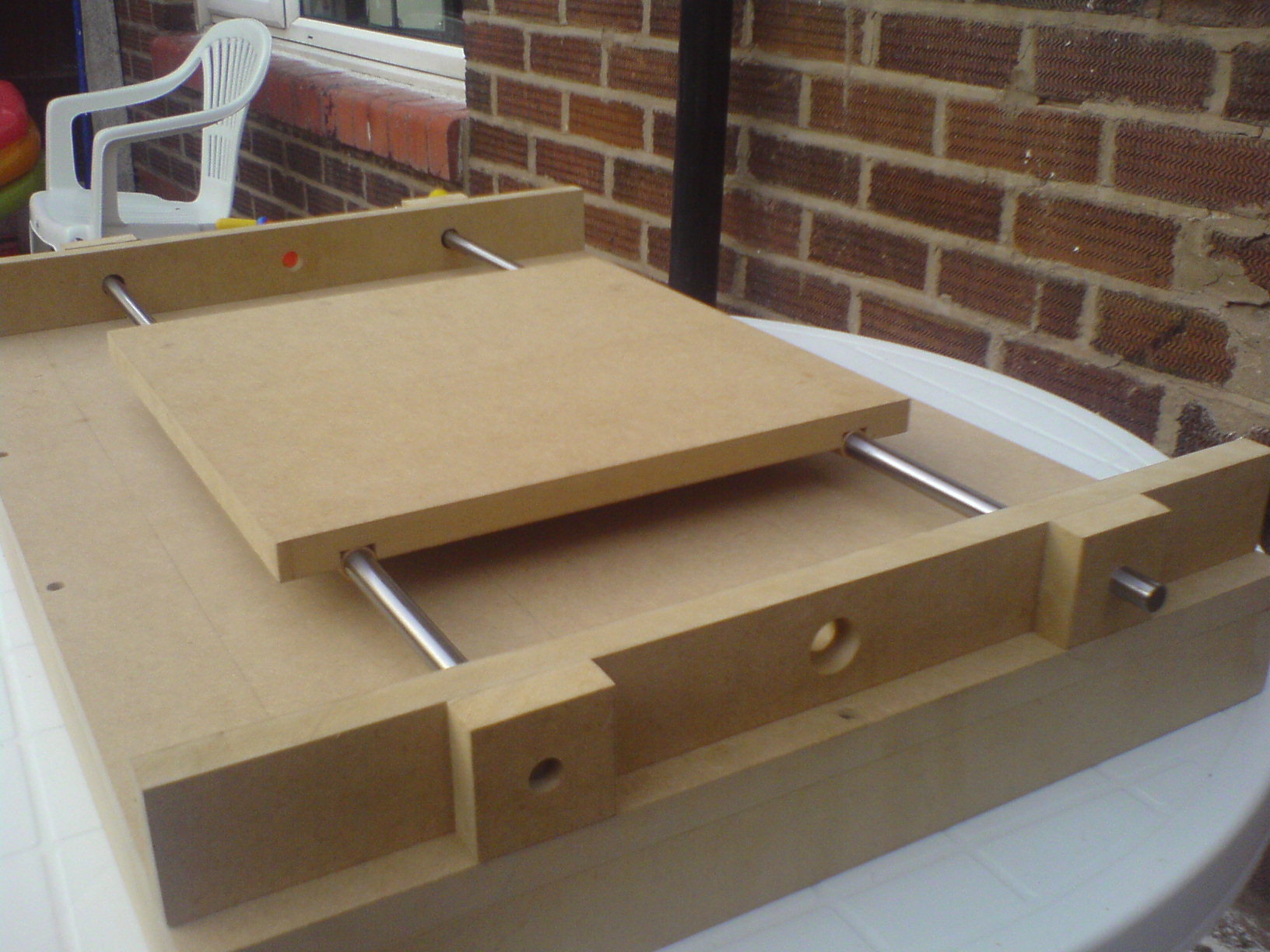

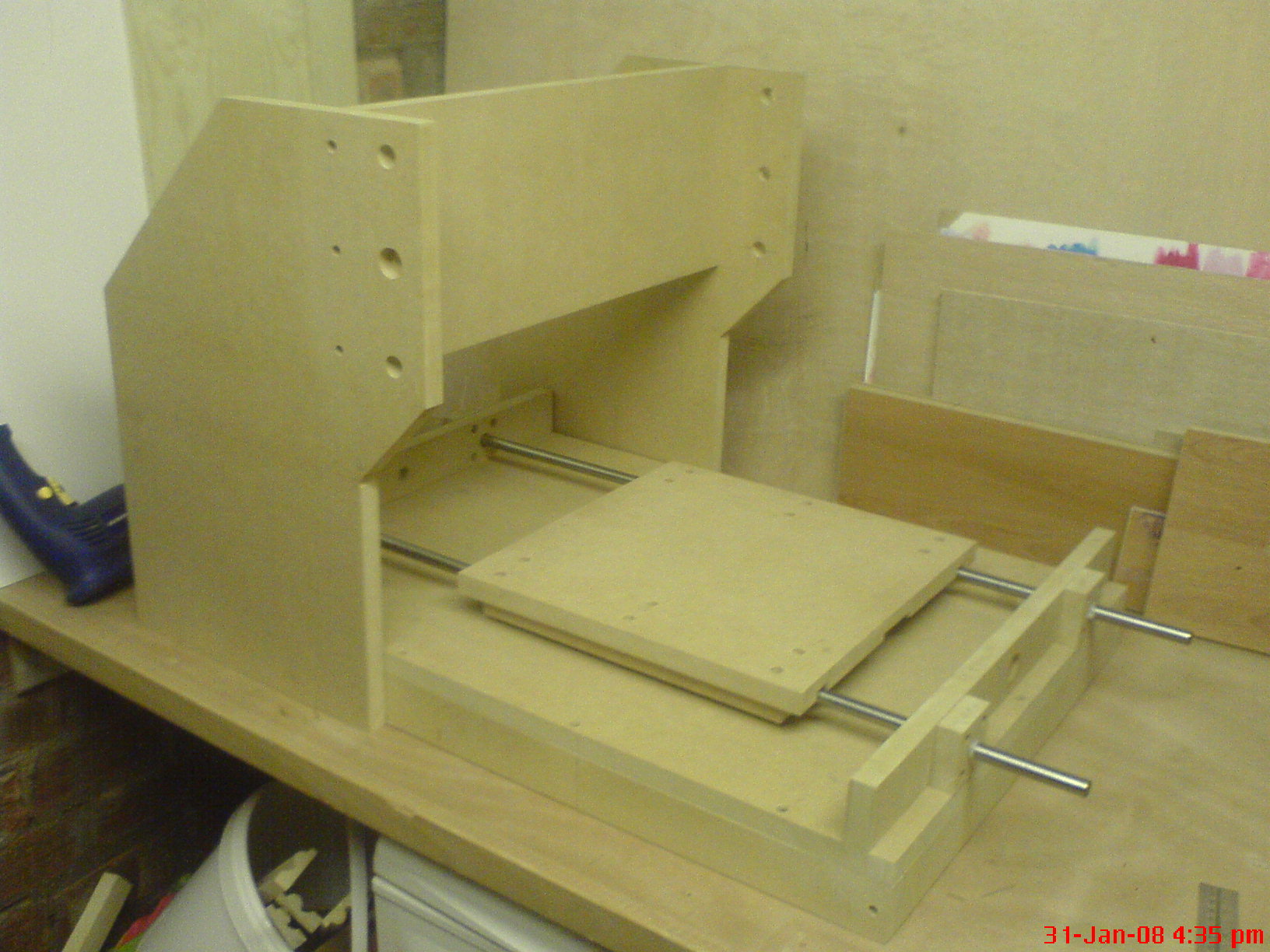

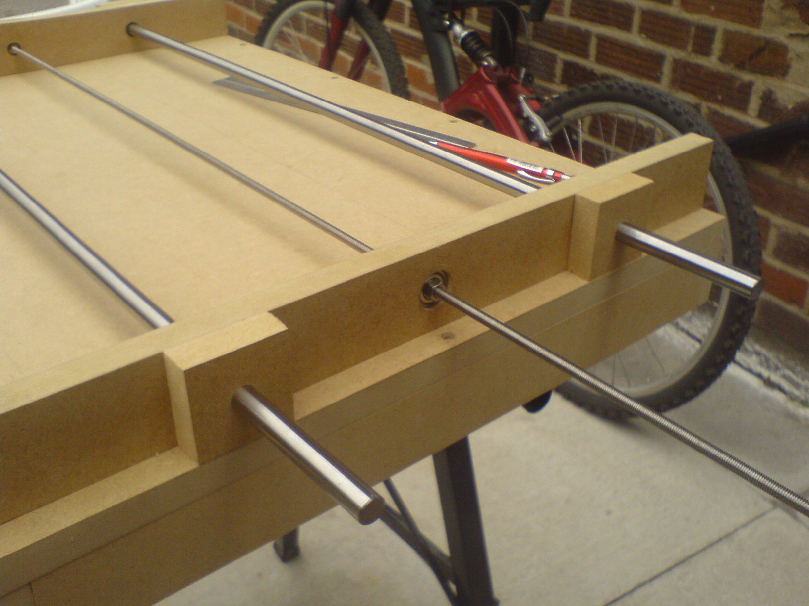

    I’ve decided to add skate bearings to my threaded rod to support them, as I say the plans don’t suggest to do this but when your machine is doing rapid movements you can get what’s called "whip" in the threaded rod if it’s not supported. At first I was only going to support my threaded rod at the opposite end to the motor, but then I thought well why not do it both ends. It will only make it better anyway, so that’s what I did.
    You can see I’ve cut out a 22mm diameter whole to receive the skate bearing, the skate bearings are 8mm inside diameter by 22mm outside diameter and they are 7mm deep. I’ve bored 10mm so the bearings sit 3mm from the surface. Before I did this I drilled all the way through with a 14mm bit so the threaded rod and nut can pass through and spin, that would be the smaller hole you can see in the pic viewing from the leadscrew side.
    I’ve also drill out two 14mm holes for the rails to pass through.

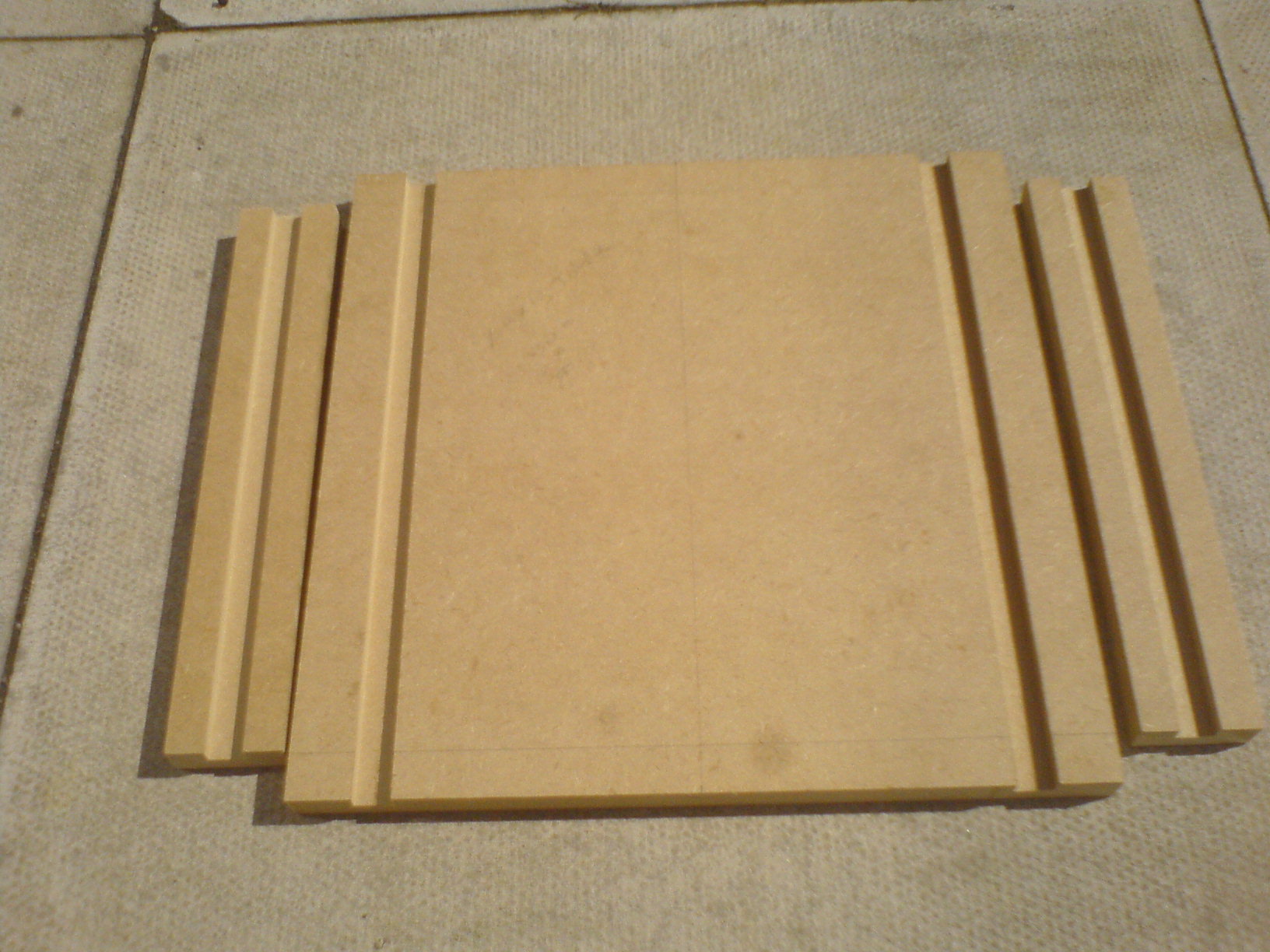

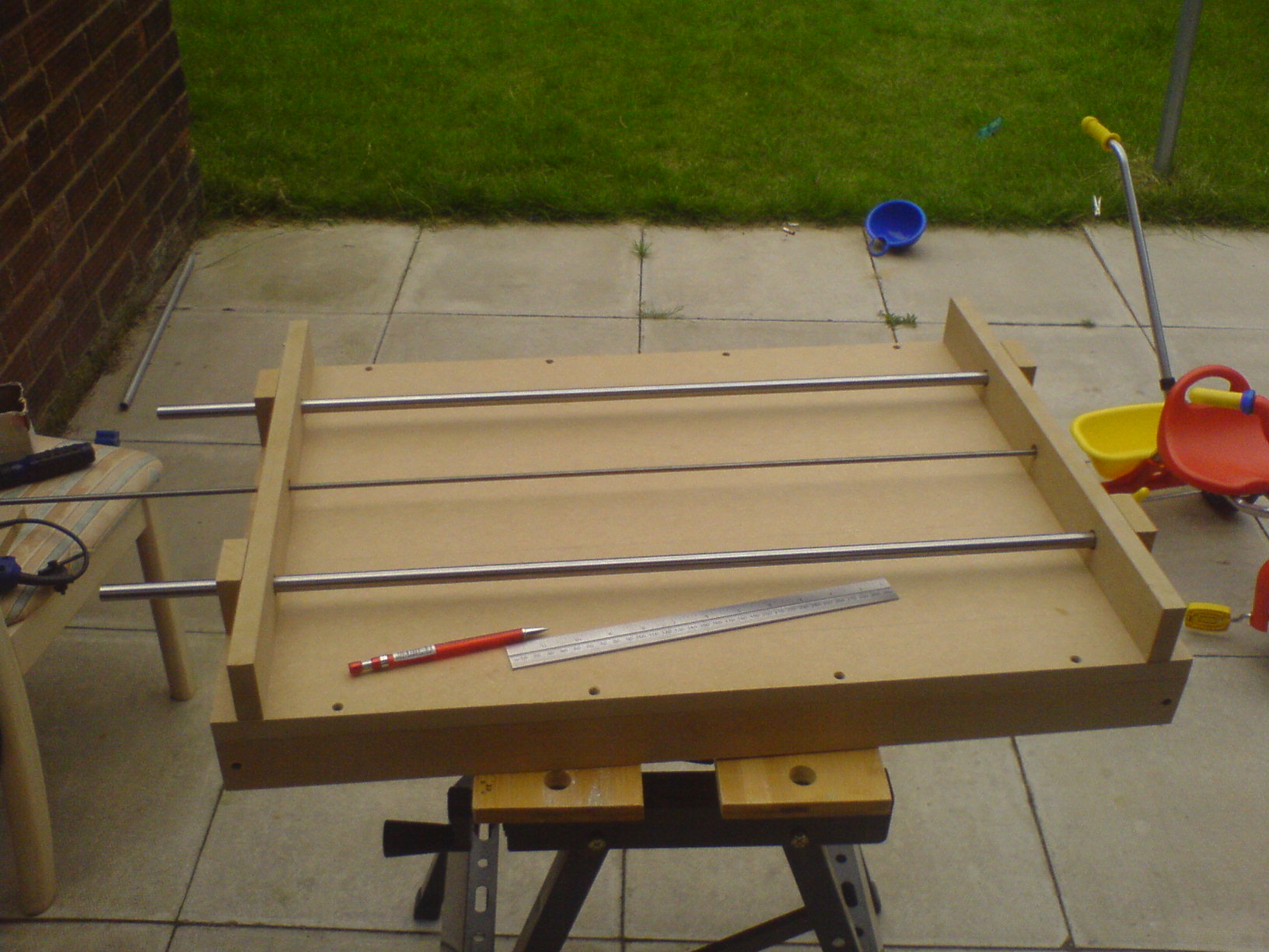

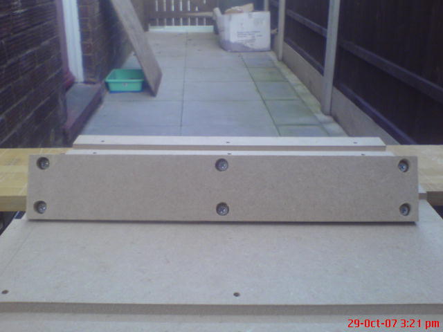

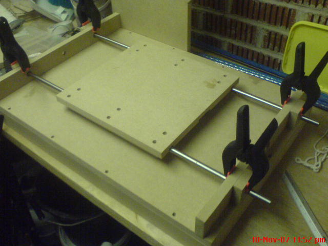

    So the sun was still blazing and the girls still shopping, so I pushed on and got some more done.

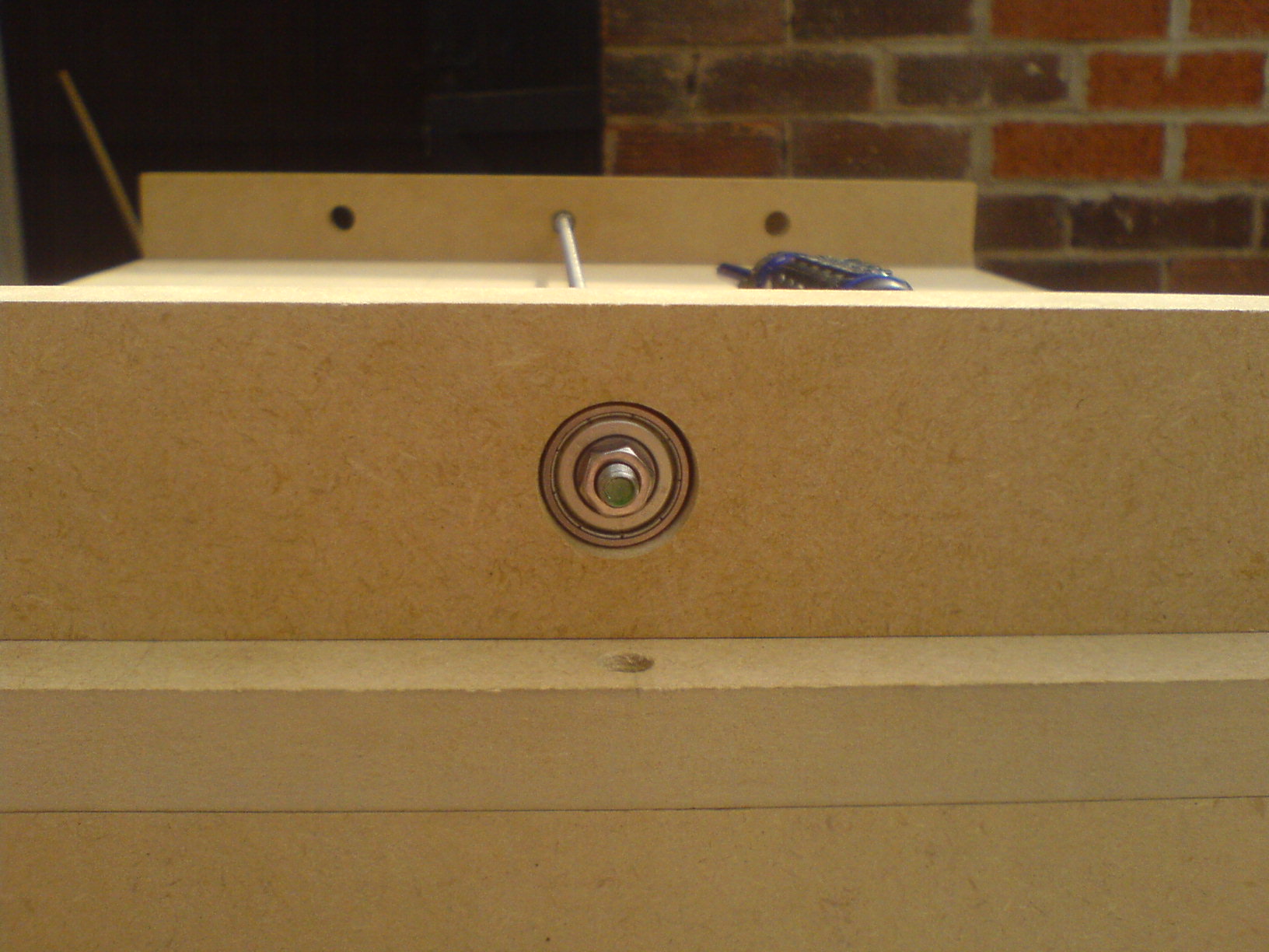

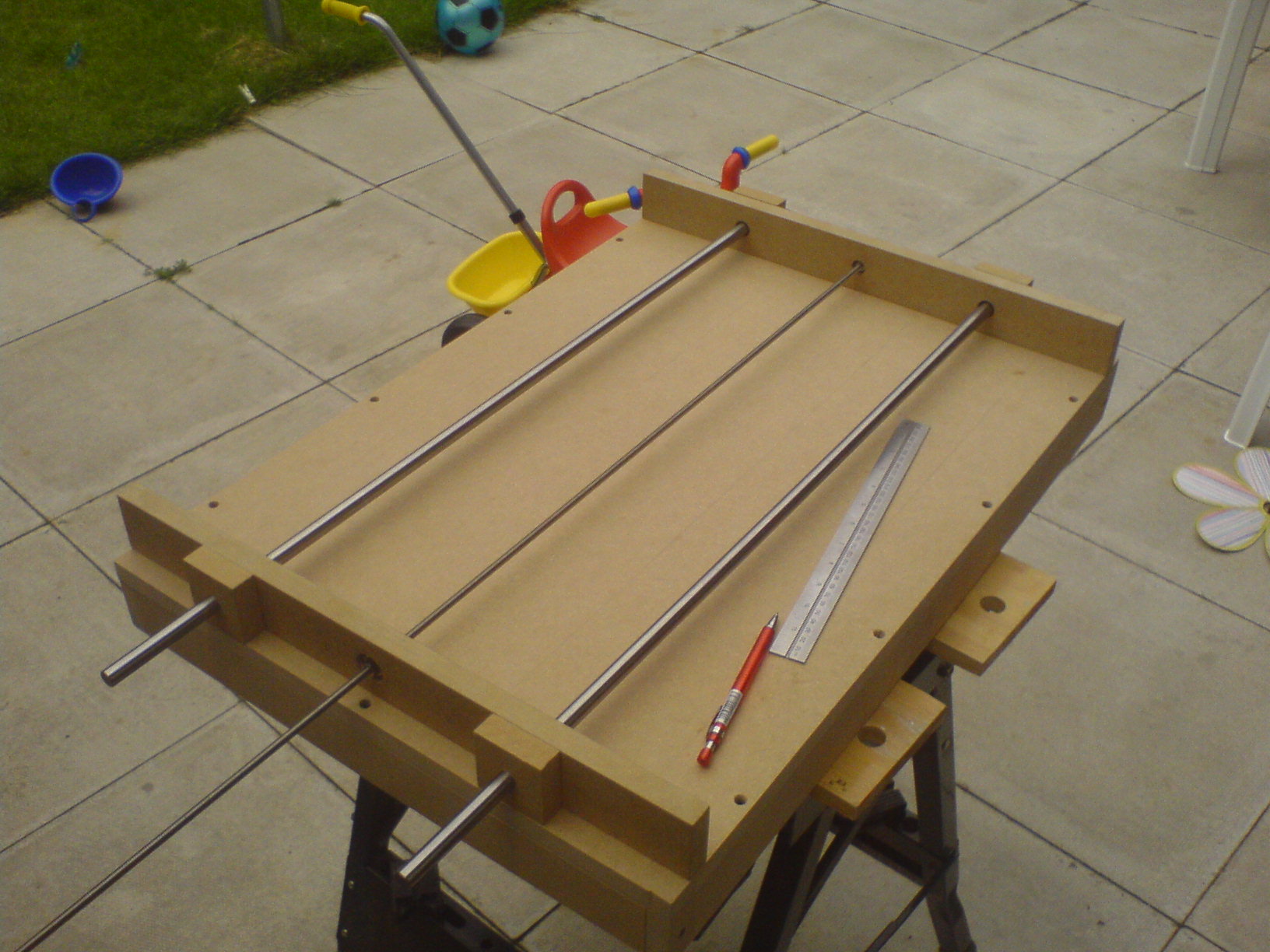

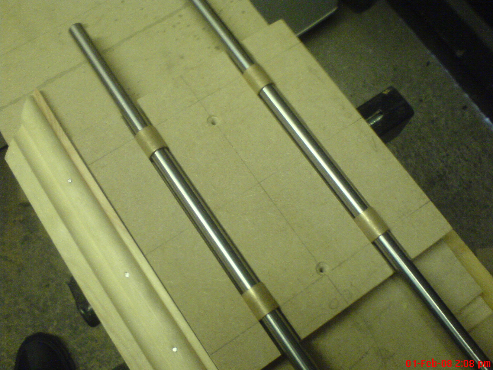

    I decided before I went on to the next stage, I would test fit the rods and rails and the bearings of course, you'll notice that I’ve put my bearings on the outside of the machine. This isn’t a must but I would like to put some tension on the rods so by putting them on the outside we can do just that.
    To test fit the rails I had to make the 50mm x 50mm rail support plates, again I just marked the centre and drilled out a 13mm diameter hole to receive the rails. You can see the rails are to long so ill cut them down later on in the build, I may not though as I could just rebuild the machine to a bigger size !

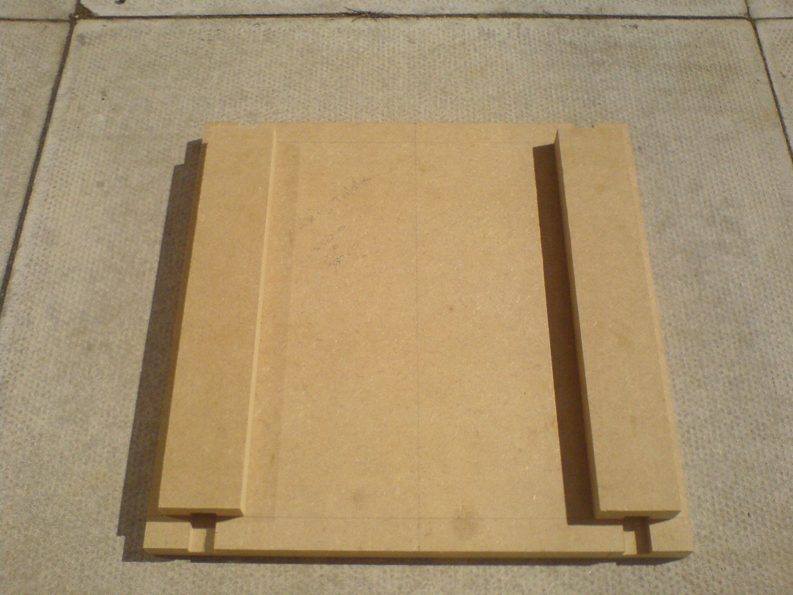

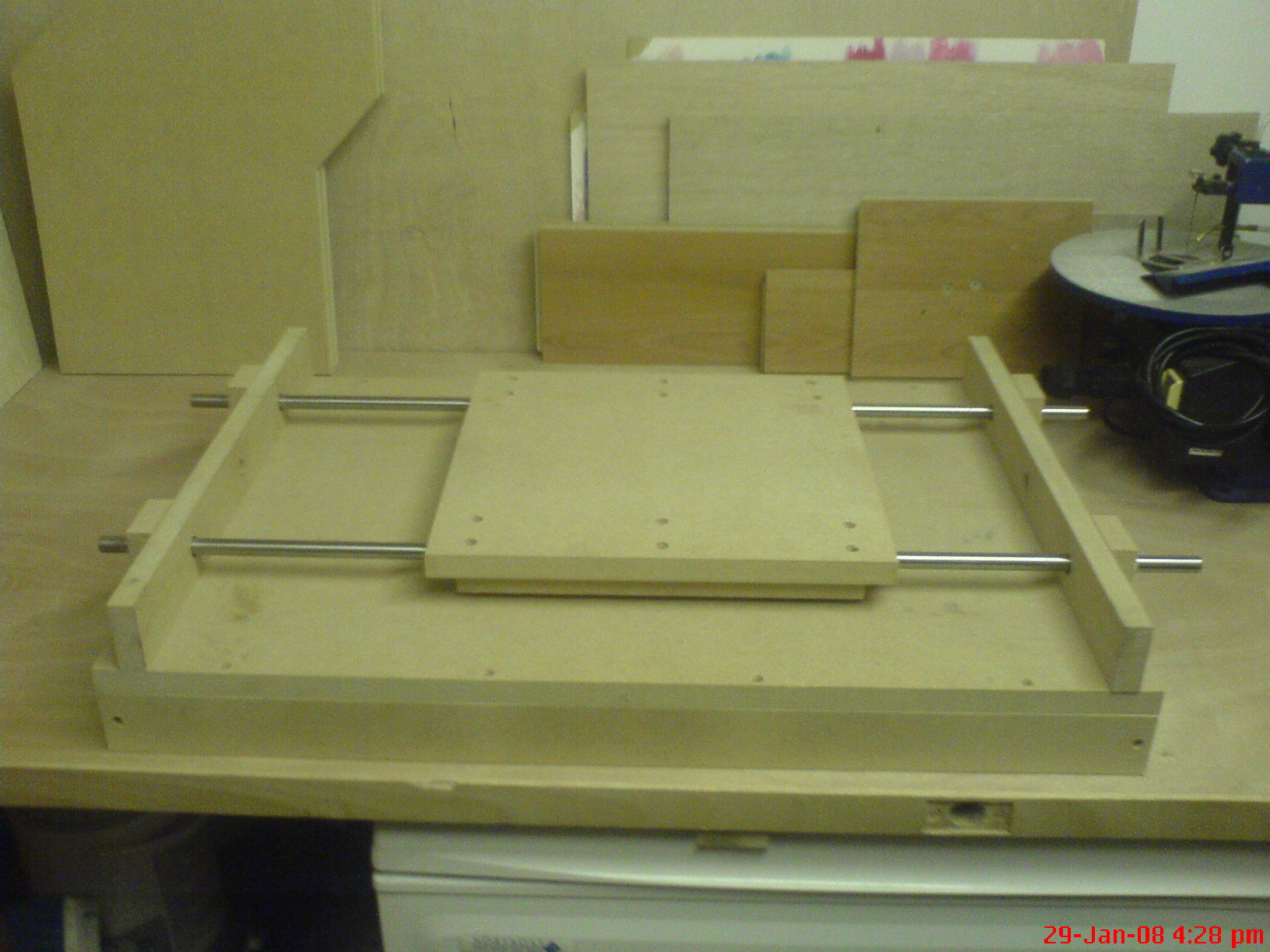

    Guess what? Yuup! The suns still out and the girls are still shopping!

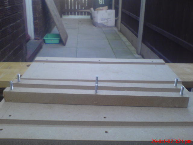

    Ok so everything looks good to go, there is a couple of things I’ve noticed at this point so ill talk about them now.

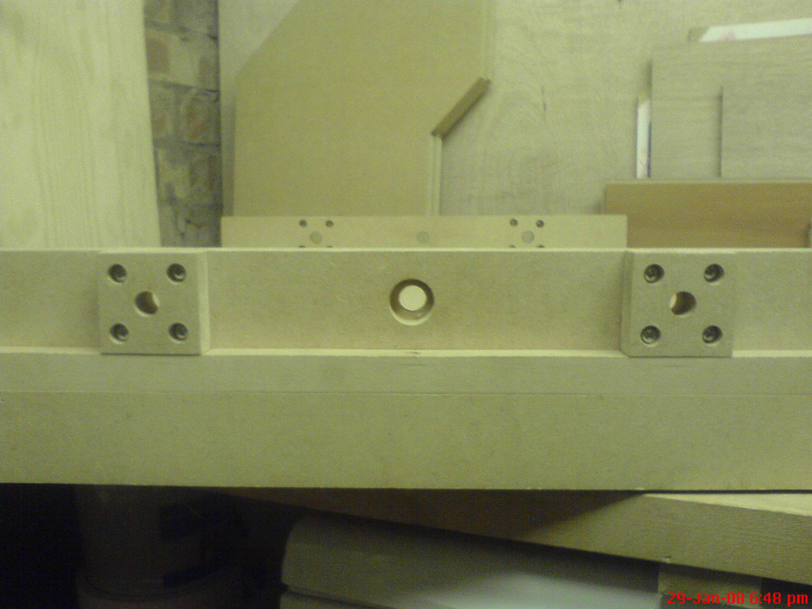

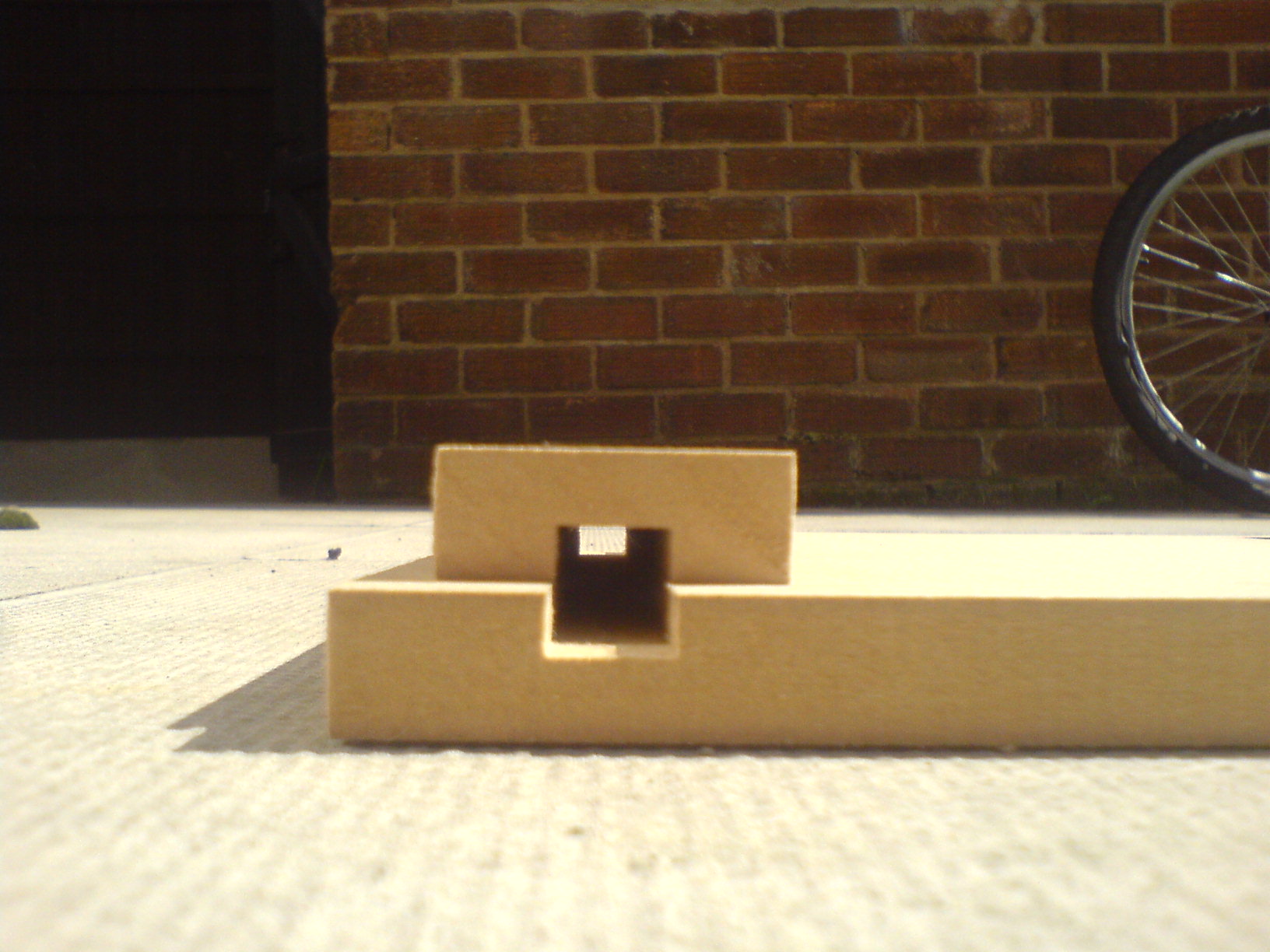

    The 14mm holes I cut in the rod support plates are small; the rail supports allow me to move the rails in all directions so as to get everything square, parallel and lined up correctly. There is enough space with the 14mm holes but I think given the choice I would have preferred 16mm holes so there was just that bit more room and clearance for the rails so I may re drill these holes at a later stage, though there isn’t really a need.

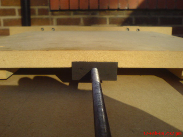

    The other thing I’ve discovered though it was expected is that I will need to rout out some of the table on the underneath where my transmission nut will be fitted, again I’ve deviated from the plans and I’m going to be using a different type of transmission nut to the wing nut in the plans.
    What my plan is, is to mount the transmission nut in the middle of a piece of MDF under the table, ill post some picks of this so it’s more clear what I’m talking about later on in the build log.

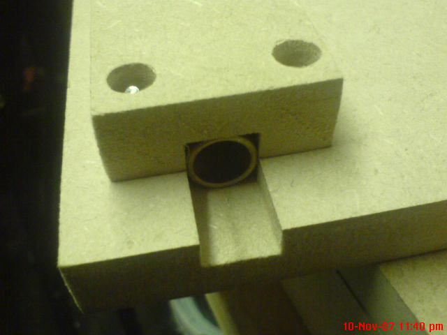

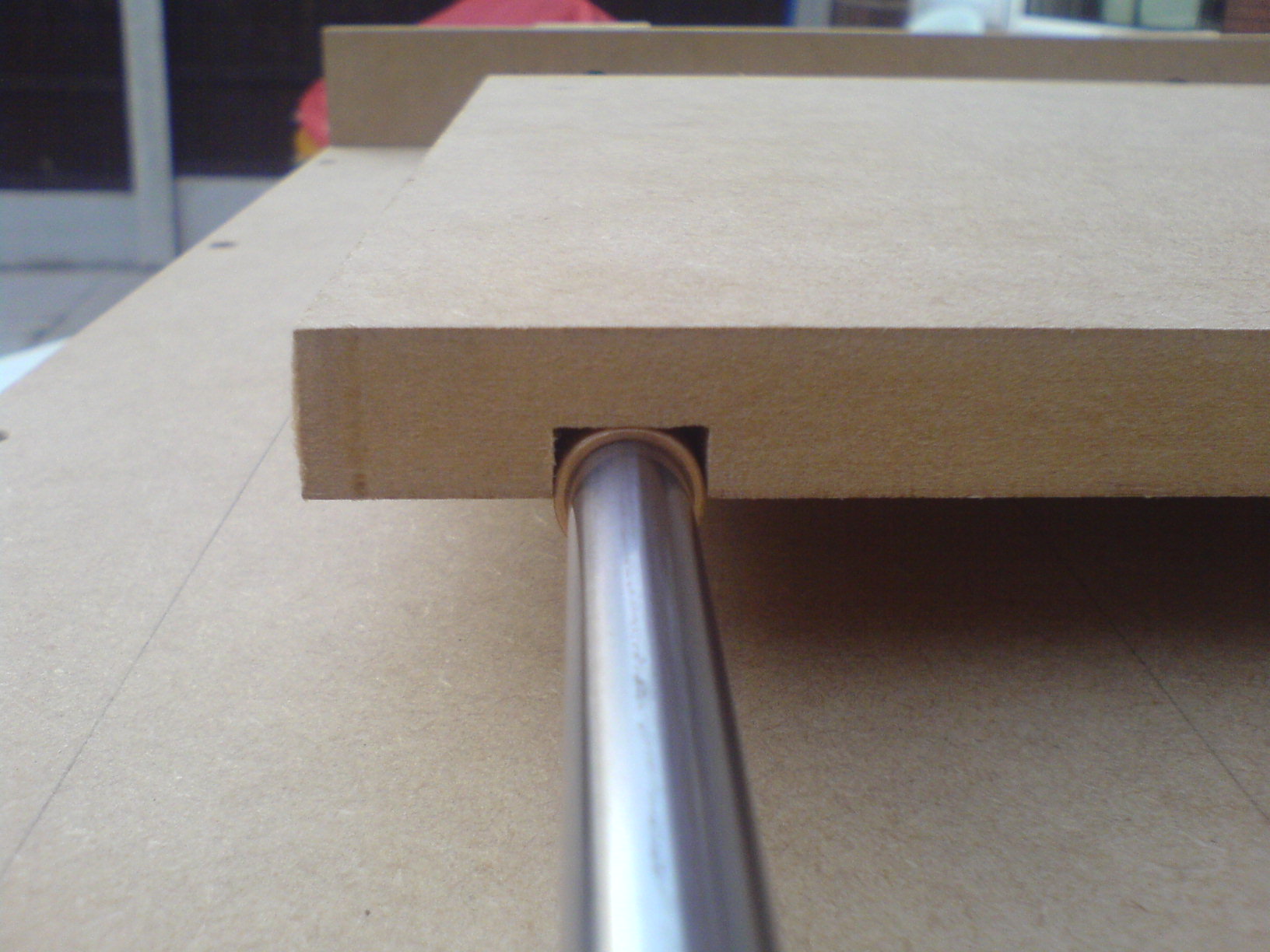

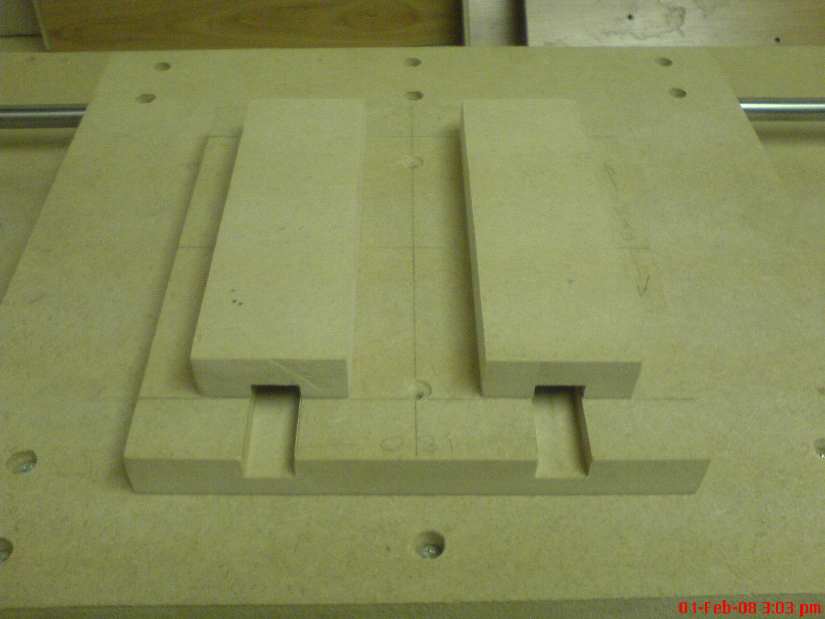

    Ok so I’ve cut my routs to receive the oilite bronze bearings, I went to every shop in Wigan trying to find a 5/8" - 15.85mm round end router bit. Could I get one?
    Yep for £63.27, so no that didn’t happen, instead I went for the bit I already had and that was a 5/8" flat bit.
    You can see in the picks that I’ve test fitted the bronze bearings and mounted the table onto the rails, I also started with the Bronze Bearing support plates that go underneath to secure them, again the plans call for 50mm x 50mm blocks but I’ve made mine 50mm x 330mm so they are one piece and very accurate. I’ve got one cut and routed and the other is done and just needs cutting from the sheet of MDF I’m working from, I will post about them tomorrow once they are ready to be used and fitted to the table.

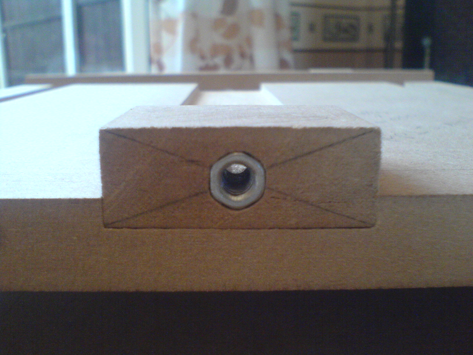

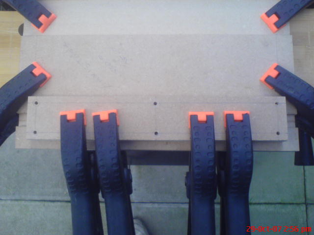

    Yep you guessed it! The girls went shopping and I had time to work on my build.

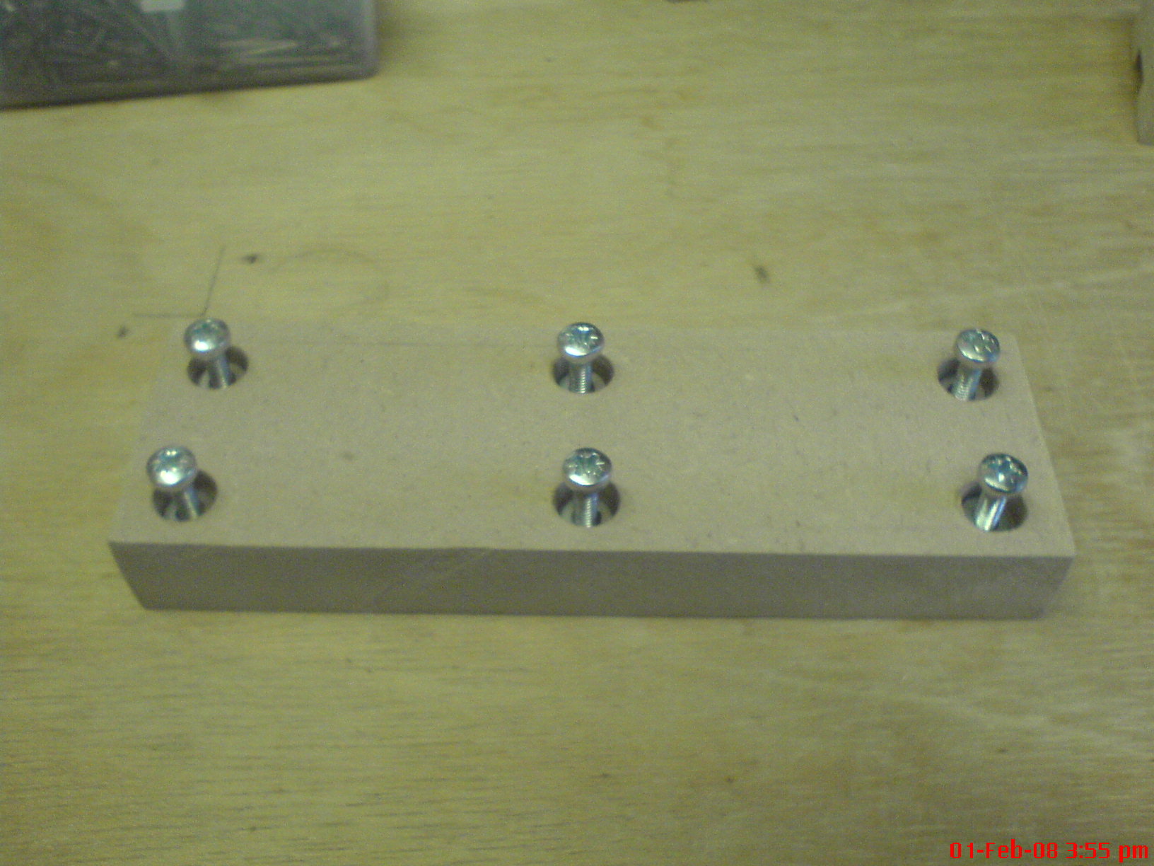

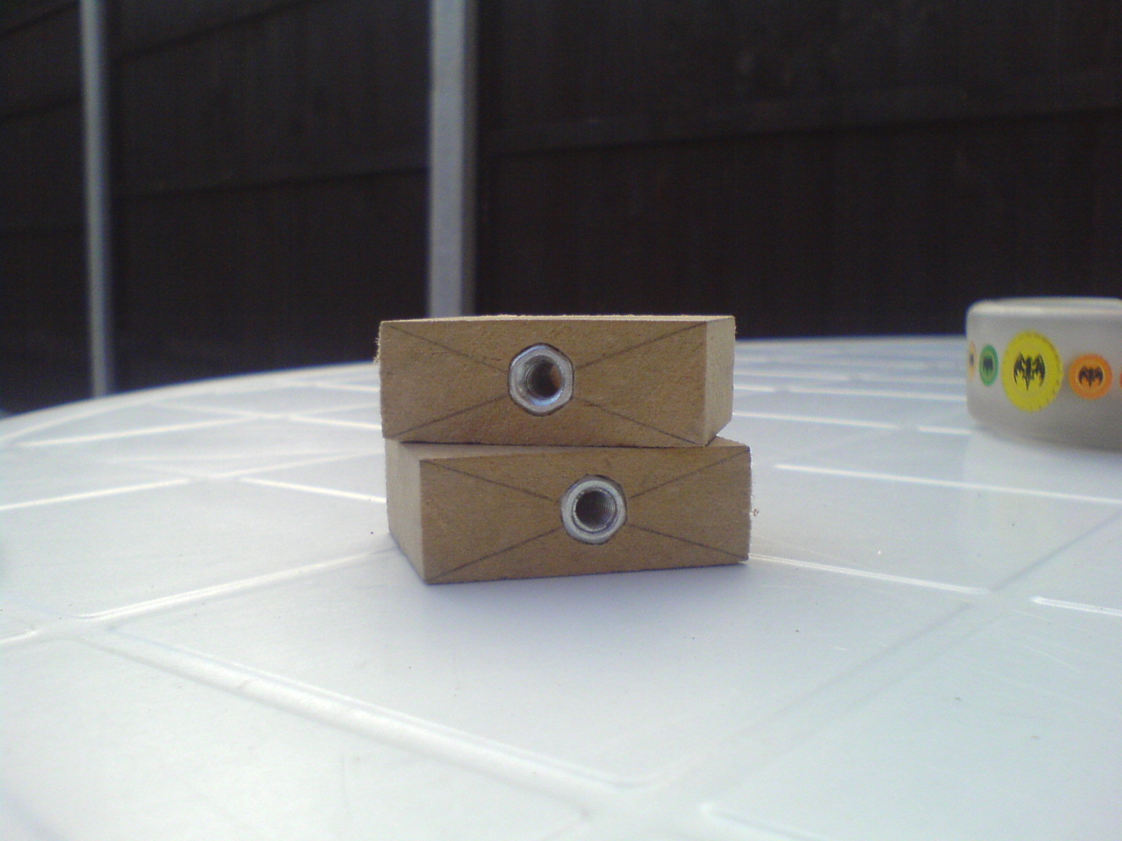

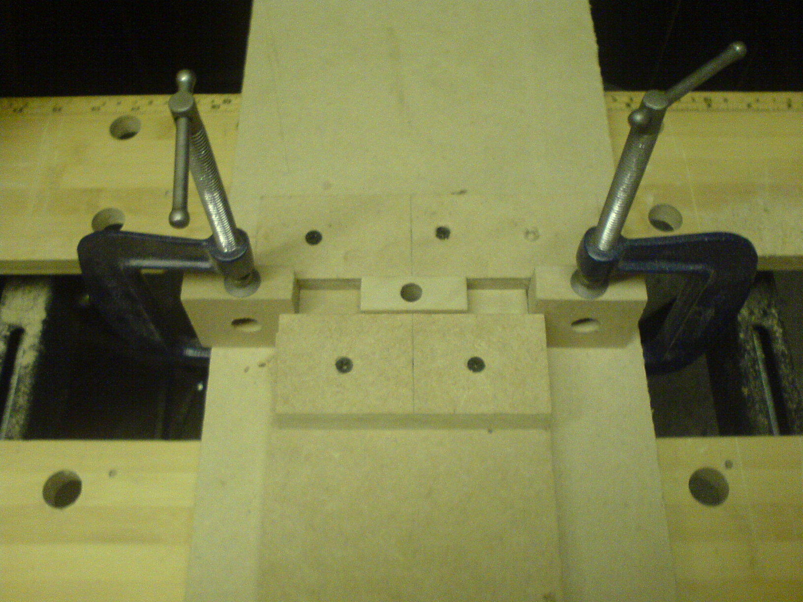

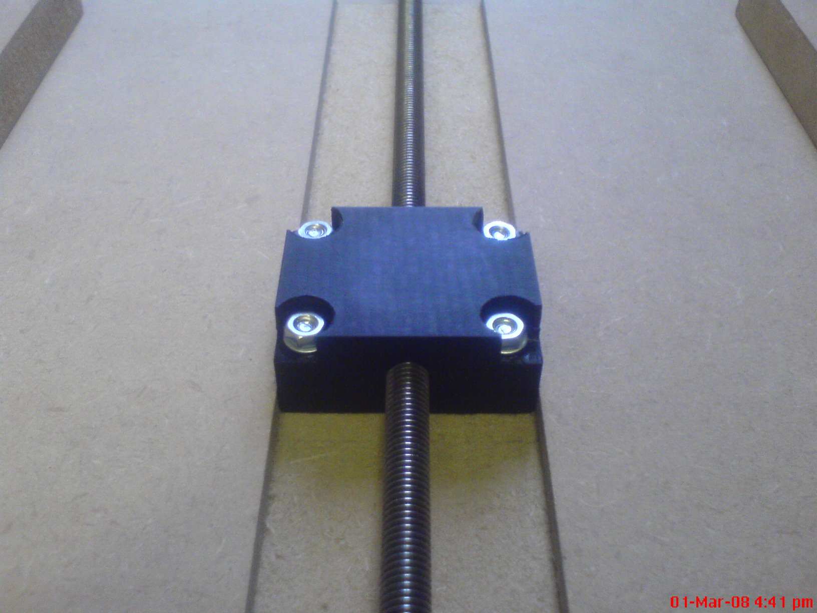

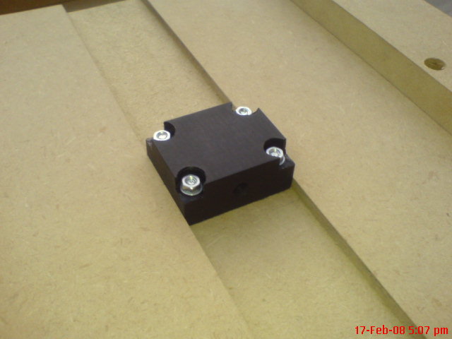

    Ok so today I managed to work on my transmission nut system and finished cutting the bearing support plates or whatever you want to call them. I will be using some small nuts and bolts to fix these in place along their full length, ill post on them later in the week.
    I also started making some beta transmission nut holders as well, after I made them I test fitted everything to see how it all looked, I needed to make a rout out for the holders to sit in so the transmission nut sits in line with the rod and bearings. I need to rework this as the transmission nuts are still to low by about 3mm.

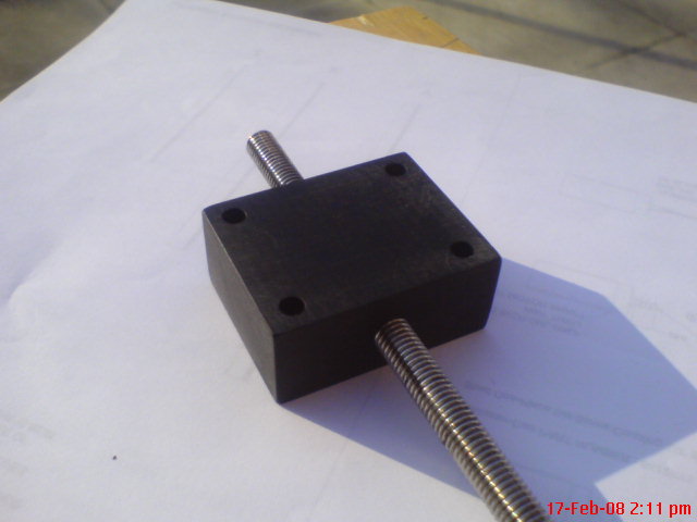

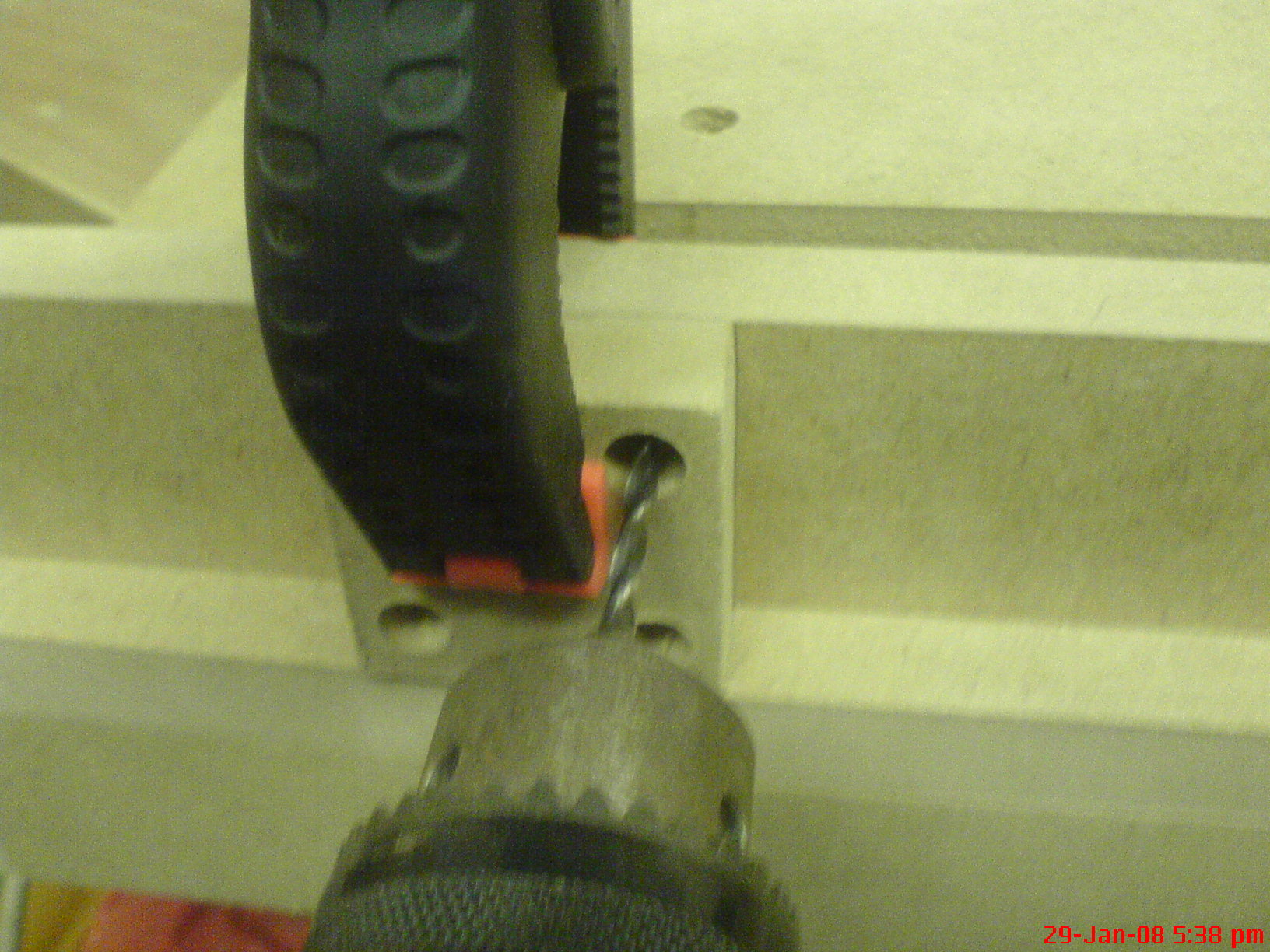

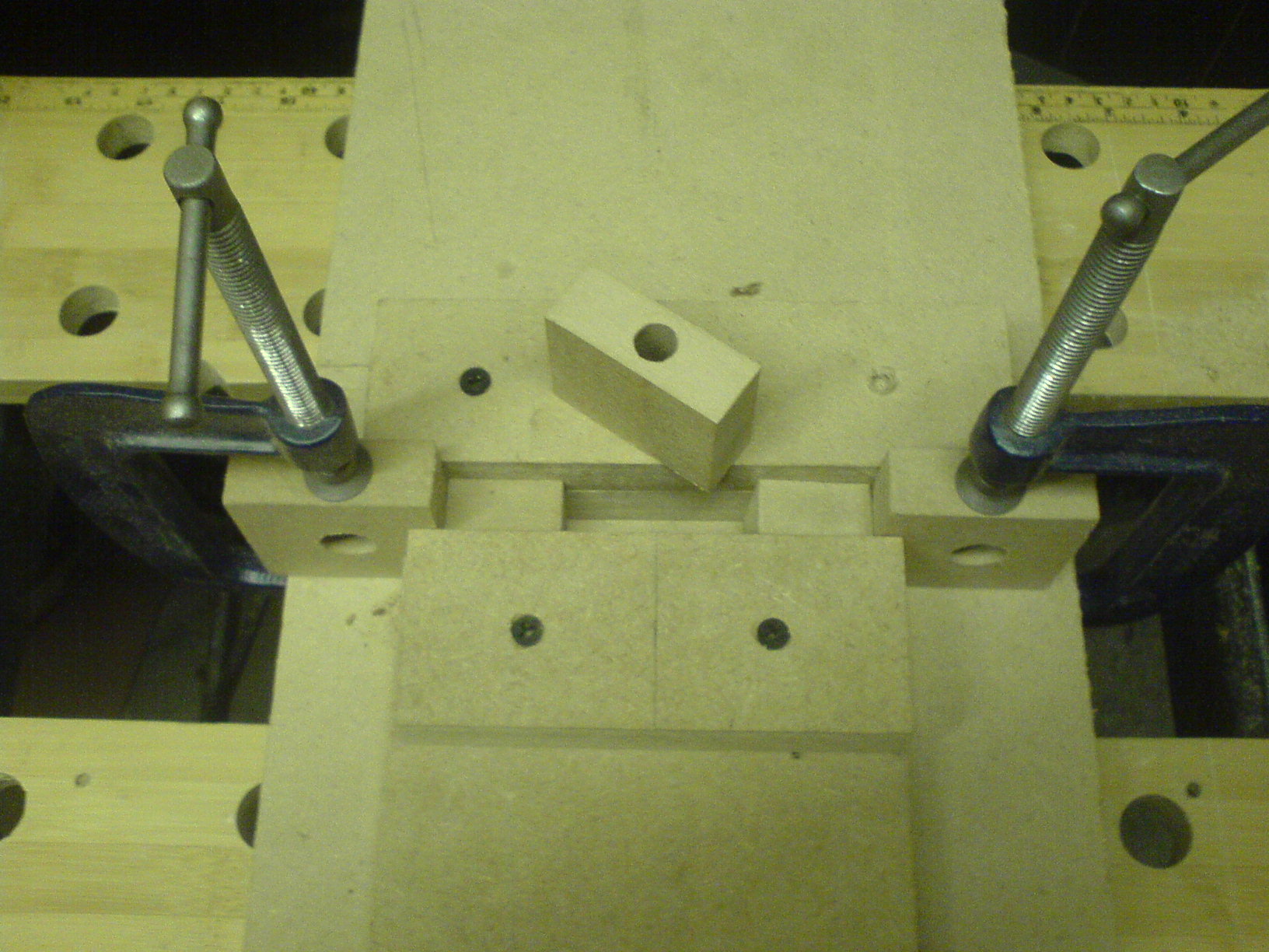

    After that I reworked the transmission nut holders only this time I made my very first ever jig to get them spot on with a router, rather than the bench dill as I found the drill wasn’t doing a good enough job with accuracy and so on. (or was that just me?)
    Try not to LOL till you pee yourself, it’s my first ever jig don’t forget! And besides that it does the job. I managed to get some new further beta holders made; by then it was time for dinner and time for "family time" so I had to stop.

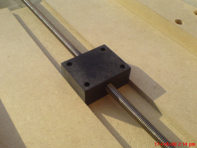

    So my setup is hand tools and I couldn’t really do a good job at getting the drive nuts spot on. I’ve now moved onto making delrin drive nuts as the ones I made above are just no good really.

    I would say they are ok, I’m building with 1/2" size rods and they seem to be fine for what I’m going to do. Pen5 has the 16mm rods and is more than happy with them; my father in-law said that they are great until they wear down (bronze bearings). I can’t see they will with the light cutting I’m going to be doing, but I guess it’s fair to say they will at some point.
    Only thing I found that I can say I noticed about the bronze bearings was, I put them upright on an off cut of MDF and the impregnated oil started to soak into the MDF a little. Also if you can, try and keep everything clean as dust seems to get in between the rods and the bearings. I know that’s probably obvious but I didn’t think about it when I was test fitting everything and I noticed small scratches on the rods, nothing major but still not what we want.
