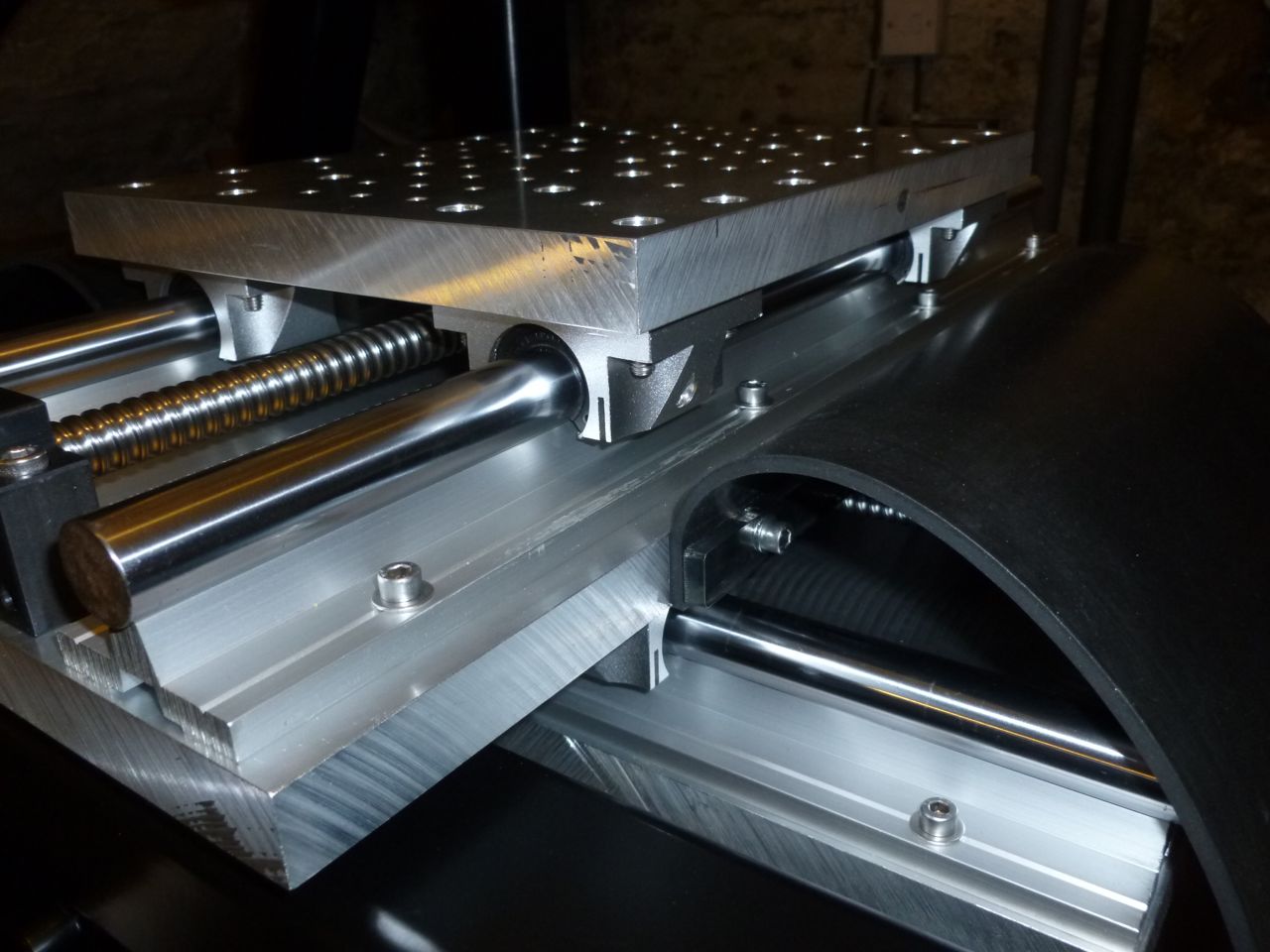

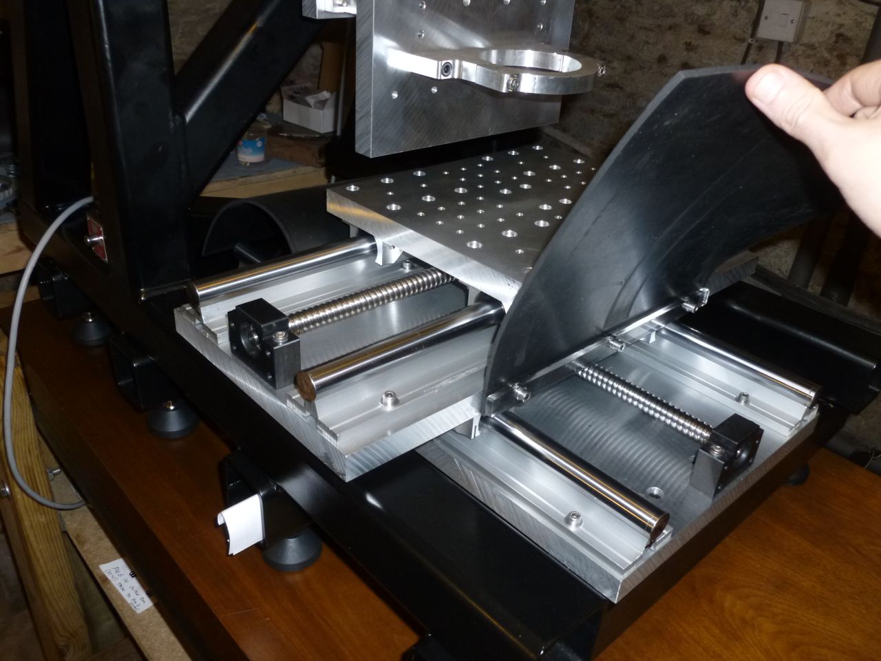

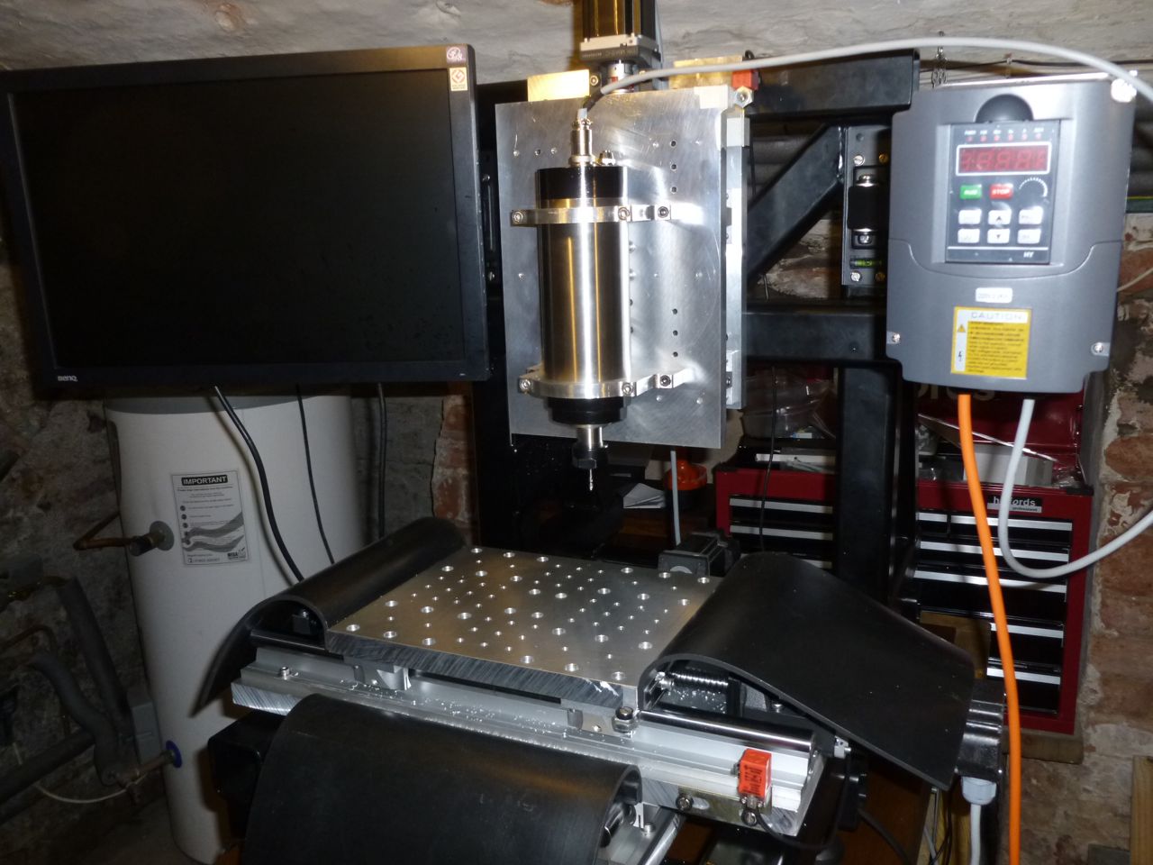

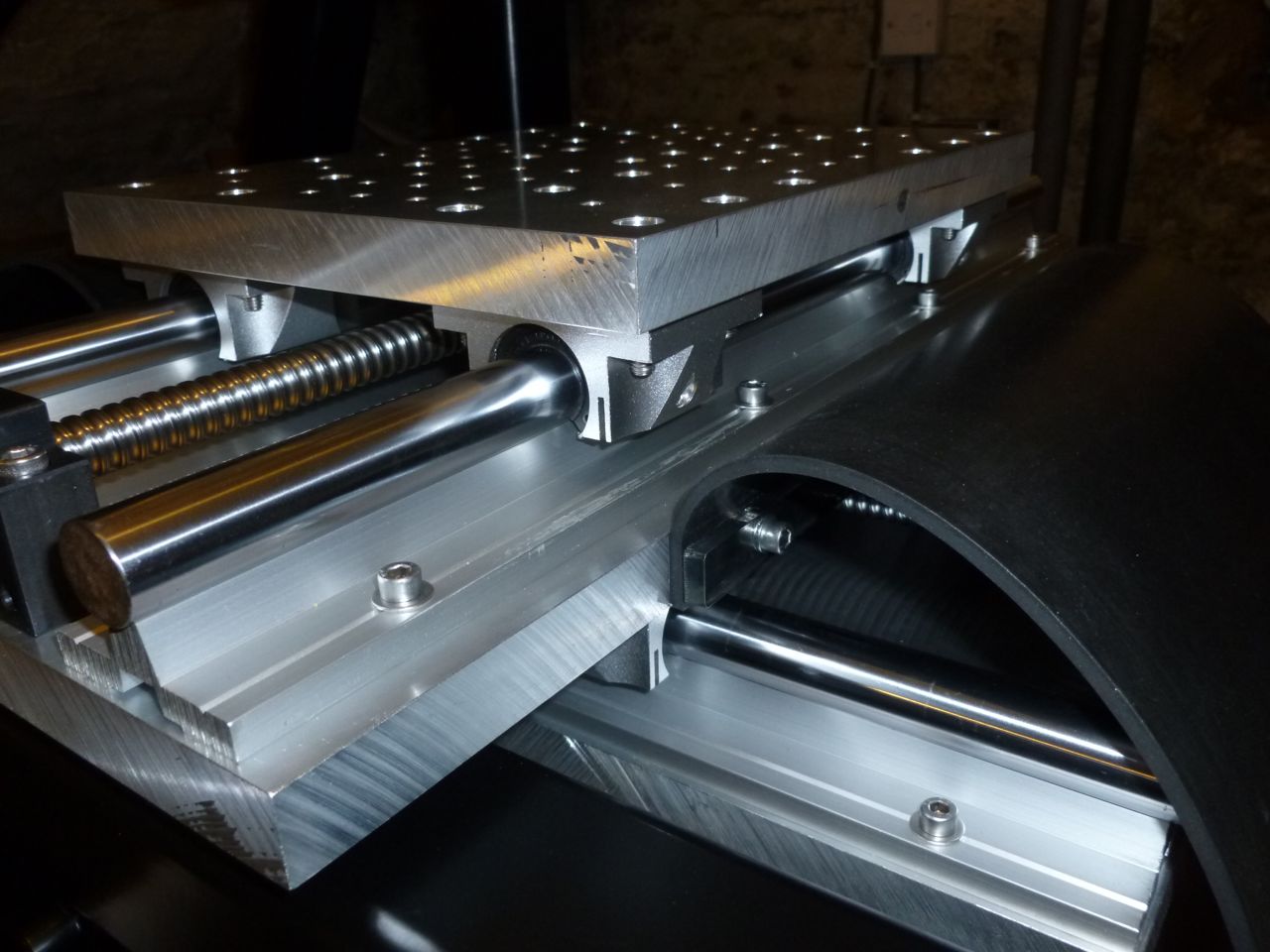

    An update from the last couple of days, although I guess I ought to start a new build thread really - going a bit OT. I'll make it quick:
    • Flipped the rubber - the protective flaps are working now - they look a bit kooky, but so long as they keep the worst off, I'm happy. Will also fit 'em to the table to protect X-running gear.
    • Motors mounted and wired in (thanks to Clive S for the covers!)
    • Monitor mounted to the frame and PC installed. Really nice having the DRO right next to the work-area.
    • All gantries moving, a quick check of run-out along table X shows .07mm - the majority of which happens towards where the hint of binding was showing up - I'll whip the rails off and make sure there aren't any high-points.
    All in all coming along quite nicely, still unconvinced by the clicky ball-nuts - I take it that they come pre-greased? Or should I squirt a bit more in..?

  6. #16
    On my British made (Devon) machine I can get 1mm deflection at the collet with 1 finger pressure !!! That is why I plan a rebuild soon
    BTW Wal - Your machine looks good, nice work !
  7. #17
    No there'll be more grease in your hair than those nuts.!!. . . .Definately give them some grease.
    Coming along nice and looking good. . .
    If that screen is a touch screen then i'm not sure I'd have it that close to machine.?. . . . I wounce used a friends machine with a touch screen mounted next to machine but on a swivel head and while using the bloody thing kept Stopping, feedrate would change and all sorts of strange happenings.?? . . . Anyway after calling my mate's machine some nasty names and calling him over asking what the F'#k was happening he turned screen away and said try again.!!. . . . Yep flying chips where hitting it and changing feed over ride, feed hold etc. . . .Lol . . Was Very Funny.!!
    Hehe - nah, this isn't a touch-screen, although I ought to find some sort of cover for the keyboard - I can see those chips finding their way in between the keys.
    Okay, I'll add a bit of grease - are there any tips on making sure that you don't over-pack the bearings?
    Cheers guys, nearly there but loads left to do..!
    Wal.
  9. #19
    Nah you won't really over pack them just grease untill you see it coming out from the ends.

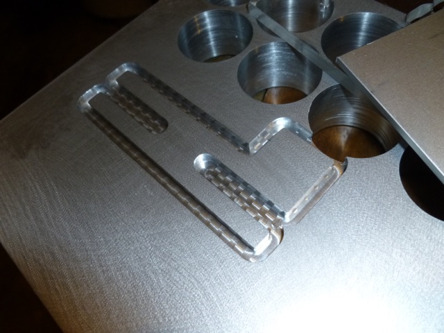

    Right, the build is nearing completion with homing and limits nearly all sorted, just need to machine me some new switch mounts - the ones on at the mo are rough fabricated jobs and I thought it would be cool for the machine to make nice ones for itself. Here's a vid of the mill cutting the switch mount profile shape into a block of semi-scrap 6082 I have lying about:
    In the vid I’m using a 4mm square end-mill (2 flute) which is spinning at 12000rpm with the work feeding at 400mm/min. My initial depth of cut was 0.5mm with a 12.5% step-over. it’s a climb milling operation. Ignore the holes - they’re not part of the job, I used the plate to cut spacers from a while back… By and large, I'm pretty chuffed with how this test cut came out.
    I've also had a go at perspex, which machines very well at the same settings as above (but with a faster feed-rate of 1200mm/min).

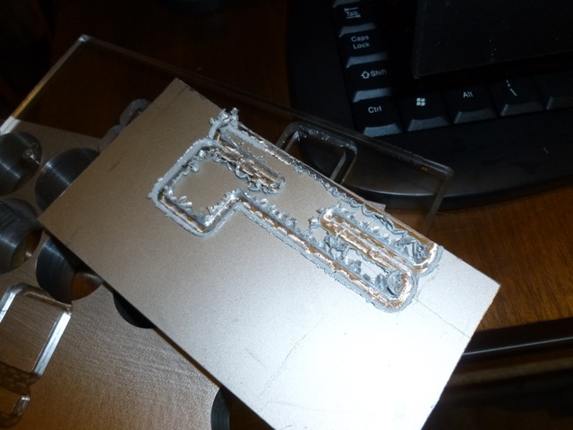

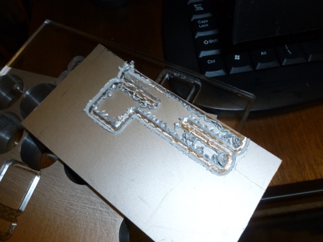

    The other day I tried milling these switch mounts out of the ali that Apple use for their Mac Pro towers, which just shredded up like this:
    I tried a few different feeds/spindle speeds, but to no avail. Earlier this evening I tried machining 'em using some old 3mm ali sheet that had been lying under my dads bench for probably the last 20-odd years, still no joy. Any recommendations on the grade of 3mm aluminium sheet I should be looking at for this kind of profile cut?
