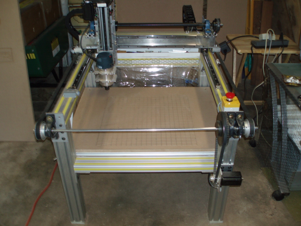

    You can clock the belts on the long axis via shaft at one of the ends. In fact you should. My current machine is build like this.

    A properly constructed , aligned and calibrated belt driven machine can offer real life precision in the ballpark of 0.05mm. Yes, even with roller bearings and belt. This for the unbelievers. My machine uses V bearings / roller bearings inside- 608/ on supported rail. When i bought it new it was in the 0.5mm ballpark, a couple of days thinking and bettering it and now is in the 0.05 -0.1 mm , i am talking about router not plasma.
    So, take your time and strive, you could make a very precise machine if you invest more time and precision right now when building it.

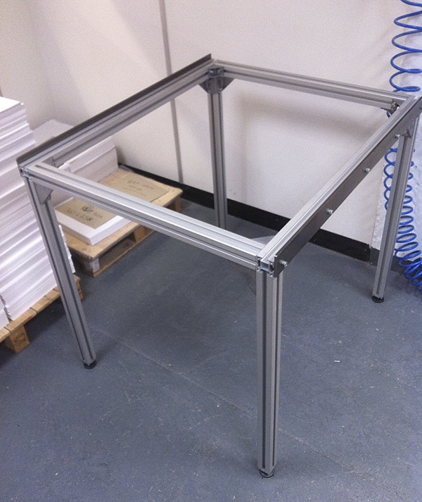

    Here's the reduced frame with side tracks fitted...

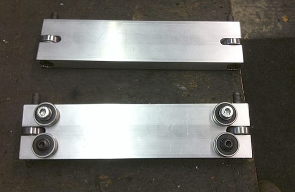

    And the two Y-axis trolleys...

    Coming along nicely.

    it not my machine, cause the part i want to show you is hidden inside, so i can not make photo of it but that's what i meant for clocking the gantry belts:

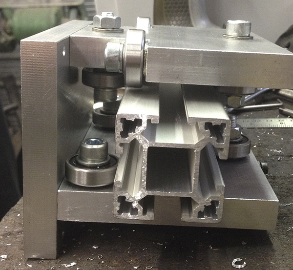

    That picture is almost identical to what I have built :)
    i have designed a carriage for the x axis on the gantry and will start machining it as soon as the aluminium arrives. It rides directly in the gantry beam, pretty much like the one in the eBay listing you added, but mine is made out of aluminium slab, same sort of bearing layout though.
    hopefully have it made by Monday as I'm still finishing the gantry trucks and motor mount.

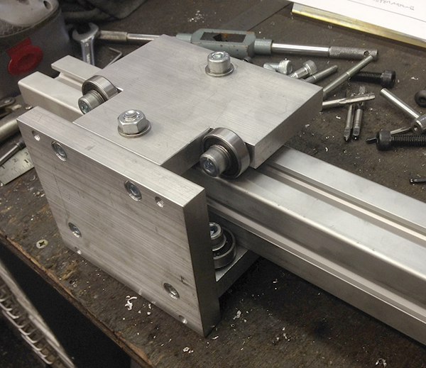

    Made the X-axis trolley today, came out lovely...
    The motion is smooth as silk and no twist or slack at all, very happy with that. The front plate is drilled for the motorised Z axis I have already waiting.
