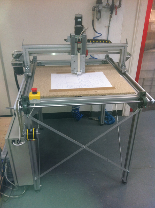

  4. #44
    A couple of pictures...
    the whole contraption....... :)
    And one of my first attempt at a floating head that I knocked together today...
    It's a couple of cut-down ball-bearing drawer runners and a bit of ally plate and a switch :)

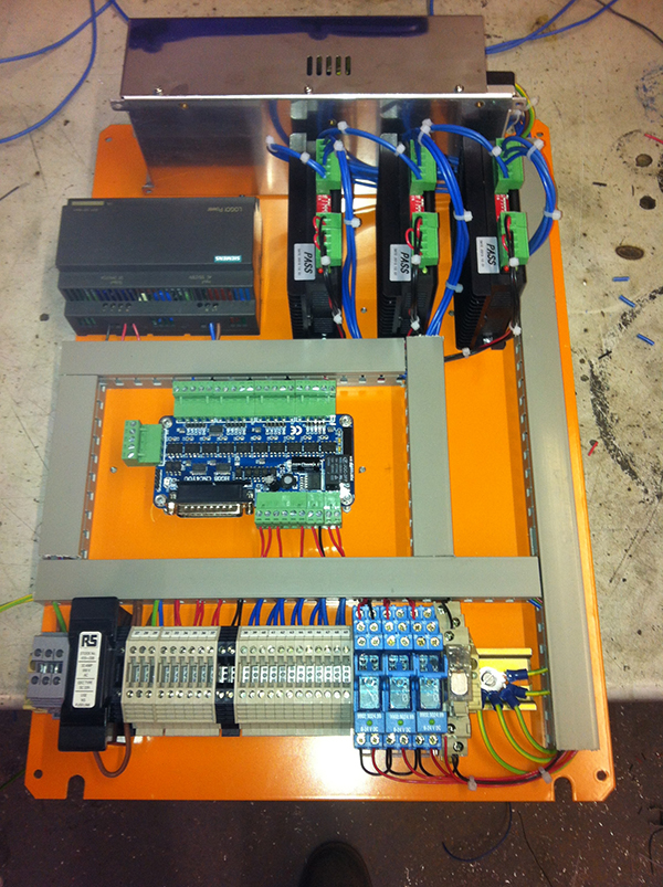

  6. #46
    Got the panel wired today...
    Just need to figure out a slat support system and I can start test cutting :)

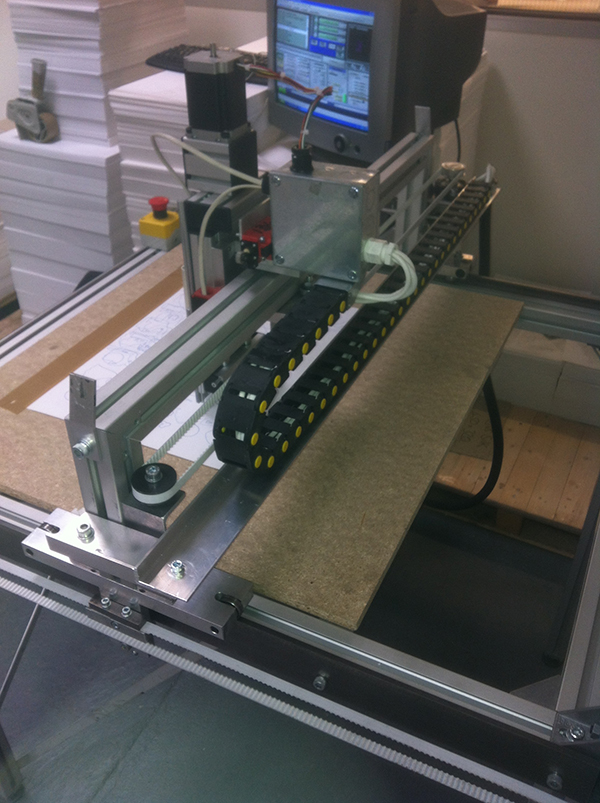

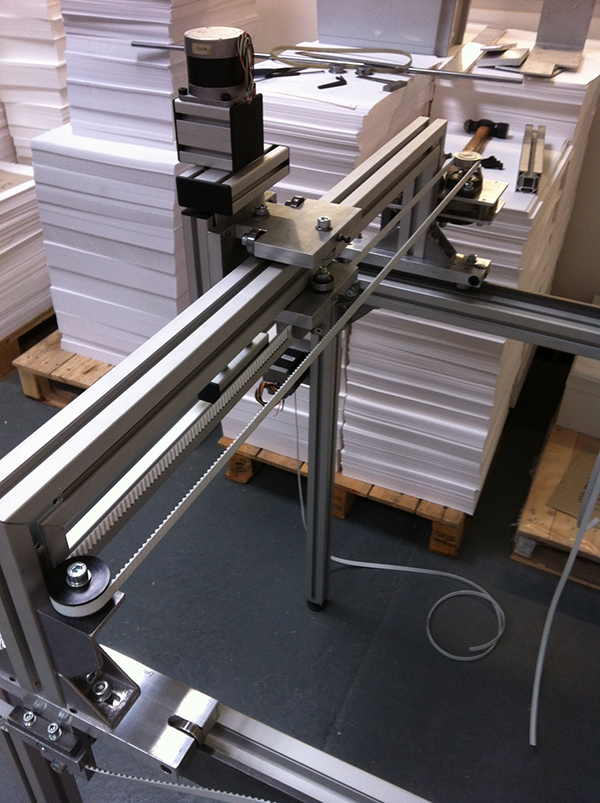

  7. #47
    Tidied things up a bit today,
    Pretty much ready each for the table bed and the torch I think. Can't think of anyway to harden the electronics further, it's got a relay isolated 24v control circuit, decent grounding, steel cabinet, no low level signals outside the box, so on.
    I've got someone cutting some slats for the bed, seemed the easiest way.
