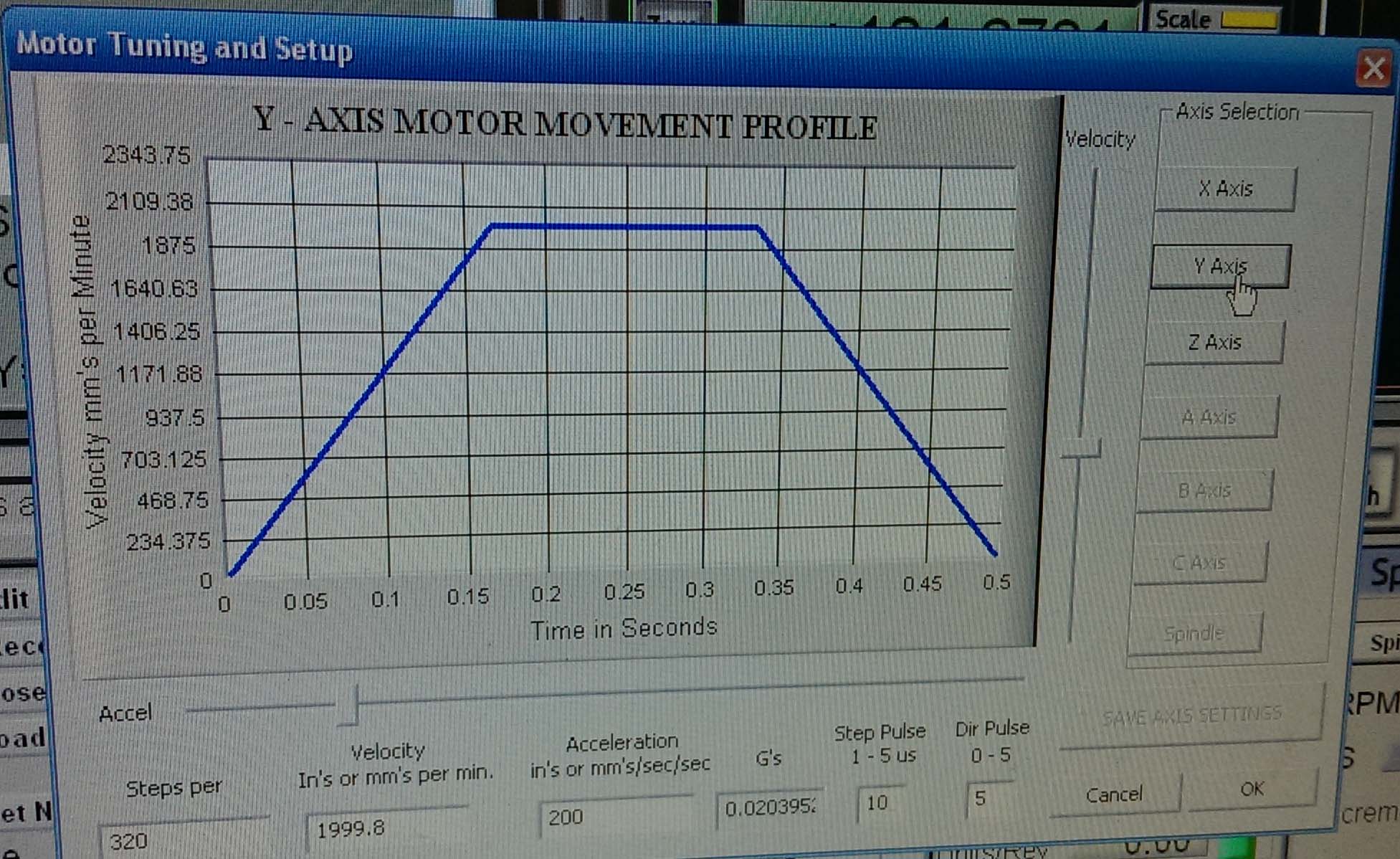

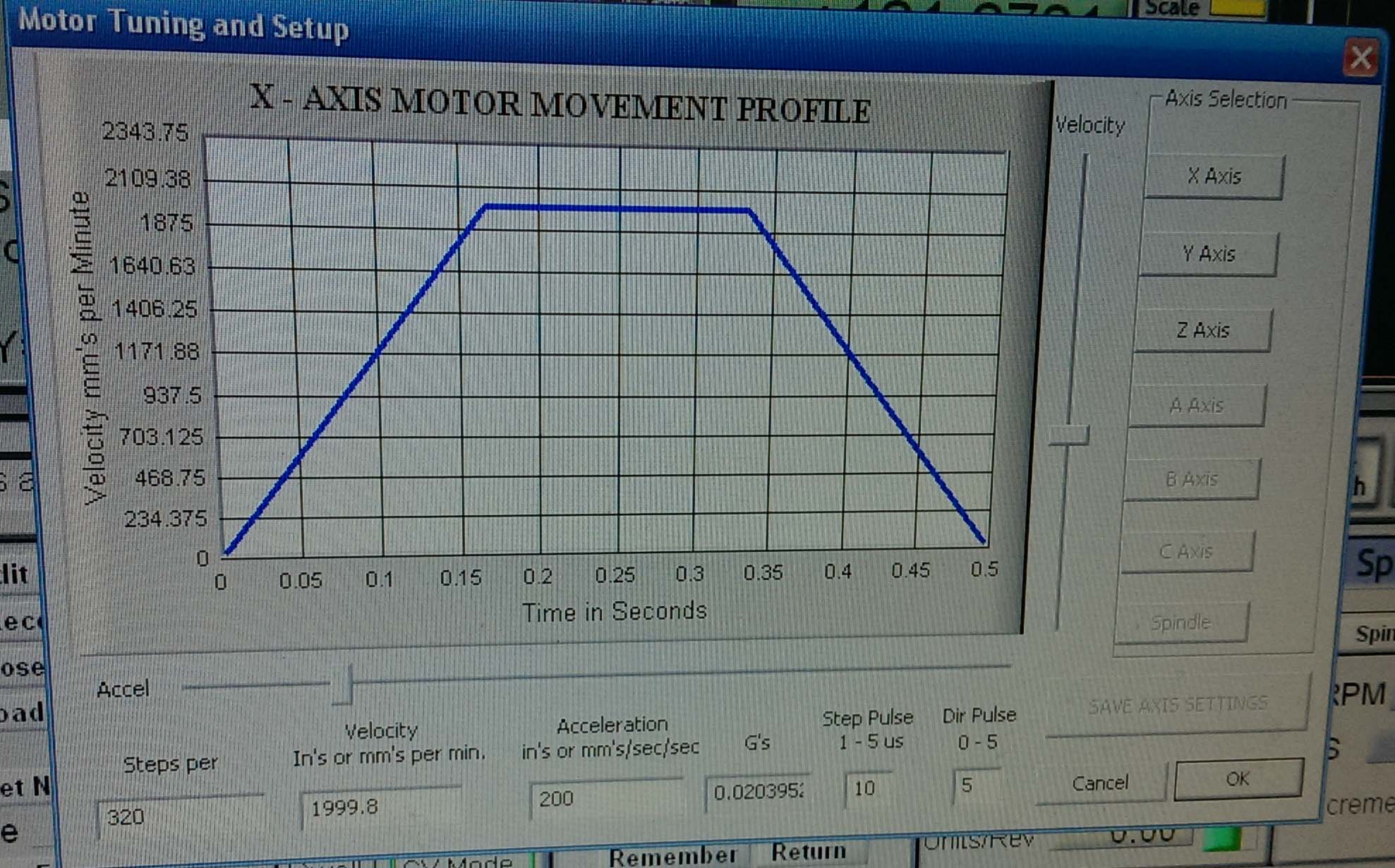

    I wanted to update you on my progress with getting this jumping/ noise issue out of the way. Well... I figured that you guys Jazz I think mentioned it first that I was expecting too much and the speeds were too high with the rapid and cutting settings.
    Well, Lo and behold after trying lots of different tuning combinations. I discovered setting the speeds too low also made for some horrible sounds. But I came across a another post with some supplier recommended settings. That were indeed a lot slower than what I had been gave.
ID:	11297Click image for larger version.
ID:	11298Click image for larger version.
    These settings were actually found to be the best for my 6040 machine. And they are
    steps velocity accel' step dir
    X 320 2000 200 10 5
    Y 320 2000 200 10 5
    Z 320 800 150 10 5
    My old settings that made the occasional noise and stalled the motors were
    X 320 3000 200 3 1
    Y 320 3000 200 3 1
    Z 320 800 200 3 1
    It sounds loads better now and doesn't fly about making my table shake slightly with the speed of movement of the gantry.
    I have re-cut a few test pieces and haven't had the horrible sound or any missed steps.... yet ;-) Never say never eh!
    I just want to say a really big thanks to all you guys for all of your invaluable advice I really do appreciate it and would have been stuck without all your help. cheers guys

    Looking at your motor tuning with 320 steps Per setting and presuming a 5mm pitch screw means the drives must or should be set to 1600 micro steps.
    This is relatively high for these machines so It could just be your system can't handle that many pulses and your getting missed steps.?

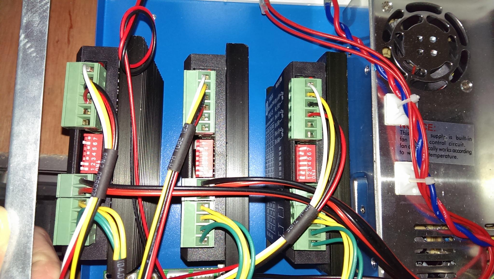

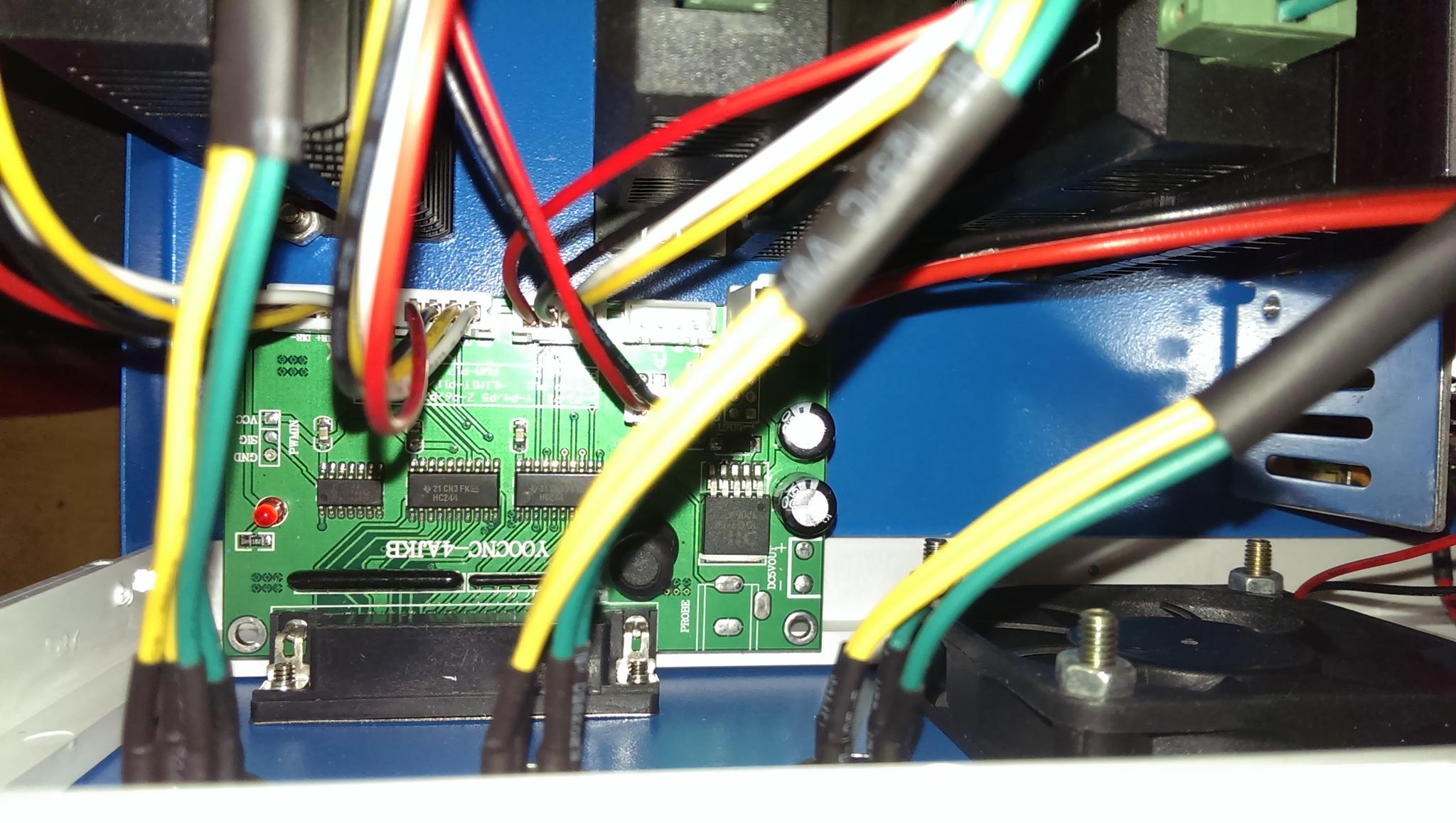

    Just got frustrated with trying to get it running consistently! I have just gone out and taken the case off and had a look inside.
    It looks like the switches are set for 1600microsteps. From the PSU I can see on the label (DC output 24v and current 12.5A) outside case says drive voltage 24v DC drive current 3A.
    The kernel speed is set at the lowest setting 25khz? I have attached some pics of the controller.Click image for larger version.

    My friend had a similar problem a few years ago, after a lot of messing about, we found a few important but simple things helped out.
    1. Check your parallel cable, and both connections, ( someone on here already mentioned it ),
    2. Try not to cross any of the cables for the axis, especially with the spindle cable and keep them away from estop cables. but try rout them away from each other, or at least insulate them a bit.
    The version of Mach your using, did it come with the machine
    3. Some of the Chinese suppliers send out hacked versions of mach ( can not remember the build number ), and its full of bugs,
    2 years ago, when dealing with a problem on my friends machine, the hacked version of mach was buggy on the axis drives and spindle speed setup for slow spindle rates.
    edit. just looked at your wireing again, you have 3 axis power cables running very close to your other wires, If your Y axis driver is the one on the right side, i would route them power cables elsware, or at least dont let them get close.
