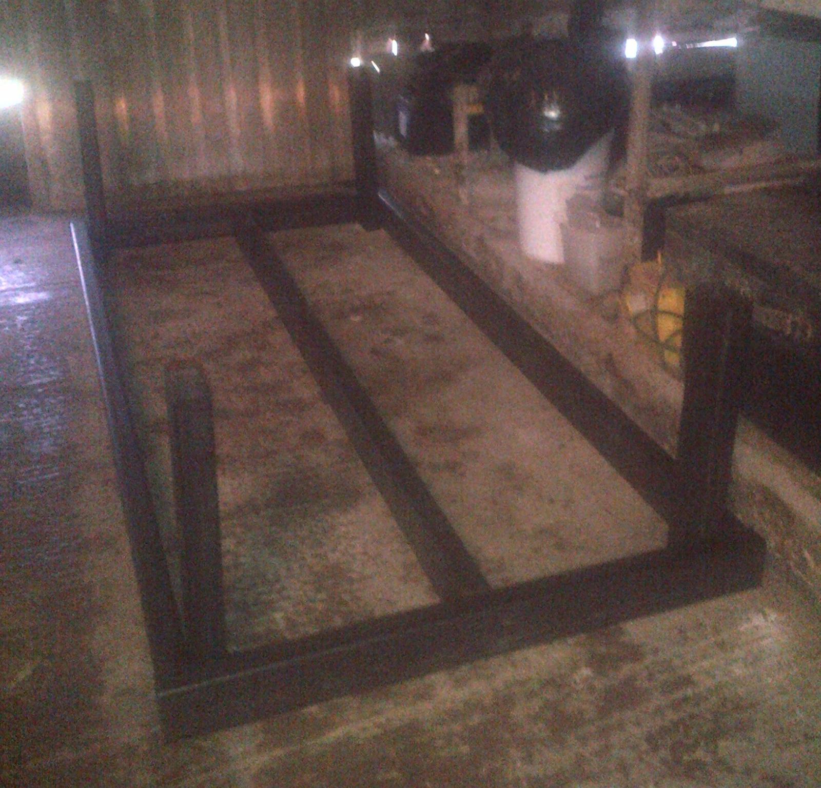

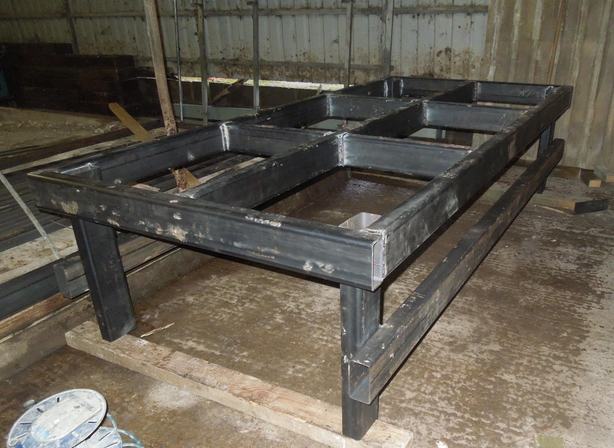

    sounds like you have it all worked out! we expect plenty of pictures
ID:	11324Click image for larger version.
ID:	11325 Here are the first two Pictures Started welding last wednesday and Saturday, didn't realise how much welding there is in it, Ive still got corner holding plates, two middle braces, 4 more legs, Diagonal braces and of course the Runner supports for the rails. then Ill be ready to start making the Gantry. I was thinking Brake pressed or welded steel Made boxes and steel across the gantry itself to take. Rails which will be profile with carriage.
    Although the frame will easily support 1 ton of stone It will also be bolted to the Concrete floor where it will be placed.
    Input would always be welcome.
