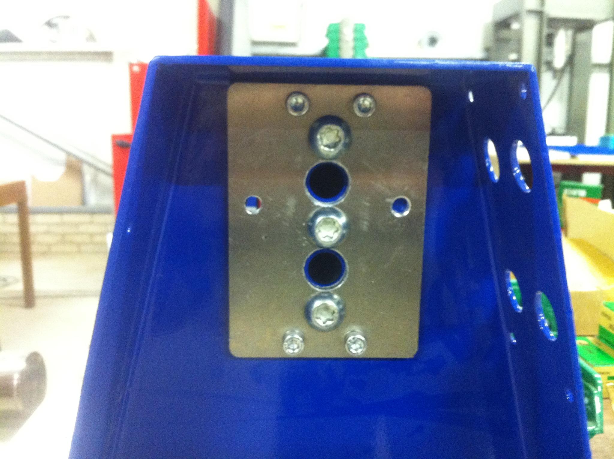

    So finally I've got round to starting this build log (to help motivate me to finish the build!)
    The specs -
    Cutting area of 3050mm x 1525mm x 150mm
    Aluminium/Steel Construction
    Hiwin Linear Guides (25mm & 15mm)
    Rack & Pinion all 3 axis
    Closed loop steppers (through belt reduction 3:1)
    1.2kw HF Spindle
    Option for tangential cutting knife
    USBCNC software CPU5B
    Full Vacuum Bed made from aluminium box section.
    So now you know where I'm going, this is what you all want, PICTURES! Click image for larger version.
