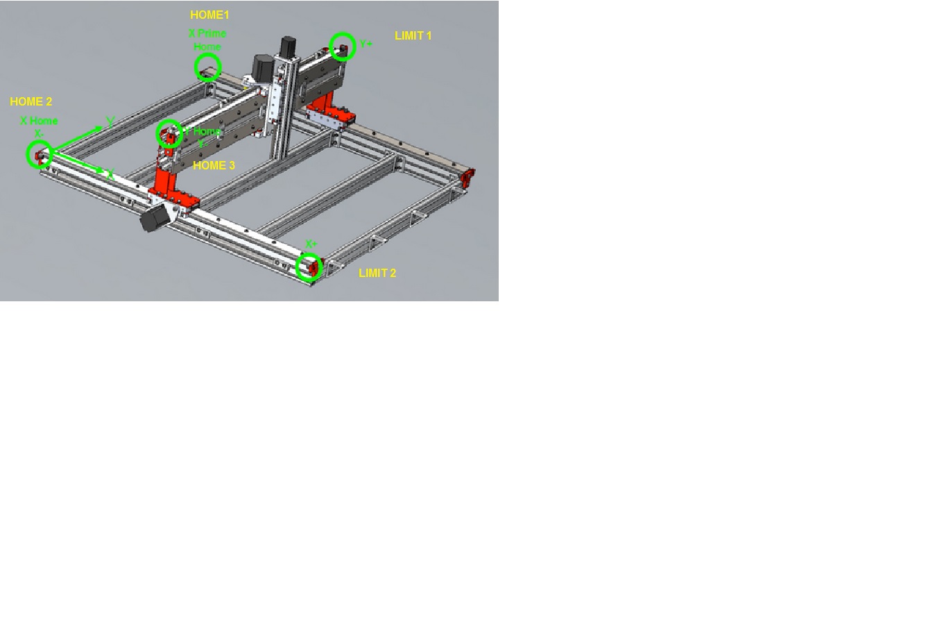

    JAZZCNC I've tried to map out what you've described in the PDF below. I've also attached the CNCRP diagram of where the relevant switches are located on the machine.
    S1, S2 and S3 on my machine seem to relate to S1 - Y, S2 - X, S3 - X prime home. I've tried to match these up with Home 1, 2, 3 and Limit 1, 2 in the diagram. Hopefully you can offer some guidance if I've got the order wrong.
    Mapping these back to the pins in the control box this leave S1 unallocated which doesn't seem right.
    Would this setup eliminate the need for the mechanical e/stops I have or do I still need those on each axis? I would rather get rid of them if I could.

    Ok Well first of all under stand that you have 4 spare Inputs labelled S1-S4 and can use any you like for anything you like. In this case you have assigned S2 for Limits and S3 for homes. Could easily be S1 limits and S2 home doesn't matter so long has you Set the correct Pins inside Mach3 inputs. ie: S1 = pin2 so set Limit's ++ and Limits-- to pin 2.
    Quote Originally Posted by davrich View Post
    Now this is were it changes regards Homing because you have 2 switches Homing one Axis to square the gantry.
    So now you need to have the Second Switch (Home2) on X using it's own Input. The other switch(home Prime) can still be wired in parallel with the Y and Z axis so share same Input.
    Now you wire it just the same regards Brown and Blue but will need an extra wire for the (home 2) signal (black) which will go back to it's own input.
    So now you will have connections on the control will go.
    All Limits = S1
    HOME X(prime) Y & Z = S2
    HOME X(Home1) = S3

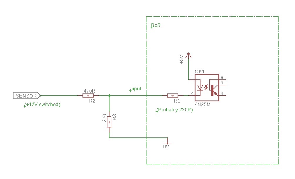

    I decided to upgrade my cheap proximity switches and makeshift wiring for some Pepperl & Fuchs ones.
    Seemed like a good idea, until now!

    Seems that the issue is that my old ones were NPN and the new ones are PNP.
    can anyone tell me whether this is easily fixable by some tweaks to the wiring or am I better off just getting NPN sensors?

    Sorry in a late reply to this - only found this thread by looking for information on inductive sensors.
    For 3-wire sensors:-
    NPN are low-side switching, so the sensor goes low impedance to ground in the presence of metal. PNP are high-side switching, so the sensor goes low impedance to supply-voltage in the presence of metal.
    This has a bearing on how you wire these to your BoB, or whatever (for now, "BoB"). If the BoB's inputs are opto-coupled AND it presents both anode and cathode of the optocoupler input then you have a lot of flexibility, and either NPN or PNP can be made to work. For an NPN you'd connect the sensor output to the cathode of the optoisolator, and wire the anode to +5V (or +12V through a current limiting resistor). For a PNP, you'd wire the sensor output to the anode, and the cathode to ground (and if the sensor is powered by 12V, then probably have to include a current limiting resistor as well). More typically the BoBs (at least the couple I've come across) have the anodes of the optocouplers bonded to their own local 5V supply and you have to have low-side (i.e. NPN) switching - hence the NPN being the sensor of choice.
    If you're stuck with PNPs and a low-side switching BoB, you *could* frig it a couple of ways. One to include a NPN transistor that is switched from the sensor output from the PNP - very easy, costs pennies and easily knocked up on strip board. Or, you *could* use the high-side switch to reverse-bias the LED in the optoisolator (it's naughty, but can be done) - connect the sensor output via a 470R resistor to the BoB input, connect a 220R resistor to ground (this allows the PNP to pull the cathode voltage up to reverse bias the optoisolator). In theory the cathode would sit around 4V with the PNP sensor "ON" and that's enough to stop the LED in the optoisolator illuminating. The only problem with this method is On is Off, and vice versa, that you have to invert the input in Mach3. You might have to play with the value of the 2 resistors, but keep the ratio the same (the series resistor from the sensor output having about twice the resistance of the external resistor from the BoB input to ground).
    Something like
Name:	Screen Shot 2018-02-18 at 12.31.49.png
    (Note: I've not tried this, but it ought to work)
    One word of warning - if you removed the pull-down resistor, or disconnected the 0V to it, you're going to exceed the max reverse voltage on the optoisolator and destroy that input. Either don't do this!, or place a diode - anode on the BoB input, cathode to the BoB's 5V supply to clamp the input voltage to not much more than 5V
