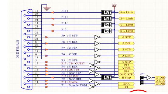

    The breakout board is a UIM2901-5A MACH3 BREAKOUT BOARD WITH SPINDLE SPEED CONTROL from zapp
    manual link http://www.zappautomation.co.uk/en/a..._attachment=90

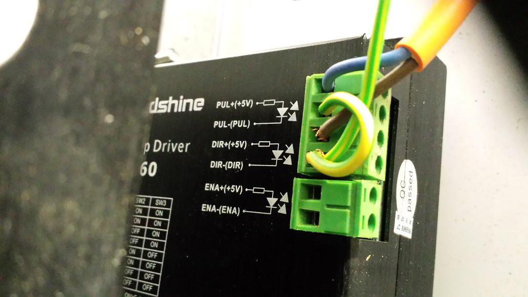

    the stepper drivers are leadshine m860s, manual http://www.leadshine.com/UploadFile/Down/M860m.pdf‎
    the wiring, is basic.
    simply
    Y AXIS STP >> PUL +
    Y AXIS DIR >> DIR +
    then DIR- and STP- wired back to the common on the same power supply the bob is wired too.

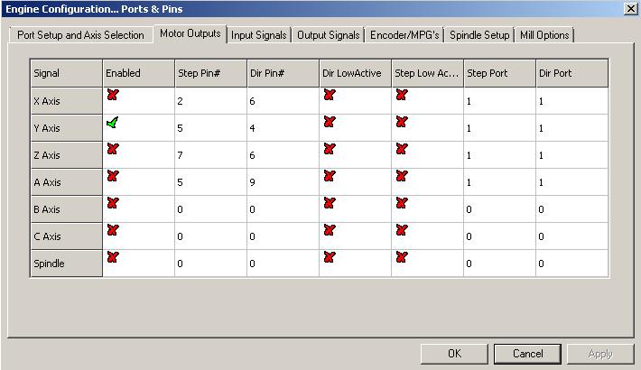

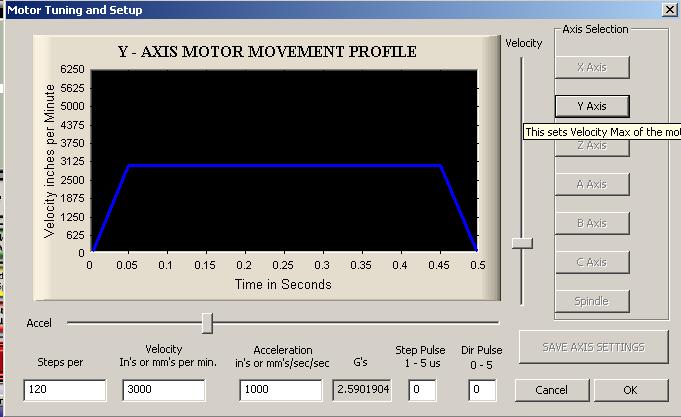

    and mach is set up as the manual suggests

    If, I put the voltmeter across the end of the parallel port (pin 4+ , pin 24-) I read 3.3v when 'jogging' the Y axis in one direction, and 0v when jogging in the other.
    likewise, if I put my voltmeter across DIR+ and DIR- on the driver (ie after the BOB) I get 5v one direction, 0v in the other
    Ive repeated the above example using an LED. (led ON one direction, off in the other)
    ive repeated the above 'test' using the pulse pins as well, it all appears to be working (ie until you jog, it reads 0v, you jog it goes high)
    Problem is, I obviously cant prove the Pulse in the same way. However I can 'hot potato' the PUL+ on the driver with 5v from the common supply and watch the stepper motor move.

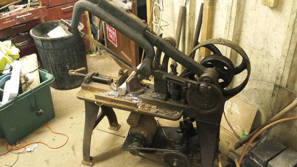

    ps in other news... got myself a donkey saw!!!

    When jogging, if the pulse signal is correct then it shouldn't go to 5V. It's a square wave, with 5us high time and at low speeds the low time is much greater. However you can still get meaningful readings with a standard meter. The meter should read anything from 0 to 0.87V (rms), depending on the feedrate. You could try running at the rapid speed you set (3m/min) and you should get 0.87V across the pulse input and 0.57V across the parallel port pins, assuming the meter is true rms which most are nowadays.
    You can also try setting the pulse output to be direction, to check if it's switching.

    Have you just been trying to run one of the axes or several? It's possible that one or more, but not all, of the outputs on the breakout board are damaged. Do the inputs still work?
    There are three ICs near the parallel port connector on your breakout board. Can you read the numbers to identify them? If so we can look at the datasheet and probe the board to see how far the signal is getting.
    There's not a lot wrong with wiring the parallel port directly to the stepper drivers, as they're opto-isolated. So long as you wire it up correctly - i.e. outputs to the step+/dir+ inputs and step-/dir- to pin 25. The thing that's probably stopping that method working is the parallel port is only 3.3V, yet the drivers require 5V.
