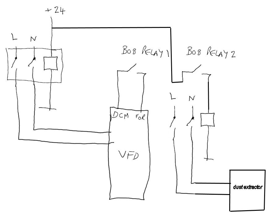

    As Dean says, like this;
    Cool. Thanks! I will be using the other bob relay to control the dust extractor on and off. Will this be ok to do via the 24v system relay switching the mains and the bob relay completing the circuit to power the 24v coil? Similar to how I was going todwitch the power to the vfd?

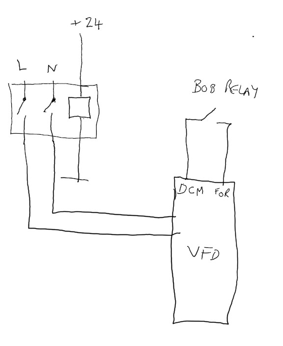

    Try this

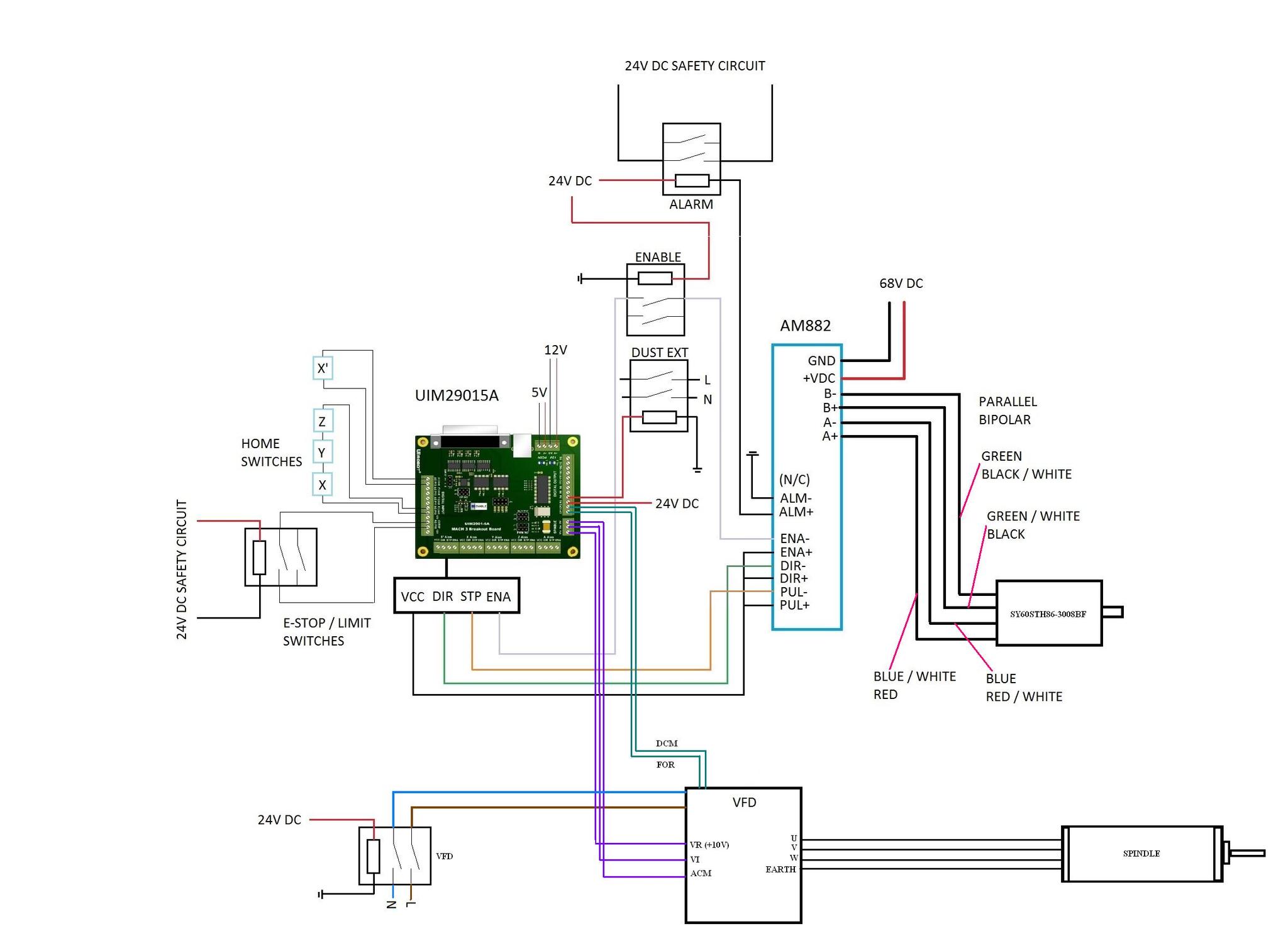

    just wanted to check that everything seemed ok before i go ahead and wire it all up.
    My questions are:
    1 to kill the enable to the driver is it done via a relay contact - if the safety circuit is tripped the contact will open - as per the diagram? will each driver enable have to go through a seperate relay contact?
    2 With the charge pump, does this disable the enable signal within the BOB if activated?
    3 If there is no power to the driver, will it still provide a nc contact for the alarm? i want the alarm to break the circuit if it is activated, tripping the safety circuit.
    4 Is the general wiring of the bob to driver and driver to motor ok ?
    cheers!!!
Name:	BOB Wiring.jpg
    Dan
  9. #19
    1. You don't need a relay for the enable signal, just take a wire from the bob ENA terminal to each AM882.
    2. Yes, when the estop signal is lost the bob will disable the drivers via the ENA signal and charge pump, that's why you don't need the ENABLE relay.
    3. The default setting of my AM882's alarm signal was set so that the ALARM relay was 'off' when everything was healthy. If you want to change that you will need to use the ProTuner software and change the polarity (page 27 in my AM882 manual). Also it's not a relay inside the AM882 it's a transistor.
    4. Other than you don't need the ENABLE relay the diagram looks okay.
