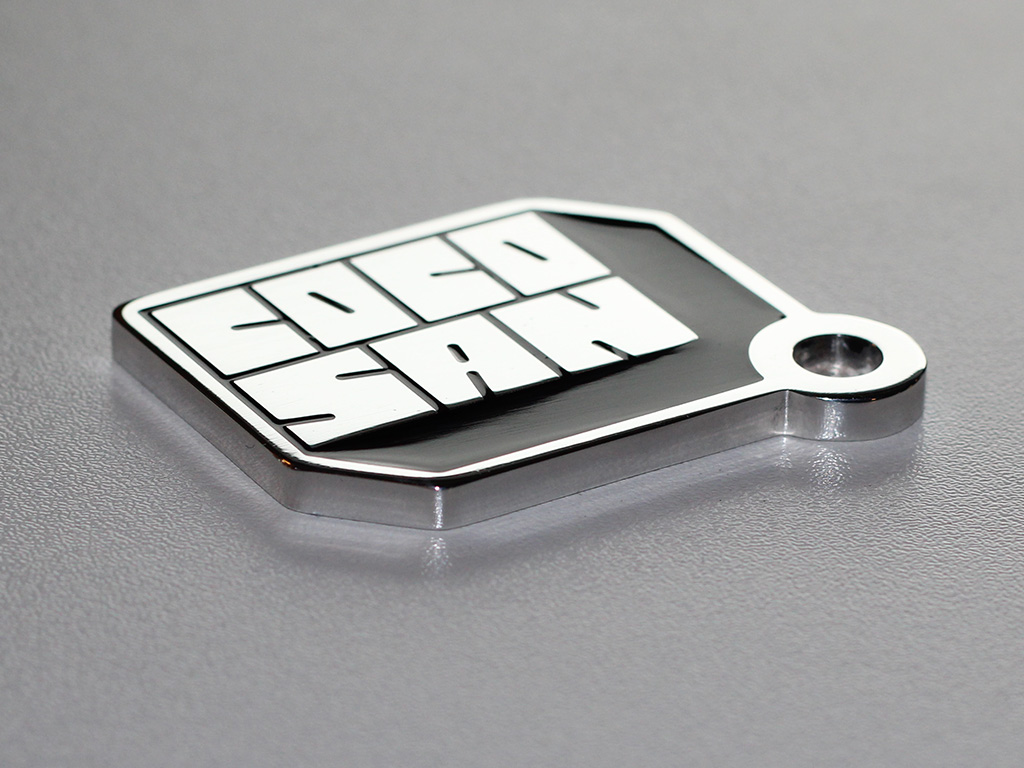

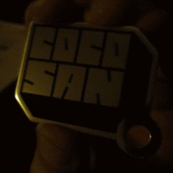

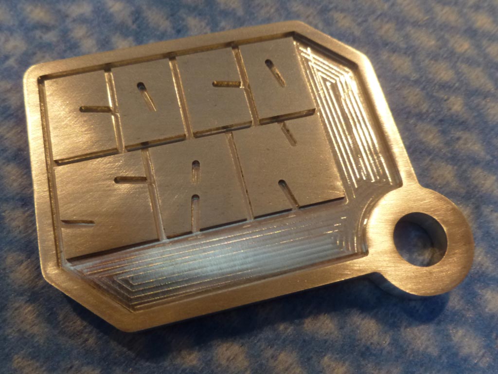

    Heh, two years on and I've finally got around to having a play with some cold-enamel / epoxy resin in-filling. I bought 250g of resin, 250g of hardener and a pot a opaque black paste from Cookson Gold in the Jewellery Quarter, Birmingham.
    The object is a key-ring that I've made for a mate of mine:
    I'm 85% happy with the results - the epoxy itself is amazing stuff which gives you 45 minutes to work with it and cures fully in 24hrs. I'm more concerned by a couple of small flaws where perhaps the epoxy hasn't flowed sufficiently into the narrower channels - the only way to get it into the detailed areas is to over-fill and encourage it with a cocktail stick - this leaves a fair bit of cleaning-up to do once everything has set which in turn means having to polish the epoxy - it never looks quite as pristine as it would if you'd just poured it and left it alone... Looking forward to using it to fill larger pockets where the metal has been finished pre-pour, but I reckon I'll have to practice a bit more with the smaller scale stuff.
