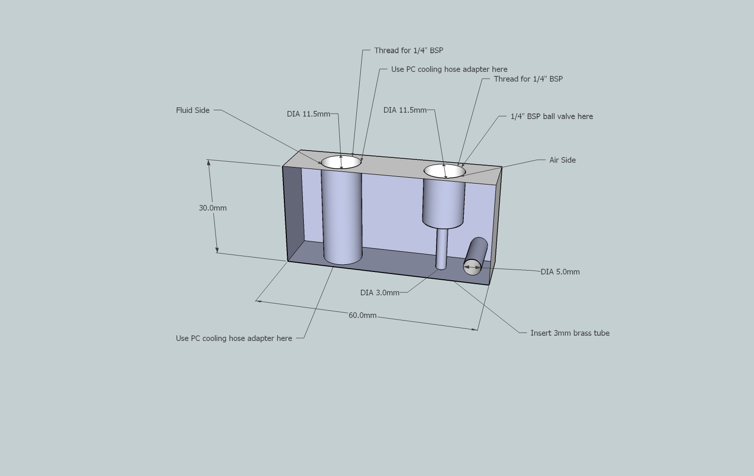

    Hi Wal,
    I don't have experience with that unit, but have just created my own by running an airline into a block of ali and reducing that into a 3mm brass tube and then mounting a reservoir on top of my z-axis and running a fluid tube (PC coolant stuff) through the same block, where it then drips into the airflow from the brass tube.
    I still have to do something more controllable to the fluid tube than a clamp but it works well, as you hopefully can see if you go to my youtube channel (also shows some evolution on the z-axis). That might be a cheaper option for you and especially as your machine has a fixed Z iirc.
    Linkage: CNC Router Milling Aluminium #5 - YouTube
    Chris

    This might help (I rarely do anything these days mechanical without doing at least a Sketchup first).
    Hardest part was blind threading the air side 1/4" BSP thread.
    You should be able to see on my video that all I've done with the "nozzles" is tie them together with the fluid on top so that it drips into the airflow below it. I was using an airbrush previously but that ate through fluid and fogged the entire workshop up in minutes.
    Hope that helps.
Name:	Mister Block v1.jpg
    My solution is currently on the Heath-Robinson side, I'll re-engineer it at some point.
    I'm using copper brake pipe for air chip clearance, the nozzle was formed by crimping the end of the pipe in a 3-jaw chuck with a bit of piano wire down the middle to keep the required jet size opening.
    I added to this an old-style adjustable drip-oiler with a length of tube directing the drips onto the chip clearance air pipe a few inches above the end. The result is fairly coarse droplet lube with no discernable contamination beyond the guards -
    Apologies for the poor video, it wasn't intended for public release but hopefully gives an idea of the setup,
    ATB,
    Nick
