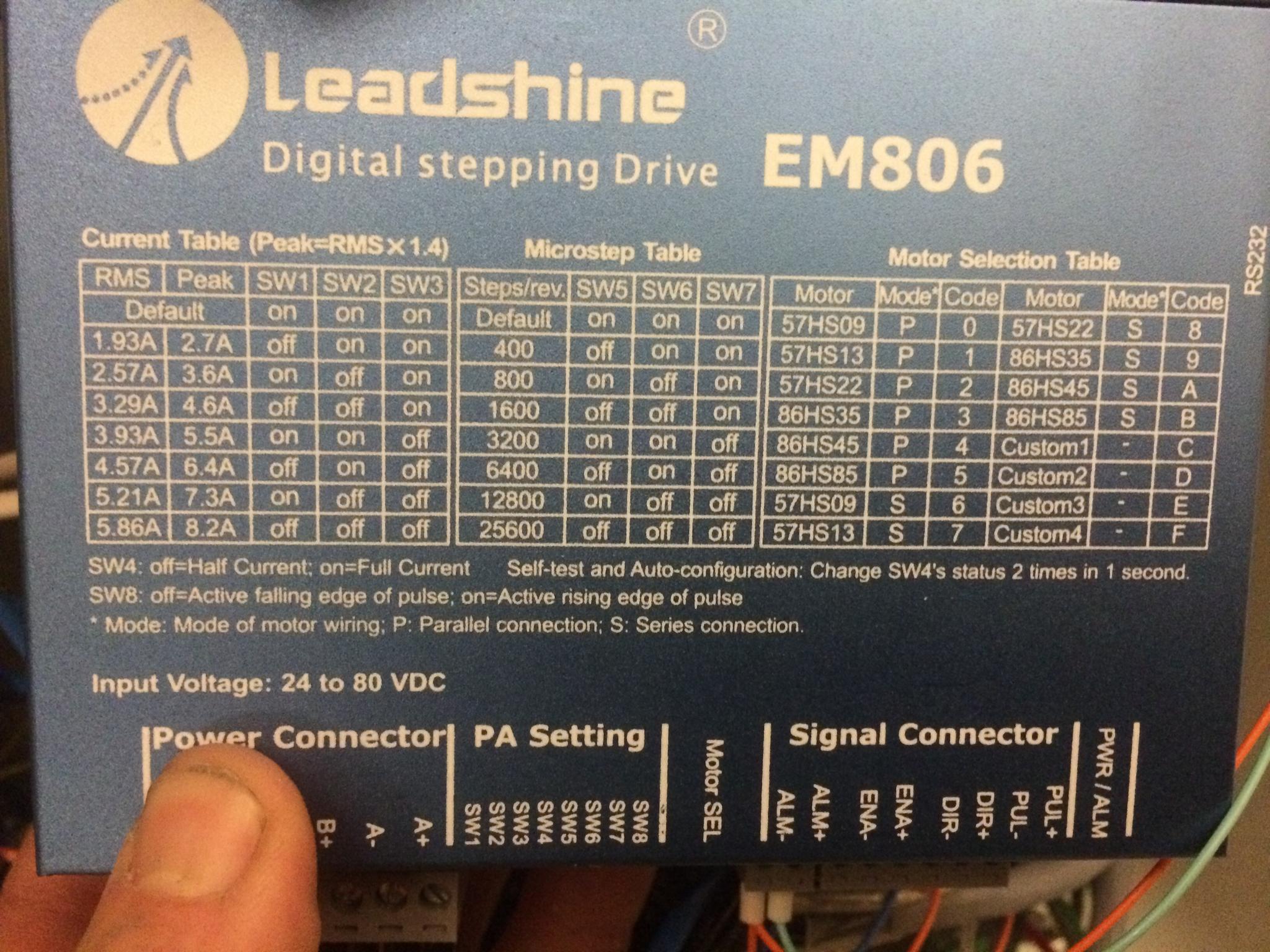

    Great many thanks uncle jazz haha I have now changed the ms and it sounds way better . Back to the em806 drives and we have just measures the idle current and it seams switch 4 half current needs to be set to off it went from 1v to 1/2 at standstill this also matches what it says on the side of the drive.
  6. #266
    Quote Originally Posted by charlieuk View Post
    Erm interesting those markings are different to last few sets I've used. I've got some drives in stock waiting to fit to a machine and just checked and they are same as those you have so looks like they have changed.? Colour is slightly different as well, much paler colour.!
