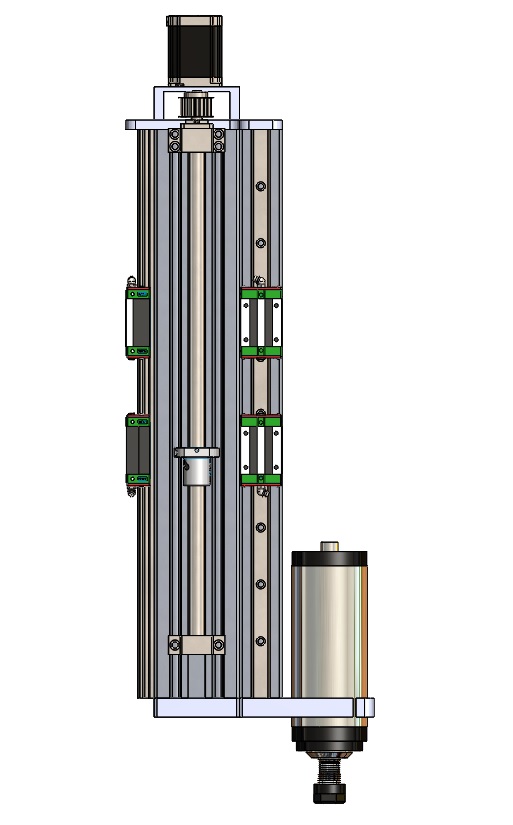

    cheers many thanks for the reply, yes one of the things i will be cutting is stand up paddle boards but hope to use it for ply would and other things
    If you want to cut plywood at all seriously, then I'd be concerned about the strength of your cantilevered gantry design. The cutting force for polystyrene is practically zero, so you can get away with a very weak gantry, but that's not the case for plywood.
    Also, for the axis on the gantry (Y-axis?) your bearings are quite close together on the rails compared to the spacing of the rails, so I would be inclined to drive it with one ballscrew on each side, or at the very least make sure the ballscrew is centred between the two rails. The problem with the former is the ballscrew would intersect the Z-axis, so there may not be space for it. If you put a single ballscrew on one side the bearings on the other side will deflect more (i.e. it will rack like a typical CNC router gantry), so the obvious solution is to use two ballscrews. That's quite expensive though so you may want to just try it and see, but keep in mind the possibility of adding another. You could also increase the bearing spacing. It's hard to say for certain as it's difficult to discern which parts of the machine have the lowest stiffness and thus which parts should be improved if you want to cut plywood efficiently.
  4. #24

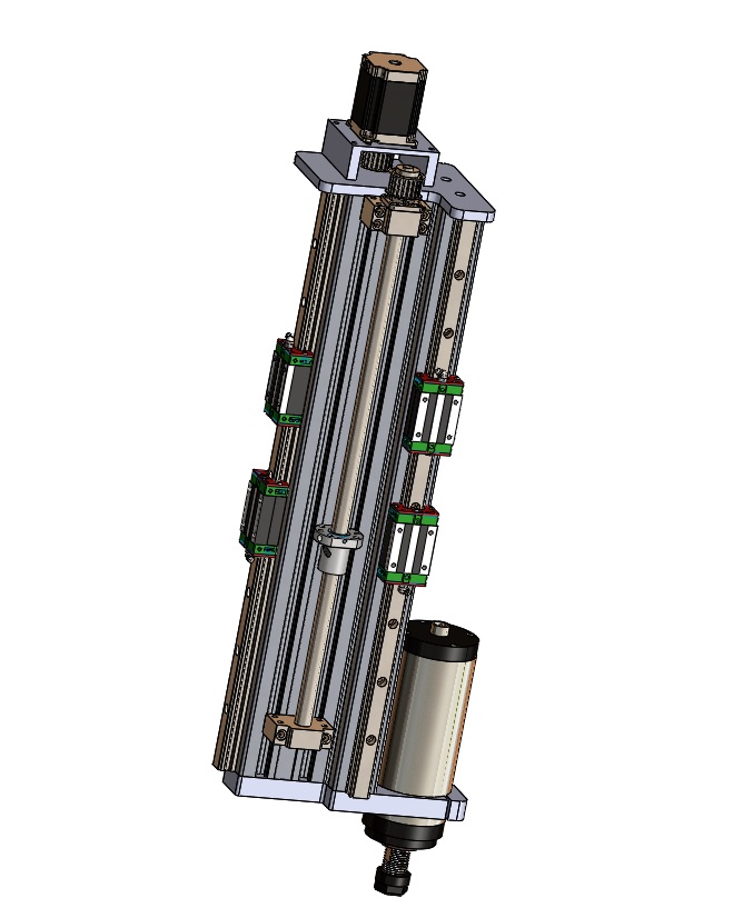

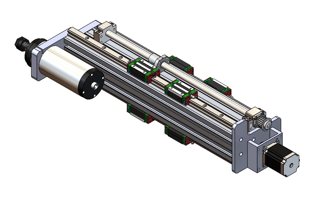

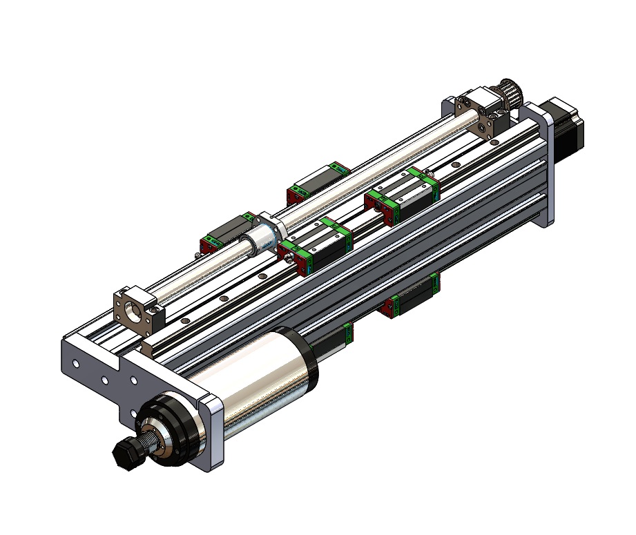

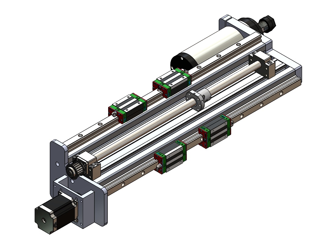

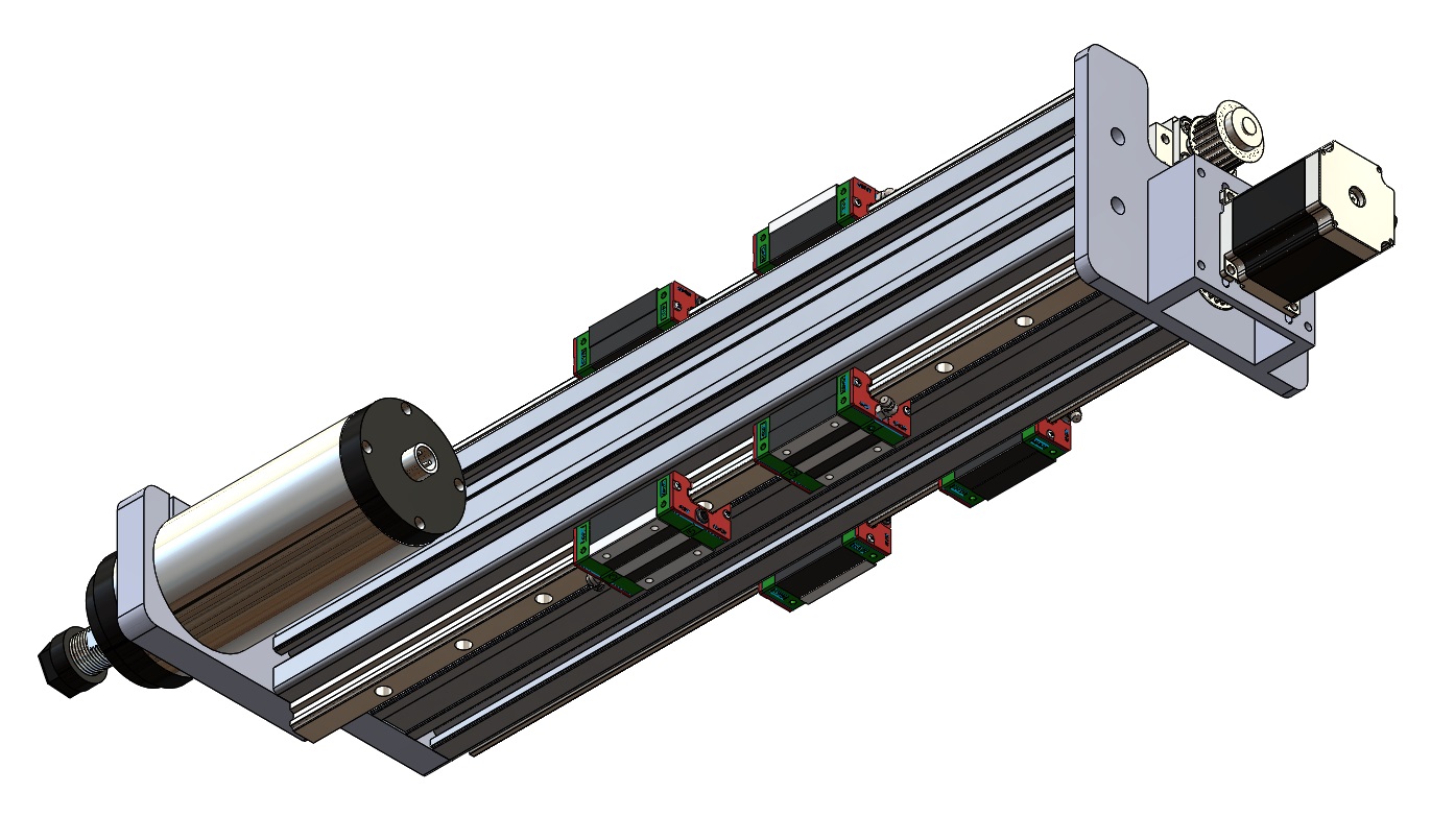

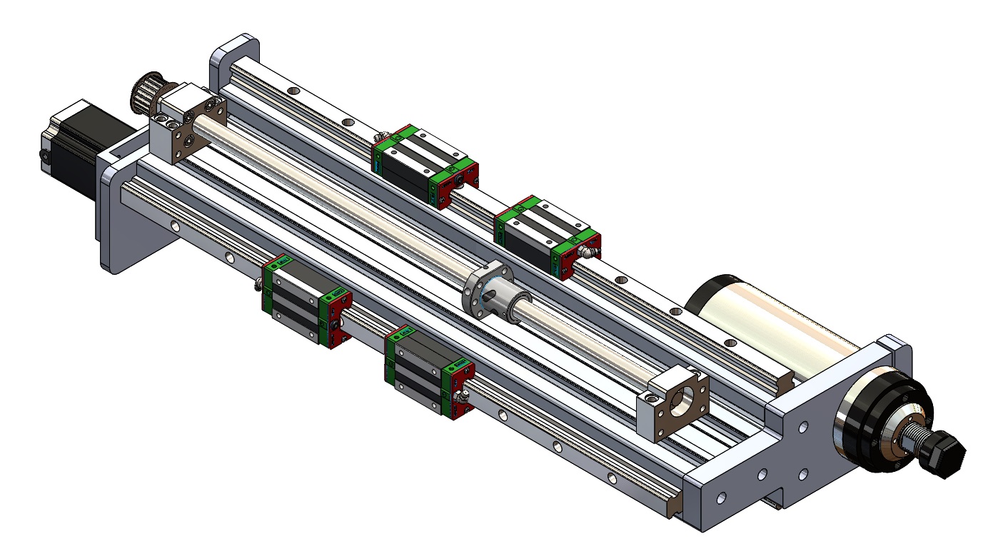

    Agree with Jonathan about being better to use twin screws for Y axis and to some degree that Z axis will be weak for cutting plywood but with just a simple change it could be made stronger to the point it would manage be ok.
    It would cost more due to extra components and ballscrew placement wouldn't be the ideal but would stiffen things up enough. I've quickly thrown together a model to show you what I mean.
    Obviously I don't know the spacing etc in side the Y axis frame or how you plan to attach the bearings and what spacing but looking at your pics I think there'd be enough room.? Spindle is just there for affect and the real thing would need extra support.

    thanks for that jazz i can see what you are saying and we did wonder about the third set of blocks and there is plenty of room to fit it all in and i have made the y frame so i can slide one side in to be what ever size it needs.
    i was wondering about using 60x60 or 80x80 for the z axis but the 40x80 in a relatively short length seams crazy strong as it is.
    i guess what i will do it try and get the x and y rolling and see how that feels and with the way it is i can pretty much just add to it if does look like its not going to be up to the job. I was planing on using rack and pinion for y could i just run a second motor on the other side rather than a ball screw? or possibly even one motor with a shaft and pinion on ether end like a car axel, although that maybe a little more tricky to build
    if needed i could actually make the hole gantry narrower if needed just buy shortening a few bits if it would help.
    I should say that i am not after crazy speeds for cutting ply or accuracy for that matter as it will be just for stuff that i would normally make by hand so 1-2mm tolerance would be fine to start with.
    many thanks for all the advice i am taking it all on board

    Quote Originally Posted by charlieuk View Post
    Yes it may seem strong Now but promise you when there's a spindle on the end with cutting forces acting on it then at full extension at this length which you would be while cutting ply it will twang like a guitar string.!!
    The Z axis is THE single most important area on a CNC machine and seen as your going to so much trouble and expense using Profiled linear rails etc why spoil the broth for a pinch of salt.?
    Regards R&P then yes it would work ok and seen as your using it on other axis makes sense but you would still need drive it from both sides, thou it would be easy enough to run a shaft across the back of profile. As would it to connect ballscrews with a timing belt, which woud be my first choice.
    Tip for you if you use the Bosch Rexroth 45 x90 or it's equivlent then the BK/BF12 bearing block hole centres match the slots and make fastening very easy.
    This stuff Profile 45x90S slot 10

    all the aluminium i have used so far is ether 40/80 or 80/80 bosh compatible from kjn, i don't think changing the z will be to hard, i have some spare 40/80 i can use however the motor mount may have to go on the top like you have drawn which isnt so great as i have a hight restriction and need to keep it as low as posable so will have to see what i can come up with.
    i dont think its going to be posable to do the y with one ball screw any were near the centre as the z will get in the way which mean needing two which would be a nice build but would cost something like a further £350 compared to about £60 ish that rack and pinion would be so will have to have a little think.
    I think the max size bit would be 19mm but most i think are just 1/2" shafts so nothing crazy. foam likes to be cut quite quick other wise you get melting issues so you don't need big bits.
