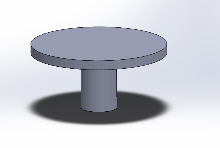

    That does make sence and is a good idea I have been thinking along similar lines but drilling some large say 1" dia holes in the table then using the cnc to drill some matching holes in the blank and using a large dowl to locate. Like you say it would be nice not to have to worry about the block being perfect. I guess I should try both and see
  2. #232
    yup, thats exactly what im getting on at .... dowels in a blank that locate on the table sound good ... maybe machine round patches into the foam , and have the blank circular in shape
  3. #233
    summing like that ?
  4. #234
    Not sure I quite under stand ?
  5. #235
    I was just thinking you need more surface area in the foam block .or the dowel will press into the foam .... So machining a bigger circular shape provides this larger surface area
  6. #236
    I see what you mean I was thinking the dowels could be quite long and go almost all the way through the block, i think it would be stiff enuf then if I used large dowels. It doesn't need ultra high accuracy anything less than 1mm would be very nice. I'm kinda hoping the method I find i can do with out having to change cutters which is a huge 5"x 1 1/4 bullnose or spend too long having to machine things to set up. I think we are on the right lines though
