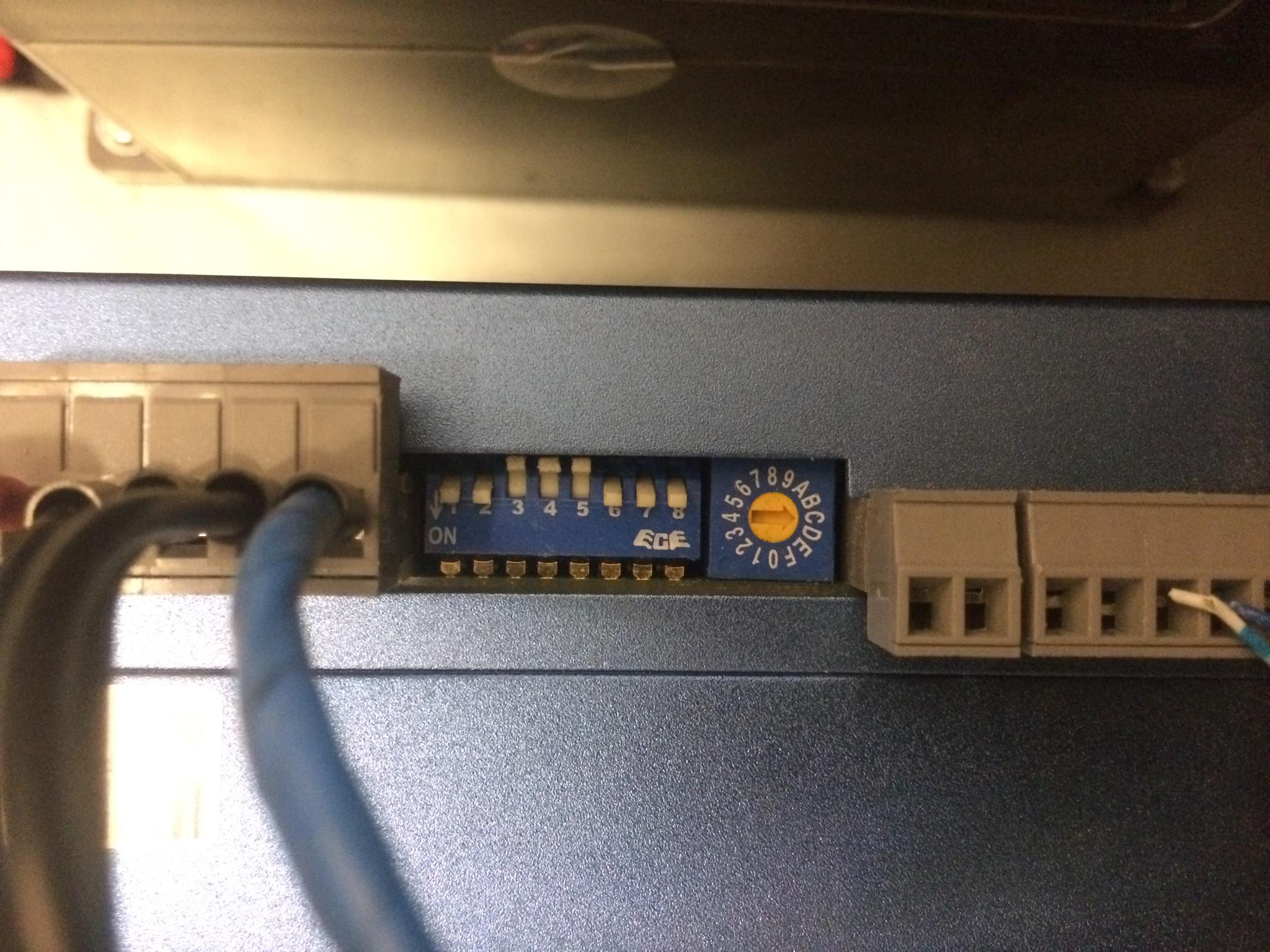

    Are you sure the drives are set correctly regards Amps and motor setting.?
    What number or letter is the dial set to on the drives.?
    Have you tuned the drives using protune or just using the dip switches.? If not try to use protune and make sure the amps are set correct for the motors. Wrong amps setting would cause this problem and the drives default to a low setting if I remember correctly. If you have the wheel set wrong on the drive it will think it's using differant motors and can default to low amps setting and wrong PID tuning in the drive.

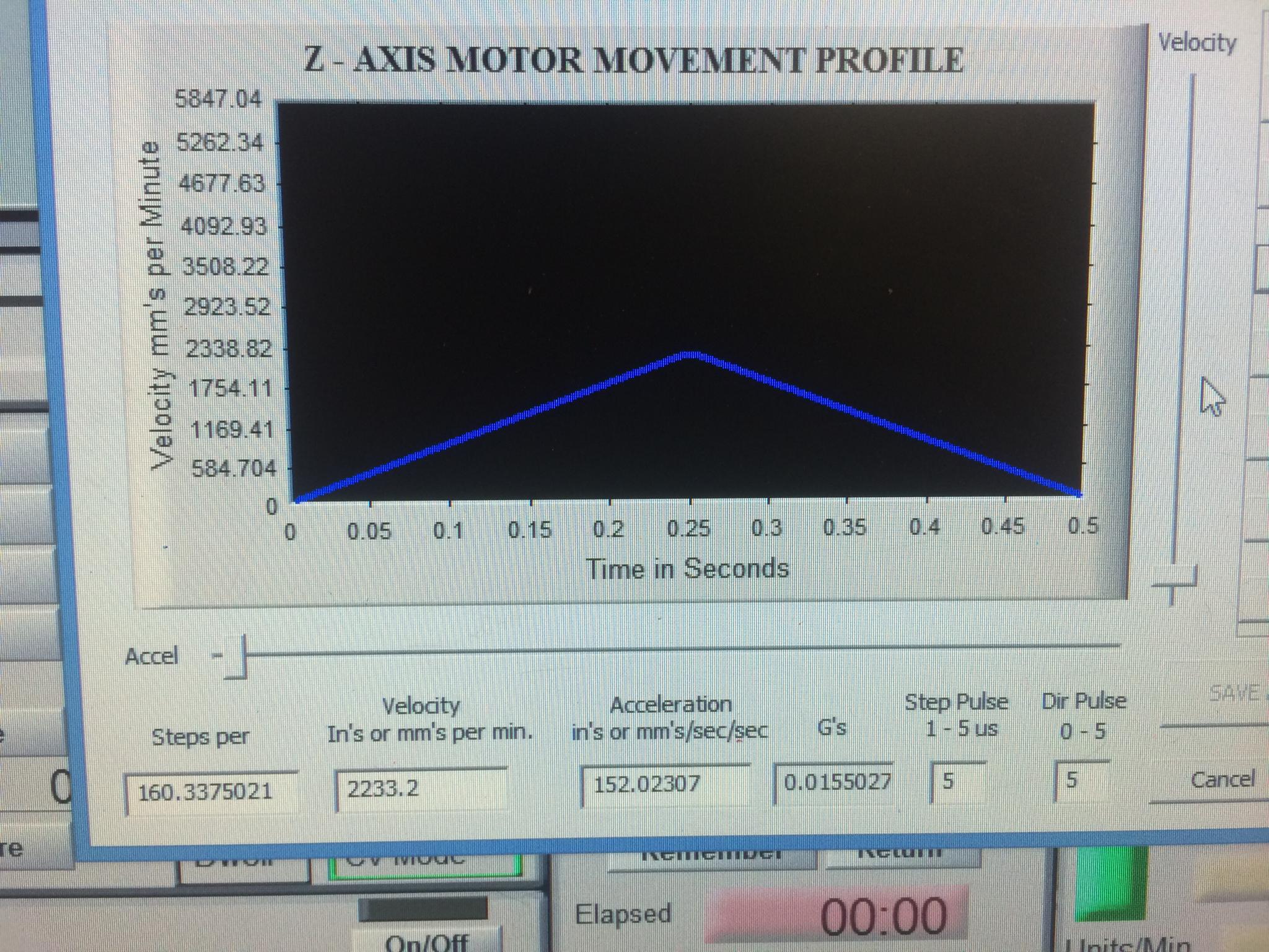

    150 on acc is far too slow for any z axis and you should be able to go much higher without any trouble. So this must be either your set wrong in the drives or there's binding at some point.!

    Ok that's good to know regarding temp, I will look at the settings tomorrow but we have them just set on the closest setting on the switches at the moment as I didn't really understand the pro tune. I will try and down load it again in to the new computer and see if it makes any more sense now I know a little more. The motors are quiet and don't seam un happy. I will be back with more info in the morning many thanks for the help
    These are the settings I have for the z. I am struggling to load a driver for the USB to 232 cable for windows 8 that I got from zapp. The cd it came with says windows 8 but it's all in Chinese. We have just swapped the drivers back and re running the file to see if the problem comes back

    We have been running tests all day. We have a ratio of 2.5:1 now. We have been playing with switching between the two drives. We just ran a test with the y and z swaped and without the spindle mounted up and it ran ok however we then ran the same test with the spindle mounted and it tripped the same driver however that driver is on the y axis so looks like it may bea setting in the driver? With a posable link to something else?
    Quote Originally Posted by charlieuk View Post
    Charlie your all cocked up on the settings both on the drives and in Mach3.
    You have the amps set wrong on drives because your using RMS settings not peak so they are getting too many amps. This will make them get hotter than should also you have the stand by current set to off so they will get hot when stood still.
    So set up Dip switches like this and then try.
    1=OFF 2=OFF 3=ON This will give 4.6A which is slightly higher than motors are rated and normally I'd say use next lowest but in your case it won't hurt for now. Thou I would set it correctly in protune at first chance.
    4= ON
    5 /6/7 Leave as set for now thou I would normally use higher than 400 micro steps for smoother motor movement. But you have the steps per set wrong in Mach3 which i'll come to next.
    8=ON
    With Mach you need the steps per setting to 200. This is because you have applied a ratio and now your affective pitch as gone from 5mm to 2mm per Rev.
    So 400 / 2= 200 steps per millimeter.
    Try these new settings and see how goes.

    Dean I notice the arrow on the drive is pointing to the letter C is that correct? .. Clive
  8. #7
    Yes it's the first custom motor setting. slightly differant to AM882 clive.

    sorry the picture I posted was when I still had it with the 2:1 ratio it is now set at 199.98 or something around that for the 2.5:1 ratio (this we done through the calibration function in setting on mach)
    from my reading of the leadshine manual on page 14 from what we can tell it is saying switch 4 should be off for reducing the idel current?
    since we re auto tuned the motor it has not yet stopped again but will adjust these setting once clear on them.
    Not in my manual see pic.!
    If you change the Amp setting which you really should then you'll need to re-tune the drive. Always re-tune with any changes made.
