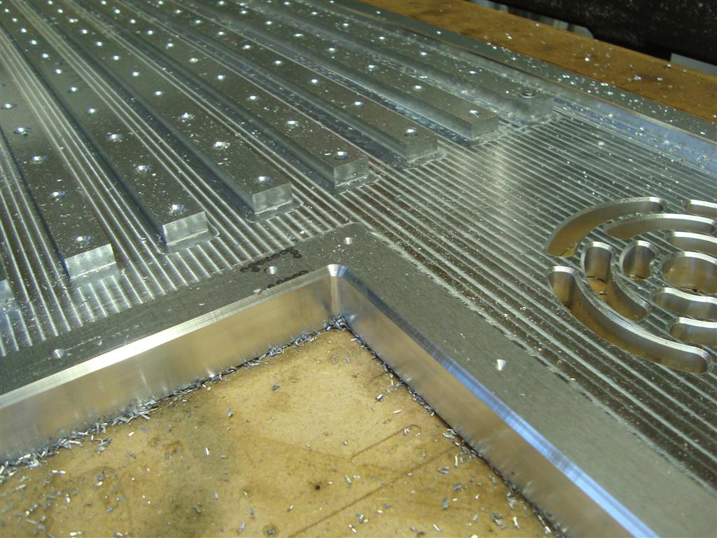

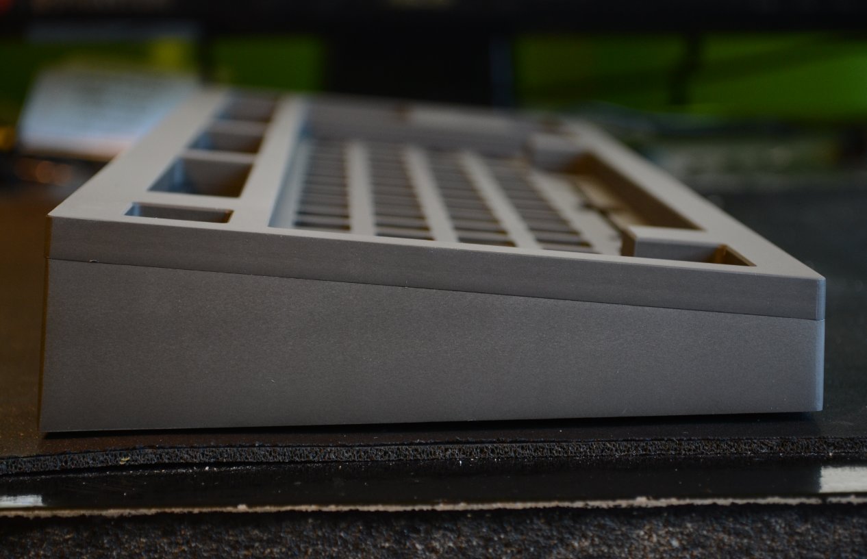

    What are you mounting the workpiece on? It can make a big difference to the finish - for example I found it easier to get a good finish when taking a small cut with my machine when it had the MDF bed. Presumably the MDF's damping properties helped. If the parts are small you'll obviously have problems with rigidity using MDF, but if they're a reasonable size and you add a finishing pass (take off 0.1-0.2mm from edge in one pass) you can get good results, e.g:

    (20mm thick parts and 25mm thick bed)
    I've still not measured, but I'm pretty sure your machine is stronger than my 'old' one which cut the parts above (and below), so unless you have big problems with resonance you should be able to get similar results. Perhaps MDF is worth a shot? That's not to say you can't get a good finished clamping rigidly to aluminium, it just takes a bit more care/luck setting the feedrates, e.g:

  8. #28
    Hi Jonathan,

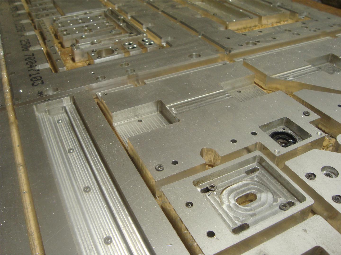

    If you look at the last photo in post 19 you can see that I generally use an 18mm piece of chipboard if I need to cut all the way through. The part I cut out in the last photo does actually have a better finish than the parts in the first 2 photos - possibly because it is cut out of a much larger sheet.
    If you look at the bed you can see gaps between the profile sections used to make up to bed. The machine is used primarily for cutting wood and in that mode it has a large sacrificial wooden sheet which sits on the bed. This works well for wood machining.
    If I end up doing a lot more aluminium I can see that I may need to either add a lot more profile sections to give less gaps, or invest in a large thick aluminium sheet to bolt to the bed, skim it, drill and tap lots of holes.
    I'll keep experimenting with F&S as I machine out more upgrade parts, plus try some with a finishing pass.
