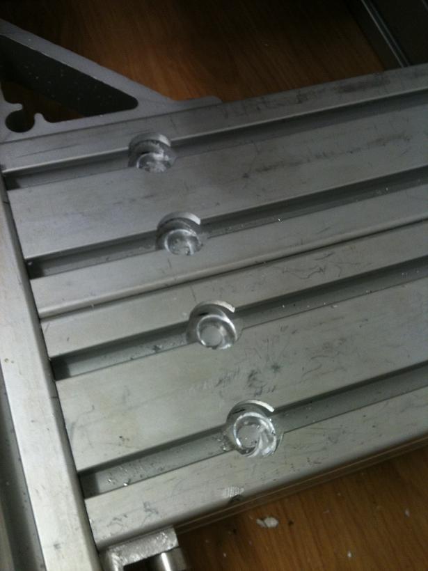

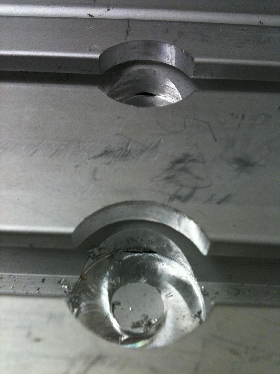

    I'm still playing around with DOC, F&S, but here are some photos of holes I cut in the bed to allow nuts to be added for clamping things down. Finish is not too bad - you can see the finish on the sides of the hole, and at the bottom of the hole.
