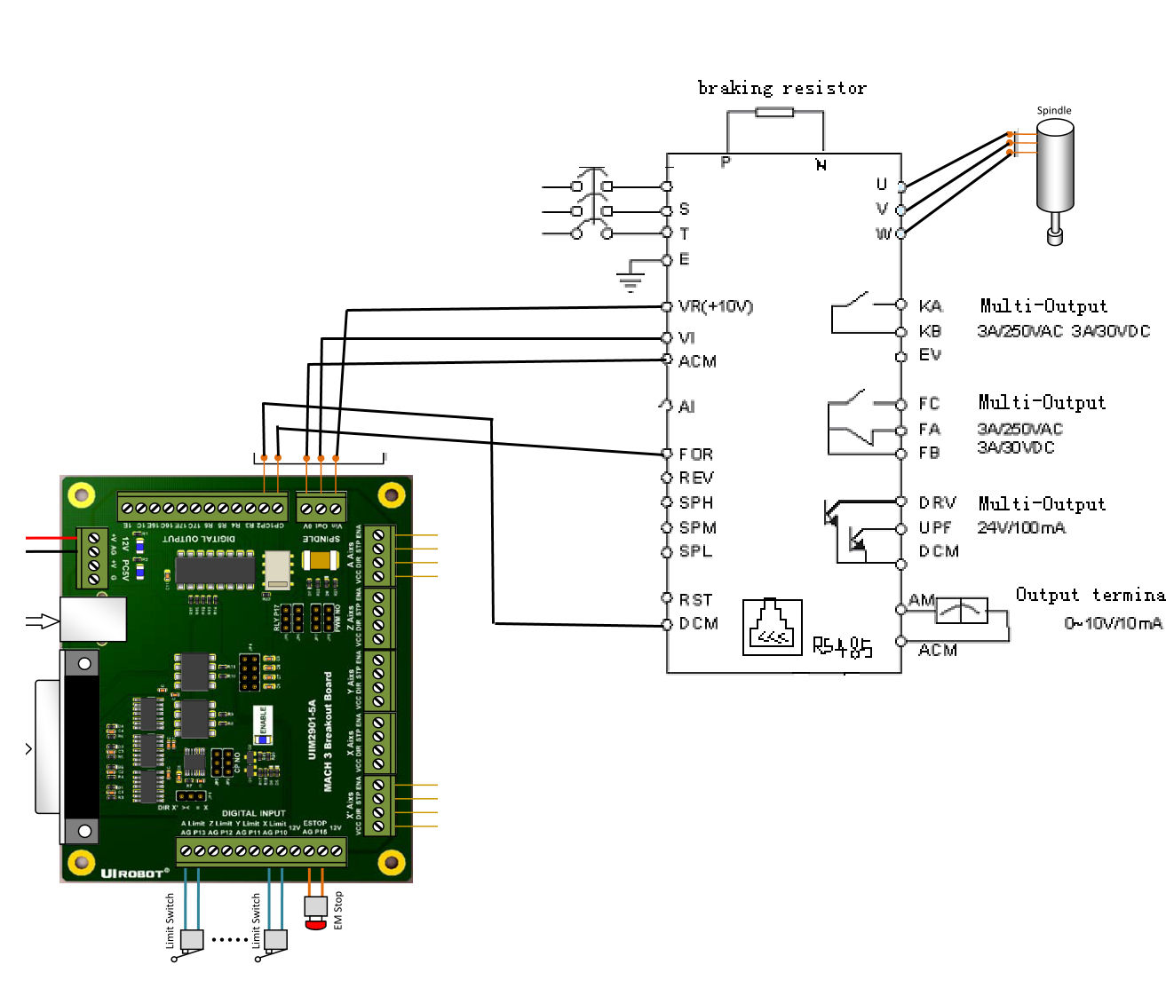

    Dan don't run the Home signal thru the relay contacts just the Limits. Take the home switch wires direct to the board from Ag to any spare input.
    Don't turn the VFD off unless in emergency. To control Start/stop do this at the VFD using the outputs.
    For best safety then wire the VFD thru the Emergency Stop system using relay contact to kill power.
    According to the bob manual this is how it's showing to connect the VFD

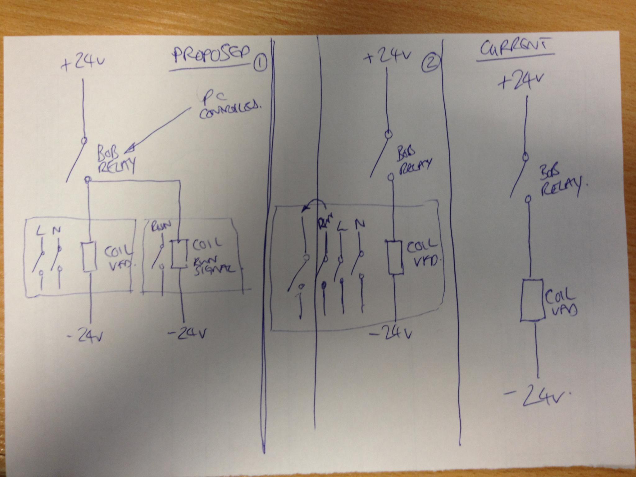

    Thanks guys. Think I will have to add another relay into my circuit. So 24v will come into cp1 out of cp2 to a relay coil - contact controlling the run signal. The second cable out of cp2 will go to b relay coil - contacts controlling the mains power live and neutral to vfd on/off as part of the the e-stop system. Will this work? Will try and get a sketch uploaded tomorrow to clarify.
    Dan
  8. #7
    Before you do anything get the sketch loaded
  9. #8
    So far right diagram is 24v coming in from the safety circuit running through bob relay contact to control VFD then into the coil of a seperate relay controlling VFD mains power.
    Left diagram is adding another relay in to control run signal on off simutaneously with power on off once the BOB relay is activated.
    Middle option is to get a 3 or 4 pole relay (4 pole - leaving a space between power and control) to wire it all in as one, but would this cause an issue with interference?

  10. #9
    Quote Originally Posted by Danielroyal25 View Post
    No Dan you don't want to be turning the VFD On/Off every time you run the spindle. You want the VFD power controled thru the E-stop so if an emergency it's shut down.
    The run signal is used to start/stop the spindle spinning. Use the BOB relay output to control On/off just like Eddy shows lower down. Then have the VFD POWER controlled via a Relay in the 24V E-stop system.
  11. #10
    Dan,
    Just off to bed, have printed your drawing, will get back in morning unless someone else answers first.
