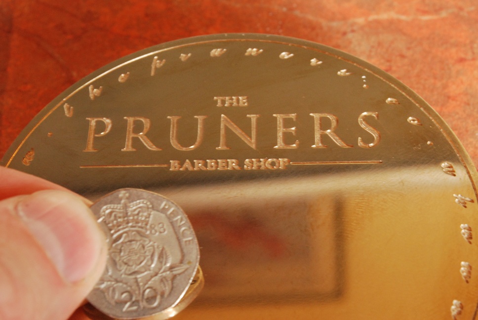

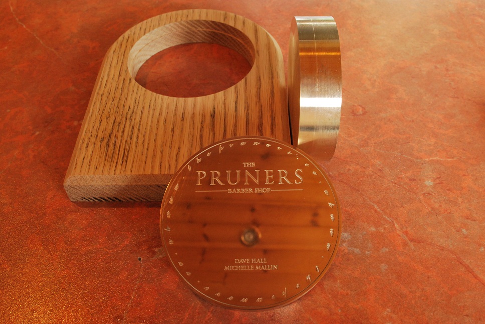

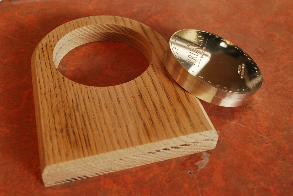

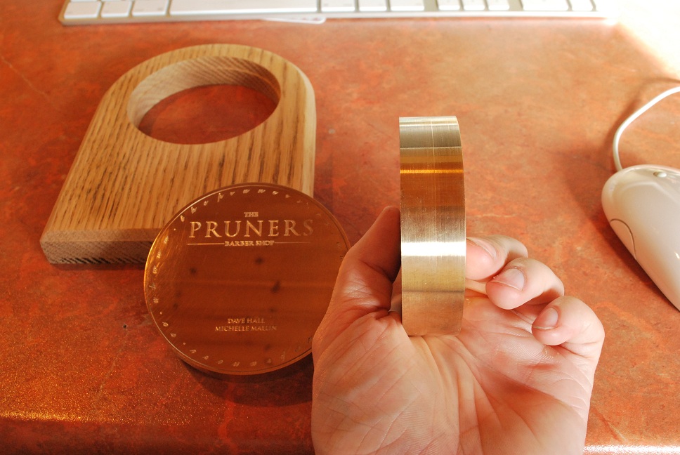

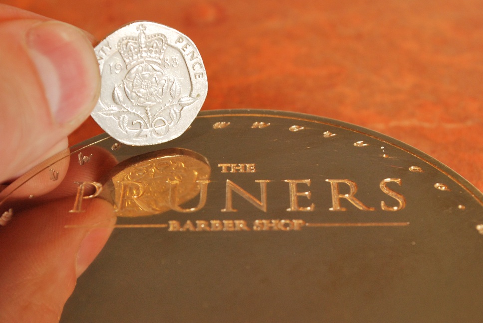

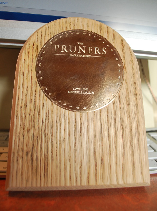

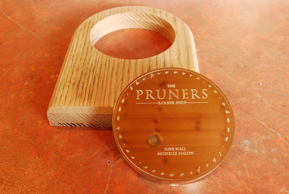

  1. Well, ive tried my hand at engraving some brass stock i had in the garage and i was supprised at the results!
    What you guys think?
    I used a 20* vbit machine time was 3.5hrs
    and about 15mins polishing
    2 mins to cut the wooden surround
    Alls i need to do now is lacquer the brass and the Oak.
    Thats after i fit the card holder.

    Why 3.5 hours ? How big is the disk ?
    John S -
  5. Hi Johnyboy the disk is 90mm, what i did was to do 2 passes of 0.1mm stepdown and a step over of 0.1 as the tip of the cutter was 0.2mm, i wanted to see how detail i could get out of the machine.
    by the way the small txt (names) are 2mm high
  6. also the feed speed was about 70-80mm min
