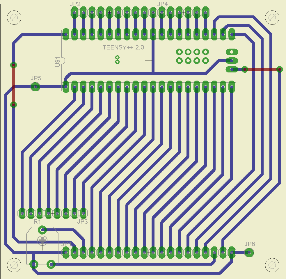

    All in all, I am pretty happy with this part of the project. However, I think I might design a PCB which will allow me to plug in the Teensy++ 2.0 module, and then solder all the connecting wires to the PCB, rather than solder direct to the actual module.
  8. #28
    It was pretty easy to make a PCB for the HID controller, and this is what I came up with...
Name:	cnc controller.png
    I added extra pins for the unused Teensy pins and a few spare grounds, in case I want to add some features later on. I also tweaked the wiring from the default openGLCD to make the layout easier. I just need to get the motor rewiring finished before I can get on and make this PCB though.
