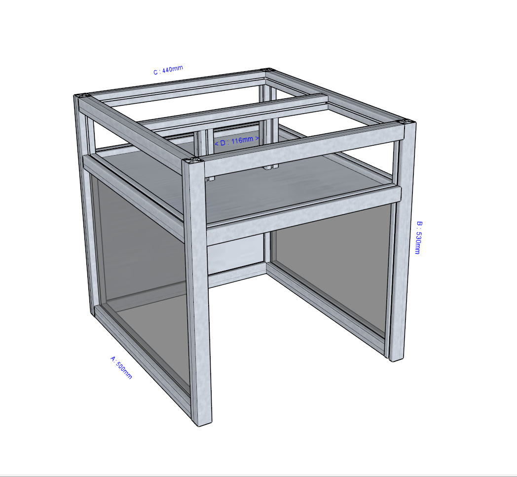

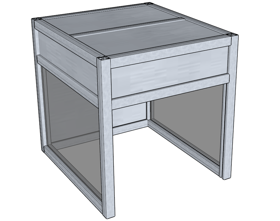

    First off I made a sketchup model which helped me visualize things and calculate sizes.
ID:	11640Click image for larger version.

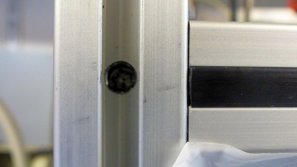

    After pricing everything up I decided to go with the cheapest 4 slot 30mm aluminium profile, as this was my first time of working with aluminium profile, I wasn't sure how easy it would be. To start with I drilled the 8mm clearance holes for the torx tool, this was bigger than the recommend size but it would give me a little extra room to move things to square them up if needed.

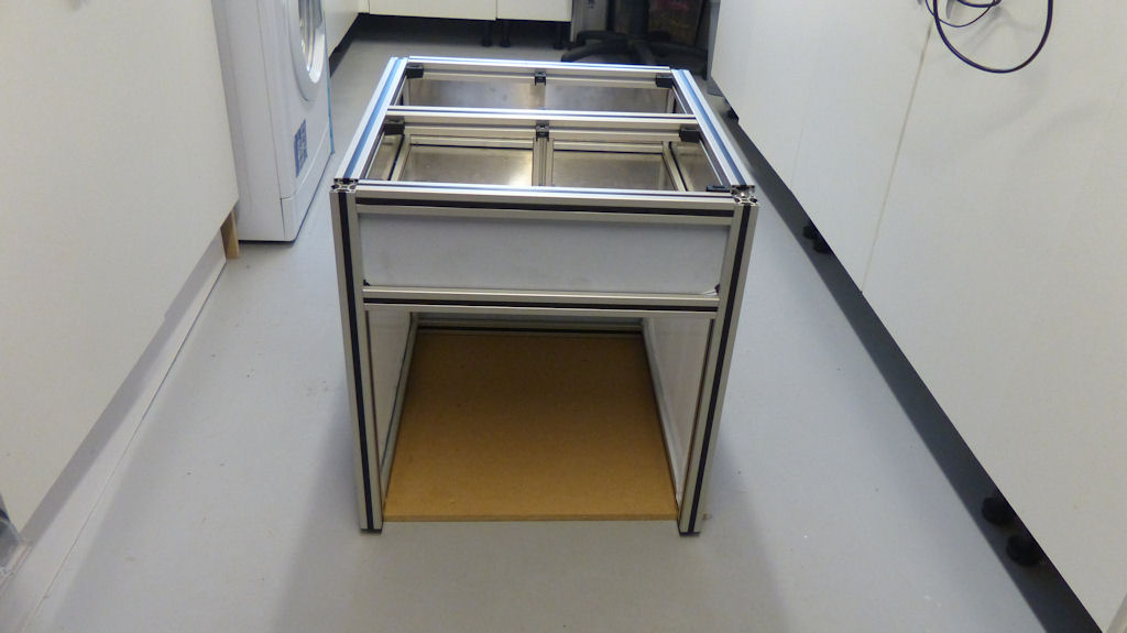

    Although I bought the self-tapping screws, I ended up tapping them anyway and once everything was drilled and tapped, it was simply a case of bolting it all together. That's when I realized my first mistake. In my haste, I had already ordered the Perspex based off the size from the sketchup model. While this was, in a way correct, I had forgotten to allow for the 3.7mm thick end caps, which meant I was 6.4mm out in the height of the panels. I was hoping I would get away with them, but when they arrived I tested them and they were no good. Having learnt from that mistake I checked, checked gain and then checked once more the sizes for the top panels. I managed to find a local company to cut them from 3mm thick aluminium. The cover and reduction profile said it was for panels 4mm to 6mm but in reality a 3mm panel is a nice tight fit, and apart from the cost, thicker aluminium obviously becomes heavier and harder to work with. It would probably have cause problems for things like the front panel switches and buttons too.

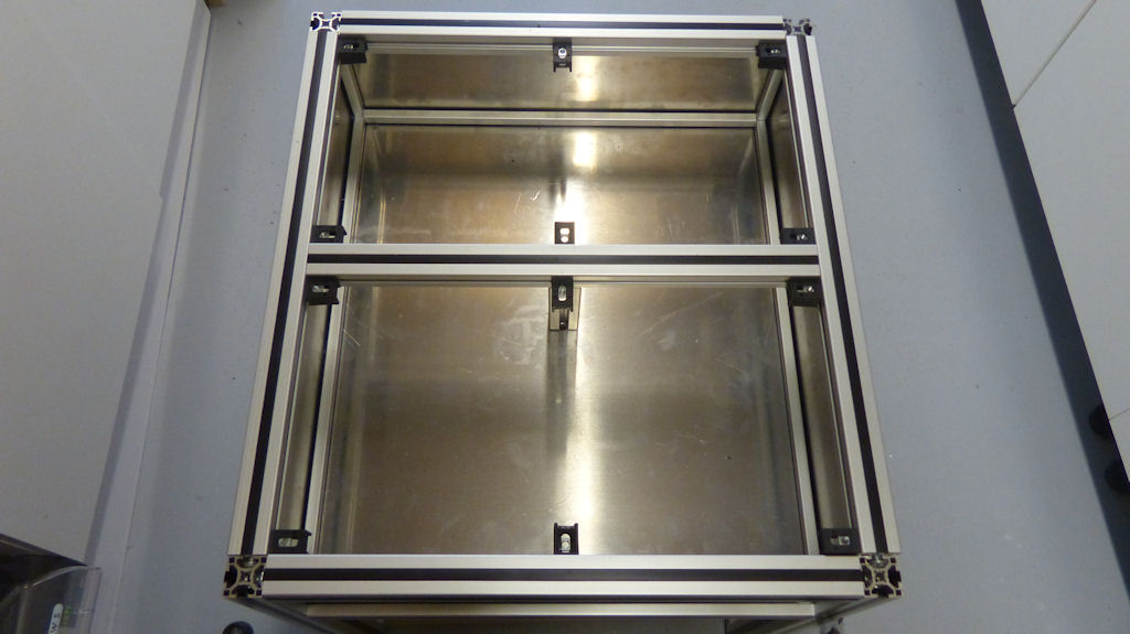

    Lastly I got some of the black plastic cover to fill in the slots, and some uniblocks to mount the top panels. Here's some pics of the enclosure assembled.
ID:	11642Click image for larger version.
    You may notice that I went for a single support for the bottom of the electronics enclosure, as apposed to the 2 in the sketchup model. The 3mm aluminium panel was stiffer than I though it would be and a single support is plenty. As you can see I have ended up with a nice size area, which is plenty big enough to house the electronics and PC, 440mm x 500mm x 100mm.

    Why not consider a removable door to stop chips flying about and also to reduce the noise ? will it need a small vent at the back to let heat escape by convection ? I don't know how hot the stepper motors and spindle get.
    I did think about a door but decided against it for the time being, but it's something I can look at afterwards. I doubt whether cooling would be needed for the small jobs I do but it would be easy to add a fan or too.

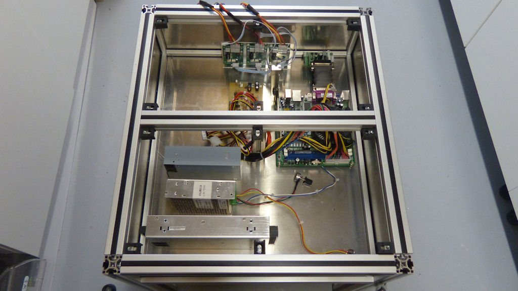

    The next task is to lay everything out in the top enclosure. I have already played about in sketchup and given it lots of thought, so I have a good idea of where to put things. I want to keep the mains as far away from everything else as possible, so this is what I came up with...
    The 24V PSU, PC PSU and spindle PSU/controller are all located in the bottom left. The mains input will be top left, and the mains switches will be located on the front panel in the bottom left corner of the above picture. The plan is to have an IEC C14 chassis socket for the mains input. This will run down to the main on/off switch and then feed the PSUs and run back to a IEC C13 chassis socket, which I will use to power the monitor. I will also have a separate switch to turn the spindle PSU on and off as an added safety feature. This means a single rocker switch will switch the whole unit on and off, including the PC and monitor. With the locations decided it's time to start fixing things in place.

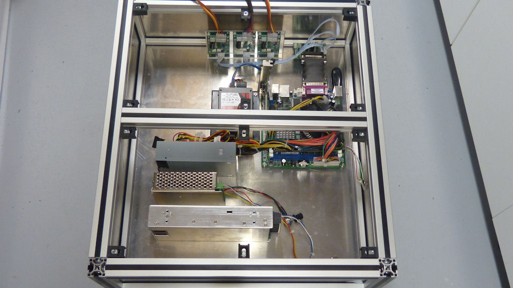

    I managed to find a PDF template for the motherboard, which is an Intel DG41AN in case you are interested, and then simply printed it off and taped it in place. I drilled some 3.175mm holes, which were perfect for screwing the standoffs in place. I used a 2.5" to 3.5" mounting plate to mount the 2.5" SSD drive using a couple of mb standoffs. I made more paper templates for the PSUs and simply drilled the holes and screwed them in place. Here's the finished layout...
    The only thing missing is the addon board which you can see top middle in the first picture, I haven't decided where to put it yet, but it will probably go just below the motherboard or just to the left of the SSD.

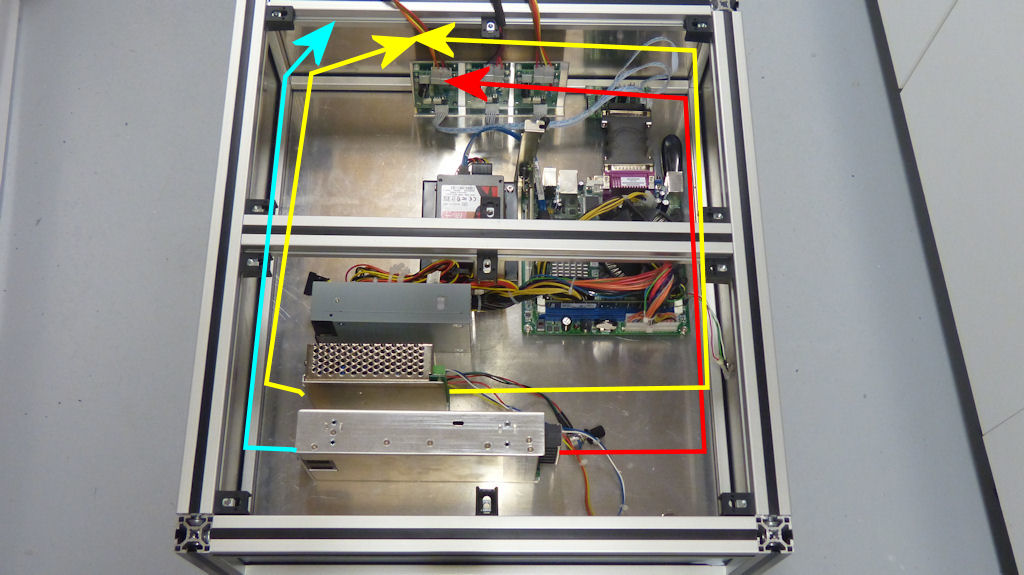

    Next up I need to work out where to run the wiring, the mains (cyan) and 24V (red) lines in the picture below are pretty much settled. I am not sure which route to take the spindle (yellow) output though, is it better with the 24v lines or running down the left with the mains? I could keep all the mains wires on the bottom and the spindle wires to the top, this would give about 100mm of clearance between them. I think I am going to use the 2nd option, unless anyone has a better suggestion.

    Good idea to keep the spindle wiring away from the rest, like you said put one cable at the top and the others at the bottom.

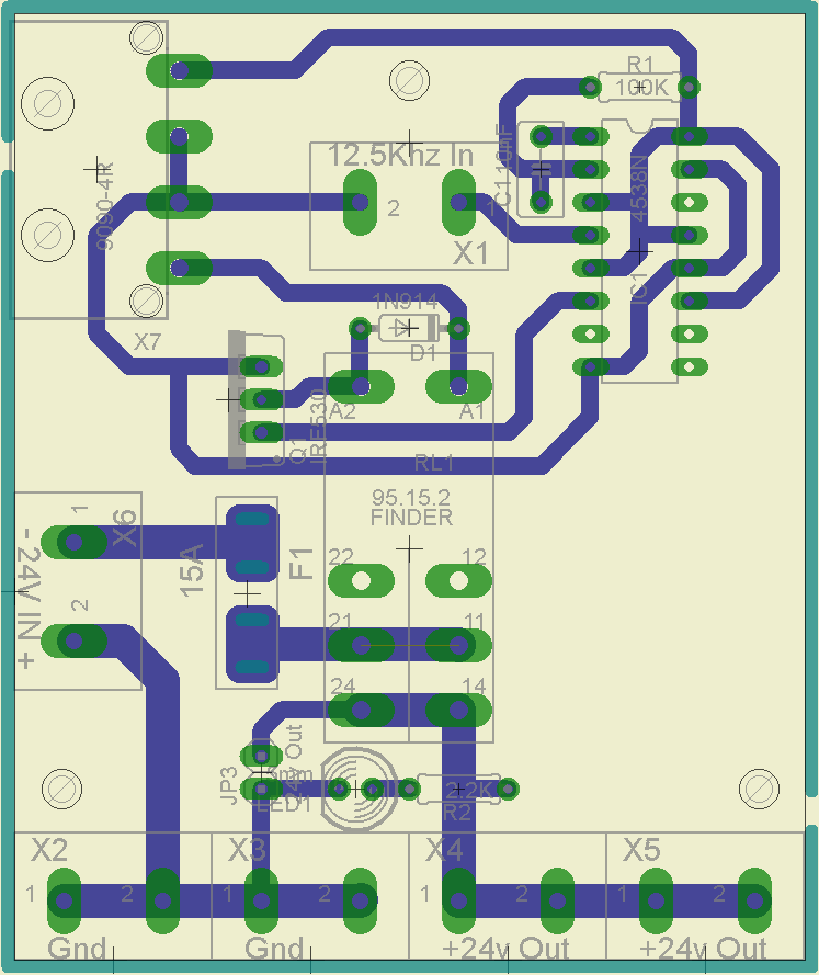

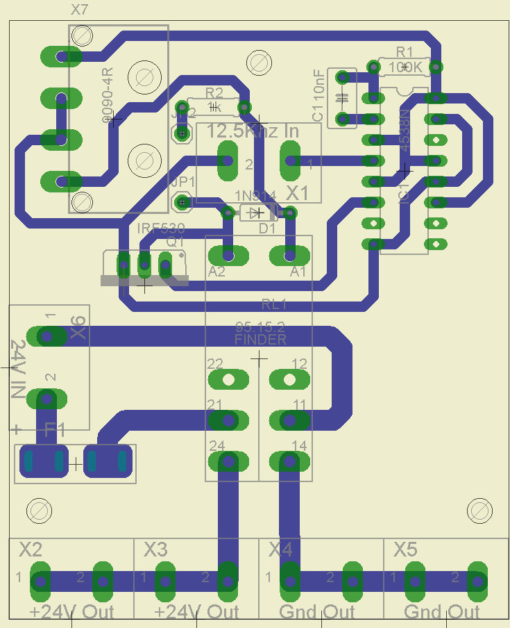

    While I was waiting for more parts to arrive, I decided to design the charge pump circuit. base upon the 2nd circuit here, I came up with this...
    It's using the 12v & 5v from the PC PSU to power the circuit and relay (4 pin 9090-4R connector, top left). I have included a fuse holder and LED indicator (JP1,2). The main 24v supply comes in on the left and will only be fed to the outputs (bottom) when the relay is energized, this should only happen when the PC is on and running Mach3.
    There is a chance I might have the orientation of the 9090-4R connector wrong, so I need to double check this, once my part arrives, and before making the PCB. (This would swap the +12v & +5v lines)
    I have also ordered some new CY cable as I plan to rewire the entire machine now. I will possibly need some new cable chains, so if anyone knows a good supplier, please let me know.
    Regards,
    Les
    Thanks for the links Ed.
    I must have had a real brain fart when I did the charge pump circuit above. Apart from getting the PC power connector the wrong way round, and a couple of other small errors, I made a major mistake with the relay. It's SPDT, so the above circuit makes a direct short across the 24v input, whoops! There's obviously a very good reason for bench testing circuits first, and fortunately I always have the current limiting control on my bench supply turned way down in the milliamp range, so no damage was done. Anyway after a quick couple of tweaks the circuit worked beautifully on the breadboard, I have only tested it connected straight to the BOB, so I just need to make sure it works, through the opto-isolators on the IO board
    Here is the second version of the PCB...
