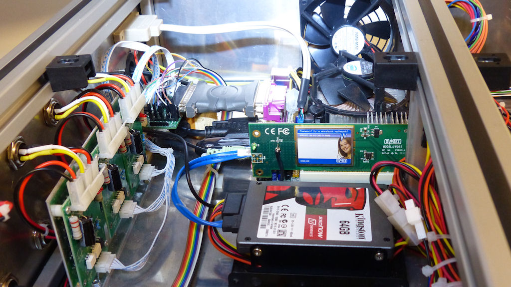

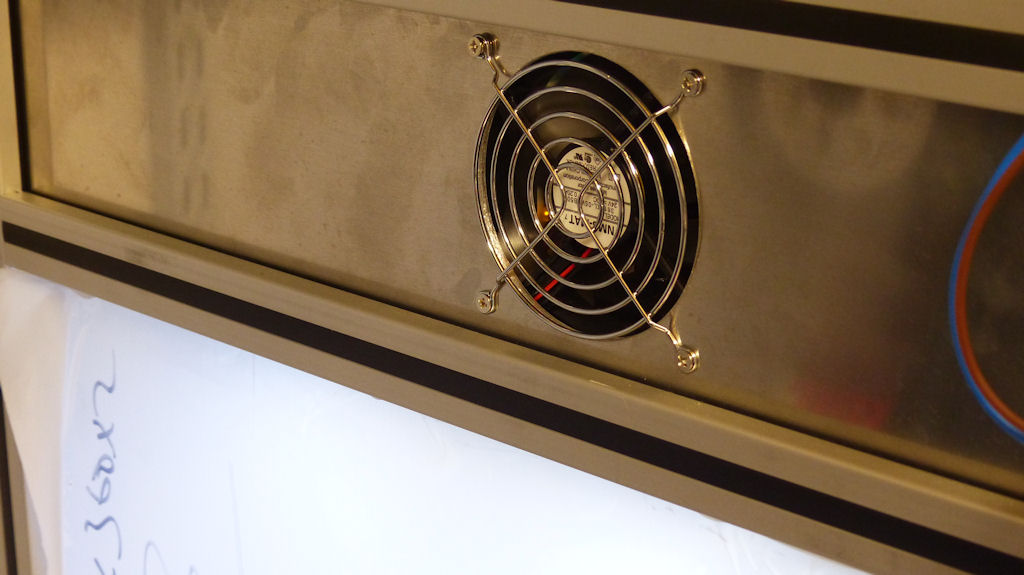

    I had another really productive day today.
    First off here's a couple of pictures of yesterdays progress, one of the cooling fans and the slight rejig inside to make space for the HID PCB.

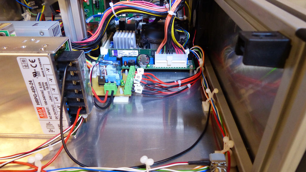

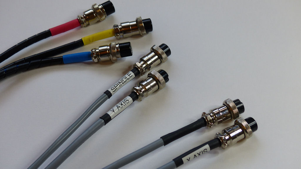

    To start with today, I fixed a bad connection on the lead from the IO board to the BoB, which just happened to be my Estop input for Mach3. Although the switch was deactivating the 24v and spindle, it wasn't letting Mach3 know the switched had been thrown.
    I really wasn't happy with my rewiring job on the connector ends, so I redid them today and they turned out much better. Here's a pic... (The top 3 are home switches, limit switches and probe)

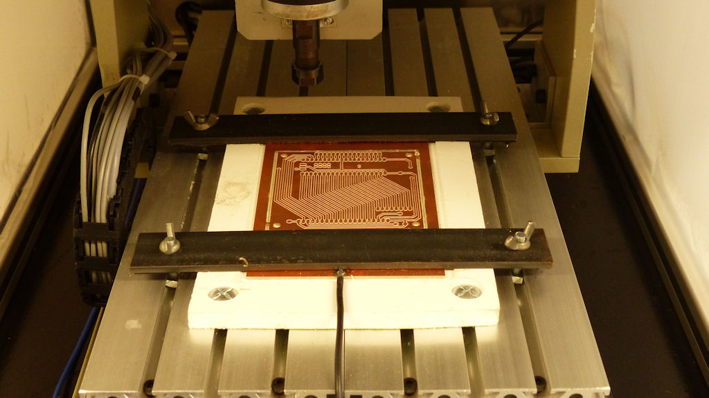

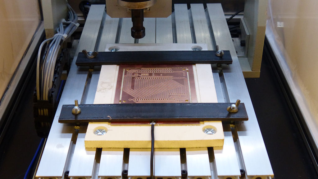

    After that I connected everything and ran a simulated PCB etch for 30 minutes. Everything worked great, and I had no false triggers on the switches even with 0 debounce in Mach3. (Before I had to have a very large debounce setting) I then etched the HID PCB, and in total the machine ran for a couple of hours without issue. I need to get some 20 way sockets to mount the Teensy module in, before I can fully assemble the PCB, other than that it's pretty much done.

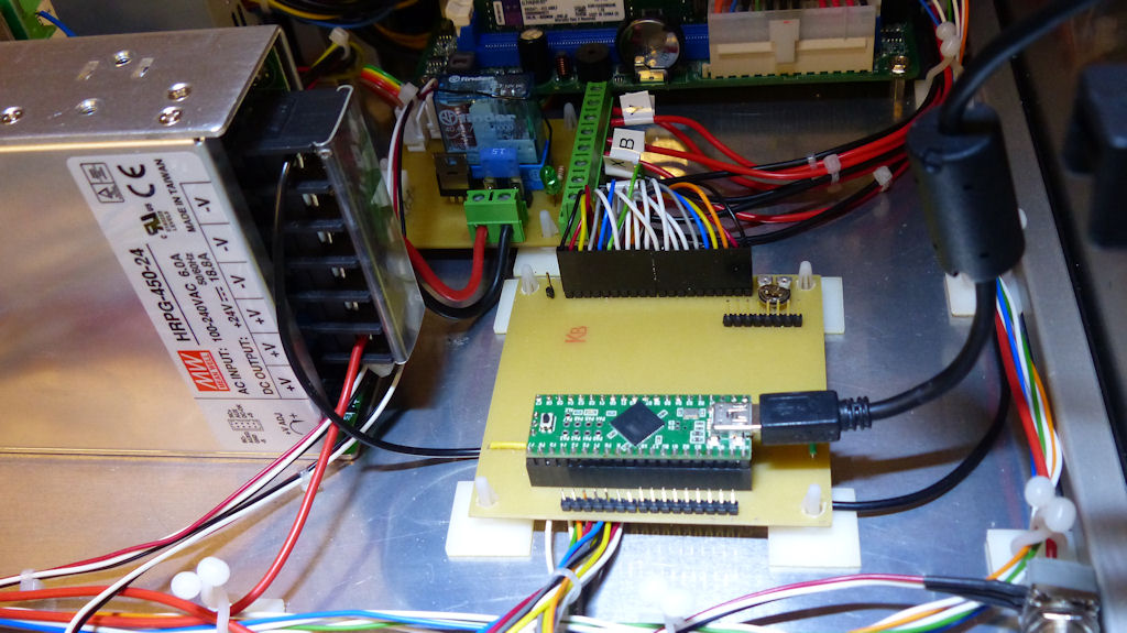

    The sockets strips came for the HID PCB so I soldered them on last night, plugged in the module and the display worked straight away.(Not that I didn't expect it to, as it's not a complicated PCB, but it's still nice when stuff works first time)

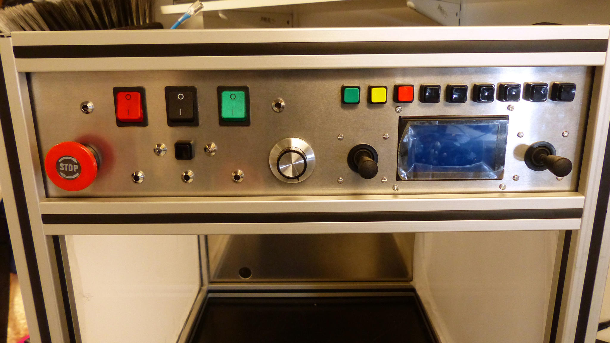

    Big, big thanks to JazzCNC, he only got the panel yesterday and sent me this picture last night. I just hope I didn't screw up any of the dimensions, if not I can see a huge light at the end of the tunnel.

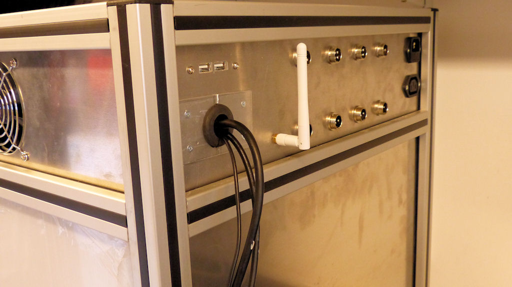

    The cheapo WiFi card I am using doesn't have a detachable antenna, so I bought a cheap extension lead from Ebay, cut off the socket end and soldered it direct to the card. I then drilled a hole and mounted it on the back panel, fitted an old router aerial I had laying about and the WiFi signal has gone from 2 bars to 4.

    The other small job I did was to mount the HID PCB and cut the LCD screen wires to the correct size.

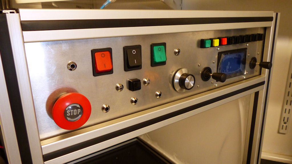

    It's here and after a small amount of filing and reaming.........
ID:	11930 Click image for larger version.
    The more astute of you may have noticed the panel is the other way up, that is because there were a few scratches on the other side. I actually prefer it this way up anyway!
    I just have to connect everything up inside now!
    Thanks again Jazz, great job!

  10. #40

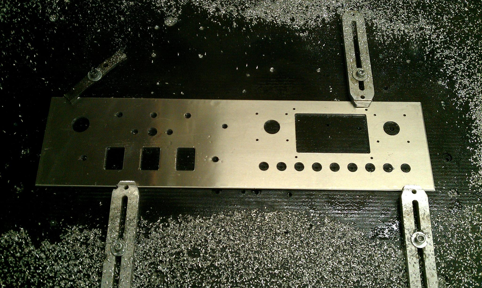

    Quote Originally Posted by Pointy View Post
    Yes I Did my best to protect it from scratches by flooding it with coolant but because it's soft shity aluminium it comes off the cutter like curly chewing gum.!
    I didn't have any tape other wise I'd have taped it up. There was no point using side with plastic on either because that stuff just goes mushy with coolant and gets ripped off then wraps around cutter which with small cutters easily breaks them.!
    Looks Good thou..
