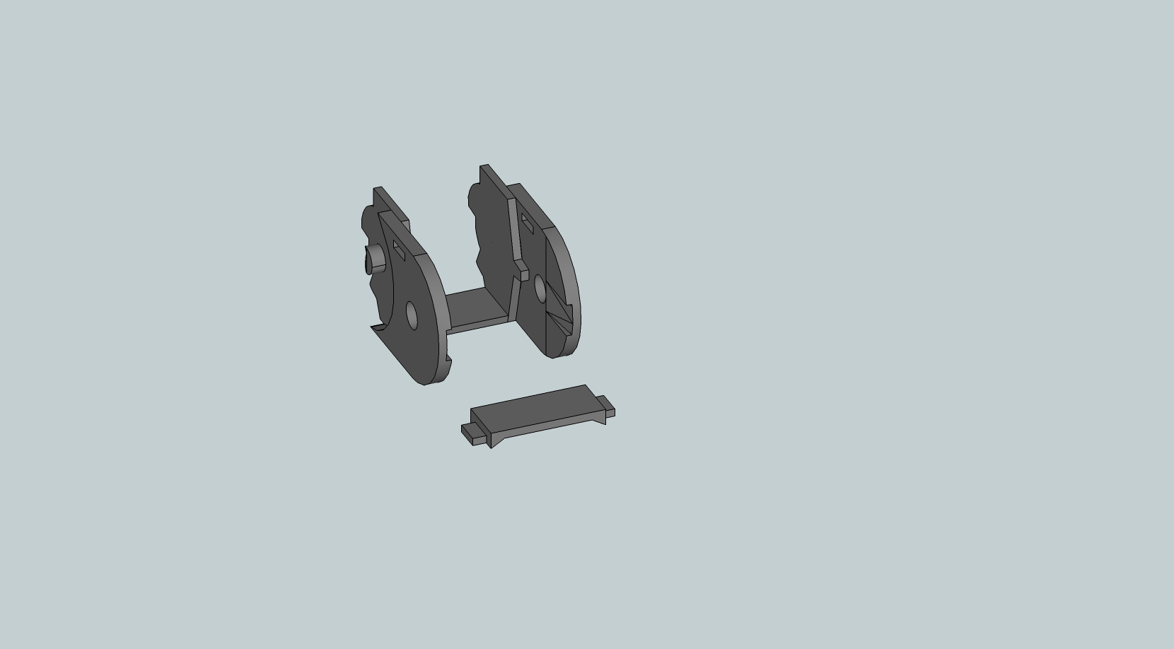

    The model looks good but probably won't print too well without support (not necessarily a problem but it uses more plastic and will be tedious to remove on a large number of components). Have a look at Pimped Cable Chain by leemes - Thingiverse - it's a bit more basic than yours but I've printed out (though not used in anger) some and they print well with no support. The main difference is the large fillets on the bar over the top which brings down the unsupported width to about 5mm.

    Thanks for the advise and link Freddie, obviously I am very green when it comes to 3d printing. I am not sure why it would need supports though, the top piece is separate and clips in after the cables are in place, as shown in the following pic...

    The reason for making my own cable chain was the fact that I was struggled to find the exact size, and also the clips keep flying off as they don't slot inside like mine. It's also not my design, I just modeled what I have here already and adjusted the size to suit.
    I never thought of looking on thingiverse though, there seems to be quite a few designs there already.

    Ah - didn't spot that :-)
    Designing for 3D printing takes a bit of getting used to because you can't directly print overhangs (like the lugs at the back) so you have to get the slicer to generate a support structure (a deliberately weak scaffold) that you remove afterwards or adapt the design so it isn't necessary. On the other hand you can easily print objects that would be difficult to machine (internal voids for example).
