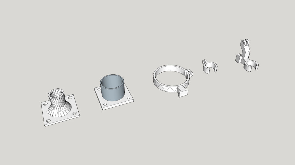

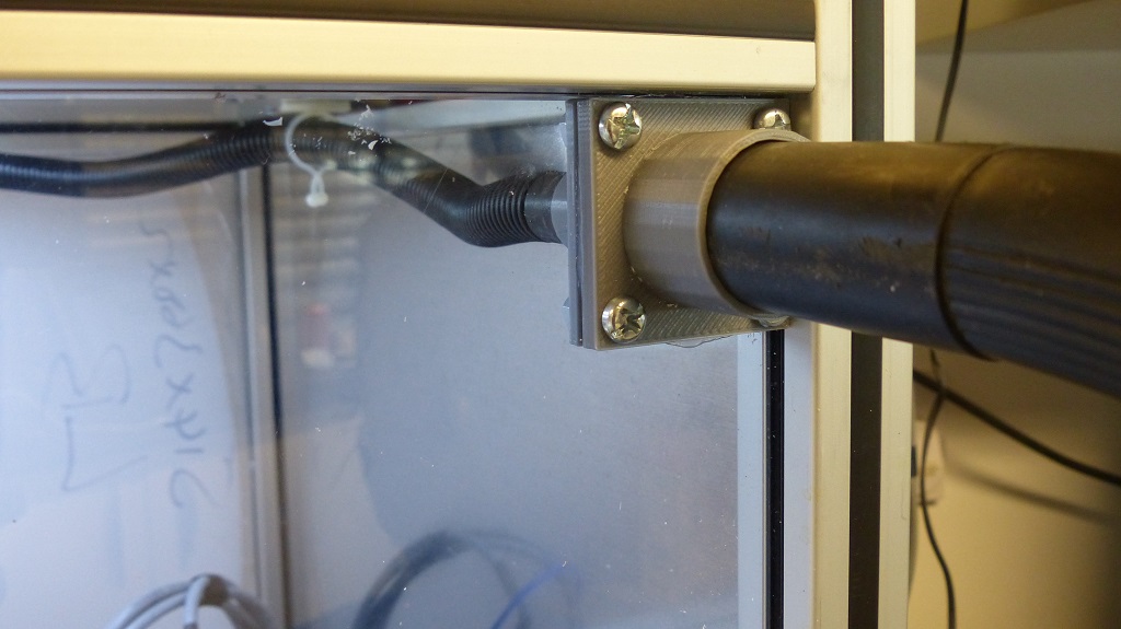

    In the meantime, I have been busy playing with the new RepRap Ormerod 3d Printer and have found a few practical uses for it already. I made some connectors and clips for connecting a vacuum hose into the enclosure. Here's a couple of pics...

    This was inspired by my brother in law, after he asked me to cut some acrylic discs for him, what a mess! I just need to find a vaccum that doesn't sound like a jet engine now!

    Very impressive - how long did that take? G.
  4. #54
    There 5 separate parts which from memory took from 30 mins to and hour or so to print, but I think it's great than in the course of a day I could design and build these parts.

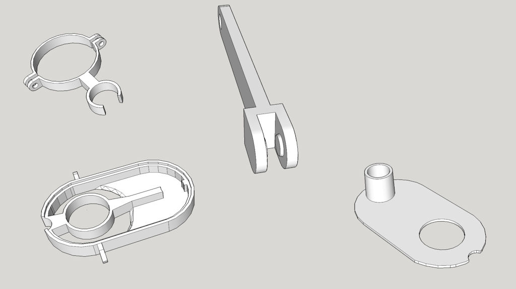

    The dust extraction was a failure but it inspired me to design and print a a proper dust shoe, which has turned out quite nice and works good. I just need some suitable skirt material. (for the shoe not me!) I'll post up some pictures tomorrow.

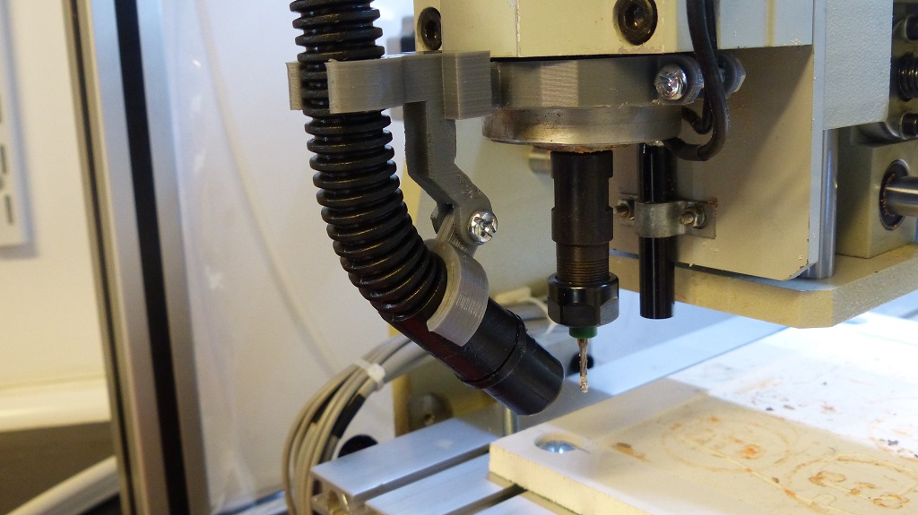

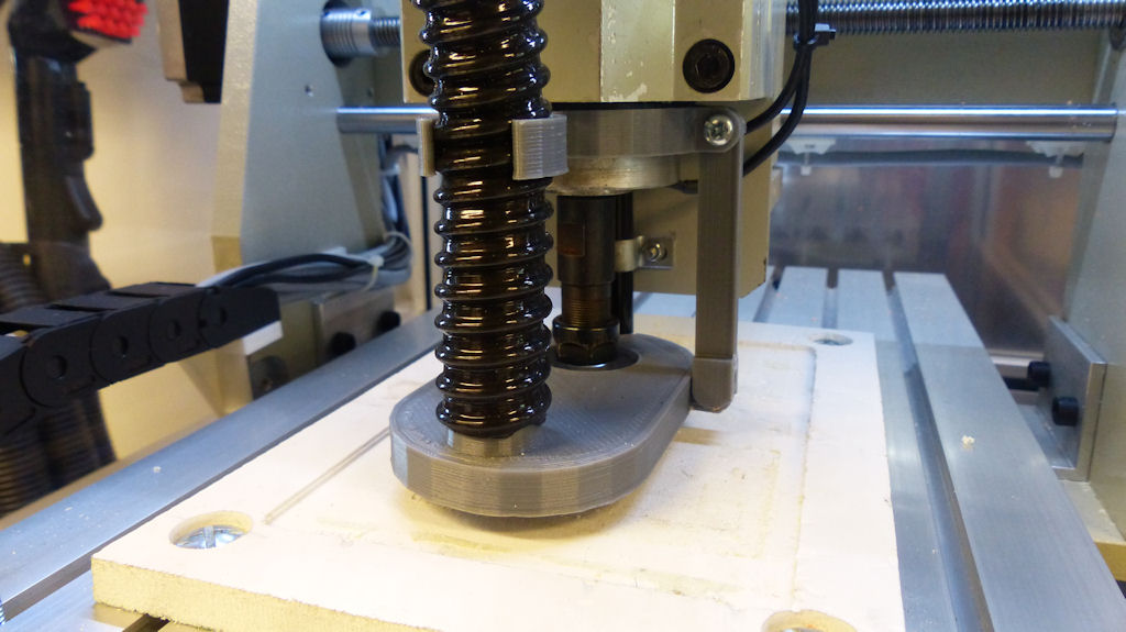

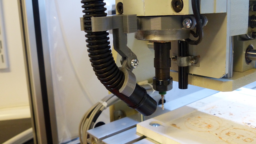

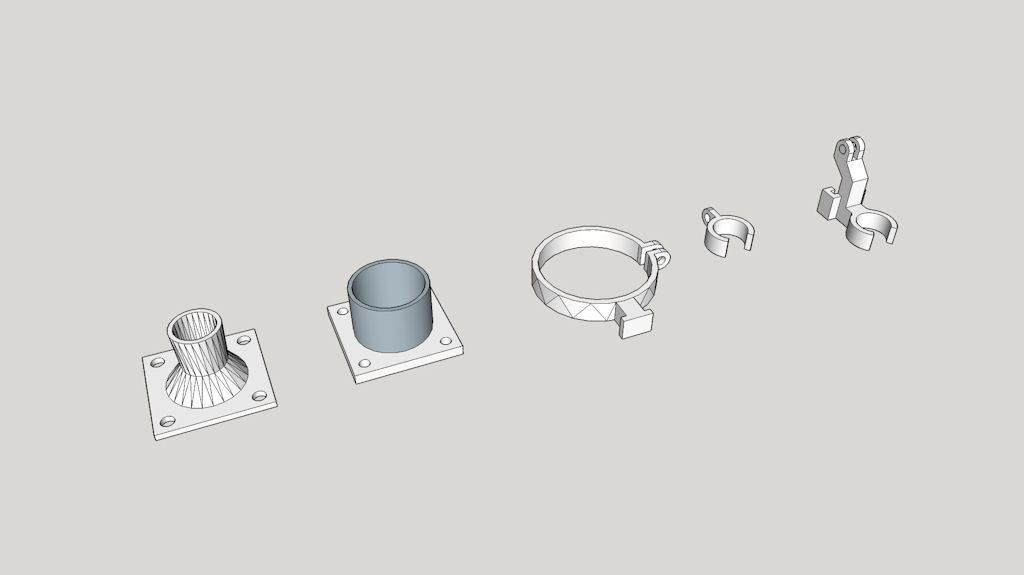

    Here's a couple of pictures of the dust shoe...
ID:	12245Click image for larger version.
Name:	cnc dust shoe.jpg
    From the sketchup image you can see the shoe is in two parts which I just simply glued together. I can easy just pull the shoe off when changing bits as it just clips into the arms either side.
    For my PCB milling it works great as it is, but when milling acrylic you still get the odd piece flying out. I think a suitable skirt will solve that, but I don't want to use brushes, I think I would rather something clear so I can see whats going on. I also think if I wanted to be rally clever I could add some LED lights to it as well, or maybe just print it in clear PLA.
  8. #57
    The dust shoe design is not bad but I would want to mount it from a part of the Z axis that did not move up and down with the spindle.
    These were suggested to me for making a plastic skirt, VARIERA Drawer mat - IKEA, a circular one that just goes around the cutter would work great.
    If you find a better material then please let us know with links to it.

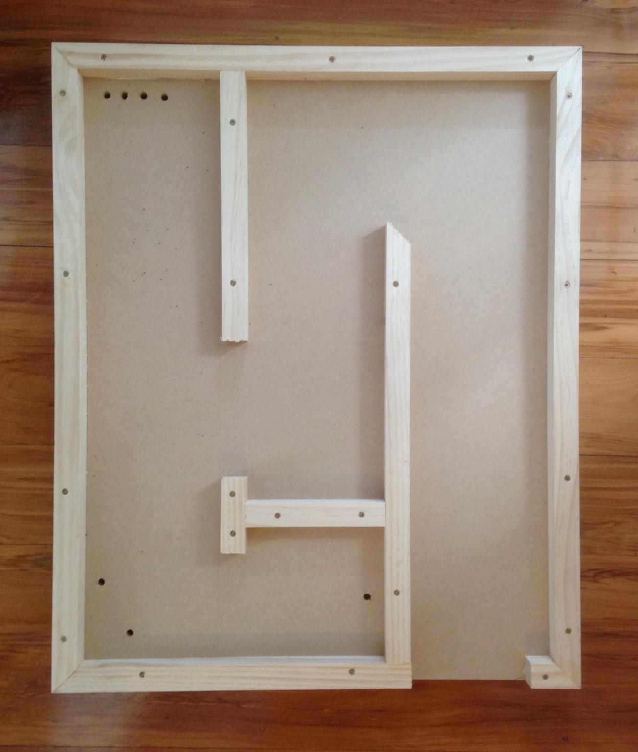

    I've been following this thread for a while. Really great work here Les. I'm borrowing many of these ideas. One thing i wanted to do was to have doors on the front. I'm also putting a radiator for the water-cooled spindle inside the enclosure and a small air compressor (aquarium pump) in as well. This will all generate heat inside the enclosure, but i'm hoping the vacuum will pull enough air out to prevent warm air from building up. With everything inside and sealed up, noise should be minimised.
    I hope to get a decent seal on the doors (made using aluminium profile and polycarbonate panels), though not sure how i'm going to do that yet. I've built a base that the enclosure (using the same aluminium profile and polycarbonate) sits on. Here is a photo of the underside. The holes hopefully will allow air to be drawn in around the radiator for spindle cooling, the air compressor and the y-axis stepper. In addition to the holes in the photo, a hole for the air compressor intake has been added and a slot that allows all the cables to run through:

    I plan to use an almost identical system through the enclosure for the vacuum attachment. I will likely add a small hole on the inside connector to allow a small amount of air to be pulled out from near the top of the enclosure. That should help keep things cool inside. Hopefully i can pull air out faster with the vacuum than the air compressor is pulling it in :-)
    Anyway, looking forward to seeing more of your build.
