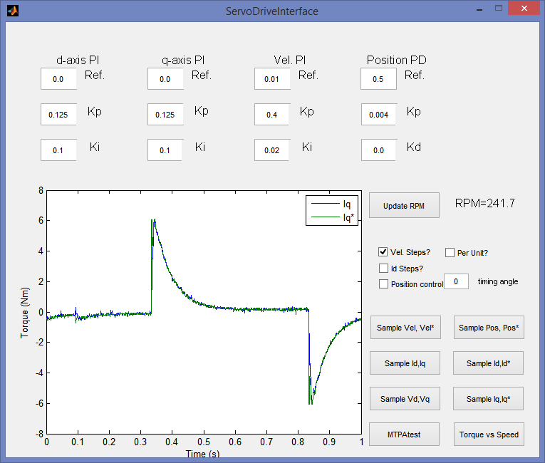

    In addition to the usual methods to control the driver, I made an interface using MATLAB, so you can adjust all the controller gains and try different tests (e.g. measure torque vs speed characteristic of load) by clicking buttons. Here's an example - graph shows q-axis current controller (part of the vector control algorithm - torque is proportional to q-axis current):

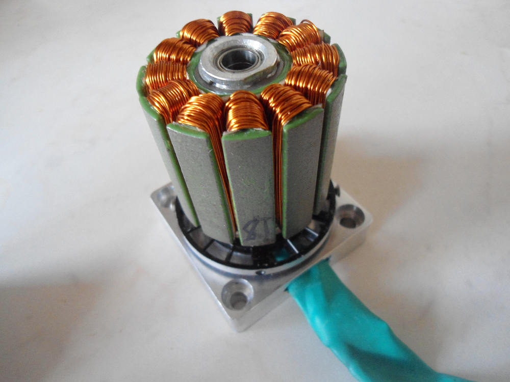

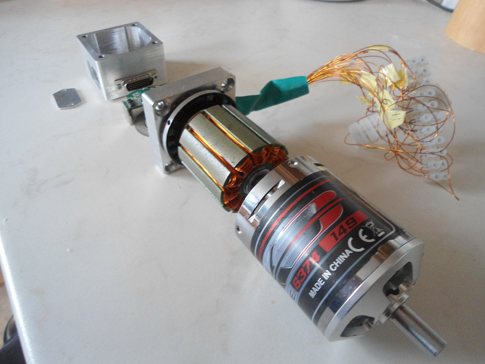

    I rewound the motor, to make the current ratings more reasonable and enable it to be driven directly from the mains (instead of requiring a big expensive PSU):

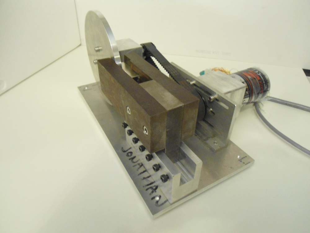

    To test the motor under load I made an eddy current brake, which worked well:

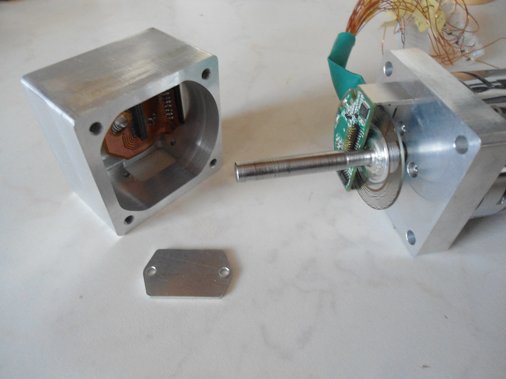

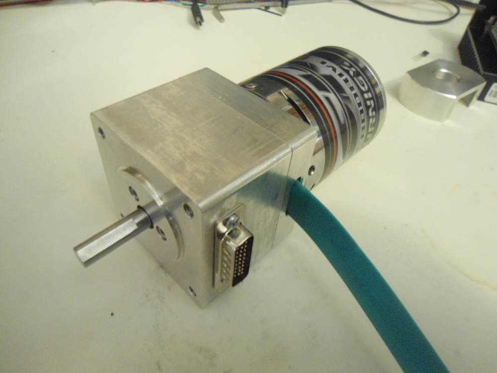

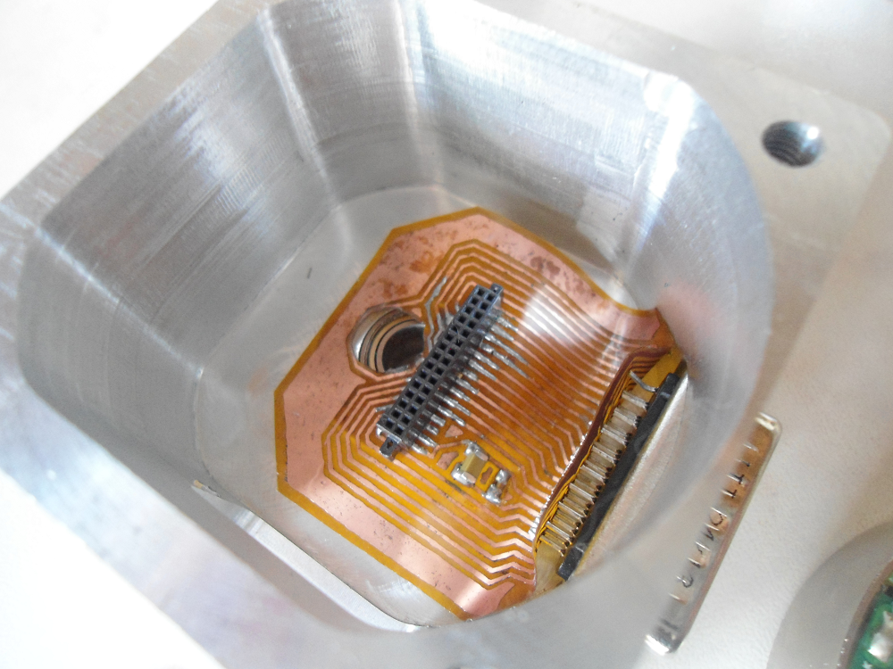

    Here's some pictures of the motor parts with the housing I machined to hold the 17-bit encoder and adapt the mounting to Nema 23. Note the flexible PCB:
ID:	12490Click image for larger version.
ID:	12491Click image for larger version.
ID:	12492Click image for larger version.

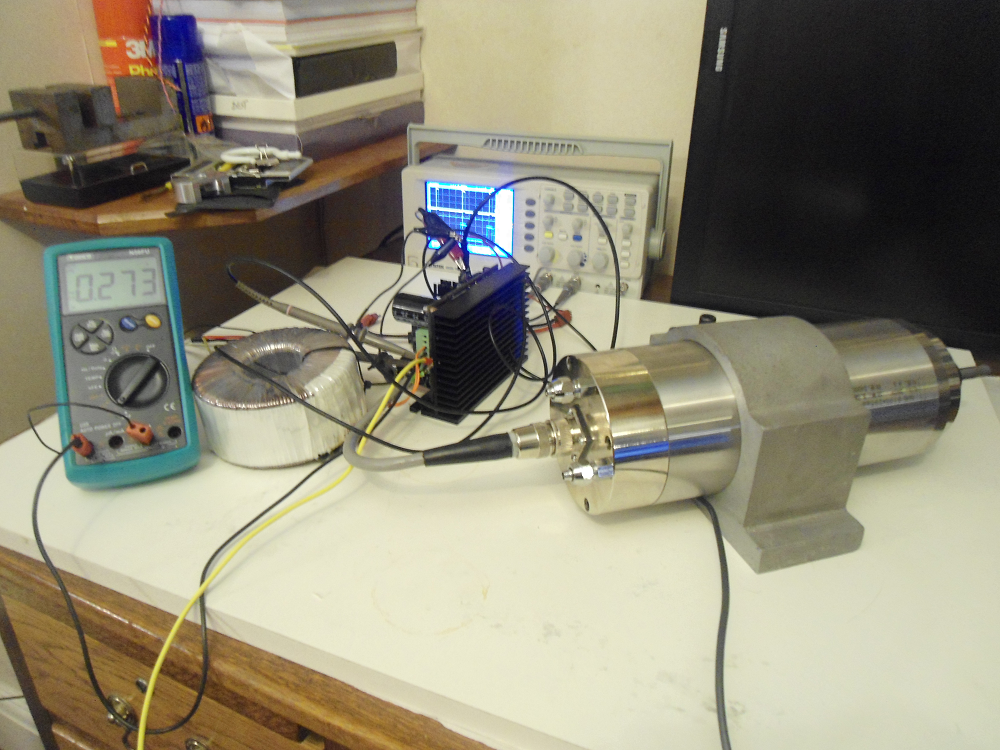

    Testing with 3kW spindle:

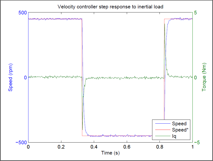

    Typical step response (note load inertia of brake is *VERY* high compared to CNC router/mill, so response is not as fast):
    The position controller step response isn't so good - it oscillates quite a bit, but I think I know how to solve that now so I'll try it again when I have time.

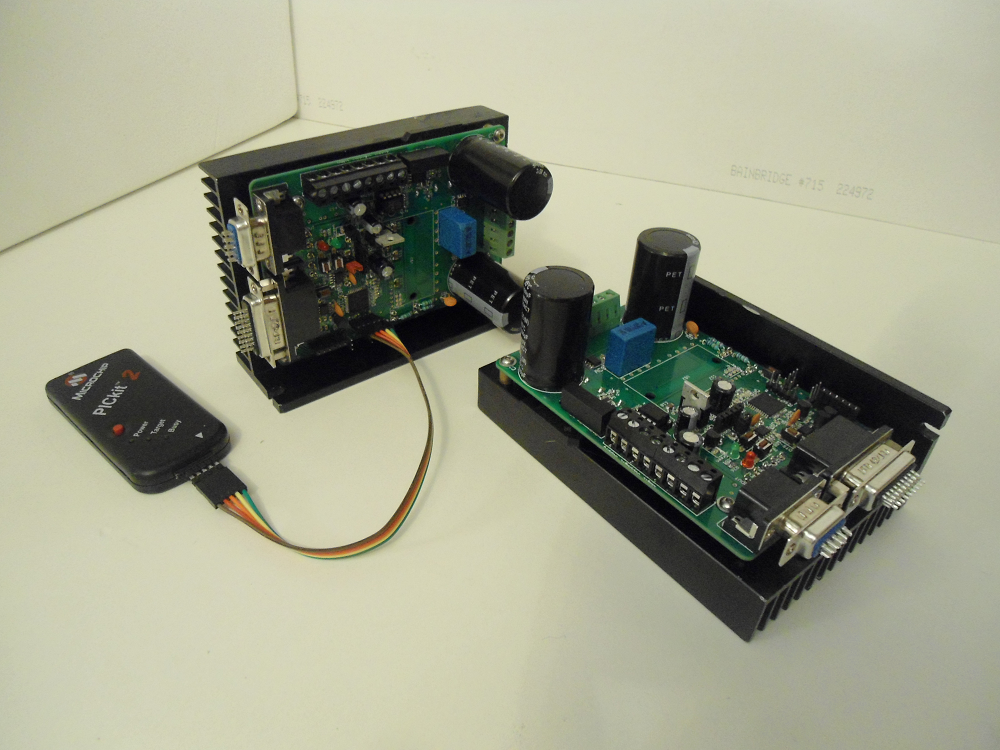

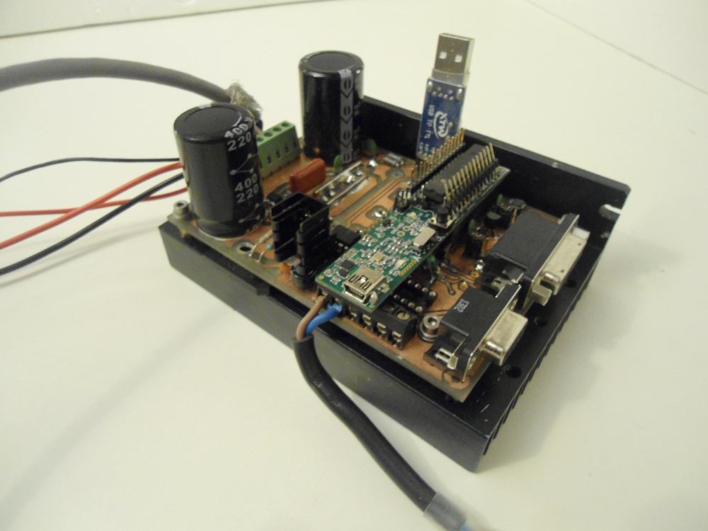

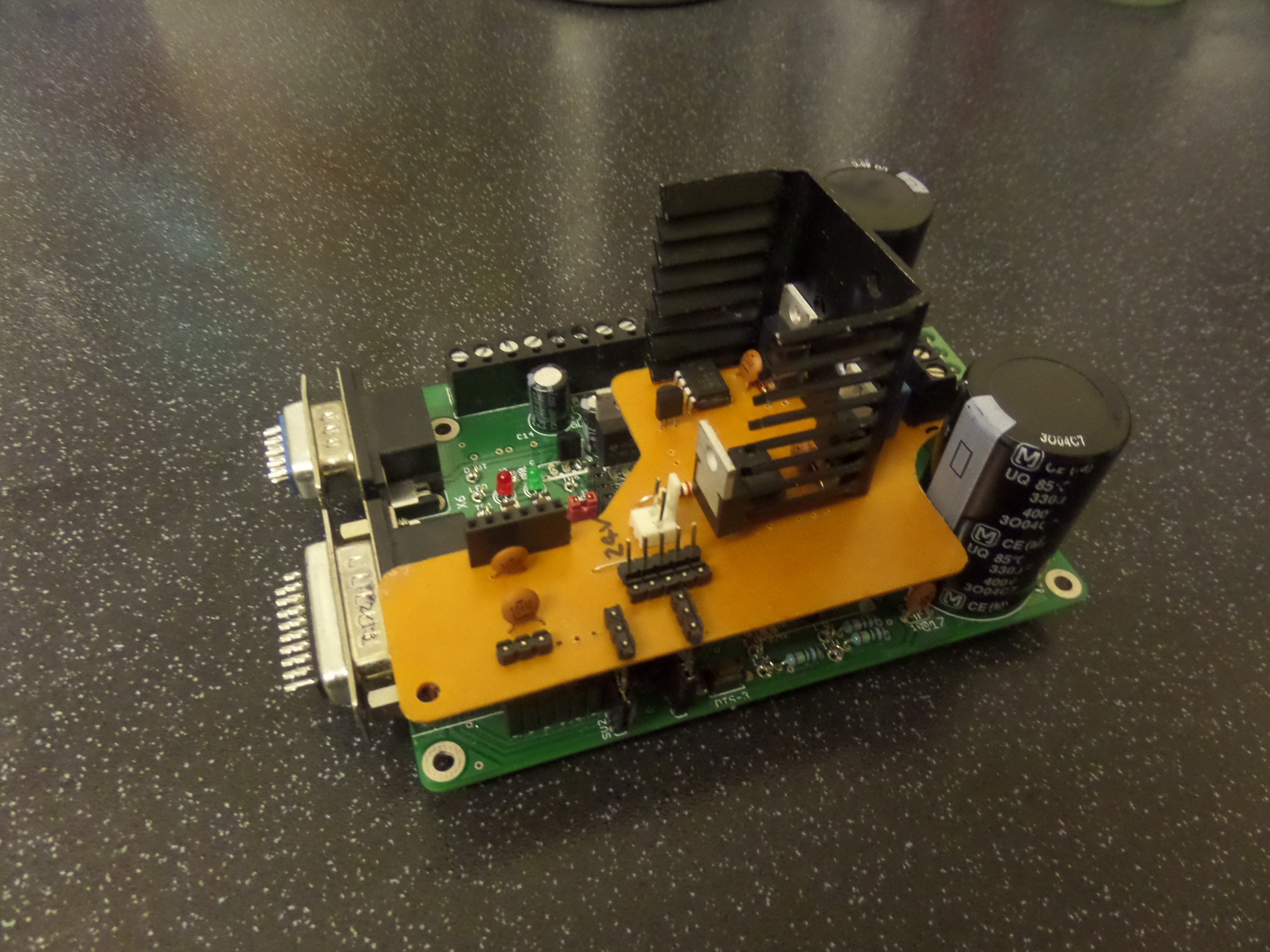

    Last but not least, here's the actual driver - first version of PCB made using toner transfer, 2nd one got made professionally (both use SMT components):
ID:	12496Click image for larger version.
    This was quite a big project (barely scratched the surface with this post) so any questions welcome. I might upload some videos, but I don't think there's much point as I'm sure you can imagine what a spinning motor looks like...

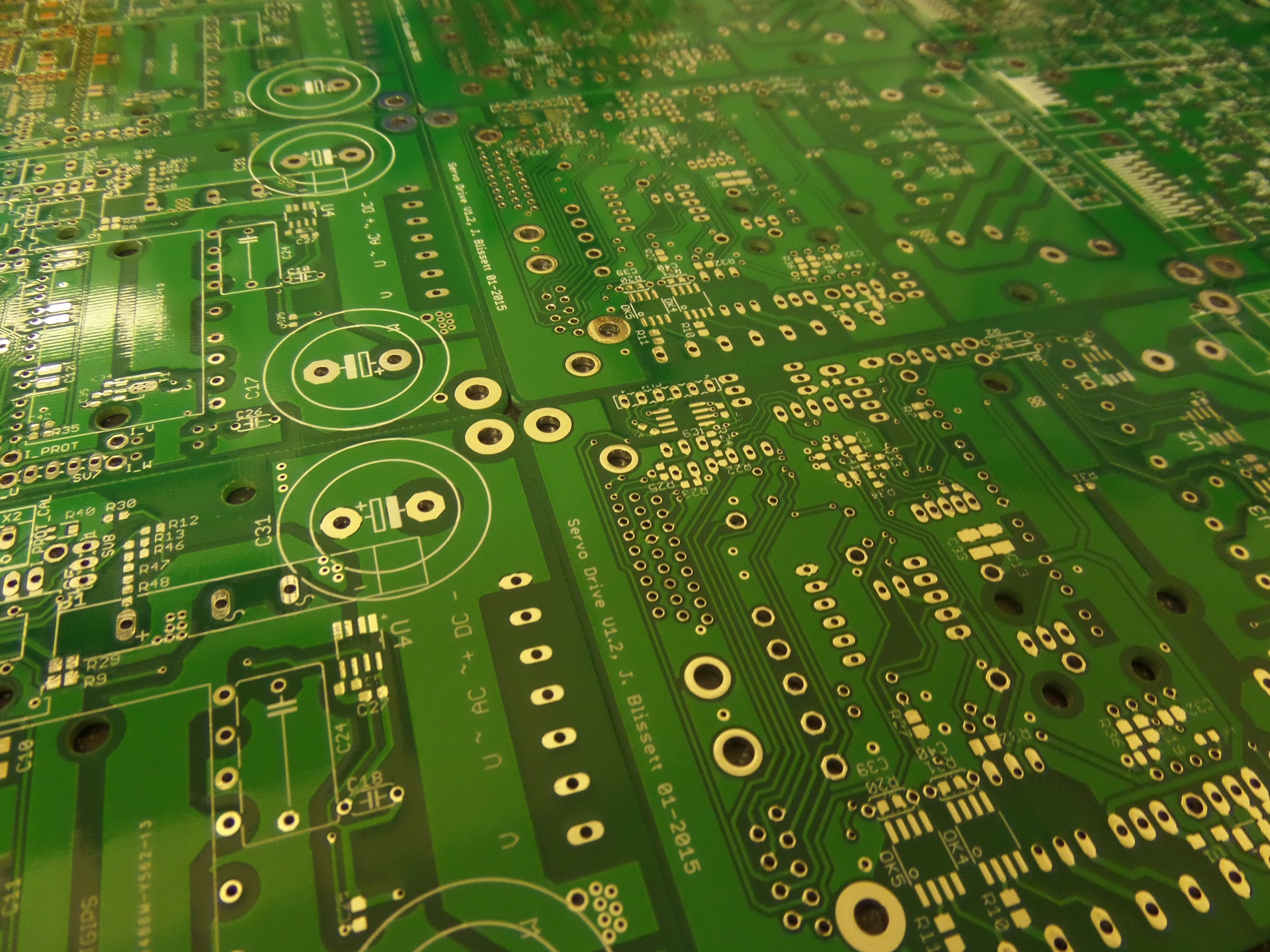

    I seem to have made some progress:
    So need to buy VFDs from China now. I was intending to split the design into a logic board and power board, but realised that realistically it's going to be a some time until I have time to complete that design, so instead I made a few improvements to the previous PCB and got a heap of them made.
    I've worked a bit on the code too - it can now drive motors with hall sensors. I'm using the sensors to generate a position reference field oriented (vector) control, so it's smoother than the generic method of just switching on hall signal transitions. I'll take a video soon, but for now here's a picture:
    With the previous design and more-so with this one, I've made is so spare I/O and signals are available on headers, so I can make 'expansion boards'. Here's one to add a 4th output to enable controlling stepper motors:
    Now I've actually thought about it, I'm pretty confident you can control a stepper motor properly with a 3-phase inverter, so I might instead use this board to do power factor correction or just an isolated buck converter to eliminate the need for a transformer when using low voltages. If you connect the two phases of a stepper motor together, then connect the center point and two ends to the 3-phase inverter, you can still apply bipolar voltages to each.
    I also mounted a 12-bit encoder on a 3Nm stepper motor yesterday, so I'm planning to use that to implement sensored vector control, rather like the Leadshine closed loop version ... but open source and cheap. There's plenty of information on how to do it, such as this, so I'll try it and see. That paper makes it look straightforward ... watch this space.

  10. #9
    Re. stepper motor use.
    If you are splitting the power section onto a separate board maybe you could use a common DC link psu to power several controllers. I suppose this is what the current stepper drivers do.
    Also if you fit encoders maybe it would be worth including a system for homing a master /slave without external intervention.
    Keep up the excellent work
  11. #10
    Currently the design has a rectifier so it accept an AC input, but I also put connection to the DC-link so you can power from a DC source, add more capacitance or share between drives. One interesting consequence of connecting the DC links in parallel is energy can transfer from one motor (regenerating) to another, which is a regular occurrence on a CNC machine as often when one axis is decelerating another will be accelerating.
    If instead of adding an extra leg I connect the stepper motor to the 3-leg inverter, as mentioned in my previous post, the only obvious disadvantage is you end up with 'poor' utilization of the DC-bus voltage, V. Depending on the output voltage vector angle, you either get V or V/sqrt(2). See this paper, fig 4. I don't think that's an issue though, as we can simply supply the motor from a higher voltage to compensate. The current controller bandwidth will have to be a little higher to compensate and the insulation resistance of the motor also must be greater, but I don't think the difference in voltage is a big enough factor to matter in either case. Maybe there's something I've missed, as it seems strange that all commercial drives seem to use 8 mosfets when this method only needs 6.
    Yes, why not ... it's just software. When I've got the code tidy enough I'll release it as open source and hardware, then people can add things like that if they like. Also the encoder I'm currently using is absolute, so homing is trivial.
    I've started soldering five of the PCBs. It's very time consuming though, maybe I should make a pick and place machine next.
