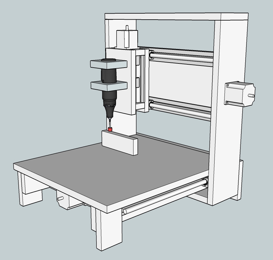

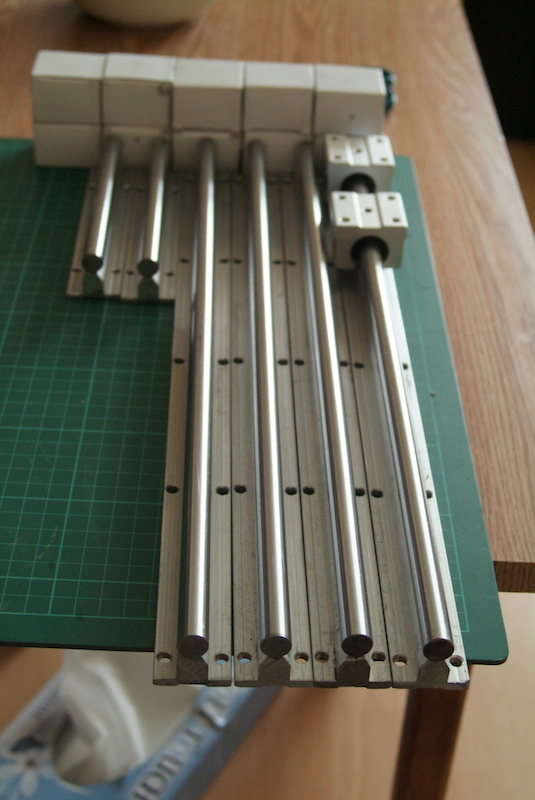

    The linear bearings and supported rails arrived yesterday.

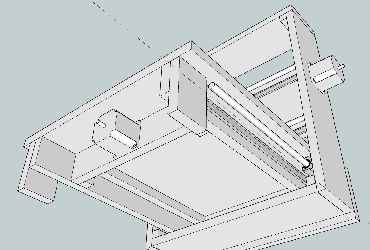

    I have also done the Sketchup drawing so hoping to start building in a couple of weeks.
    Initially, the idea was to build a small machine that could engrave up to 200mmx150mm but I couldn't get the rails I ordered are 420mm long and I just can't bring myself to cut them so now the machine's working size will be about 300mmx300mm.
    I only want to use it as an engraver for now but might convert it to cutting as well in the future.
    I am not going to use a dremel BTW, making my own spindle with a permanent magnet motor I scrounged form a neck massager.....no idea if it's going to be any good enough though as I don't have a clue what RPM it runs at. But it runs very quiet, can hardly hear it, unlike a dremel.
    I'll add more comments/photos as I go along.
    Any help would be appreciated.

    What's the construction going to be, aluminium extrusion or aluminium flat plate ? How are you going to fit tooling into the, erm, 'spindle' ?
    Neither at the moment cause I am not 100% sure if my measurements are correct so going to use MDF, a lot cheaper to experiment with. If it's all ok then I'll consider getting alu flat plates.
    I have salvaged the chuck off a dremel that burned out on me a few months ago and want to connect that on to the electro motor, somehow. Like I said, no idea if it's going to be any use but gonna give it a try.

    The original idea was to build one with a fixed gantry but I have changed that now to give me double the cutting/engraving size. I have very limited space so need to make the best, or near as damn it, that I can. And if I convert it to cut as well later on it'll be more useful with a moving gantry, can cut larger pieces.

    What I have in mind is to use 18x18mm wood to join the pieces together, as in the sketchup drawing below, would be a lot stronger and will be a lot easier to pull apart and use as patterns as you mentioned.
