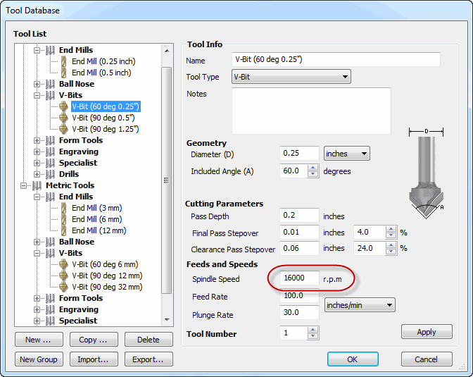

    Hi Suesi, I tend to use whatever settings are recomended in my tool path software. They have far more experience at that sort of thing than me. Im Lucky as my spindle will hit 50k rpm if needed.

    It might be that if you used a hard wood, hard as in 'aluminium like', you may have more success, but even so I'm cutting aluminium on my pin router that's designed for wood but I find it likes a speed of about 8000 to 10000 rpm with a 6mm spiral cutter designed for aluminium.

    Unless you use a very large diameter cutter you will only "chew" most timber at 4000 rpm.This is where the horses for courses bit comes in. Milling machines are generally very rigid and are designed to cut metals and harder materials, but do not usually have high speed spindles. Routers on the other hand do usually have high speed spindles and are used predominately for softer materials. If you really want to cut timber (I seem to think that your first post referred mainly to cutting metal) I think you will need to become a "dab hand" at using abrasive paper!! Good luck. G.
