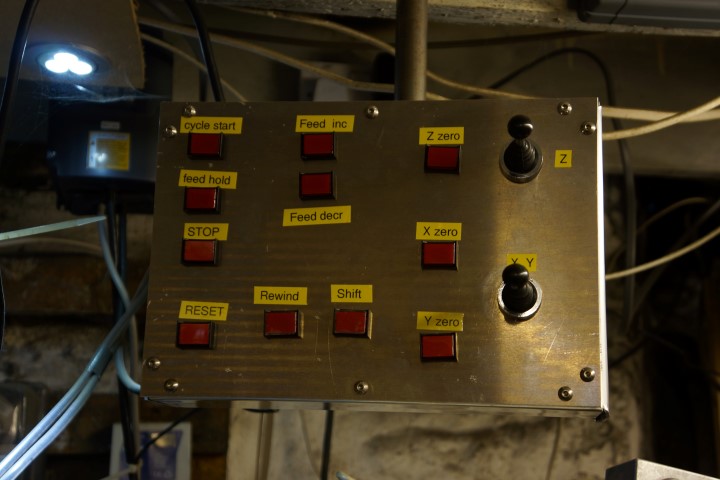

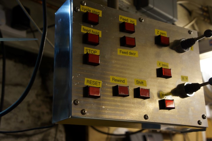

    Not seen a thread on control panels but it's not difficult provided you have enough inputs or some keyboard emulator. I don't build control panels as such but do build in some small form of control on front of machines. Like this.!
    Latest one just done has a joy stick on and few other buttons for Axis Jogging but not no pic sorry.!

    Any chance you could list the controls for me? There are a lot of buttons on the Mach3 interface I haven't tried yet, some of them might be useful for all I know.
Name:	IMGP3409 (Large).JPG
  9. #19
    Can do but not all are controlling mach3 modes in fact only 3 mach buttons are controlled via trigger codes. Cycle start, feed hold and Reset. Some signals are sent to Mach inputs to inform about E-stop and to reset after E-stop etc.
    Starting left to right.
    #1 On/off switch and LED This just turns off 24v to control system so nothing can be turned on.
    #2 Momentary Reset and Led which latches safety E-stop circuit(relay) on and Reset's Mach.(Trigger/Button)
    #3 Oh shite Button connected to latching circuit and Signal back to mach informing E-stop(Input)
    #4 Cycle start (Trigger/Button)
    #5 Feed hold (Trigger/Button)
    #6 Limit override
