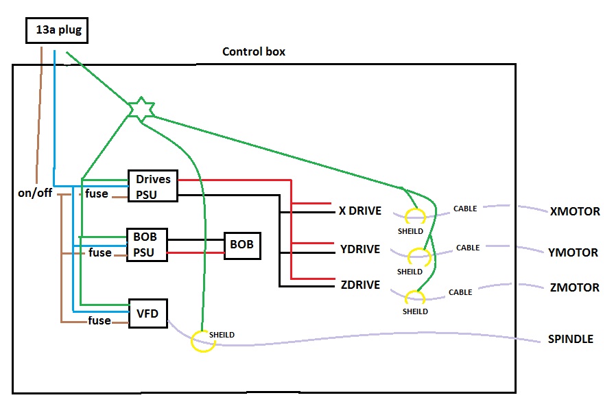

    Cheers for the comments the switches were ment to be normally closed and are shown wrong. Lol

    The pilz relays were only me trying to make use of stuff ive already got and may be beter than some cheap alternatives.
  4. #14
    As has been said, put the limits and E/Stops in series. don't cut power to the bob.
    You would then just need to use the PNOZ X9P, also why are you have a reverse option on the VFD ?
  5. #15
    I may be wrong but I only wanted the limits to kill the steppers and leave power to all the other systems and the estop to kill everything but the supply to the bob.
  6. #16
    Quote Originally Posted by GTJim View Post
    There is no right and wrong, that's a fair requirement. I chose to put the limits and E/Stops in series because I couldn't see the point of having both scenarios you mention, what's the point of killing power to the steppers but leaving the VFD running for example ? You can still put the limit override switch across them if they are in series with the E/Stops.

    It seems like a few amendments are needed.
    Has anyone got an easy to understand grounding/earthing diagram for a similar circuit, and info regarding suitable components to use?
    Below is a very basic sketch I've found but not enough detail.
    Just my 2 cents worth. Personally I would not put the VFD inside the control box as it will generate a lot of noise (rf speaking). Also it's not a good idea to daisy chain the power supply to the drives, I would run separate cables back from each drive to the power supply. The grounding of all the screens on the cy cables etc should all go back to one central place, (called a star) Most people tend to ground the screen at one end only.. ..Clive

    Hi Clive, thanks for your comments.
    I was only using the sketch to show a very simple example of grounding/earthing and was hoping to get feed back relating to methods and components used.
    Jim
  10. #20
    As Clive says each driver should be wired back to the PSU.
    For my earth star point I'm using the terminals DIN rail. If you use these for your screens, EK2.5 - Detailed item view - Chalon Components, they earth right onto the rail which becomes the star point and it's tidy.
