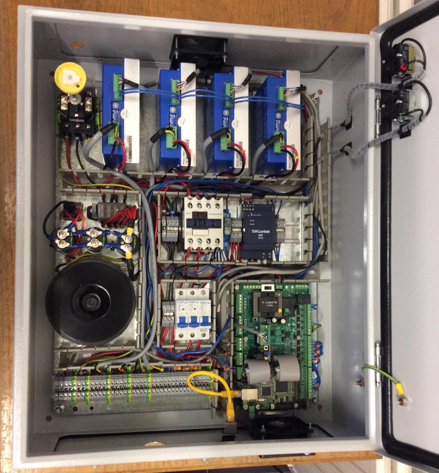

  7. #36
    As promised earlier here's a photo of my panel and updated wiring diagram.
    I've maintained the layers in the PDF. If you open it with Acrobat Reader 6.0 or later and go to View > Show/Hide > Navigation Panes > Layers, then you can turn the layers on/off by clicking on the 'eye' icons next to the layers.
Name:	cabinet layout7.pdf
    The panel looks quite neat with the covers on the trunking, I left them off for the photo so more of the wiring can be seen.
Name:	Panel Wiring.jpg
    Hope these help someone at some point.
    Si.
  8. #37
    Si what are those in the door.? They look like Switches.? but what are they controlling.?
  9. #38
    Si that looks very good and if i can get mine laid out as well I'd be happy.
    Do you have any fans in the cabinet and are they needed?
  10. #39
    Where did get the terminals and isolation switch?
  11. #40
    Dean, they're just LED lamp holders. One as a 'ac power on' indicator (so I don't forget to switch it off!), the other connected across the NC terminals of the contactor to show when it's not latched on.
    Quote Originally Posted by GTJim View Post
    Thanks Jim. There are 2x 24v fans in the cabinet. One can be seen just below the BOB pulling air in, the other is at the top in the middle pulling air out. I could have got away with just a vent at the top, but as I had 2 fans and a load of filters I thought i'd use them.
    The Din rail terminals are these : EK2.5 - Detailed item view - Chalon Components and these : JXB2.5 - Detailed item view - Chalon Components
    The isolator switch is this one : Buy Non-Fused Switch Disconnectors 32A 3P Door Interlocked RS LBDI323P online from RS for next day delivery.
