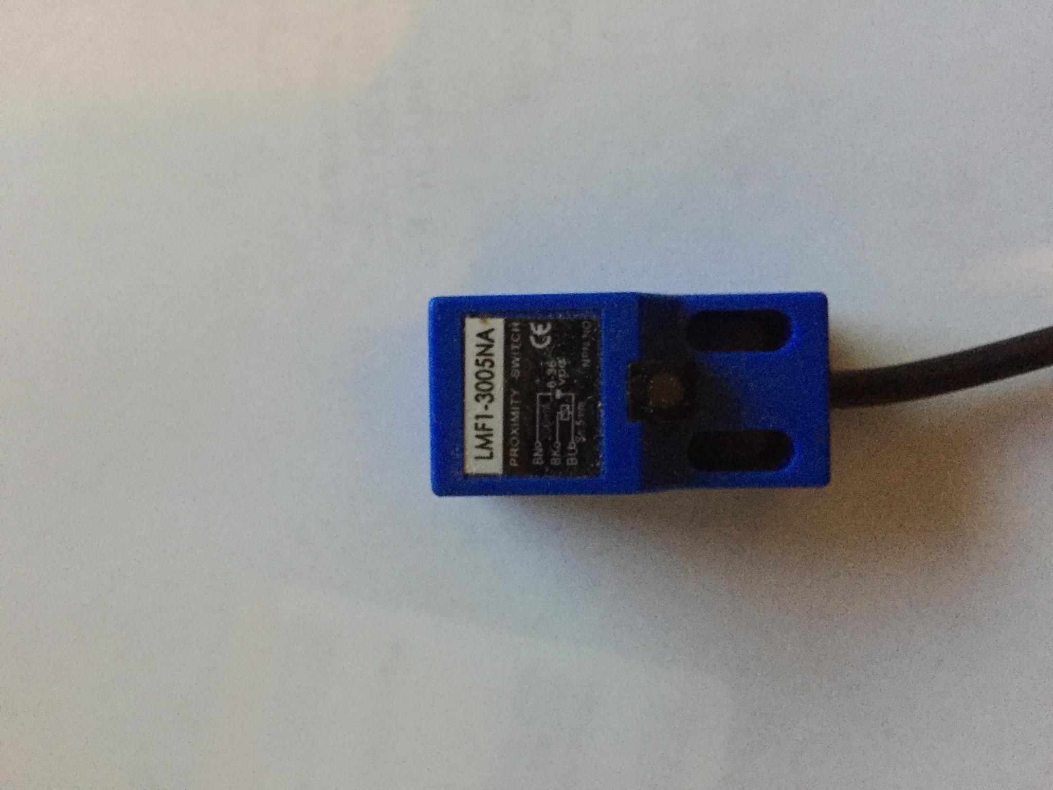

    it's a 6 - 36v switch the wiring diagram that came with the switch is attached and I also included a picture of the switch. Since I'm not and electronics person I'm trying to find which wires go to what pin numbers and if a transistor is needed which one and how to connect it. I
    Im using a 12v transformer to power the switch.
    Thanks again for the help if you need me to list something else I missed let me know.

    I thinks they are simply a +, - and a 'switch' wire.
    I had a similier type, Brown to +5v, Blue to Ground (-5v), and the black wire to the 'Limit switch' terminal on my controller....

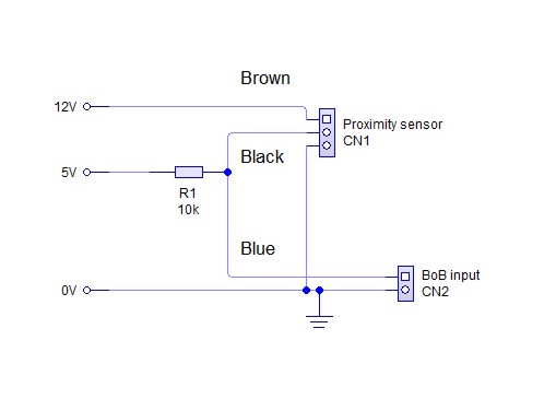

    First of all you will need a 12v DC power supply.
    The sensor is designed to work from a supply of 6 to 36v +V (Brown wire). 0V (ground) is connected to the Blue wire and the black wire is the sensor output, which switches to ground when triggered. When not triggered the black wire can be considered as not connected to anything internally in the sensor.
    You will need a load resistor connected from 5v on the BoB to the black wire and to the input pin on the BoB. I use 10k ohm, the value is not critical but ideally should not be less than 1k or greater than 47k. The blue wire from the sensor should also be connected to ground on the BoB. The BoB must be supplied with a separate 5v power supply and I do not recommend using USB from the computer. This type of sensor acts as a switch between the black and blue wires. I have found that though rated 6-36v they do not work reliably below 10v.
    Mach3 sees the input as triggered when it is at 0v.
    The Blue wire label should be underneath pointing to the 0v (ground) line.
    I put a circuit diagram in here, but it got lost in the post.

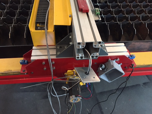

    I connected them the way you said and it works. I conected the black wire to the imput and the 5v on the BOB. Now I'm trying to connect them in a junction box and the Y+ will trip but the Y- won't when there conected together. Can you tell what you think is wrong.
    I used 1 4300 ohm transistor on the end at the BOB for both switches. I'm wondering if all the switches have to be run back to the board with seperate transistors.
    They are the two blue switches on the bottom of the picture.
