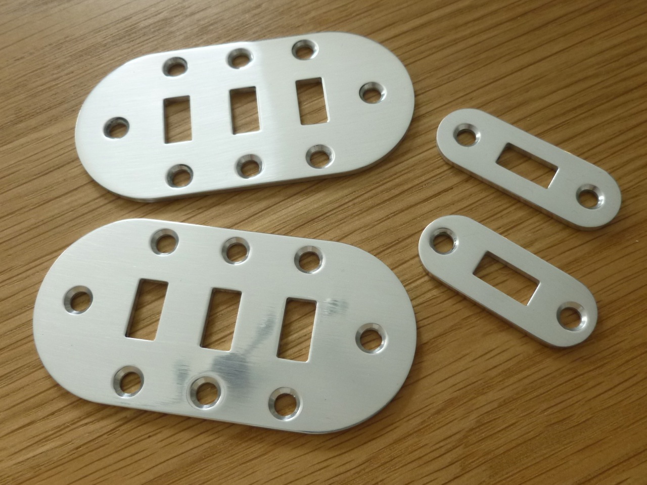

    I cut some parts from 1050 the other week. Yes, it's a bit of a devil to cut but I found the slower the better... These are the parts I cut:

    And here's a clip of the machine at work. (Yes, that is the alu sheet bending while getting spot drilled - I was feeling my way around the RPMs needed...)
    And here are some cutting details - all very conservative:
    Spot drill - 10k RPM
    HSS Through Drill - 5k RPM
    3mm 2 Flute Carbide Cutter - 10k RPM
    1mm 2 Flute Carbide Cutter - 13k RPM
    Plunge rates at around 0.75-1mm/sec
    Feed rates no higher than 3.5mm/sec
    WD40 - a must. The cutter squeals a bit without it...
    Wal.
