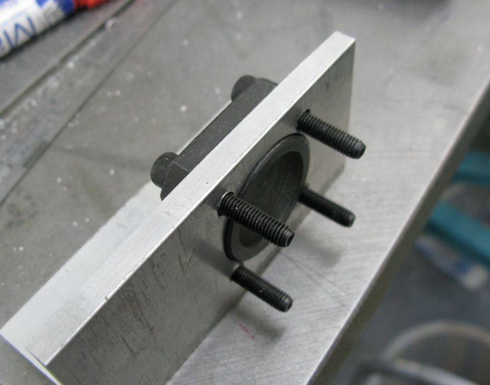

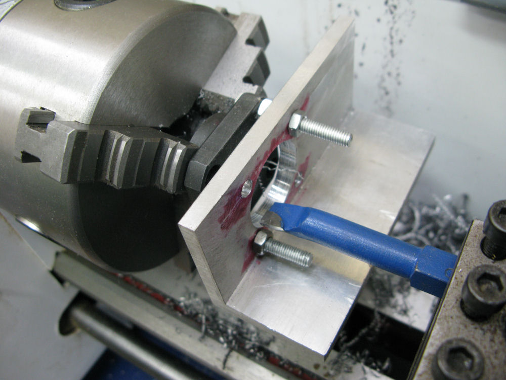

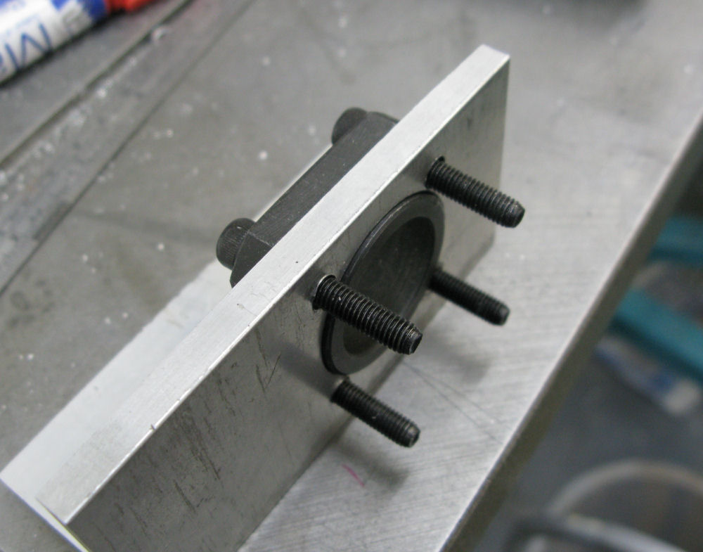

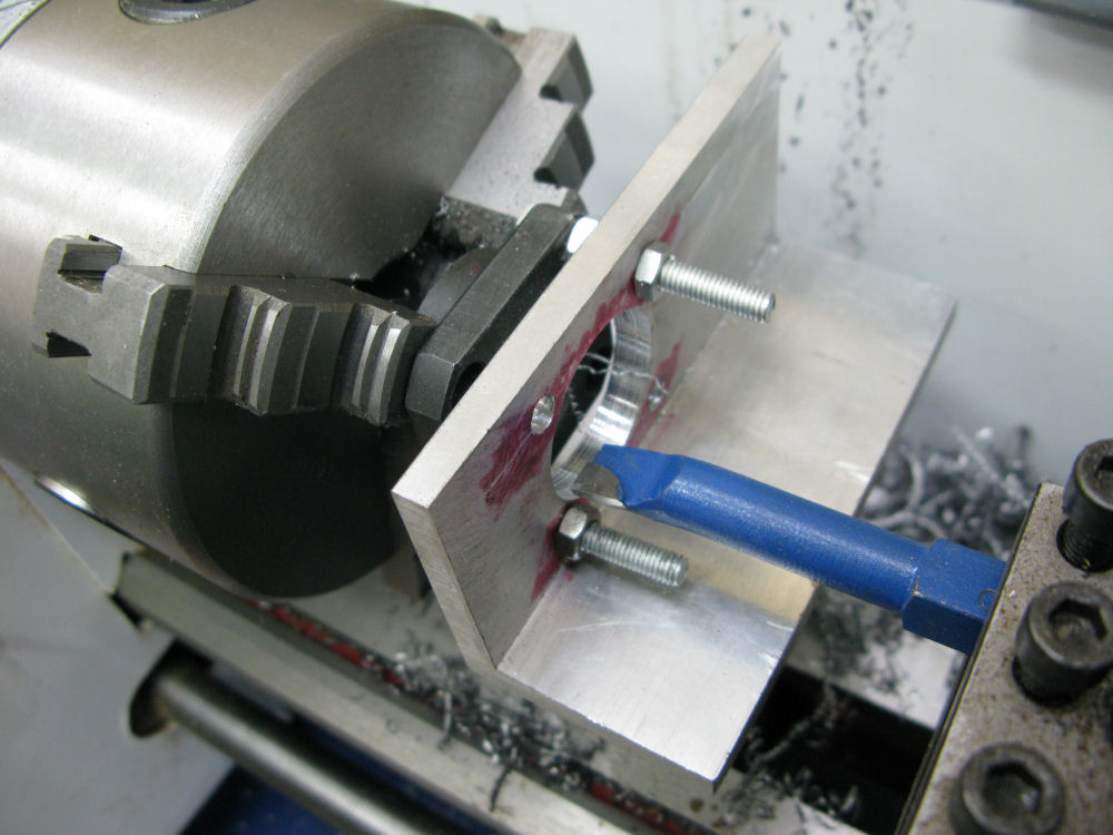

    Drill largest feasible hole in bracket, in my case about 19mm using a cone cutter (it's hard work and hardly cuts), position bearing block on bracket and clamp, drill mounting holes in bracket using bearing block as a guide, bolt bearing block to bracket with some spacers between, mount in lathe chuck, use boring bar to open hole out to final size.
ID:	11745Click image for larger version.
    I think the answer to my original question is this;
    The bearings can be used either way around but the face next to the boss is the one that goes up to a bracket. This allows for the fact that the mounting holes are counter bored on the flange face and it's possible that the face next to the boss is more accurately machined.

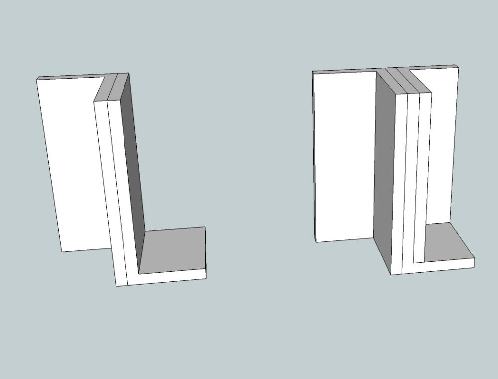

    By the way is the angle bracket the only part holding the bearing? There will be some flex here if that is the fixed end. Is it part of some bigger grand design involving the plate in photo2?
    Good work anyway.
  7. The Following User Says Thank You to routercnc For This Useful Post:
  8. #7
    Your right, the floating end will have two pieces of angle and the driven end will have three, as per drawing.
    Angle is 6mm thick by the way.
