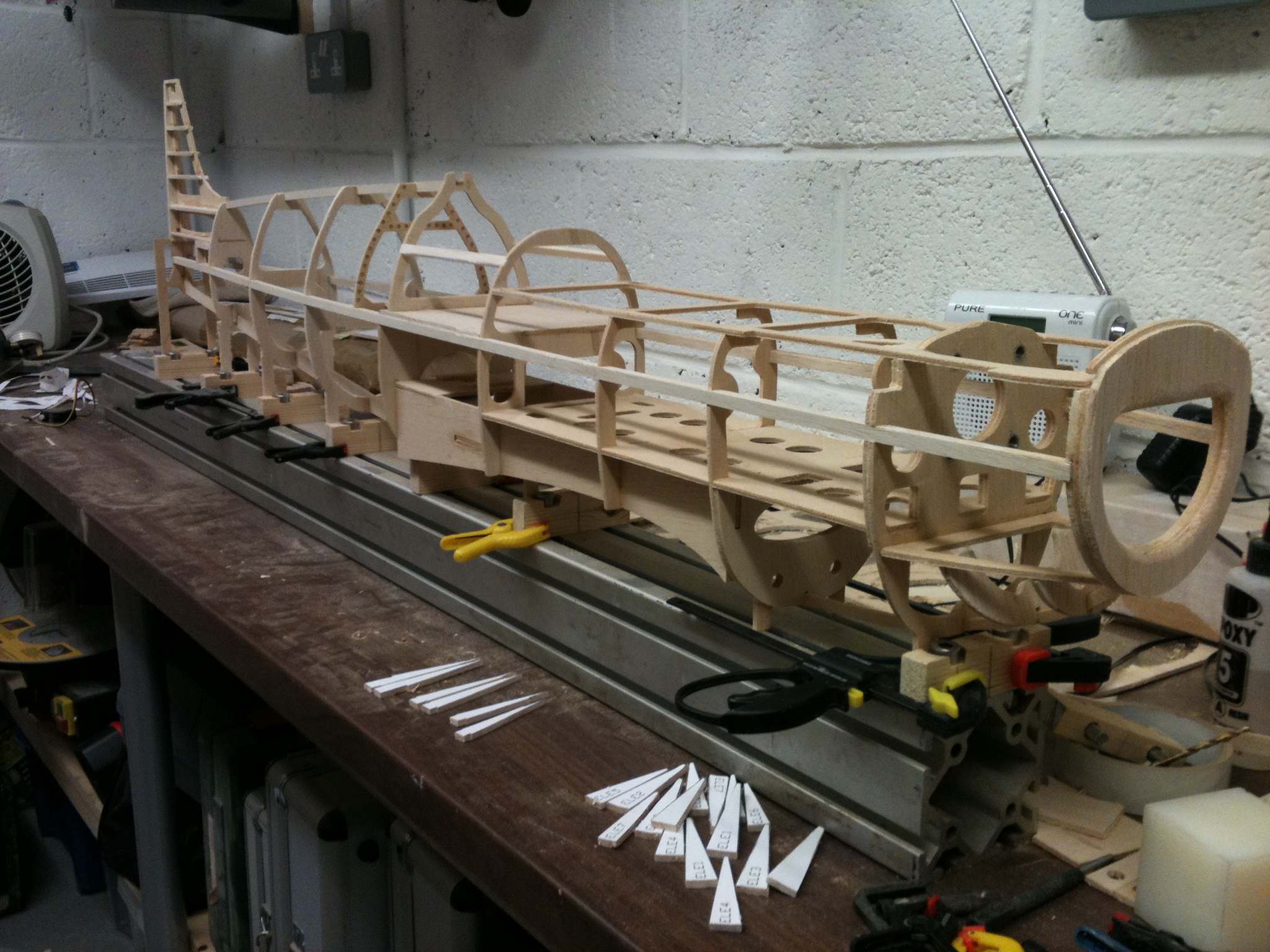

    Doesn't seem like a particularly heavy cut so it's a bit odd that one. I cut a fair bit of 3mm ply, liteply, and the occasional bit of MDF and use a single flute 3mm TCT router bit without problems. Here is my home design Spitfire which all locks together nicely . . .

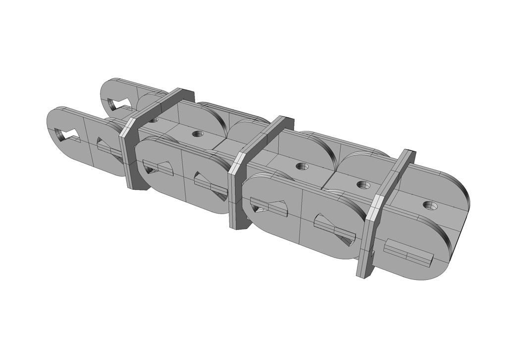

    This is what I'm playing with.
Name:	Cable chain small.jpg
    It's a cable chain idea based on something I found a while back; it needs reasonably accurate cutting to make it all stay together (no glue or loose fixings) while still being able to articulate.

    Indeed - that's where I found the original. However, I've redrawn it to be a little bit bigger as the original was tight to take CY cables, etc. I was just taken by the idea of hinged links that didn't use any kind of conventional hinge, and it's an interesting CAD->CAM->machining exercise.
