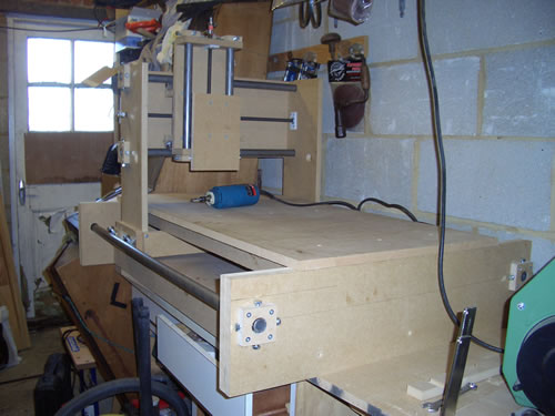

    Measured the shank of the cutter just above the flute. Converting from imperial to metric (only have an imperial mike) that came out at 3.08mm. Plunged a hole straight down and checked size with the shanks of twist drills and that came out between 3.0 and 3.1mm. Pretty conclusive, then.
    I was going to measure backlash, leadscrew float, etc., but when I did a quick "shove it and see if it clunks" test, I realised that the whole thing bends so much that it wasn't worth the effort of digging out the dial gauge, etc. As a further demonstration of general bendiness, I changed from two passes of 1.8mm DOC in MDF to a single 3.5mm pass, and the dimensional error changed significantly to the point that the pieces didn't fit any more. The machine works fine for engraving nameplates, or anything involving light cuts where there's no need of great dimensional accuracy, but ask it to machine two components that will slot into each other, and you're on a loser. Those of you who can machine aluminium on a CNC router are allowed to laugh. I can't machine 3mm MDF...

    Have you got any photos of the machine you could post? Might help gauge stiffness.
    Are you sure you are not loosing steps - the deeper cut is higher load on the leadscrew and delrin nut. I confirmed my machine was missing steps a while ago by touching the stepper motor body during cutting - I could feel the kick every now and again. I think mine was an extreme case so instead you could also set up a DTI on the tool, gantry, or Y axis plate when it is all at the home position, cut out the shape and then see where the machine homes back to. DTI should be back at zero, otherwise there has been a step or so missed.

    I won't bother with a picture. It's too embarrassing... The machine is basically the JGRO design, and there are lots of references to it on the 'net.
    I'm using (all from Zapp) a 68V power supply driving 3 M752 drivers, fed by a ZP5A-INT BOB. Motors are all SY60-something 3Nm steppers. Given that they are driving relatively fine-pitch leadscrews (1.25mm) at modest speeds (max rapid is about 900mm/min to avoid whip) with 400microsteps, I don't think that the motors, etc, are being overpowered by the cutting forces. 3mm cutter, 1.8mm DOC, in MDF? FWIW, I also use LinuxCNC, which seems to be a minority choice on this forum, with clock rate within the max suggested by PC latency tests. I do seem to get good repeatability; I can cut several sets of those cable chain components and pieces are cleanly cut (as clean as MDF cuts) with good registration of first and second passes, as far as I can see.

    OK, if it's one of these then I guess flex is still a possibility if backlash is low:

    JGRO machine
    The electric spec seems very good, leadscrews are low/medium, and machine is . . . . well, MDF on gas pipe bearings. The next step is up to you - whether to upgrade the machine or stick to engraving / simple jobs.

    I've had enough frustration and I'm working on the design of the Mk2 which will be welded steel, ballscrews, and profile rails. I'll take the electronics and motors across from the current machine as I reckon that they'll do nicely (and it's why I overspecced them in the first place). In the meantime, I'm doing some interesting projects with some local artists/craftspeople who are more interested in artistic interpretation than accuracy! I spent some time today with a friend who wants me to turn a bunch of photographs of her daughter's head into a full-size 3D version routed into a bundle of wooden sticks. It's the kind of project that no-one doing this kind of thing professionally would even look at
    (and yes, my machine looks somewhat like that one. Oh, to have a machine that will take drawings and turn them into fitting components without three false starts while I calibrate out the bend!)
